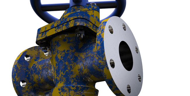

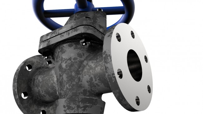

Typically, Opacity maps would be used for something more like a mesh or wire material, but can be handy for rust spots, decay or broken out views as well. With the Color maps you can also add other colors, gradients or use actual images of wood grain, paint splatters or rust.
The value of creating all of these together like this, allows you to sync all maps together perfectly when adjusting the scaling and position. That’s what we’ll look at next time.
Here’s one more shot with a different color map and diffuse color.
