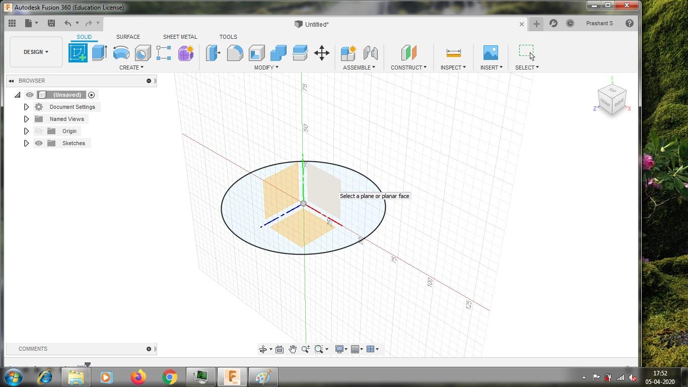

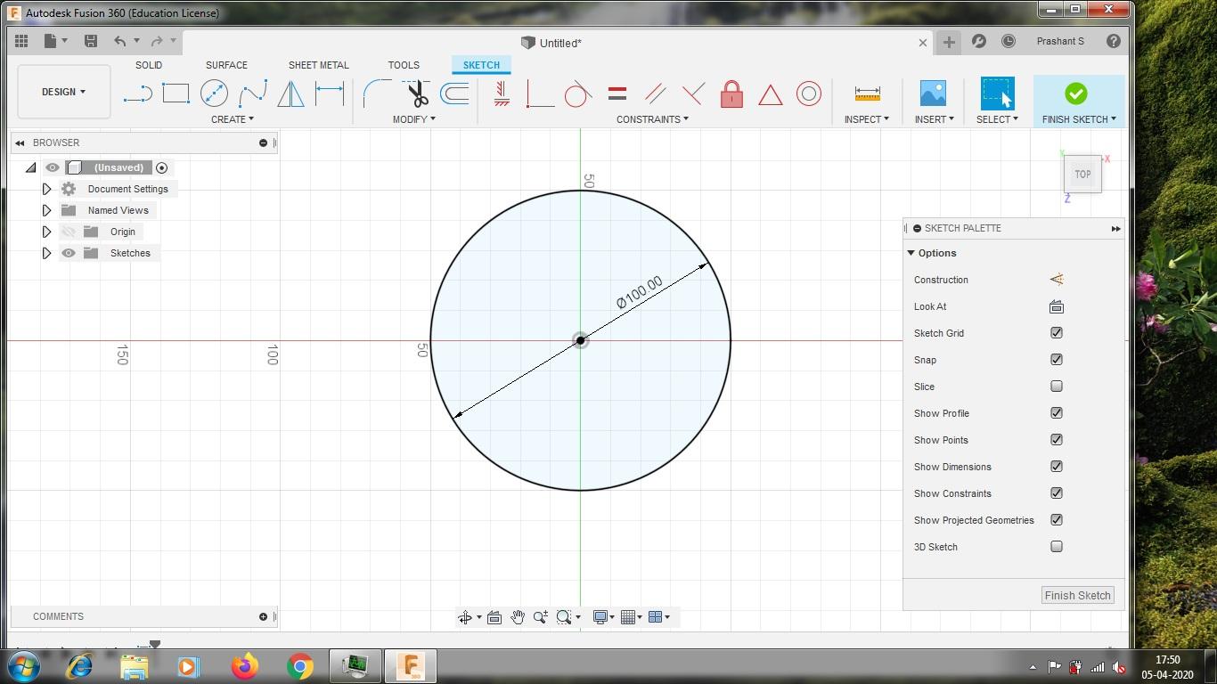

  1. Step 1: Sketch 1
    Draw Circle with 100 mm diameter on vertical front plane.

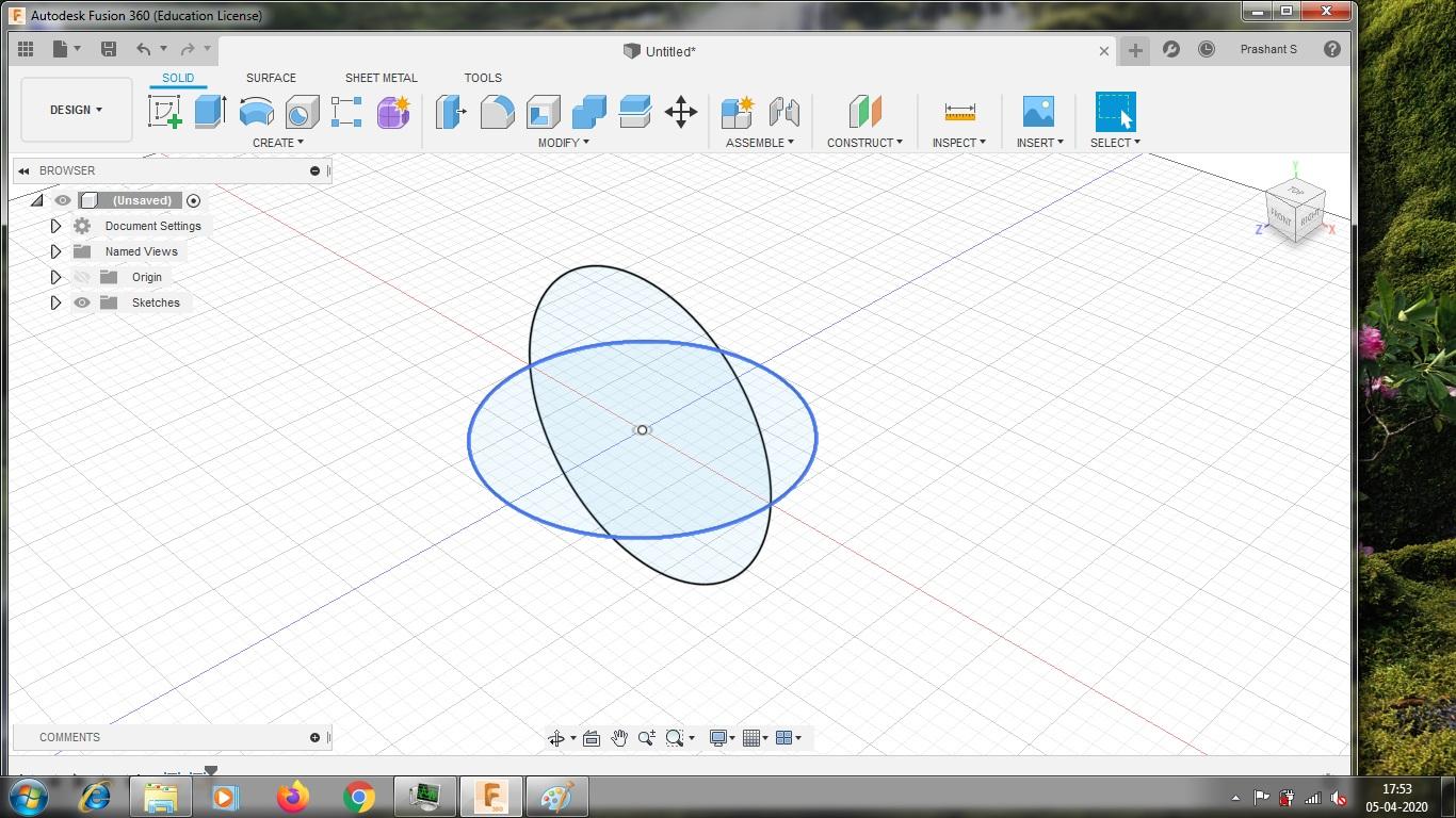

  2. Step 2: Sketch 2
    Draw another circle on right angled plane with diameter 100 mm.

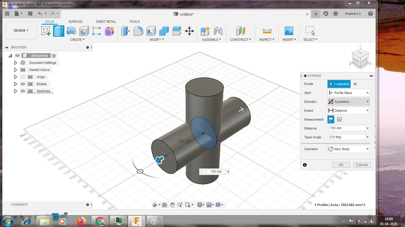

  3. Step 3: Extrusion
    Extrude both circles with 500 mm length on both direction.

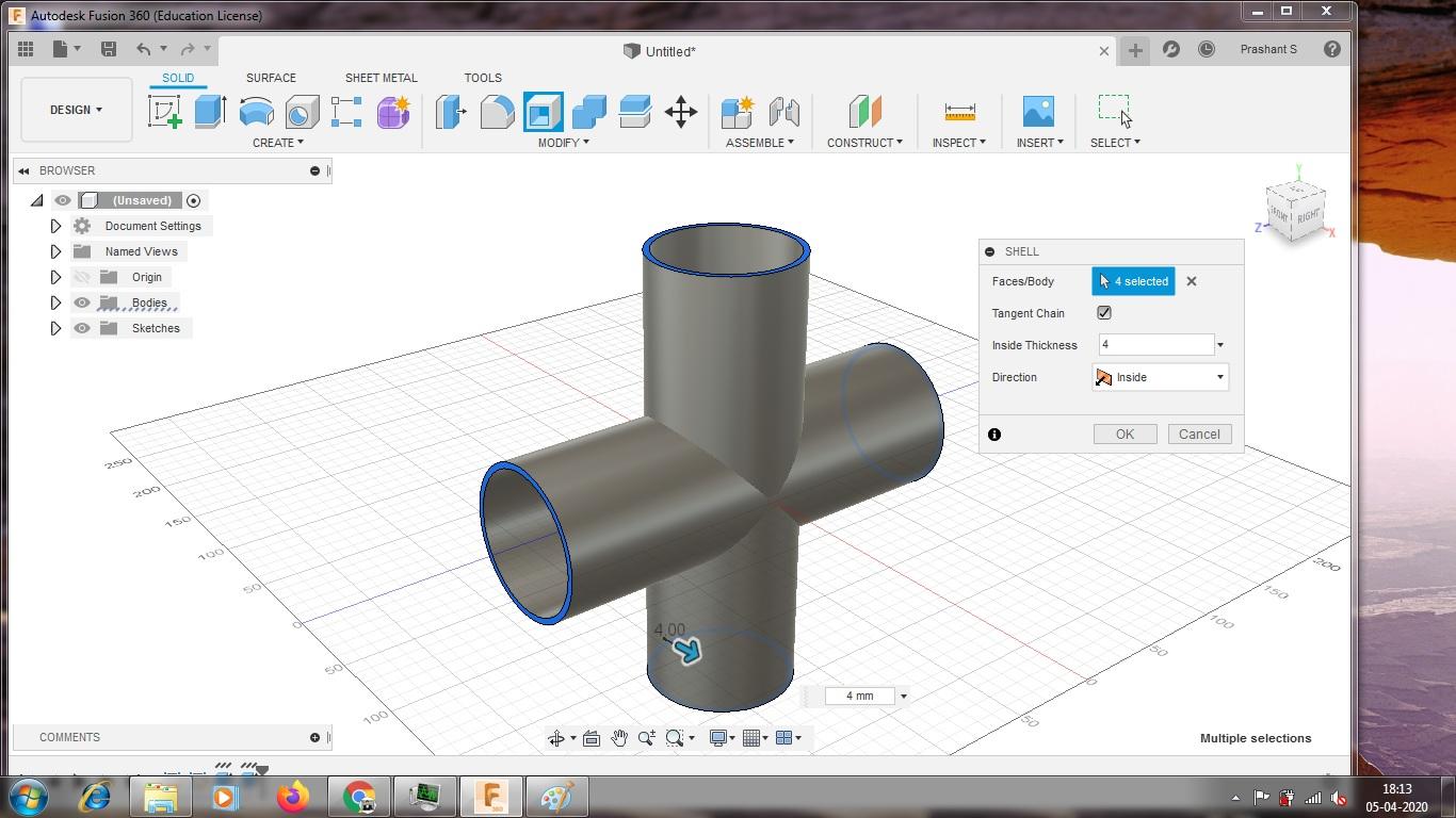

    With different options you will get different results.
    1. With Shell applied 4 mm thickness.
