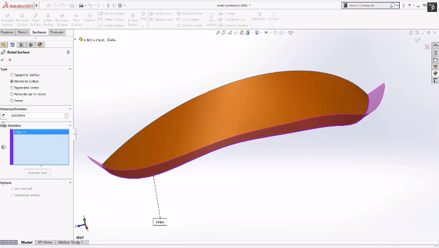

Step 2: Normal to Surface
Normal to Surface creates a surface that is normal or perpendicular to existing surfaces. We select the edge or edges and specify the distance.
Select Normal to Surface
Select the edge or edges
Specify the distance and click on the green check mark.
