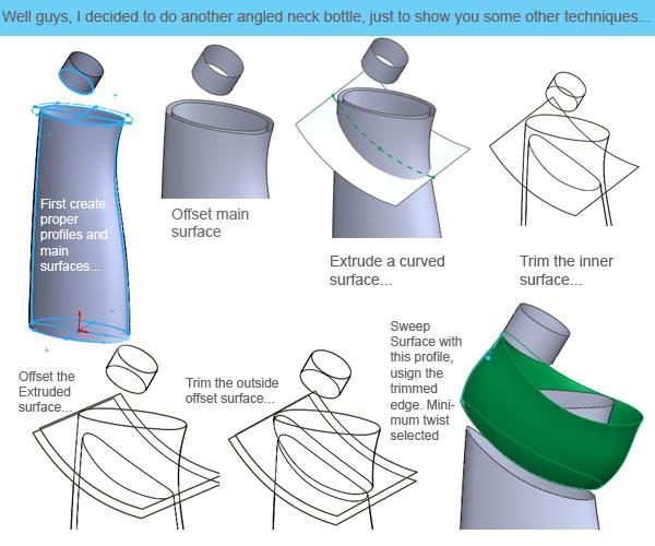

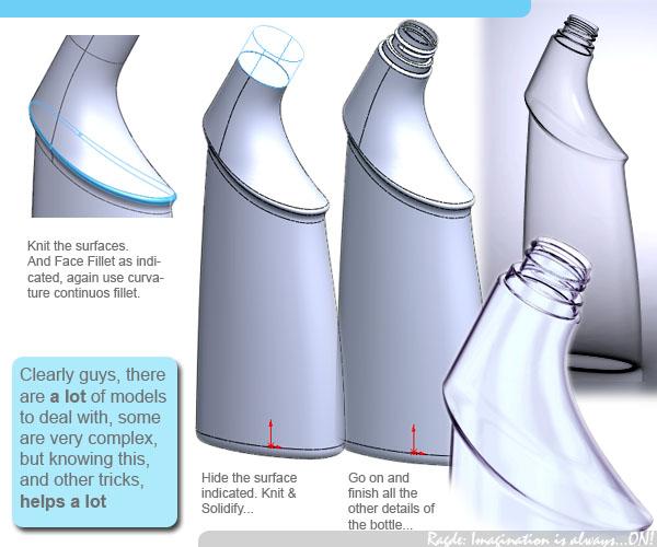

This is another style of Angled Neck Bottle, and you will see other surfacing techniques used for this model.
Please, download the 3D file here:
Angled Neck Bottle
  1. Step 1: First Steps, Main Surfaces...
  2. Step 2: Transition Surface...
  3. Step 3: Finishing the Bottle...
