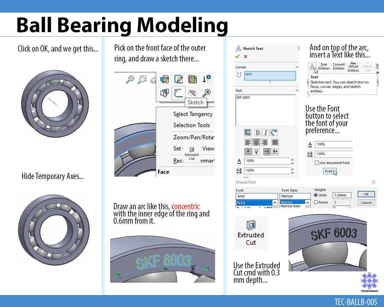

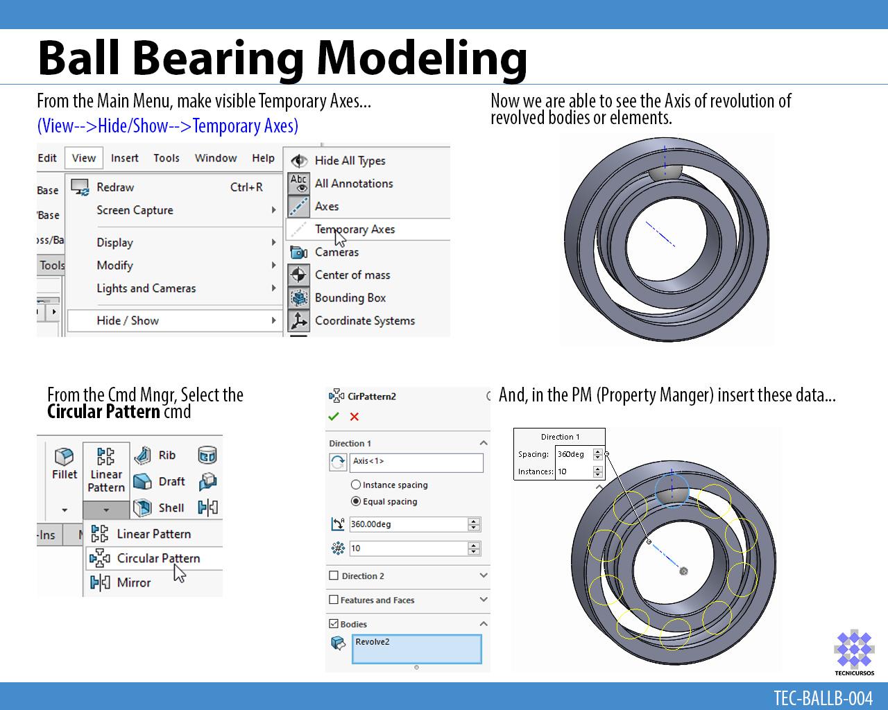

Small tutorial on how to model a Ball Bearing (SKF 6003). (Without the cage)

  4. Step 4: Circular Pattern to model all balls...
  5. Step 5: Engraving...
  6. Step 6: The End...(Some rendering)
