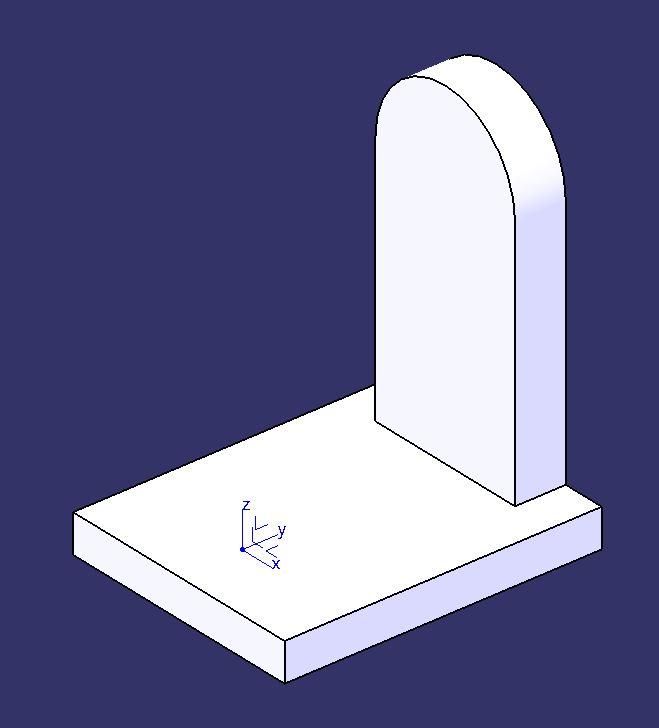

Step 2: 2 Pads
Begin the model by making a sketch (XY plane) of the base and make a Pad (I think it's 15mm thick - hard to read).
Then sketch the vertical wall and make a second Pad (20mm thick).
Here's what we should have to start:

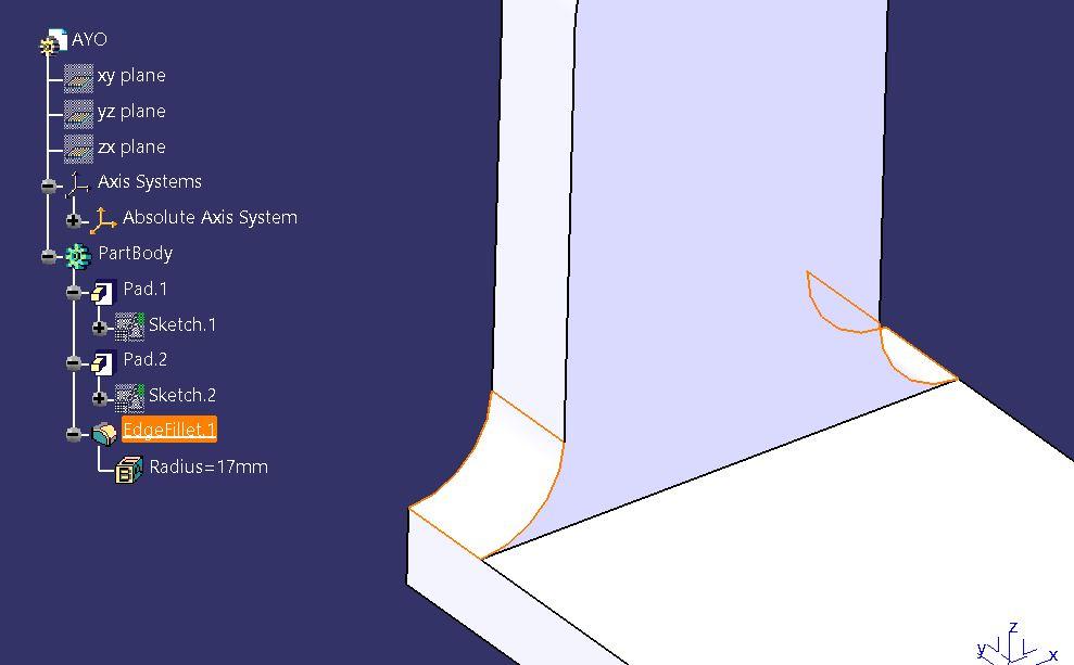

Step 3: Fillets between pads
Using the Edge Fillet tool, select both of the sharp edges, enter a Radius of 17, and click OK.

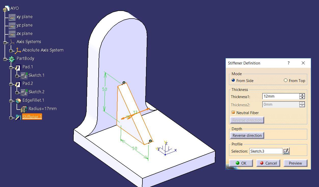

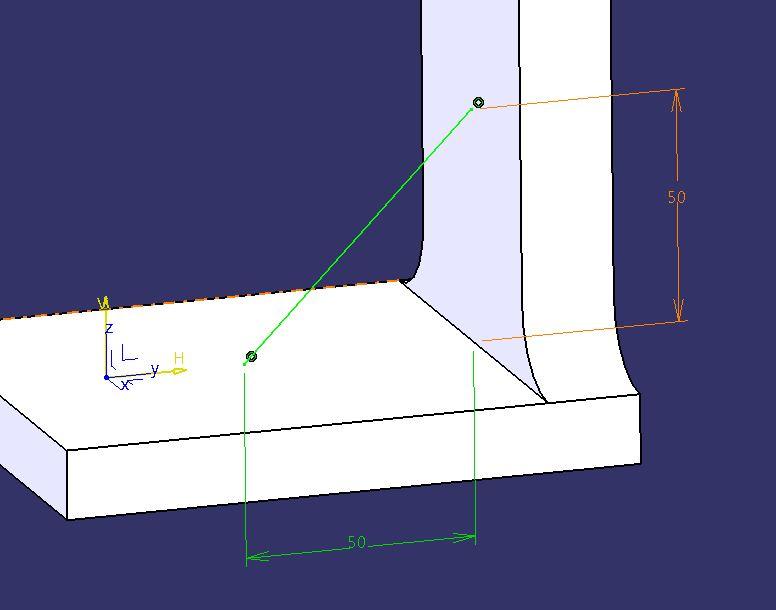

Step 4: Add the gusset
In the YZ plane, sketch the top of the gusset (50 x 50).
Then use the Stiffener tool to make the gusset 12mm thick.

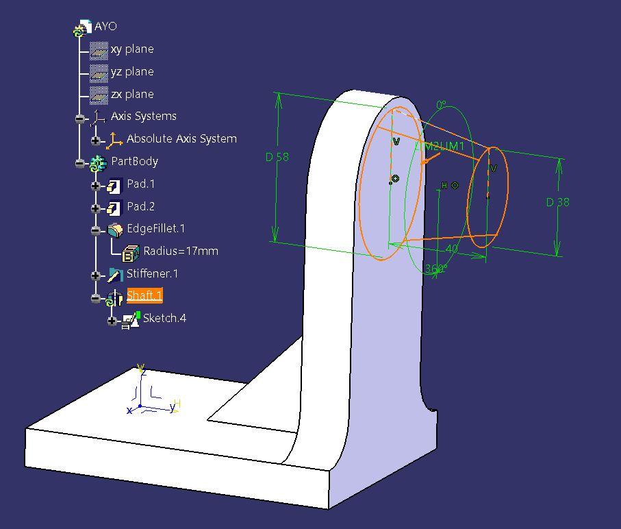

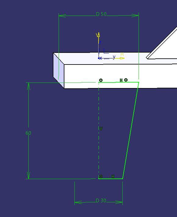

Step 5: Upper Cone
Again in the YZ plane, sketch the half profile of the upper cone. Change the centerline to be the Axis, and dimension as shown. The axis (centerline) should be constrained as concentric to the half circle on top. Rotate this sketch with the Shaft tool to make the cone.

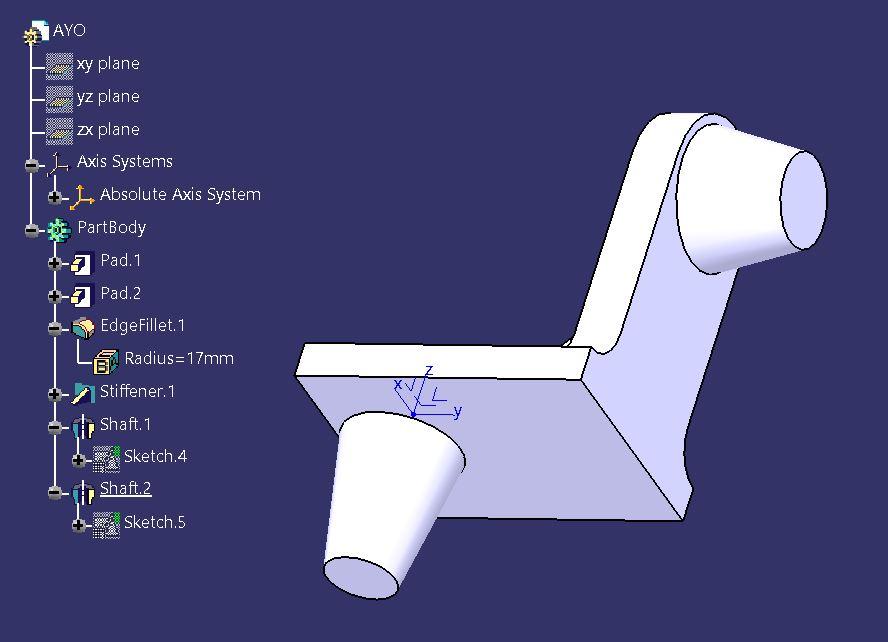

Step 6: Lower cone
Repeat Step 5, make another profile sketch of the lower cone, with the axis colinear with the Z axis.
Just like the other cone, use the Shaft tool to rotate the sketch profile 360°

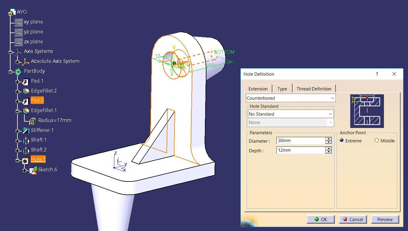

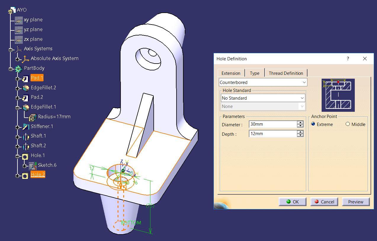

Step 8: Upper hole
Referring to Ayo's drawing, the upper cone has a Ø20 thru hole, with a Ø30 C'bore, 12mm deep.
Using the CATIA Hole wizard; click on the half circle to center the hole, and then click on the front face where the hole starts, and then click on the Hole icon in the toolbar.
The Extension should be set to UP TO LAST, with the Diameter = 20mm.
The Type should be set to COUNTERBORED, with the Diameter = 30, and Depth = 12.
Step 9: Lower hole
Use the Hole wizard again for the lower hole.
Referring to the drawing; Ø16 thru hole with Ø 30 C'Bore, 12mm deep.
