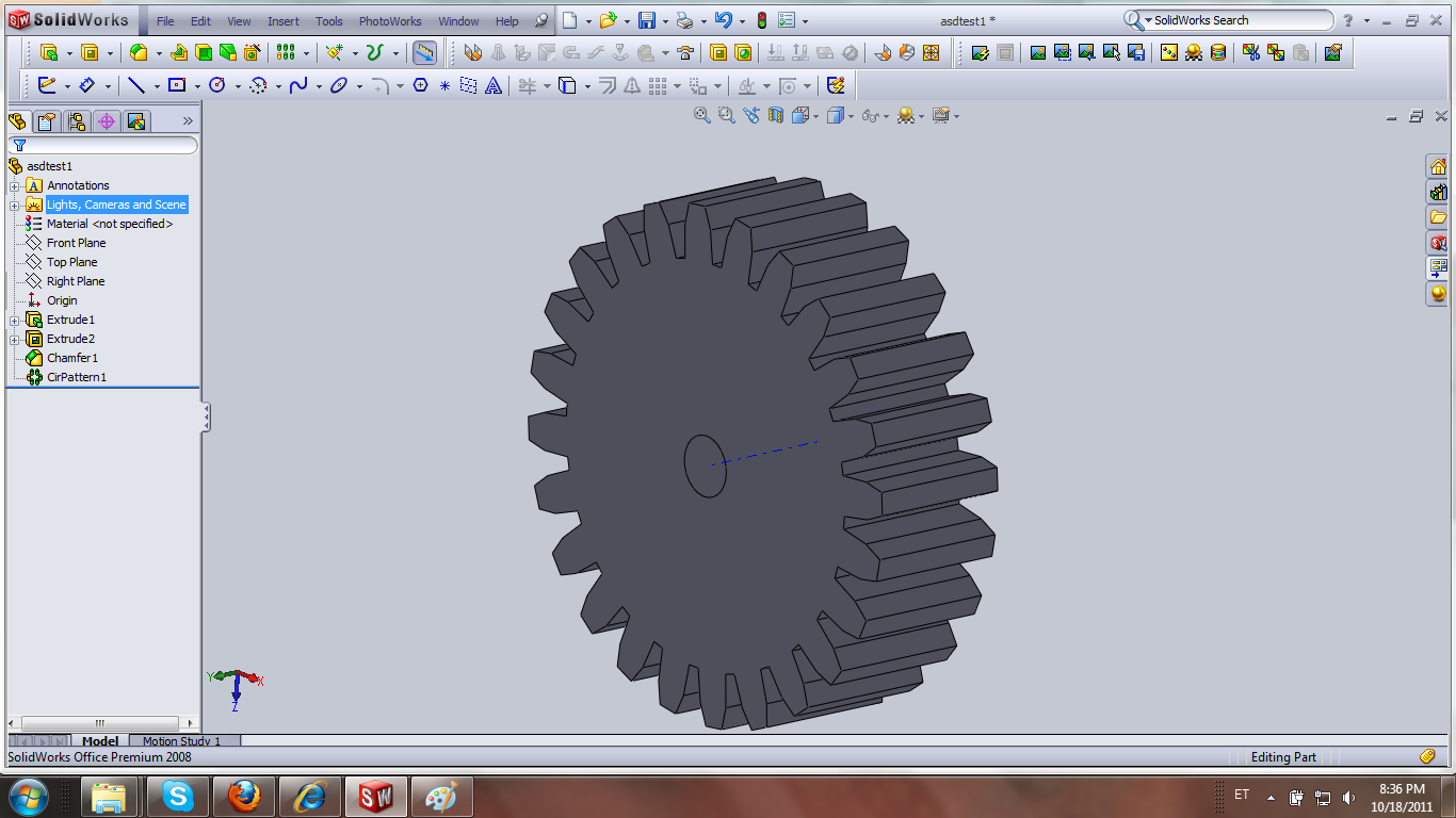

Step 1:
open up the part file and find the lights and cameras folder

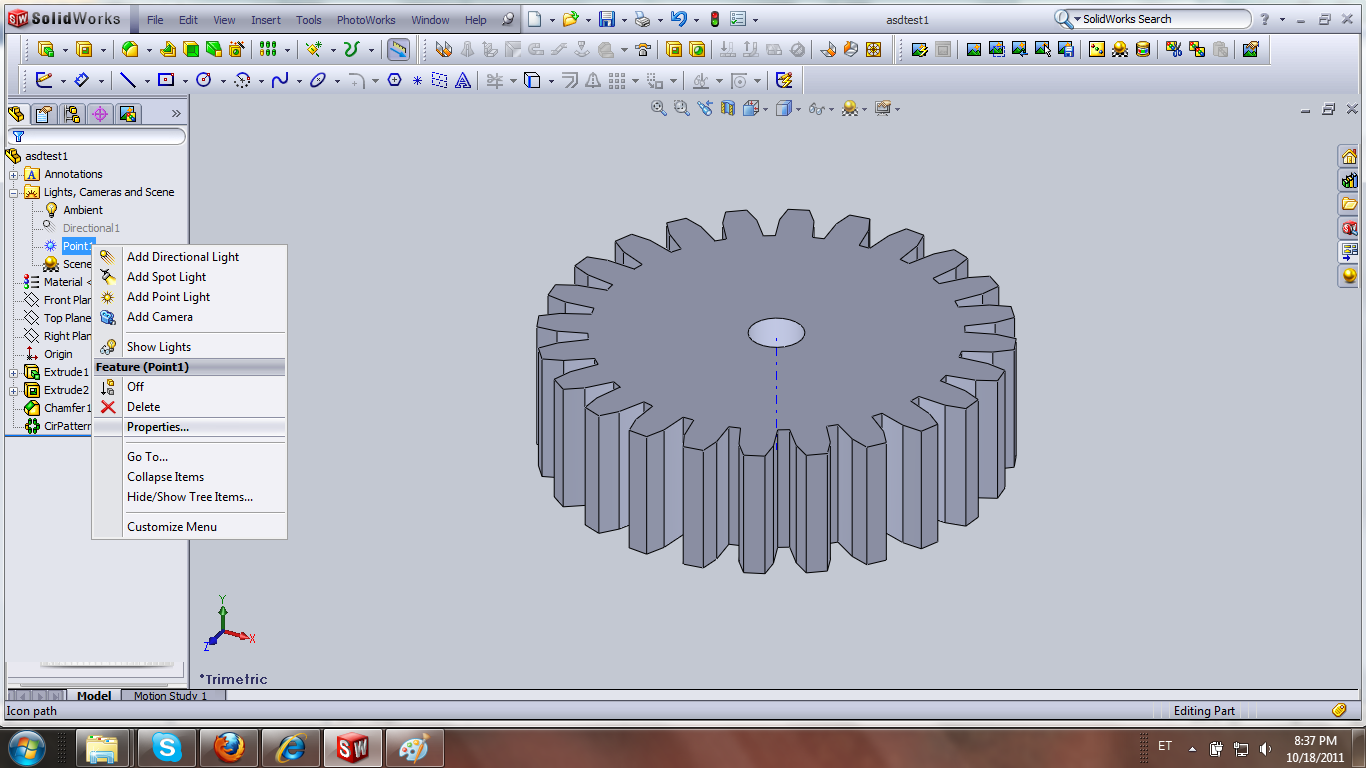

Step 2:
look for the pointlight and right click to change settings

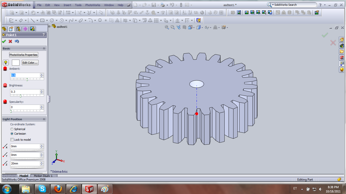

Step 3:
change the brightness or ambient setting to change light intensity and propagation. save after done and render again!
