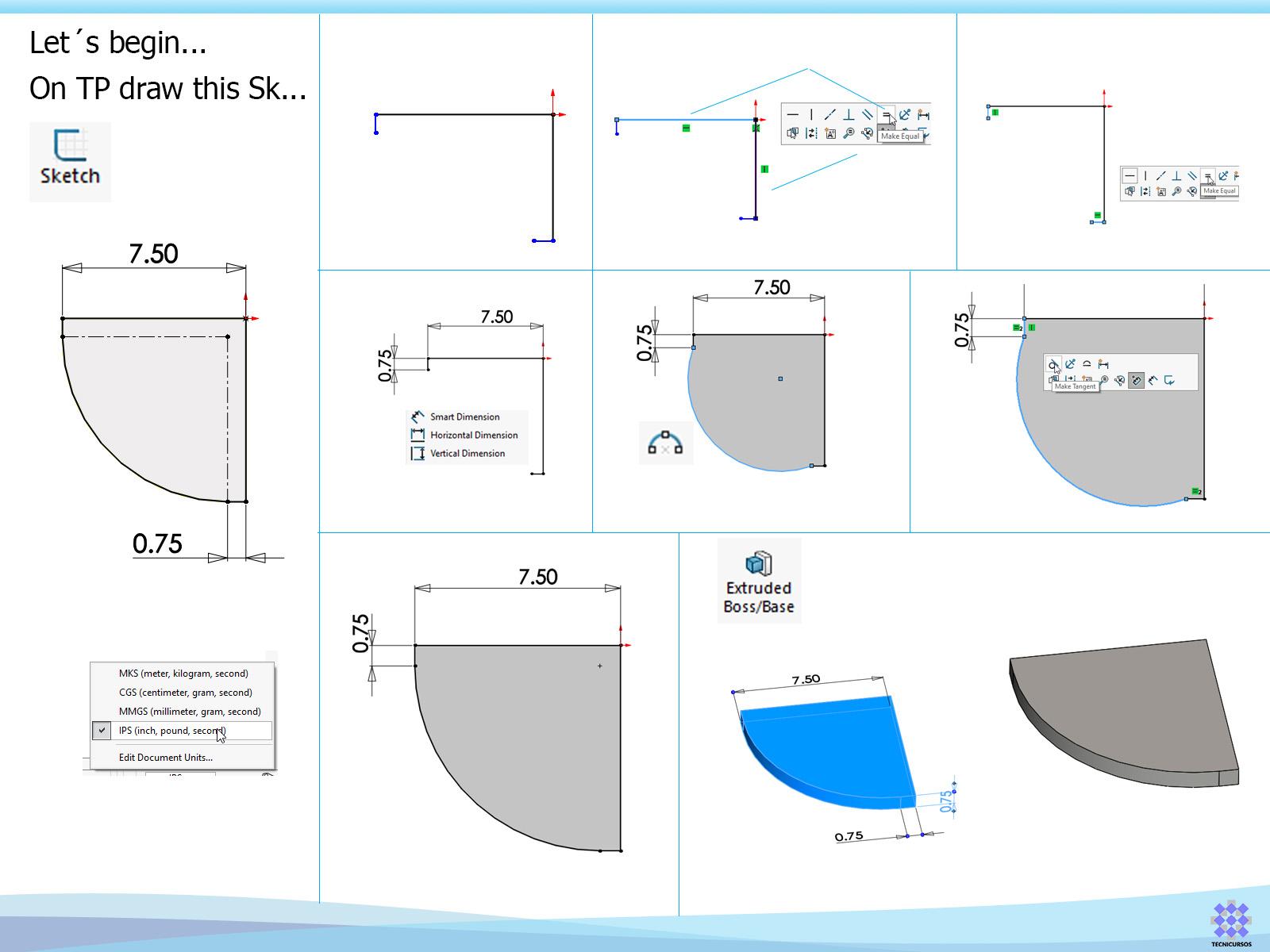

Step 1: The First Sketch...

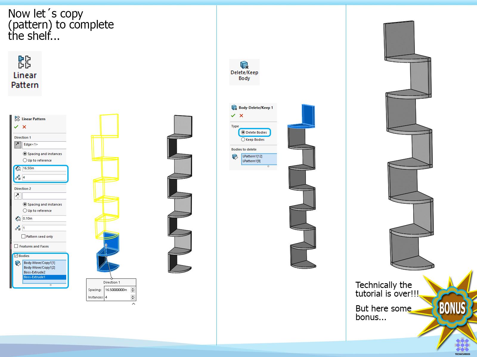

Step 4: Linear Patterning... & START BONUS

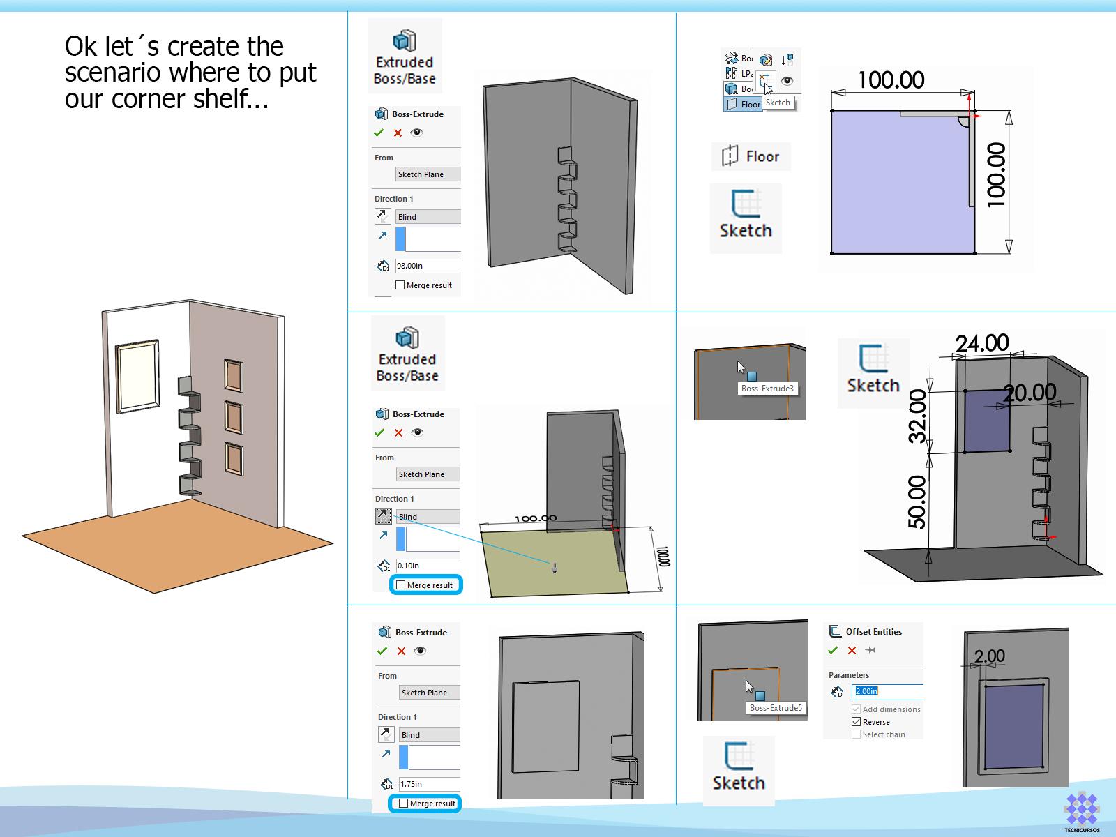

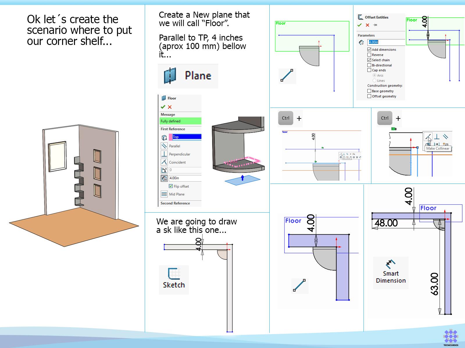

Step 5: Building the Scene...
Step 6: Walls, Floor & Picture frame...

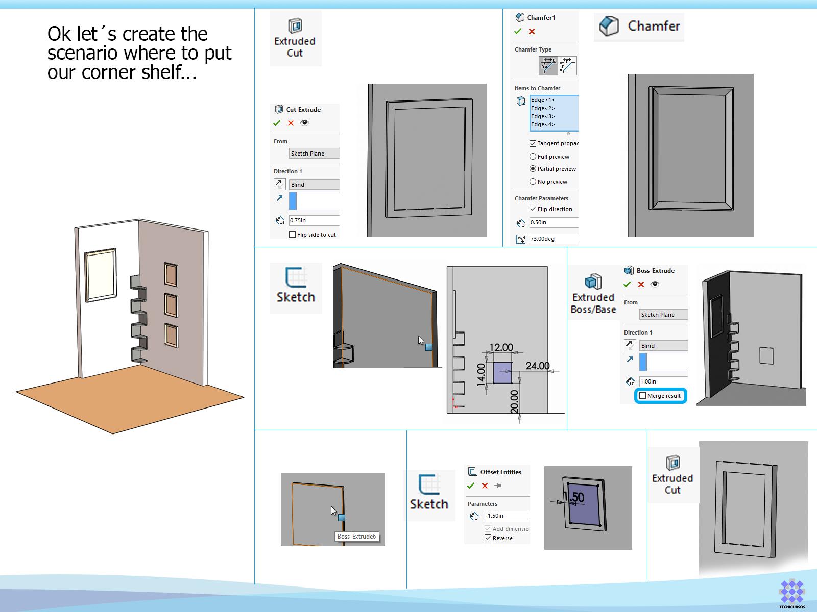

Step 7: Small Picture Frame...
Step 8: Patterning the Small Frames...
