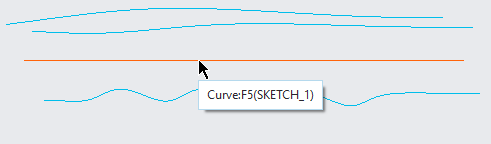

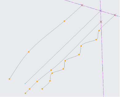

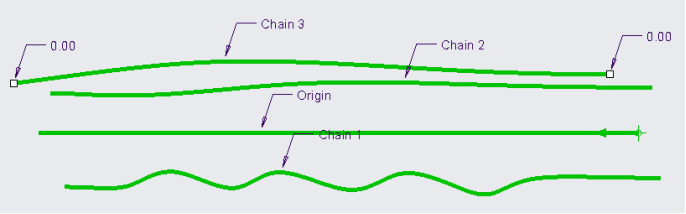

    The model consists of four datum curves as shown below.

    Pick the straight datum curve (Sketch 1) with left mouse pick to make it Origin Trajectory. (Set the view to Default Orientation to avoid any confusion)

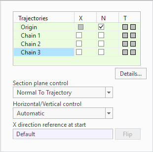

    Now hold down the Ctrl key and pick the other three curves to add them as chains.
    The order, in which chains are selected have no effect on the sweep geometry. Only the desired Origin Trajectory should be selected first.
    Pick References tab to open the References slide-up panel and confirm that there are three chains in addition to Origin Trajectory.

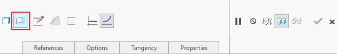

    Pick 'Sweep as surface' icon  to create a surface with this sweep feature.

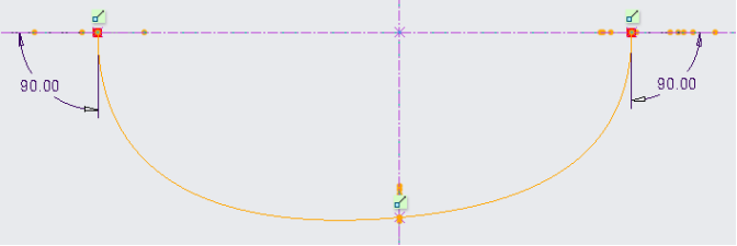

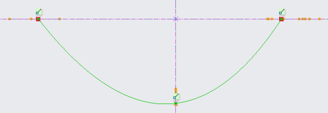

    Pick Spline icon and sketch a three point spline that passes through the references for chains as shown below.
    Now create the spline tangency dimensions as shown below.
    To add spline tangency dimension at a point, click the spline, then click the geometry to which the spline tangency is to be defined and then click the endpoint where the tangency is to be defined. Then click the middle mouse button to place the dimension.

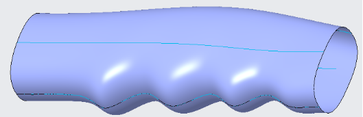

    Pick Apply and Save icon to complete the feature and surface will display as shown below.
    Notice that cross-section remains aligned to the chains all along the sweep feature.

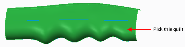

    Now we will mirror the surface, so select it as shown below.

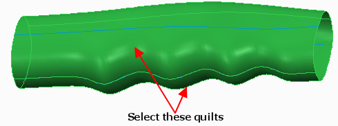

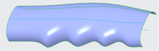

    So select the surfaces, shown in the figure below, while holding down the Ctrl key. (order of selection is not important)

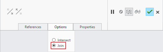

    Pick Options tab and change the merge type to Join.
    Join option is used when two surfaces have a common edge. Join option is faster than Intersect option.
