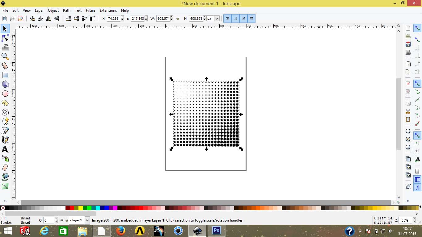

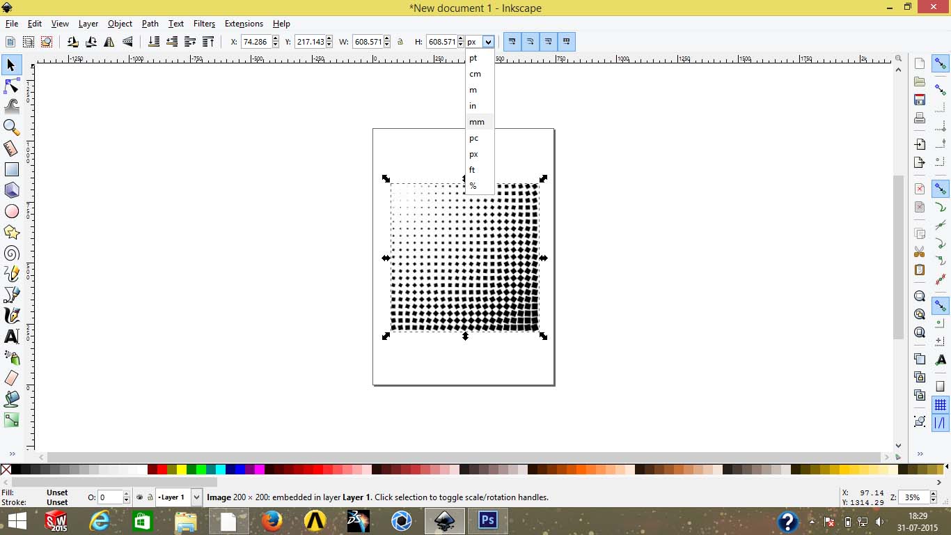

    Now open the inkscape and drag the image file in to it.
  3. Step 3:
    Now just adjust the dimensions for your sketch.

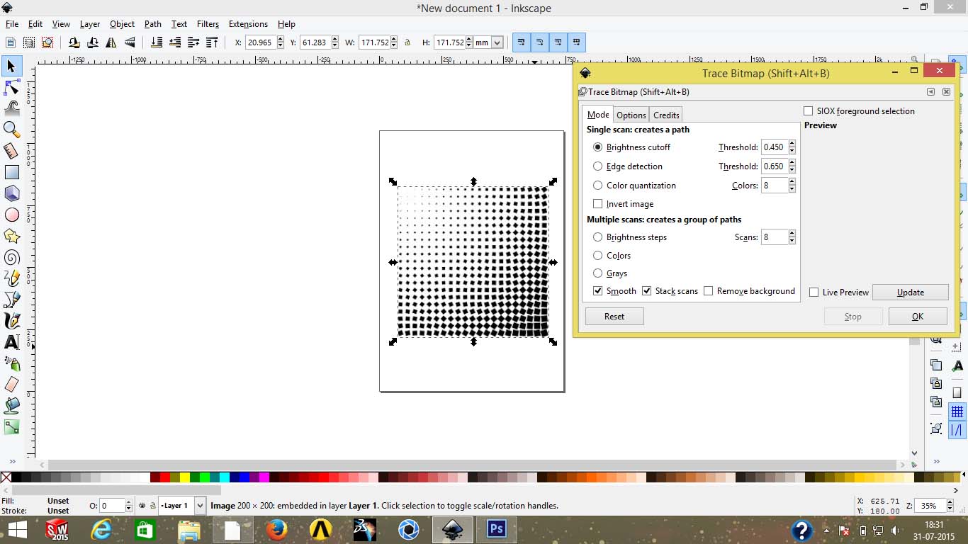

  4. Step 4:

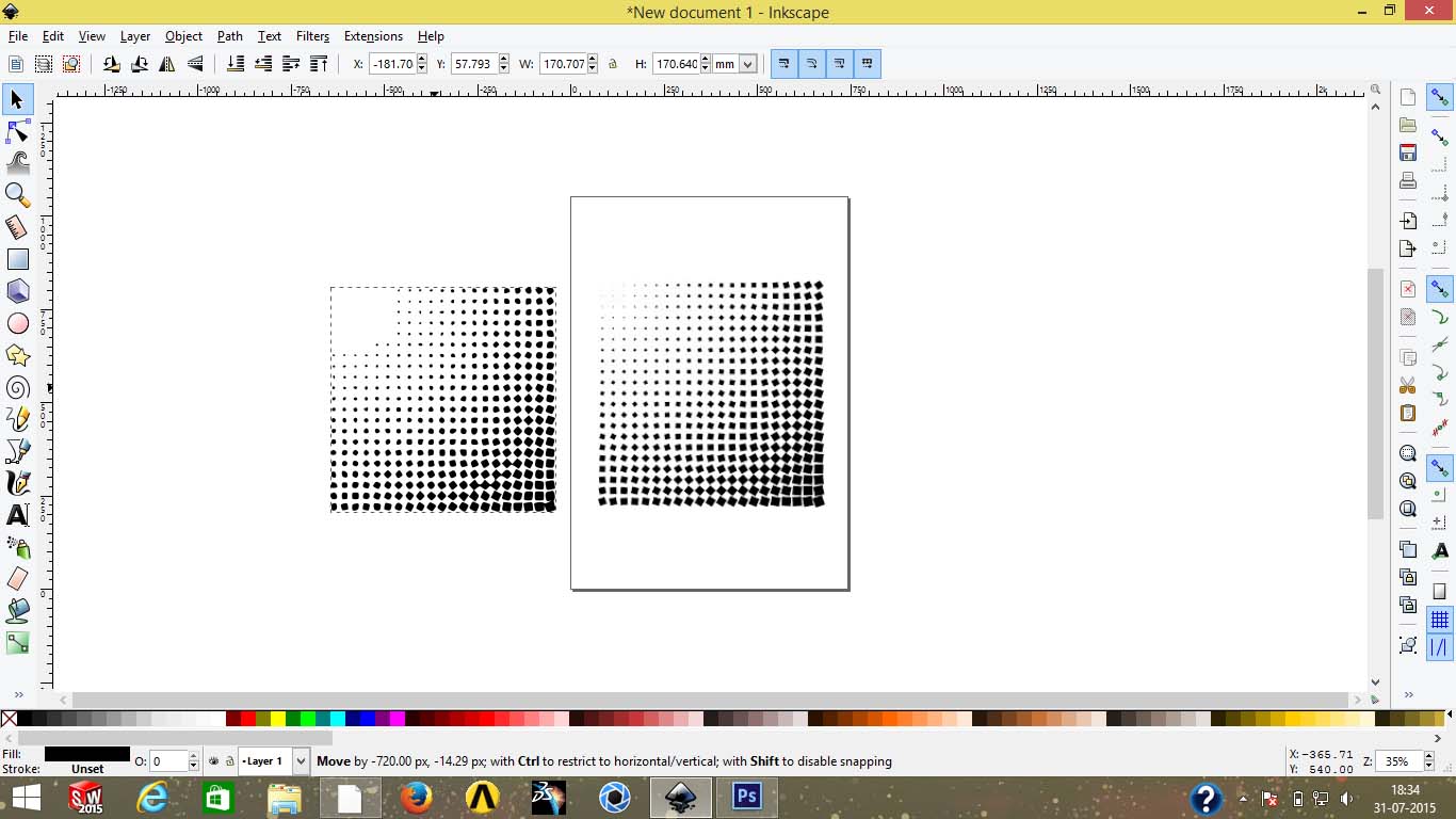

    Go to Path > Trace Bitmap. In the menu, select the brightness cutoff. you may adjust the threshold here. then just place ok and close the menu.
  5. Step 5:
    Now just drag the image outside. you may see there are two of the pics now. one which we just dragged out is vector image.

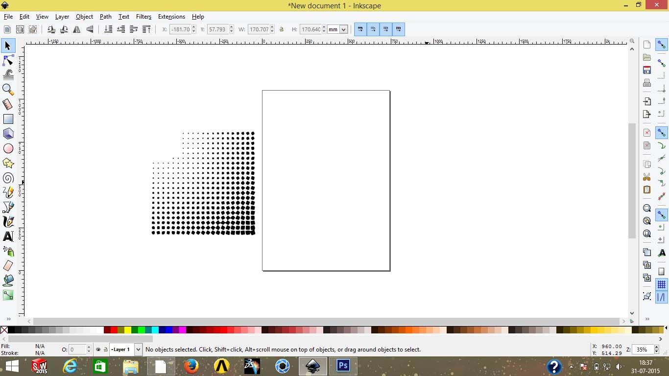

  6. Step 6:
    Delete the other image. adjust the vector image accordingly.

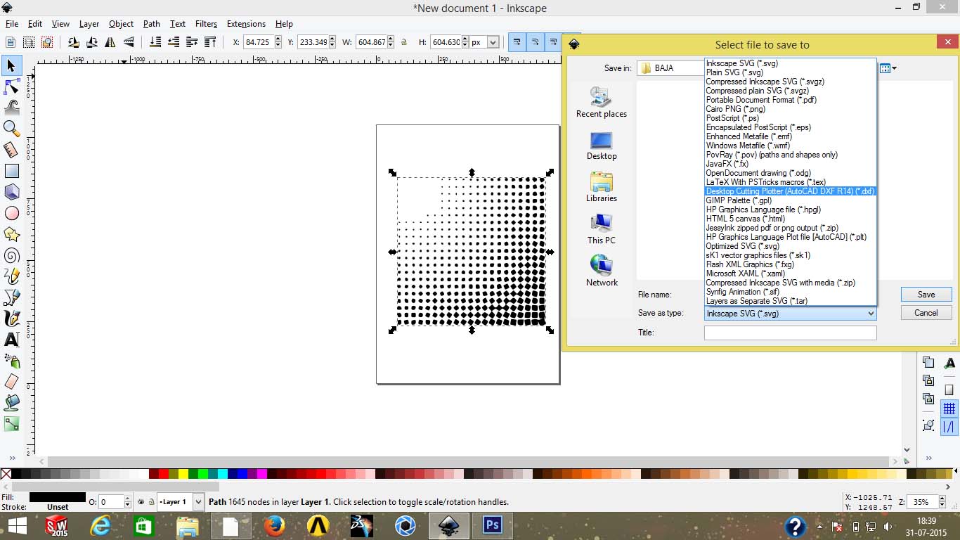

  7. Step 7:
    Now save file in dxf format. Don't change any setting in next dialog box. Just click ok and that's it
  8. Step 8:

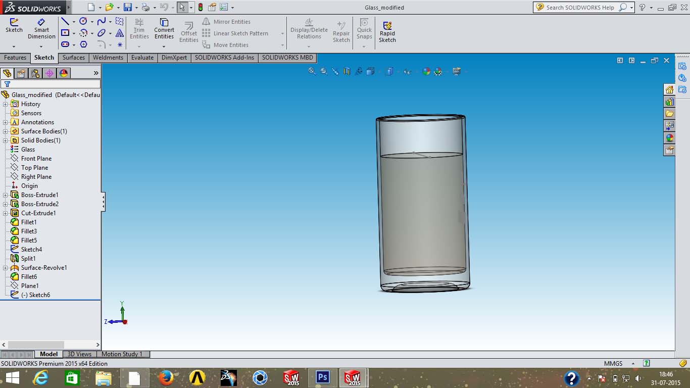

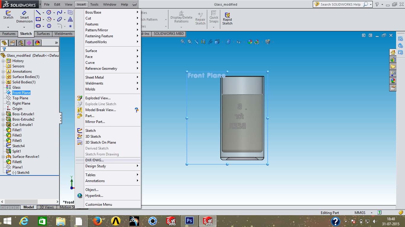

    Open your 3d model in solidworks.
  9. Step 9:

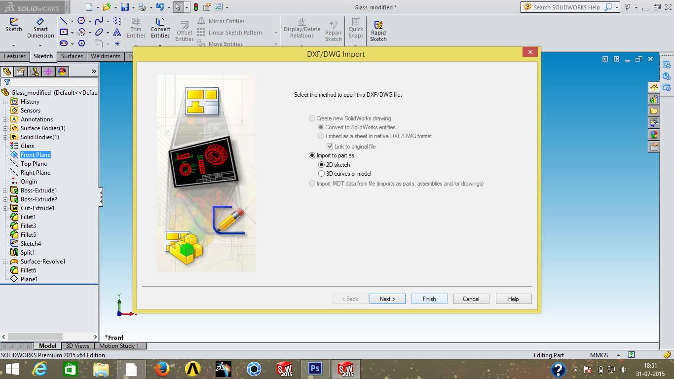

    select a plane you want that sketch on and go to Insert > DXF/DWG and insert the saved vector file from its location.
  10. Step 10:
    Import it as a 2d sketch and click on finish.

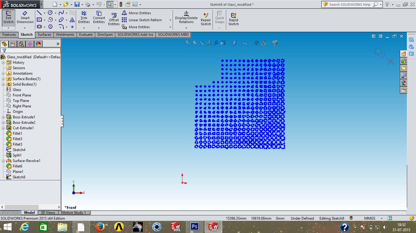

  11. Step 11:
    You may see the sketch now. although it may require some scaling and moving.
  12. Step 12:
    after adjusting its size you may use any required feature you want to use like extrude boss up to a surface or extrude cut offset a surface etc.
