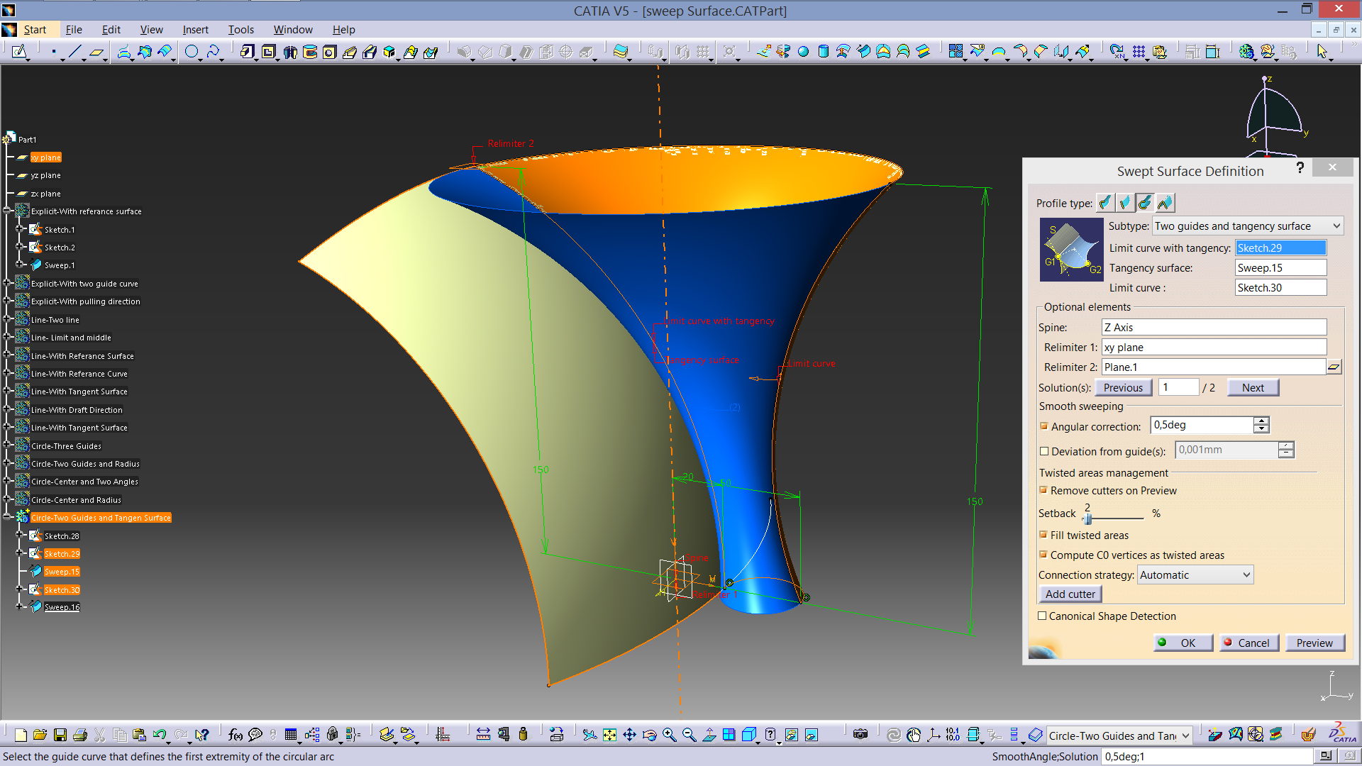

detail explanation of sweep surfacing command ..........all types explane plz....
Here is the all sweep surfacing commands with images in CatPart created. :)

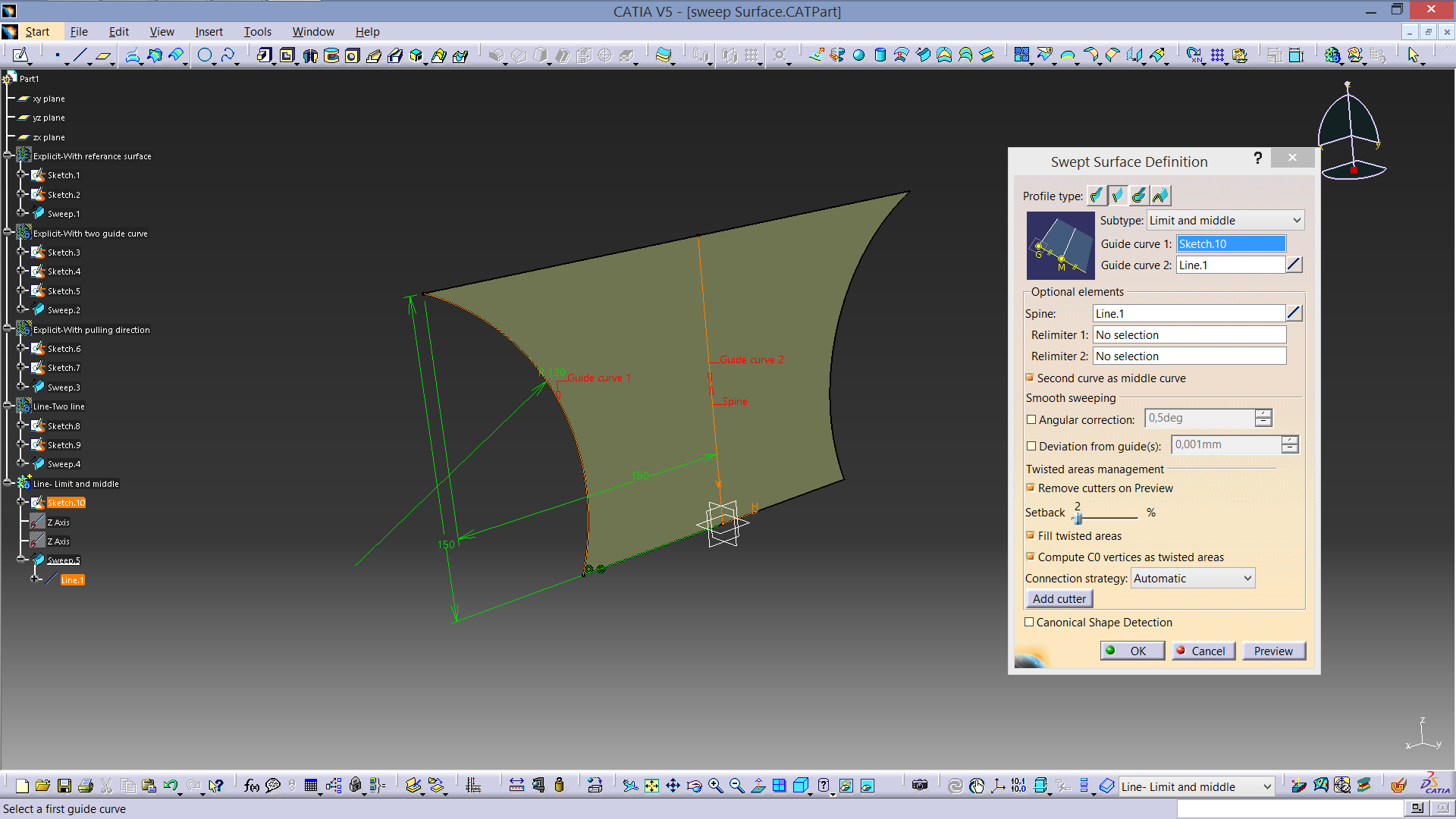

Line-Two line
Step 5:
Line- Limit and middle
Step 6:

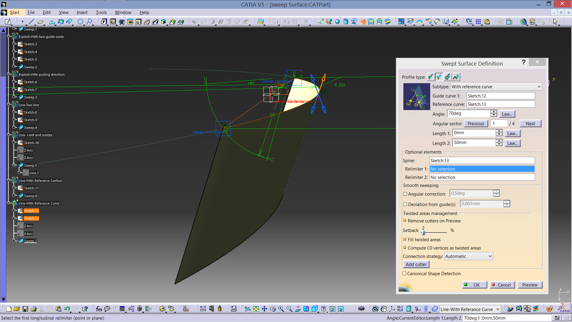

Line-With Referance Surface
Step 7:
Line-With Referance Curve
Step 8:

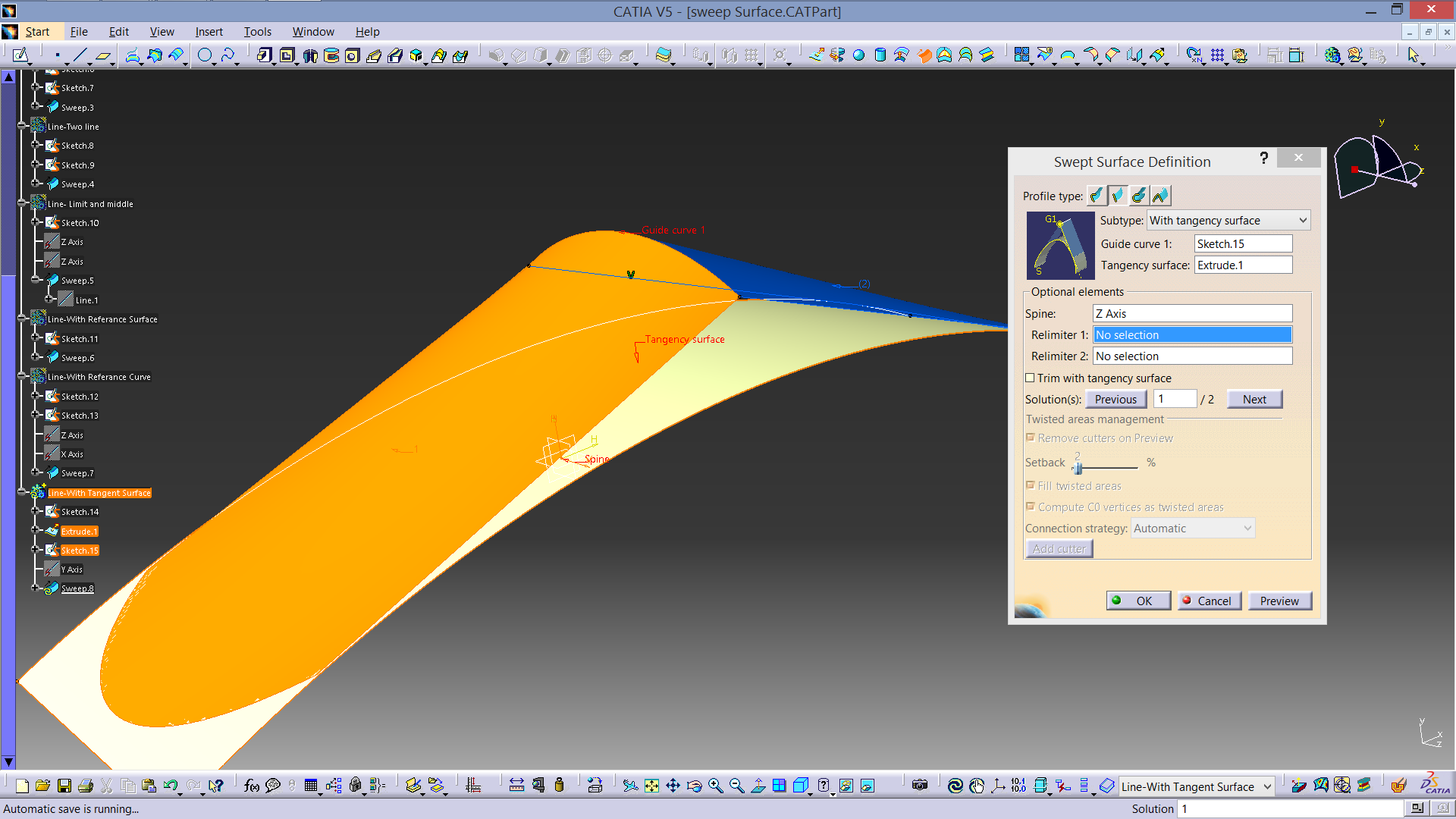

Line-With Tangent Surface

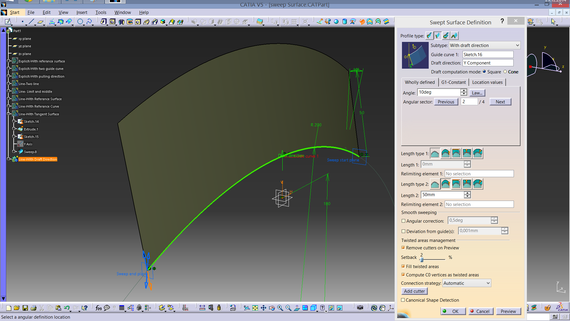

Step 9:
Line-With Draft Direction

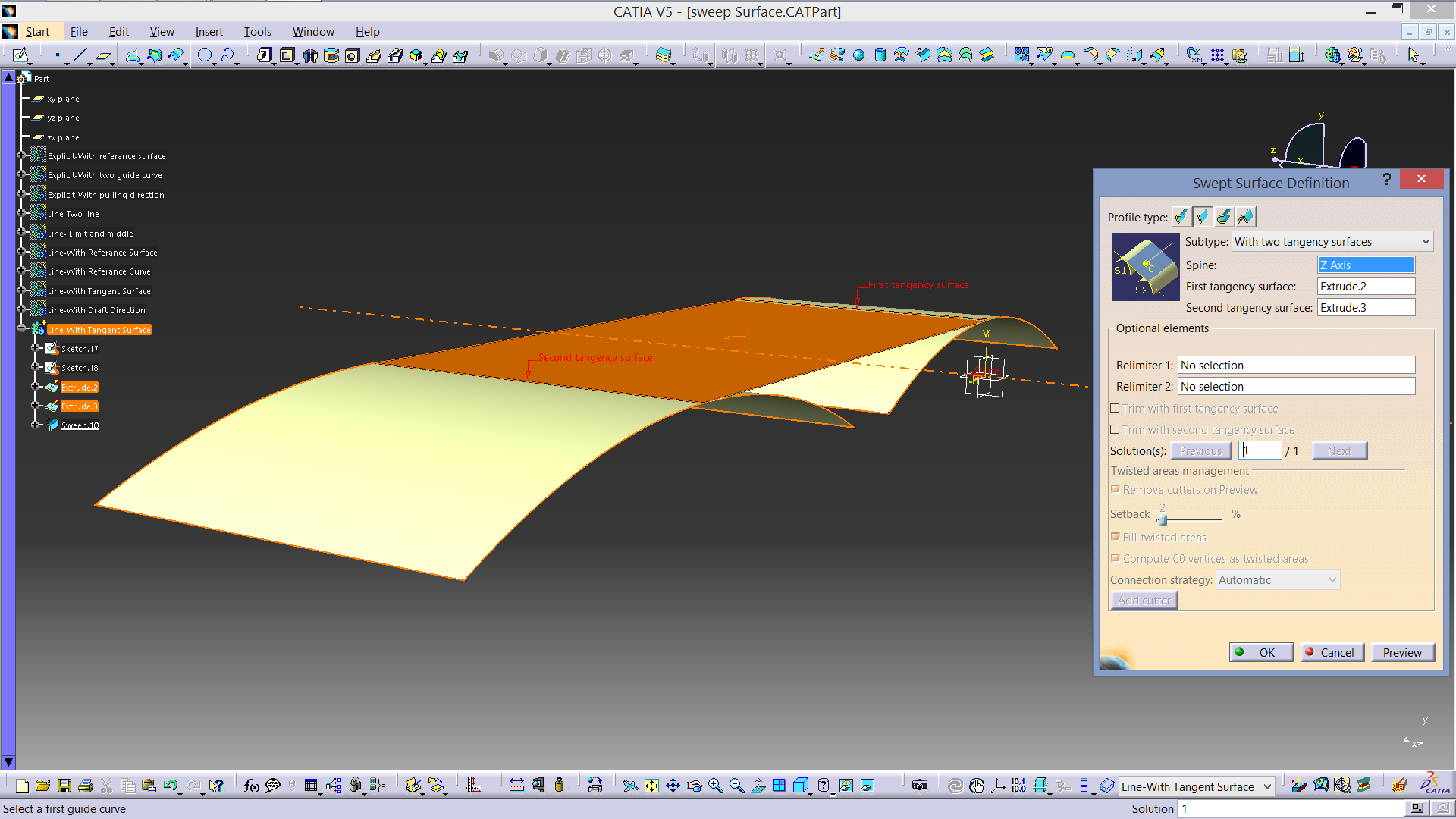

Step 10:
Step 11:

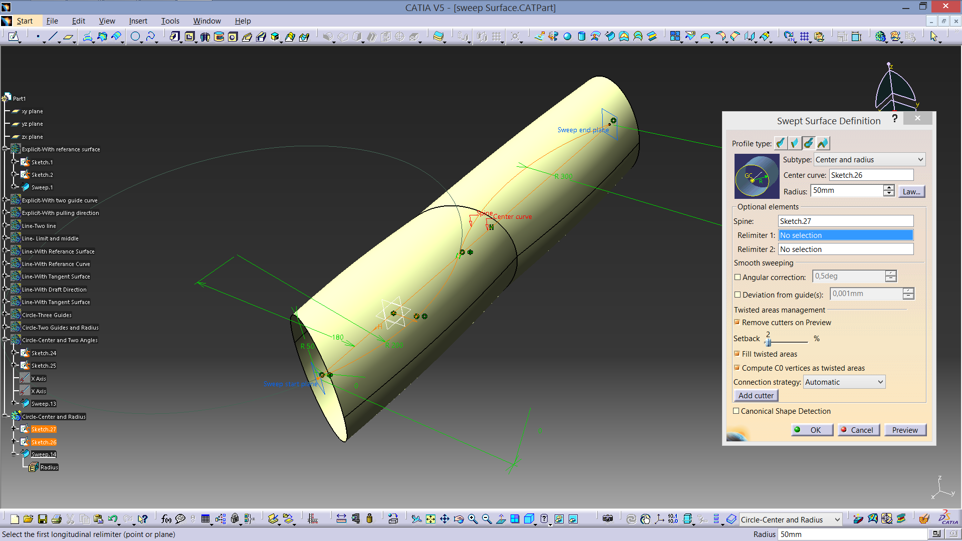

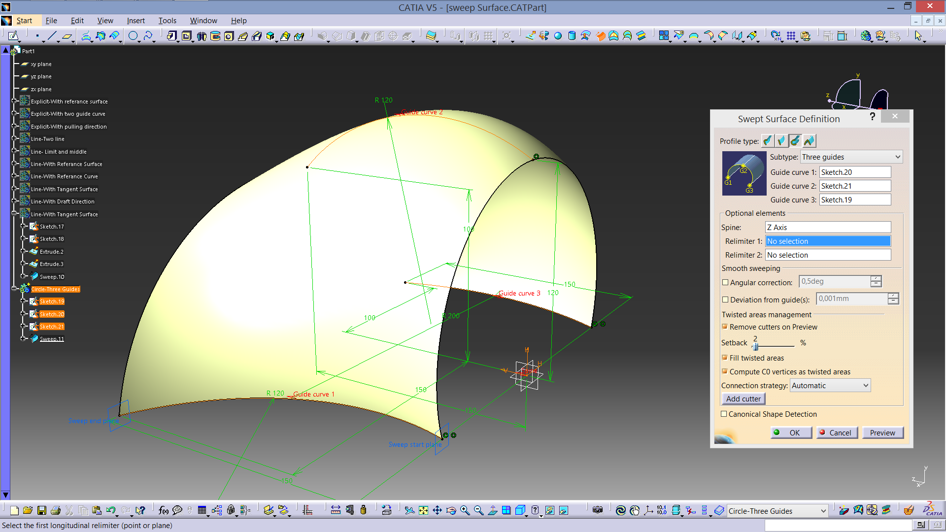

Circle-Three Guides

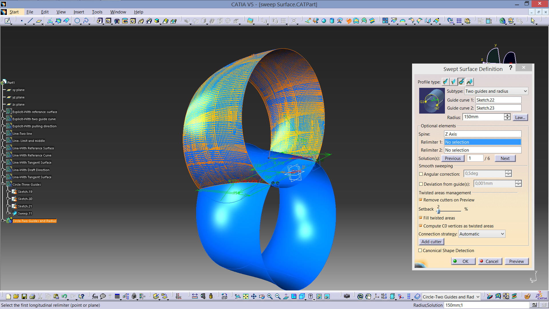

Step 12:
Circle-Two Guides and Radius
Step 13:

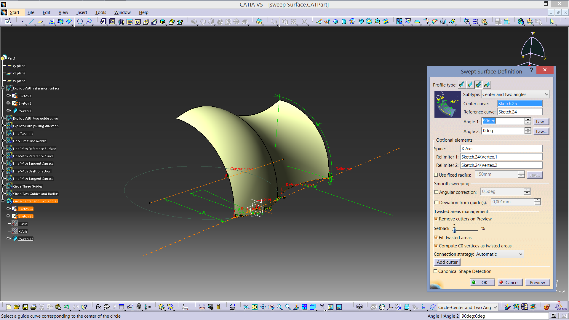

Circle-Center and Two Angles
Step 14:
Circle-Center and Radius
Step 15:

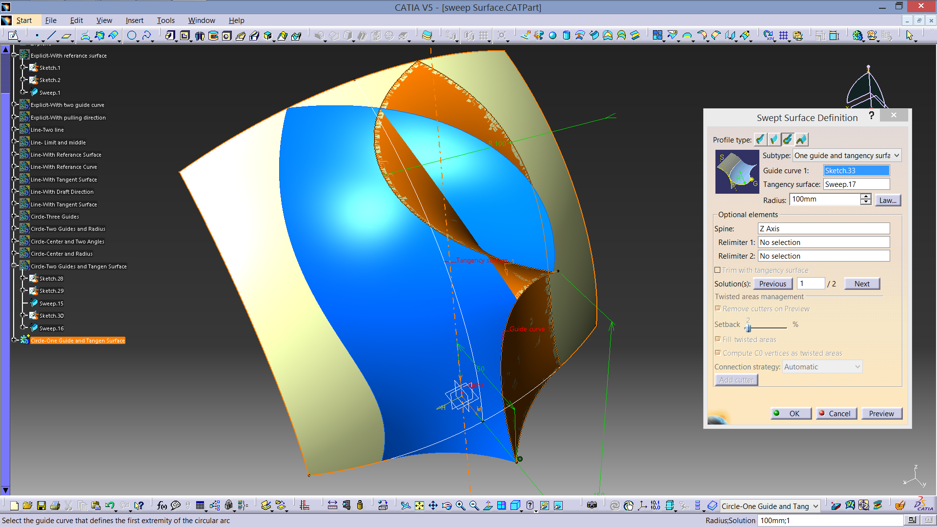

Step 16:
Circle-One Guide and Tangen Surface

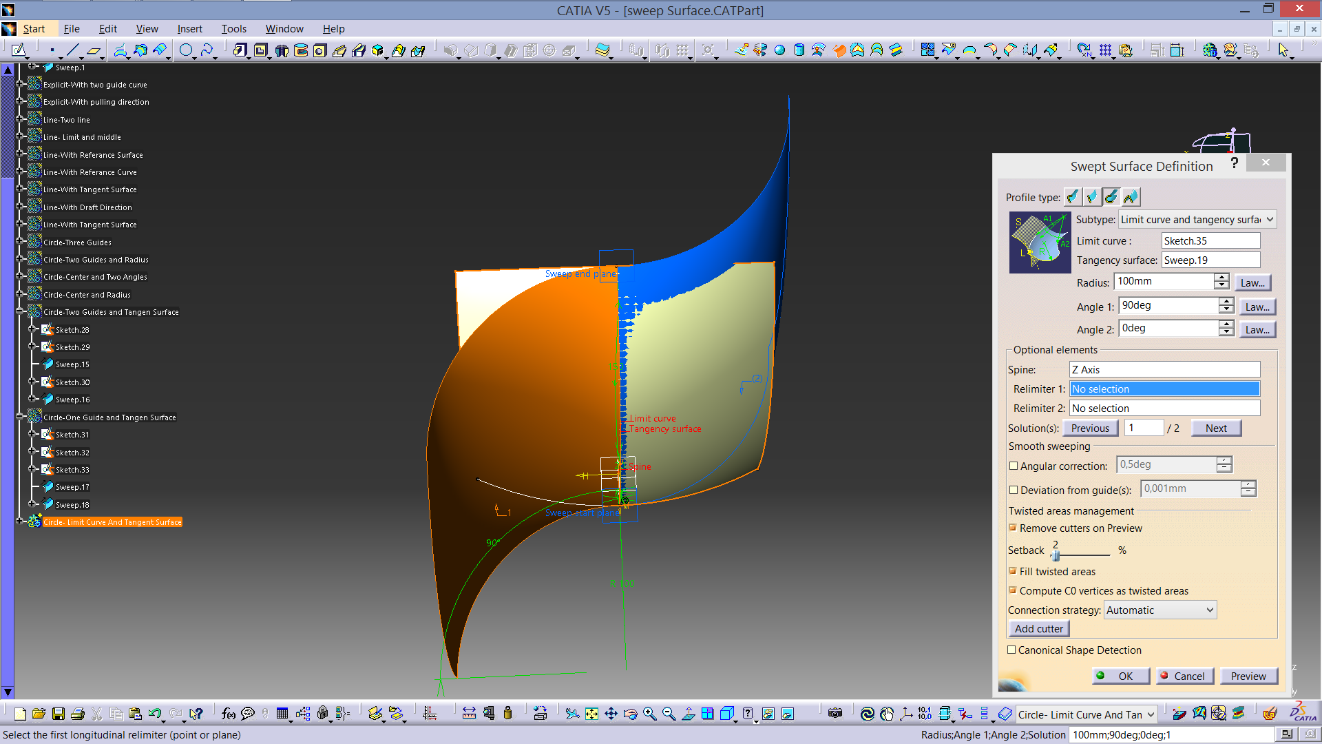

Step 17:
Circle- Limit Curve And Tangent Surface
Step 18:
Conic-Two Guide Curves
