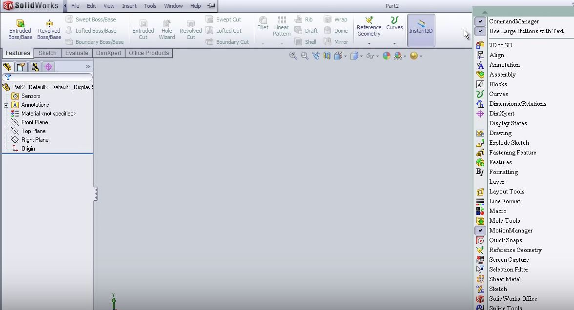

Step 3:
From there, you’ll need to access your extrude tool. To do this, access your surfaces toolbox by right clicking on the toolbar at the top of your screen. A menu will drop down (pictured below). Select “Surfaces” and the surfaces toolbox will appear on the left hand side of your screen. From this toolbox, select the “extrude” tool.

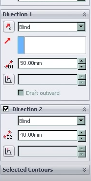

Step 4:
To change how far the sketch extrudes from either side of your original line, you can change the dimensions (in the picture below, the dimensions are 20.00mm).
Step 5:
This can be done for both sides of the sketch (Direction 1, Direction 2)
Step 6:
Once you are finished selecting the distance each side of your sketch will extrude, click the green check on the right hand of the screen to finalize your sketch.
