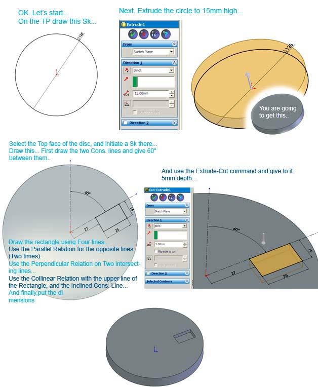

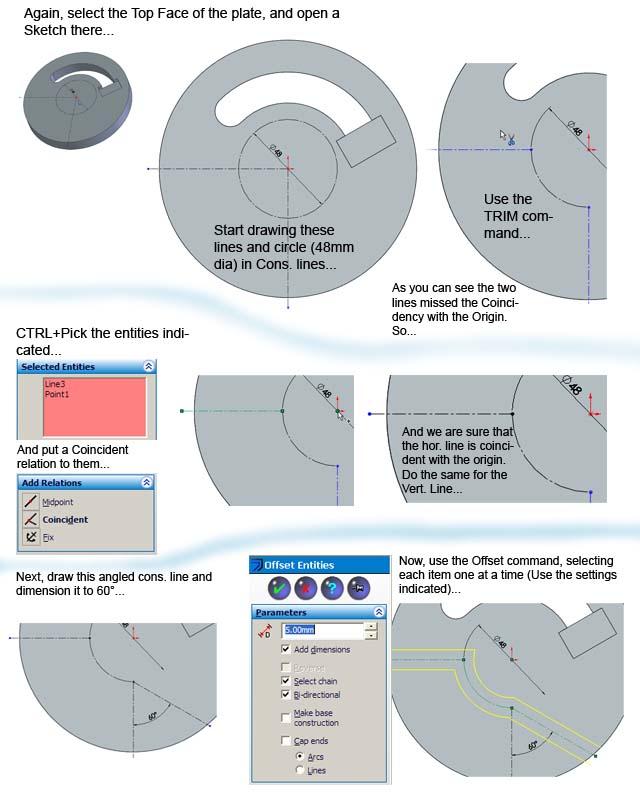

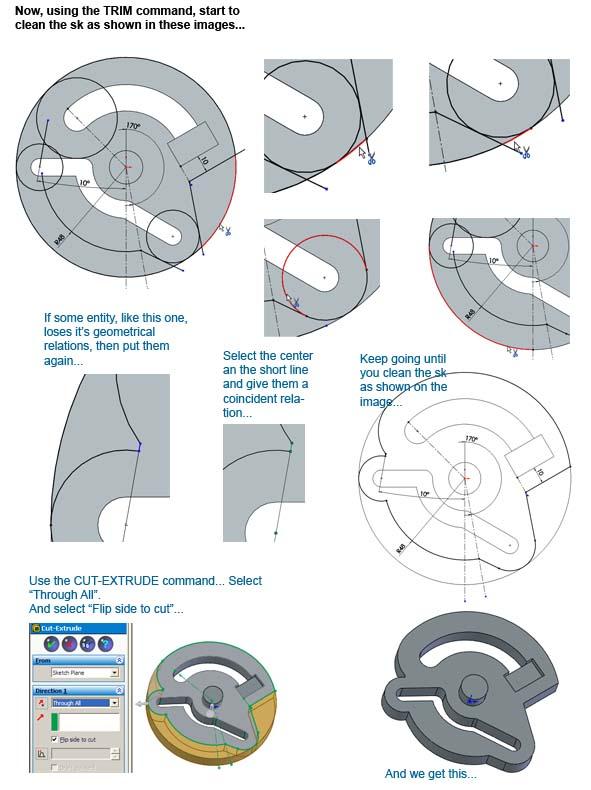

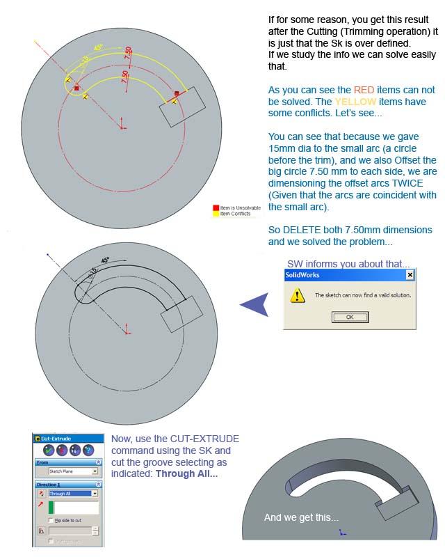

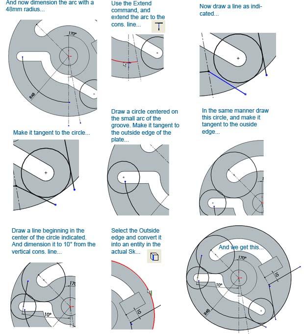

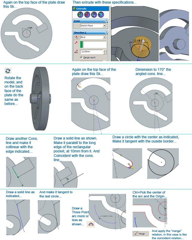

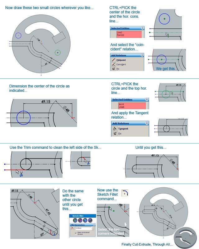

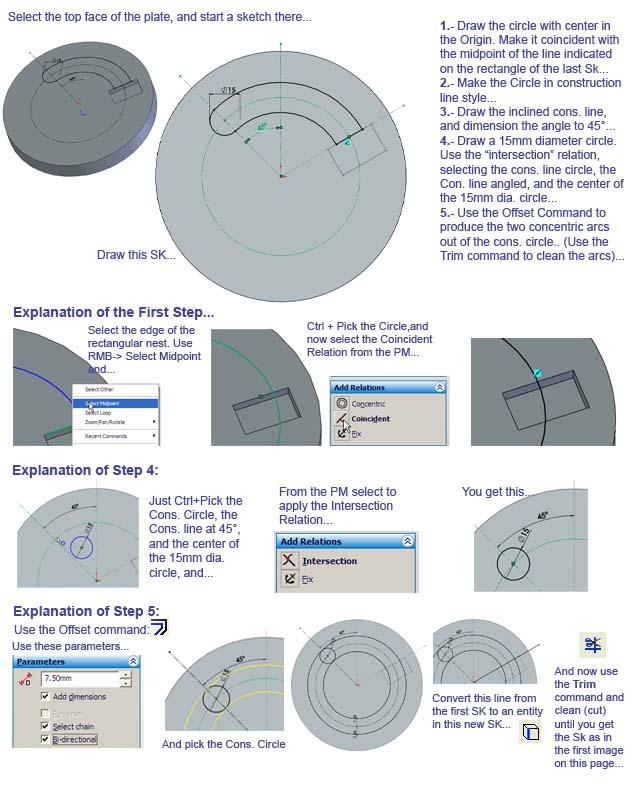

Grooved Plate Exercise
Beginners exercise from Our SolidWorks Mini Course.
You can download the Course here:
SW MiniCourse
  1. Step 1: Main Target...
  2. Step 2: Initial Sketches...
  3. Step 3:
  4. Step 4: If you get some Errors in your Sk...
  5. Step 5:
  6. Step 6:
  7. Step 7:
  8. Step 8:
  9. Step 9:
  10. Step 10:
