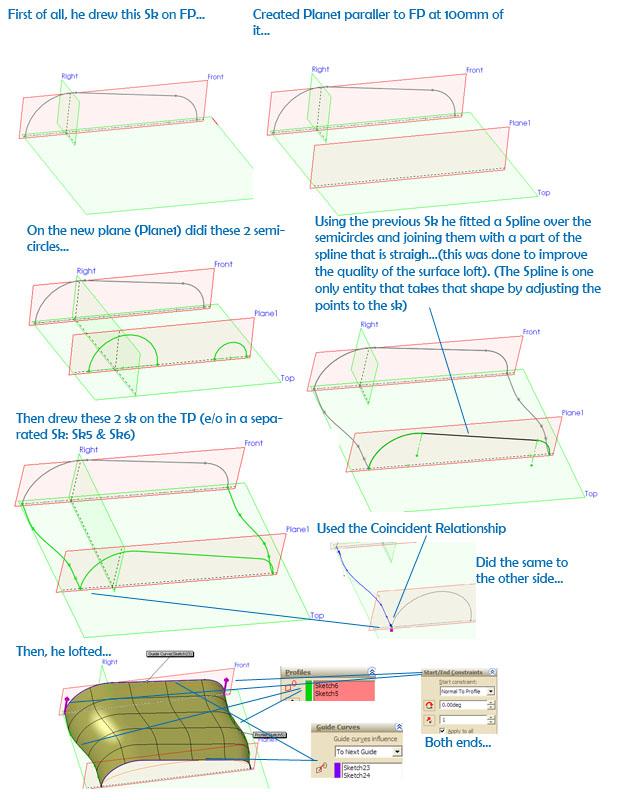

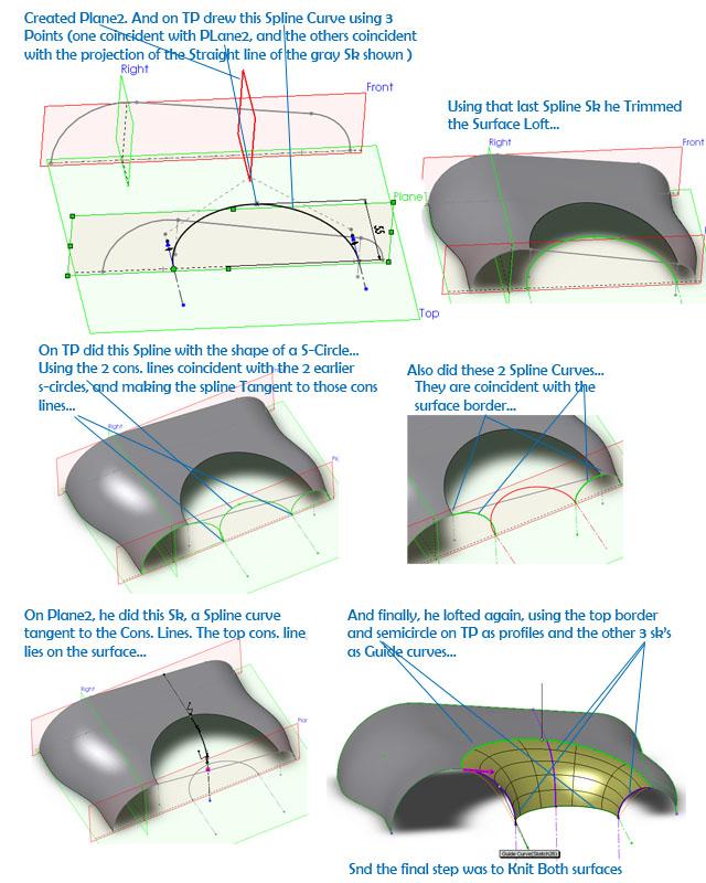

This was something we did to explain to a friend how a designer had made a kind of transitional cover from one mouth to two.
We made these images to help her understand.
I think it will also be useful for many people.
  1. Step 1: The Initial Sketches...
  2. Step 2: Surfacing the Item...
