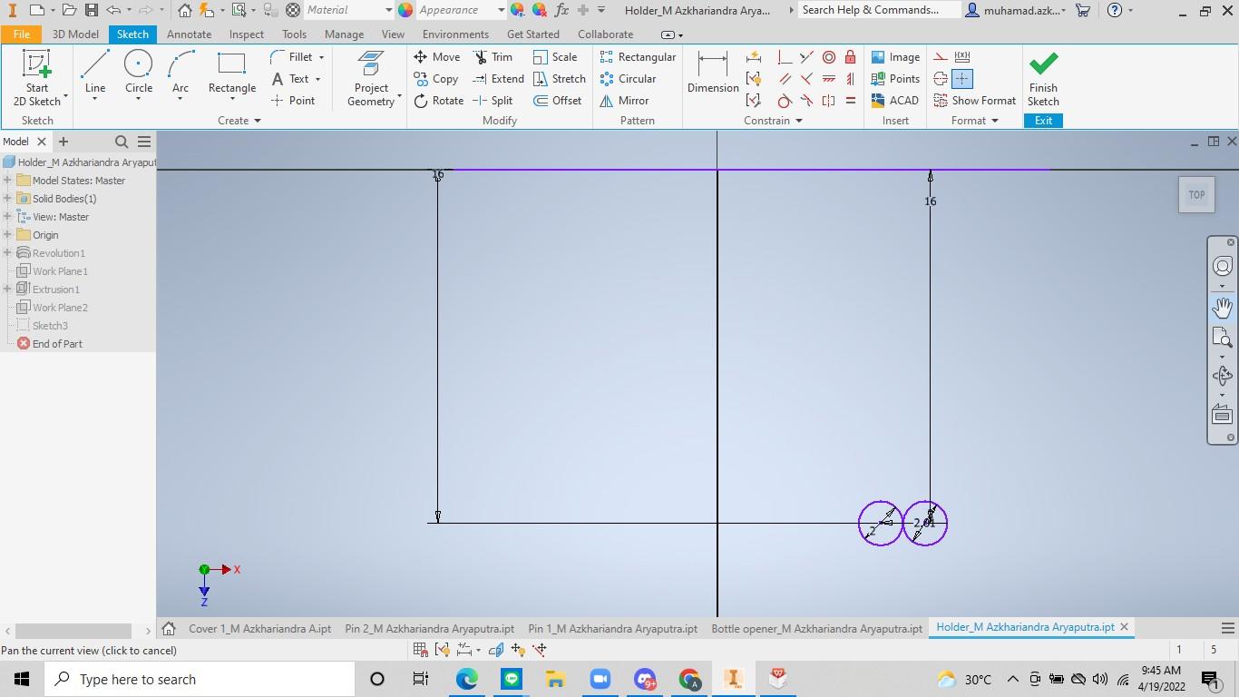

  1. Step 1:
    Make two circle with diameter of 2 mm, and the distance between the circles is 0.01 mm and the distance between the circle to the centre line is 16 mm

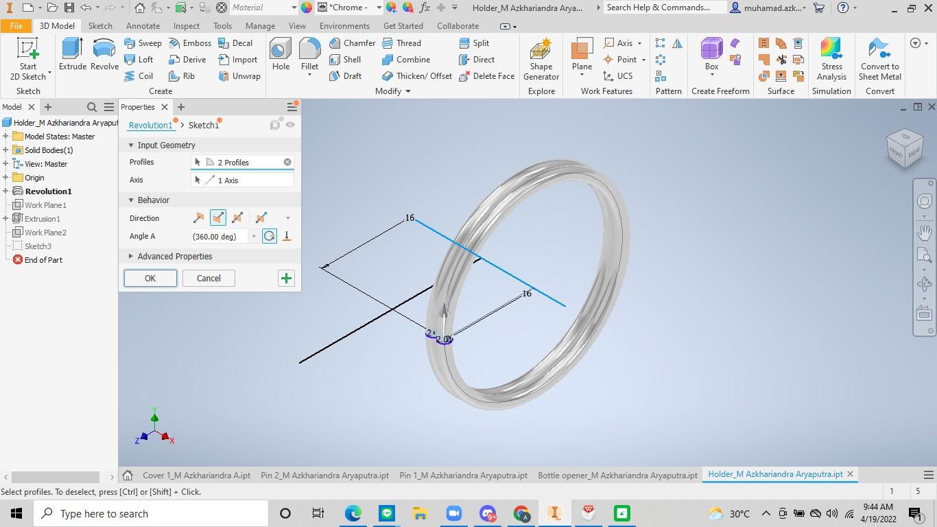

  2. Step 2:
    Revolve the two circle with the angle of 360 degrees

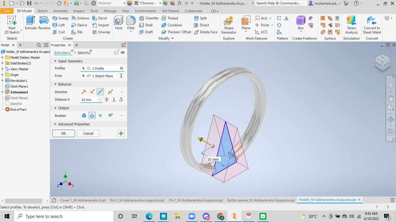

  3. Step 3:
    Make triangle two cut between the holder with distance of 10 mm
