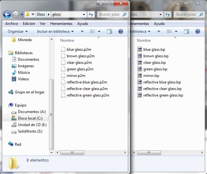

In SolidWorks 2011 Photoworks no longer exists and Photoview replaced it, but all appearances were mixed up, so what you see in SolidWorks are ".p2m" appearances from Photoworks (like the ones i'm sending you) and when you render your file, those .p2m appearances are linked to an equivalent library of appearances but with Luxology's extension ".lxp" something like this:
Step 3:
The way this appearances are linked cannot be changed directly, that's why you cannot add custom appearances to SolidWorks folders and you have to save them in different locations.

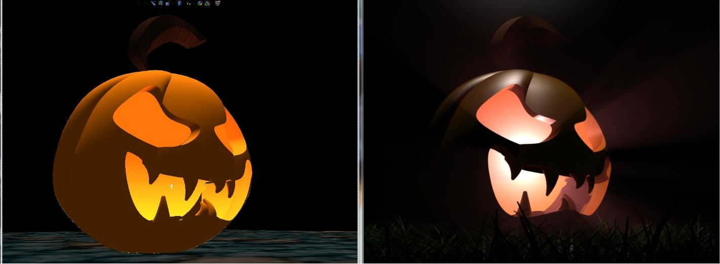

and when you render something like this pumpkin you should see grass instead of an ugly carpet. -

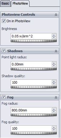

For the lights is just matter of adjusting the setting:

You just need to practice with fog settings, you could see that for this effect the light brightness is tiny in comparison with the fog radius (or fog distance), with a brighter light and the same fog, you get something like this:
