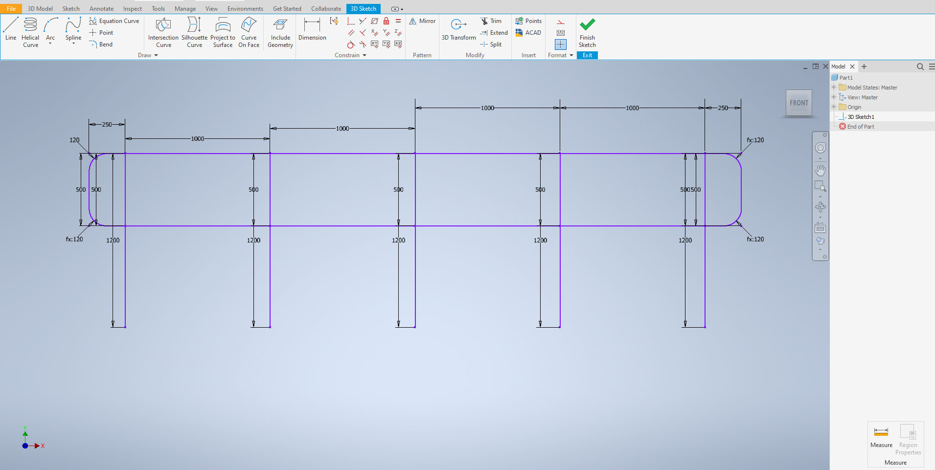

  1. Step 1: Creating a skeleton for frame generator
    We go into the mode of creating a part and make a skeleton through a 3D drawing, for example, take a 4.5 meter barrier with 4 legs, the distance between which we take 1 meter. This distance can be changed, but it makes no sense to take less than 0.5 m.
    Important:
    Height A is fixed and always = 500 mm.
    To draw such a skeleton, turn on the "Ortho mode" function (shown by an arrow in the figure)
    The height of the entire barrier should be between 1100 - 1300 mm
    Rounding corners. This point must be coordinated with production. We do a rounding with a radius of 120.
    Save the drawing as a part and create a new regular assembly.
