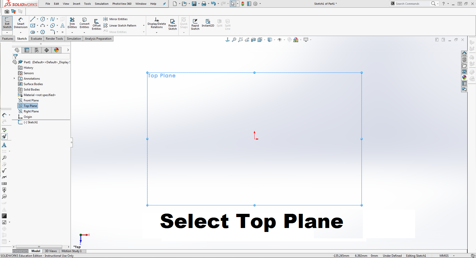

Step 1:
Select Top Plane.

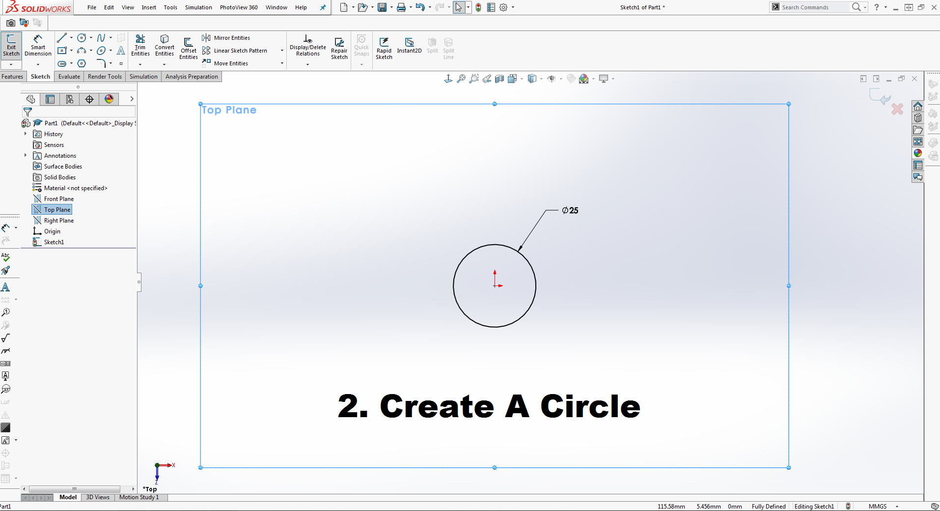

Step 2:
Create a circle.

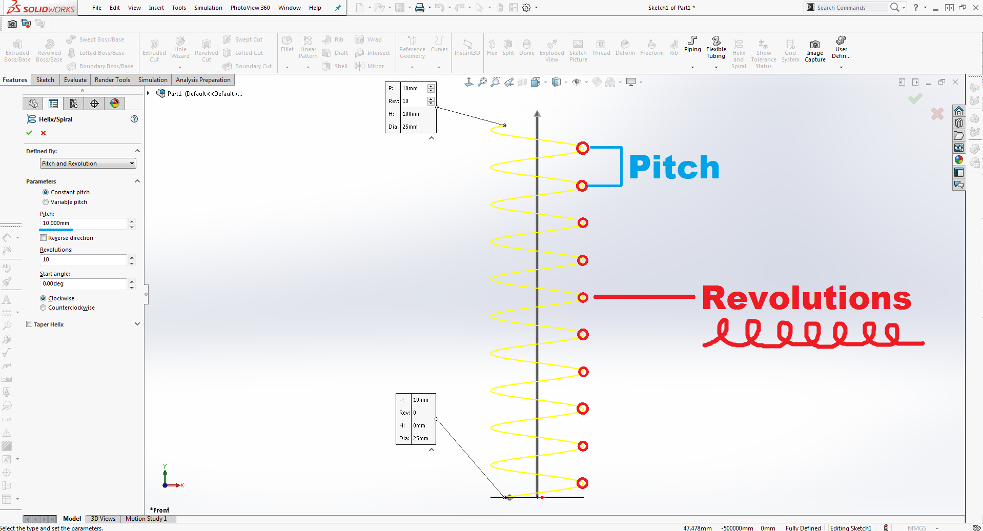

Step 4:
Input the pitch and revolutions, there are different options you can also do if you click on "defined by"

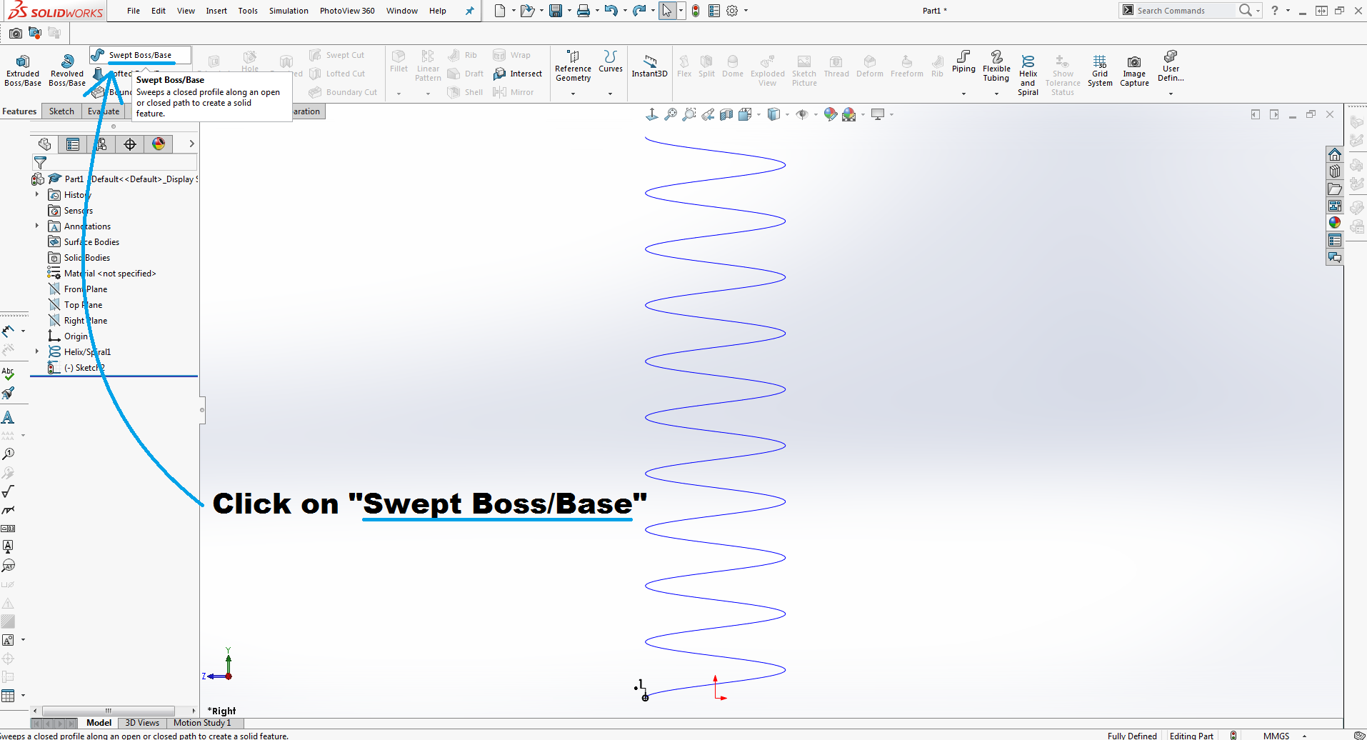

Step 7:
click on "swept boss/base"

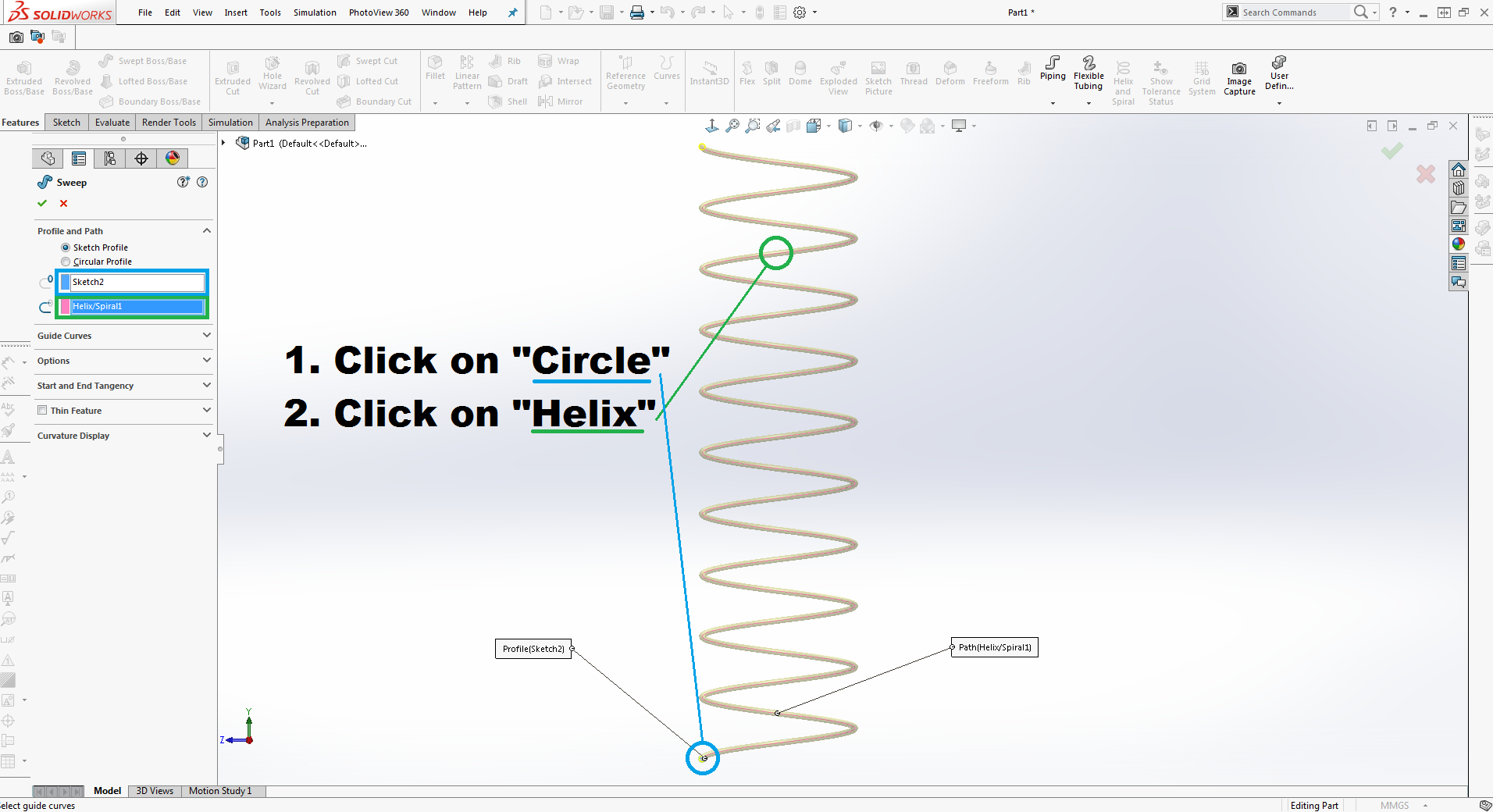

Step 8:
1. Click the "circle"
2. Click the "helix"
Step 9:
