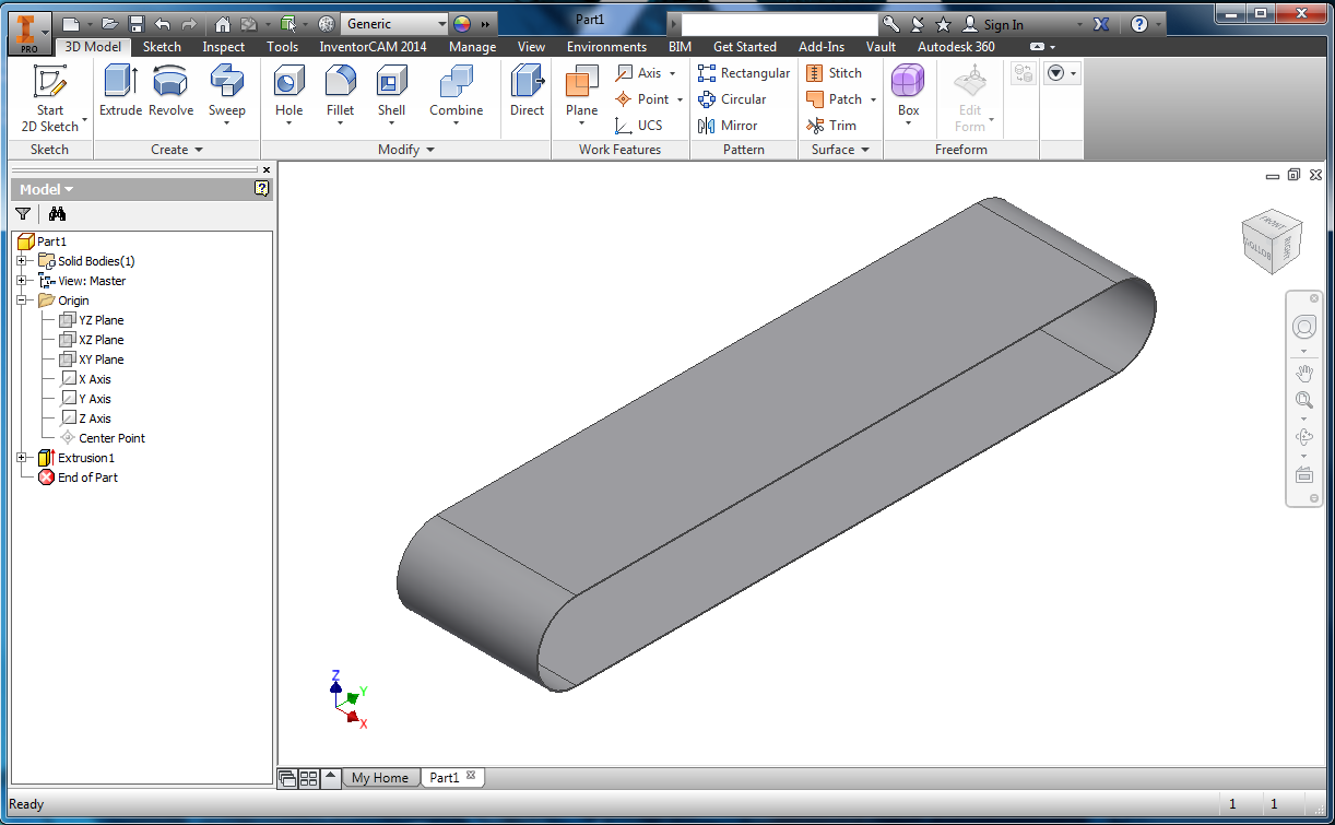

1- Create a new part
Step 2:
2- Create your first sketch
Step 3:
3- Extrude it

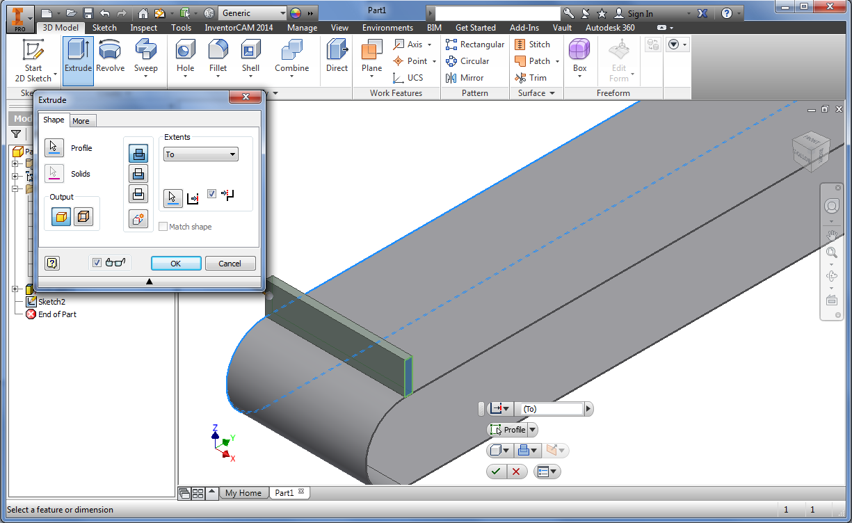

Step 4:
4- Create second sketch
Step 5:
5- Extrude it
Step 6:

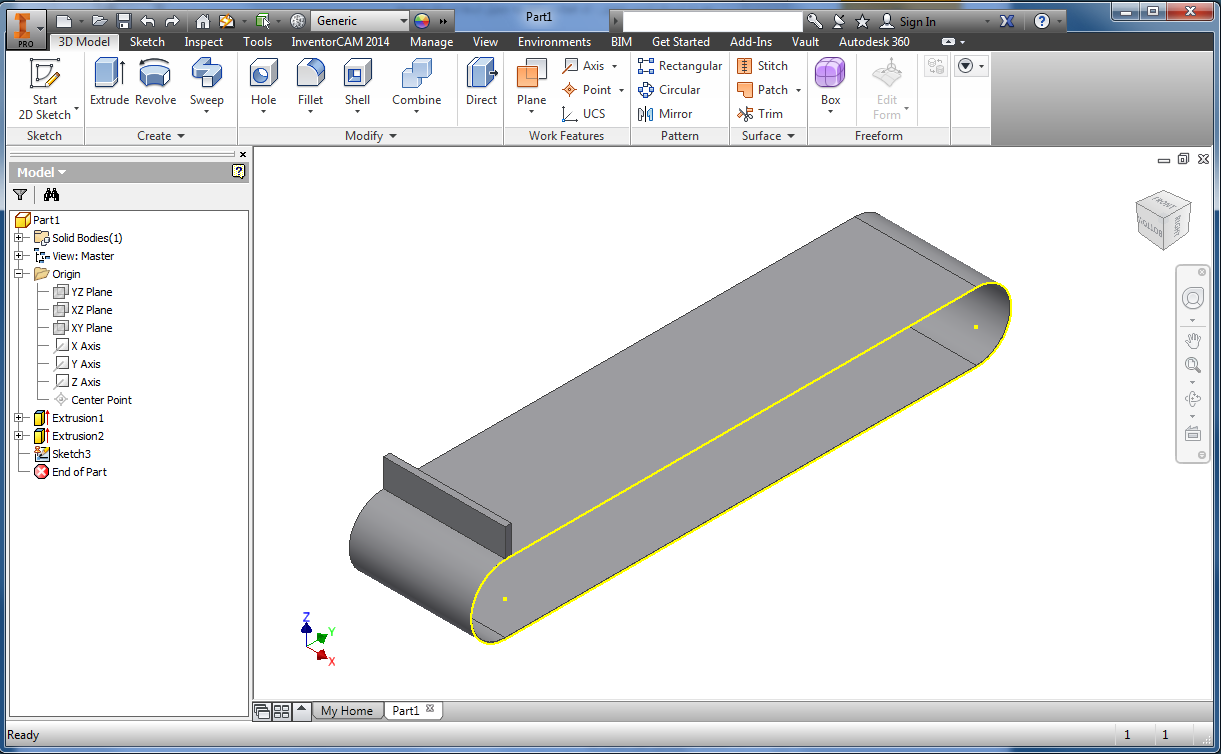

6- Create Third sketch that it only must has a projected curve which we will use it as a path
Step 7:
7- Use rectangular pattern as i show it on the picture.
Step 8:
8- It's done ...
