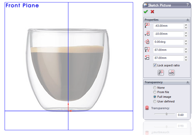

Step 3:
Go to: Tools > Sketch Tools > Sketch Picture
Go to following link
http://gcp.grabcad.com/screenshots/pics/60813/medium.jpg?1327148493Download this image and then select the photo i.e. “medium.jpg”
Click: Open
Change the dimensions and position of the photo with the menu as shown in the picture.
Select ‘’Full image’’ in the Transparency tab and change the transparency into 0.50
Click OK ok How to Model a Bodum Glass in SolidWorks?
Click at the Sketch button in the upper right corner close the 2D Sketch

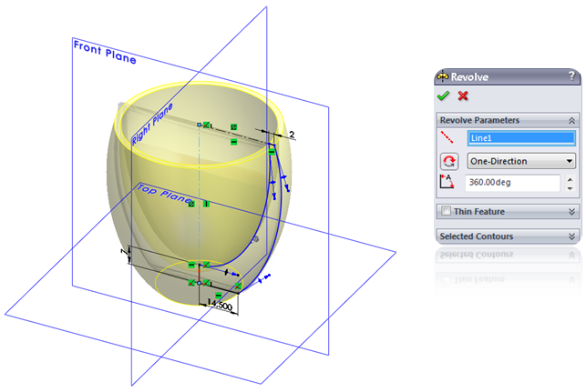

Create a Revolve
Go to Insert > Boss/Base > Revolve or click at the Revolve icon
Click at the vertical Centerline to define the Axis of Revolution Axis of Revolution
Use the One-Direction option
Set the Revolution Angle to 360 degrees
Click OK
