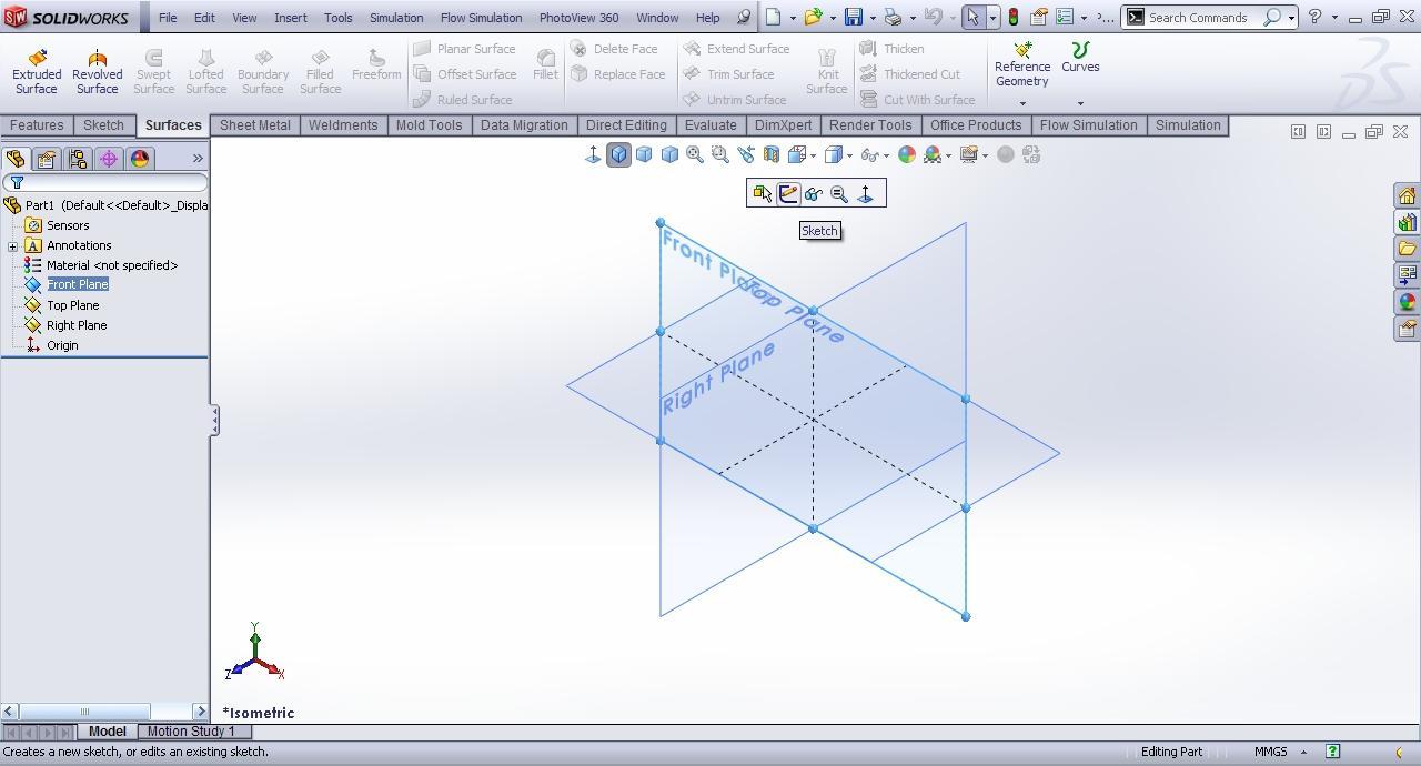

Step 1:
Start Solidworks in Part mode. Select front plane and then sketch.

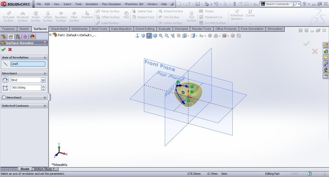

Step 3:
Now select revolve surface under surfaces tab. Revolve the profile along the centre line.

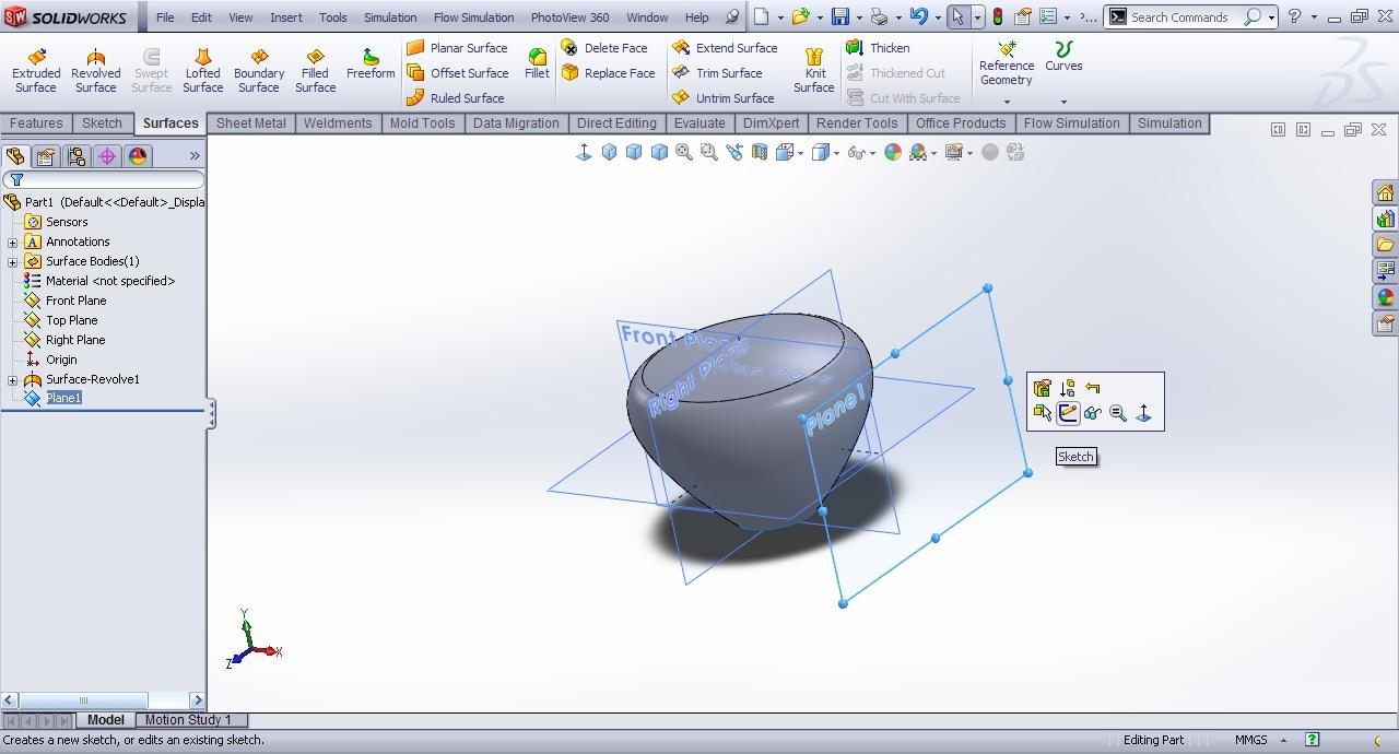

Step 5:
Now select plane1 and then sketch.

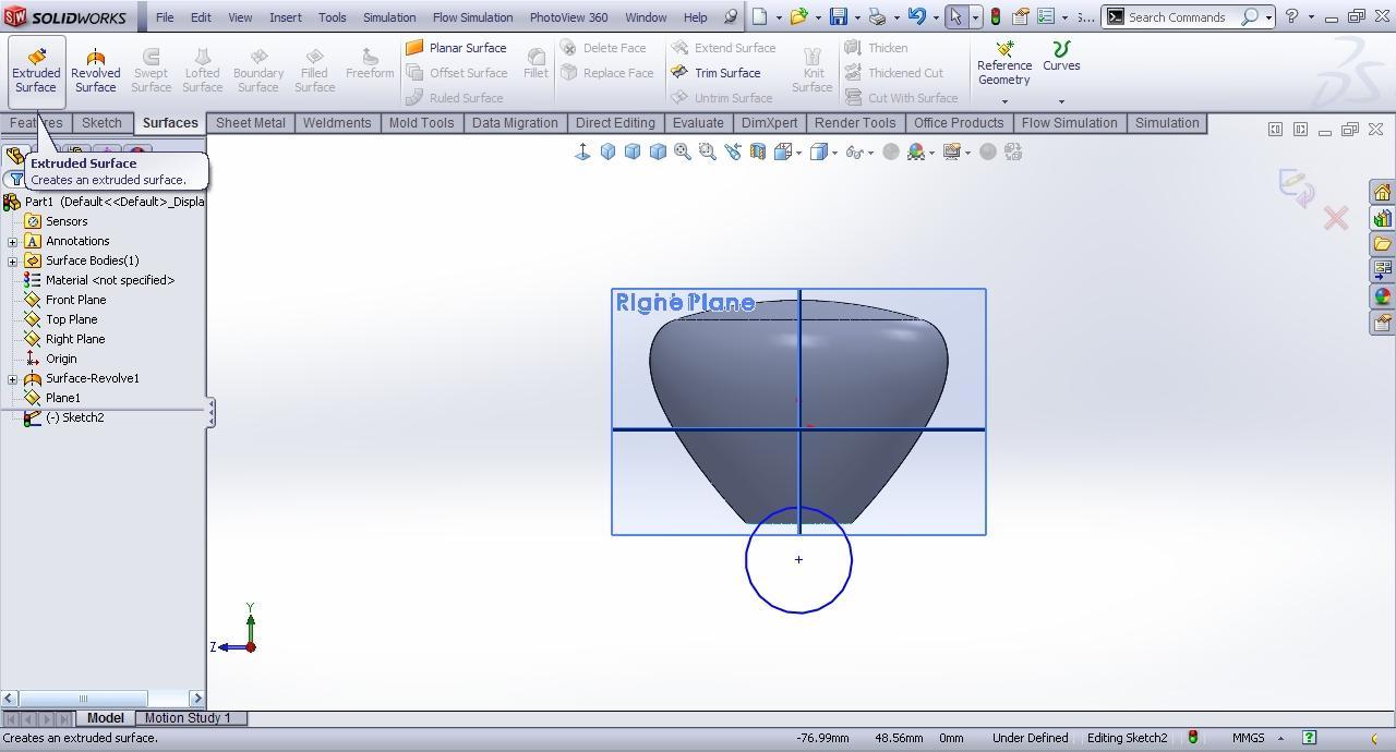

Step 7:
Under sufaces tab click Extruded surface.
Step 8:
Extrude it in both direction with a considerable distance.

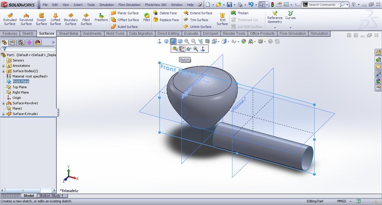

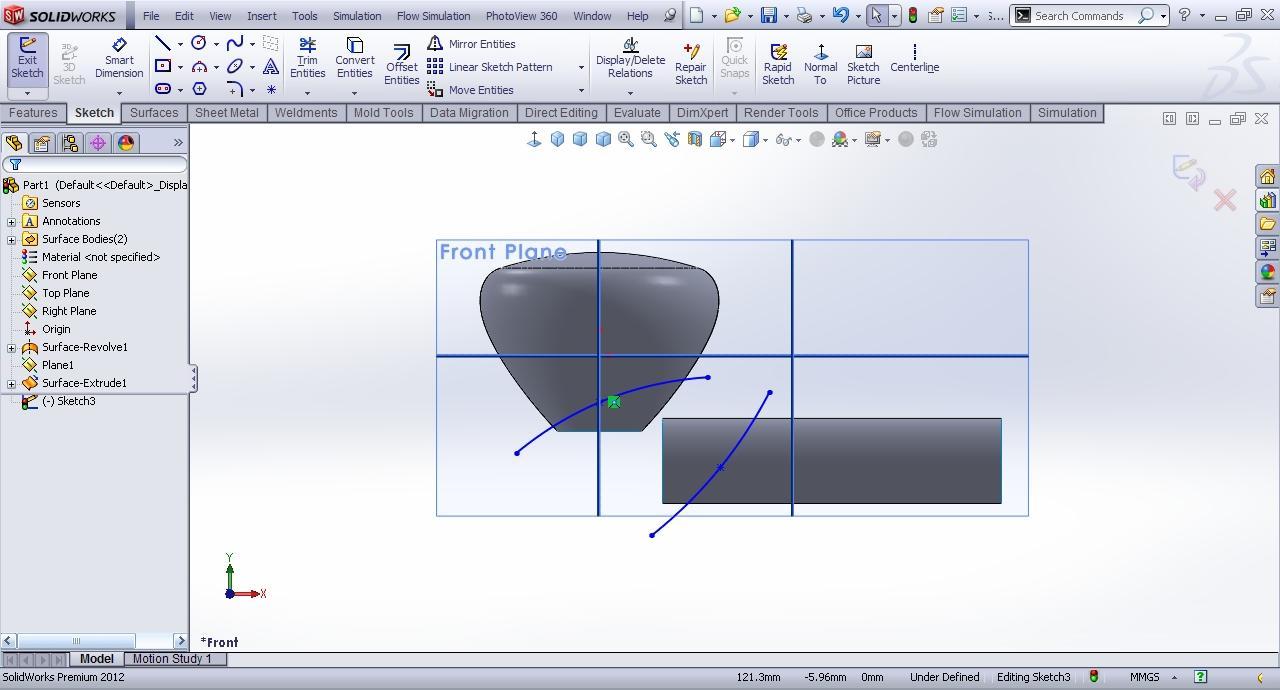

Step 9:

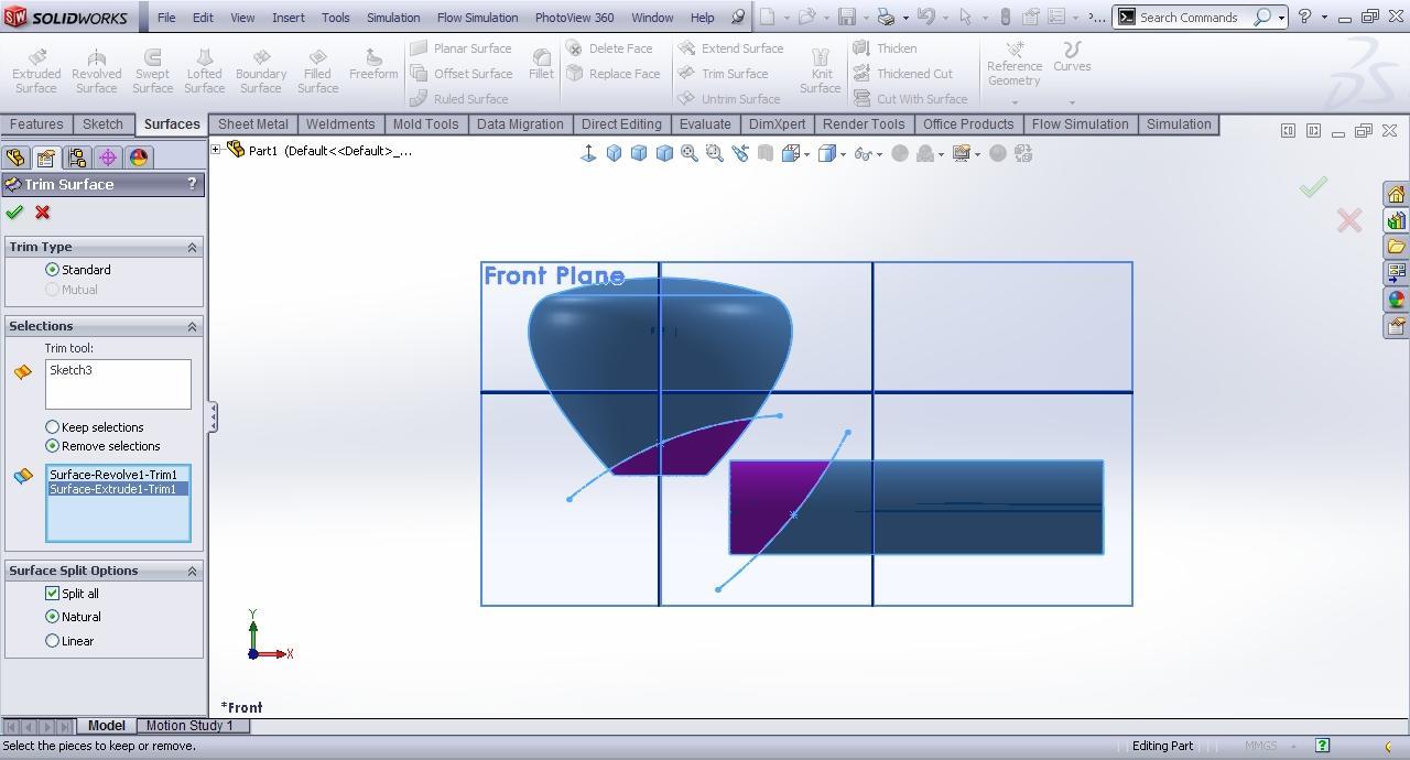

Now select front plane and then sketch.
Step 10:
Draw two spline cutting the surfaces.

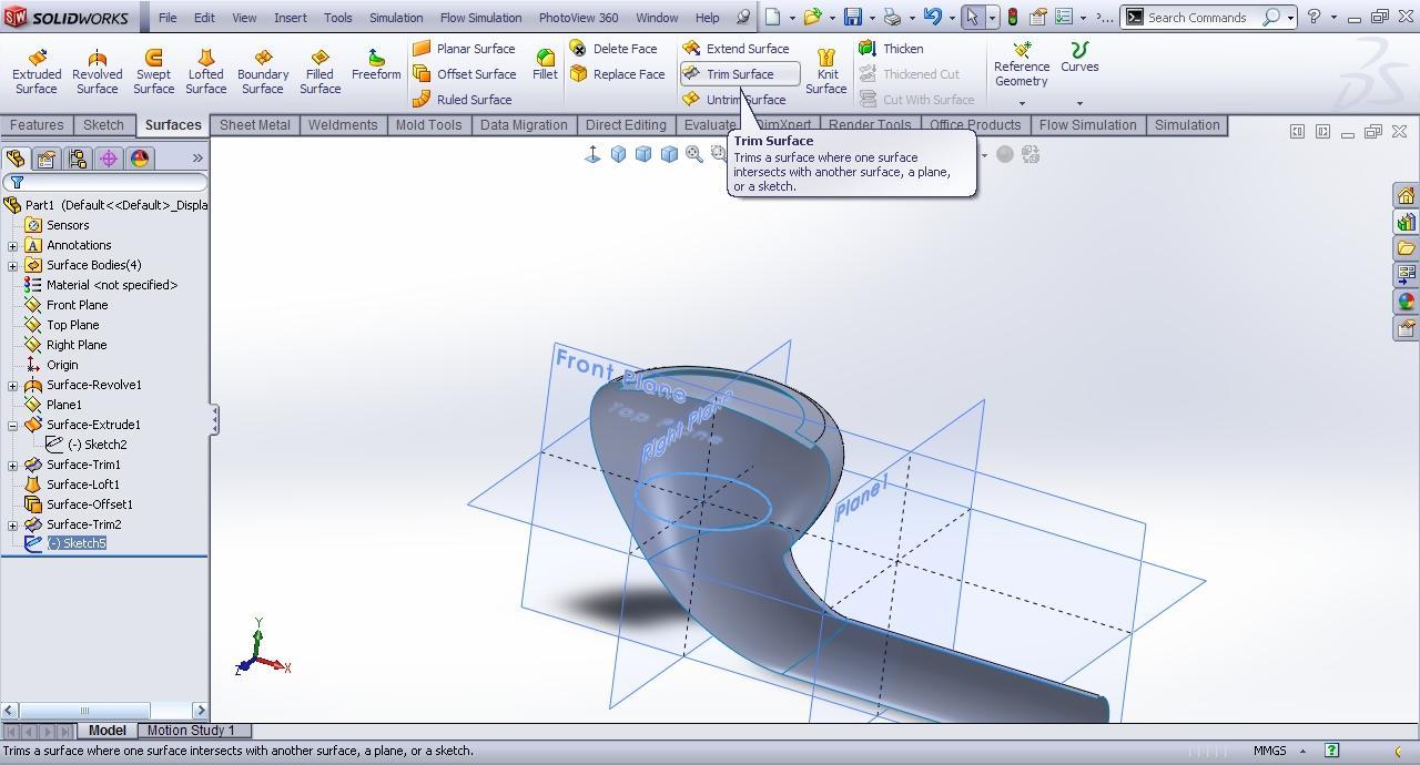

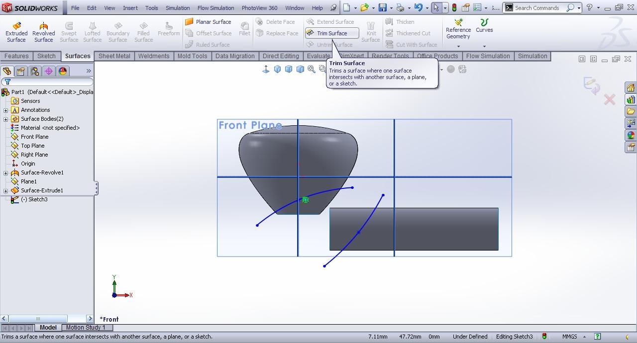

Step 11:
Under surfaces tab select trim surfaces.
Step 12:
Select the surfaces under the splines and remove them.

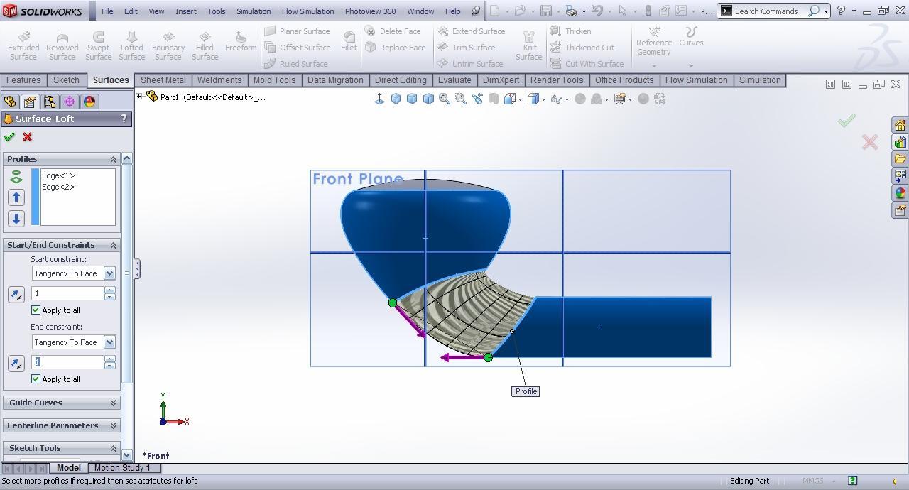

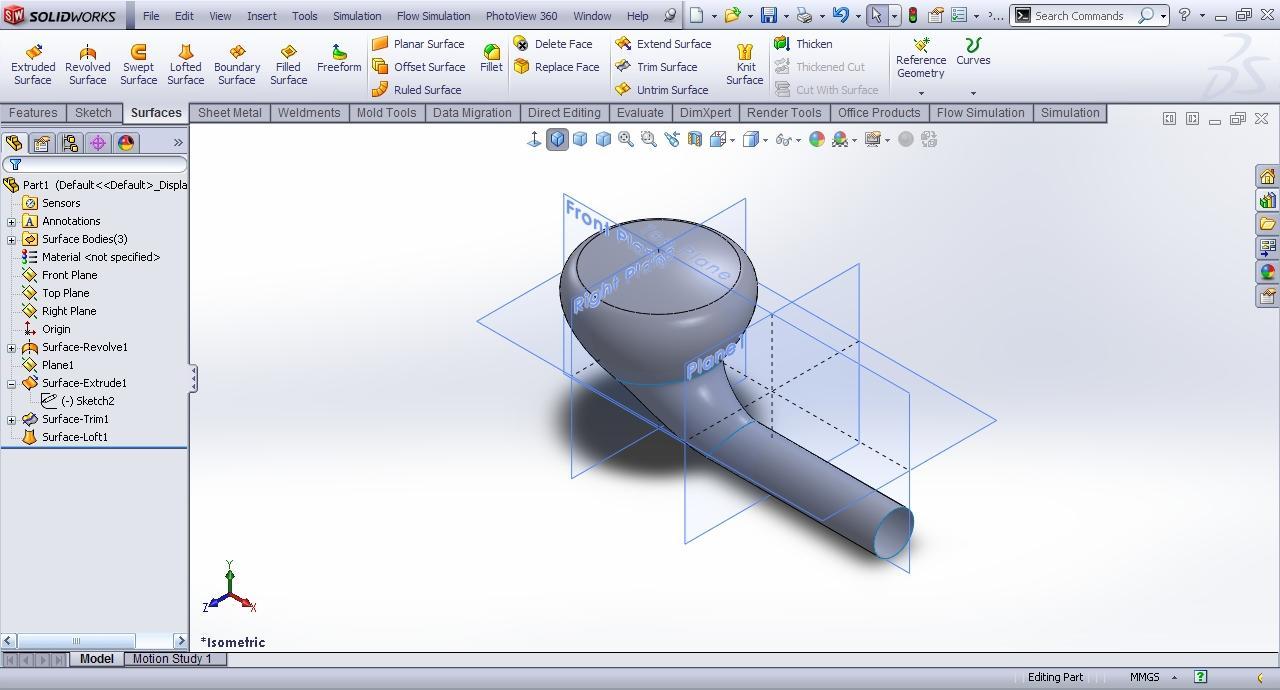

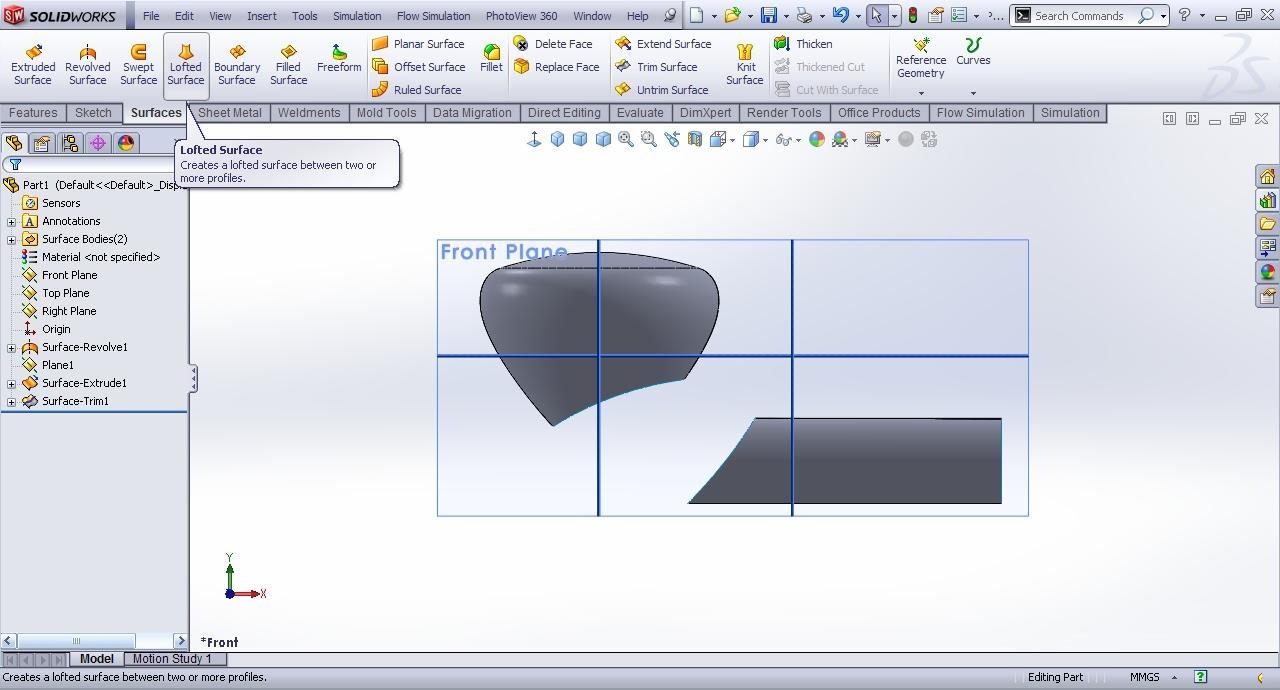

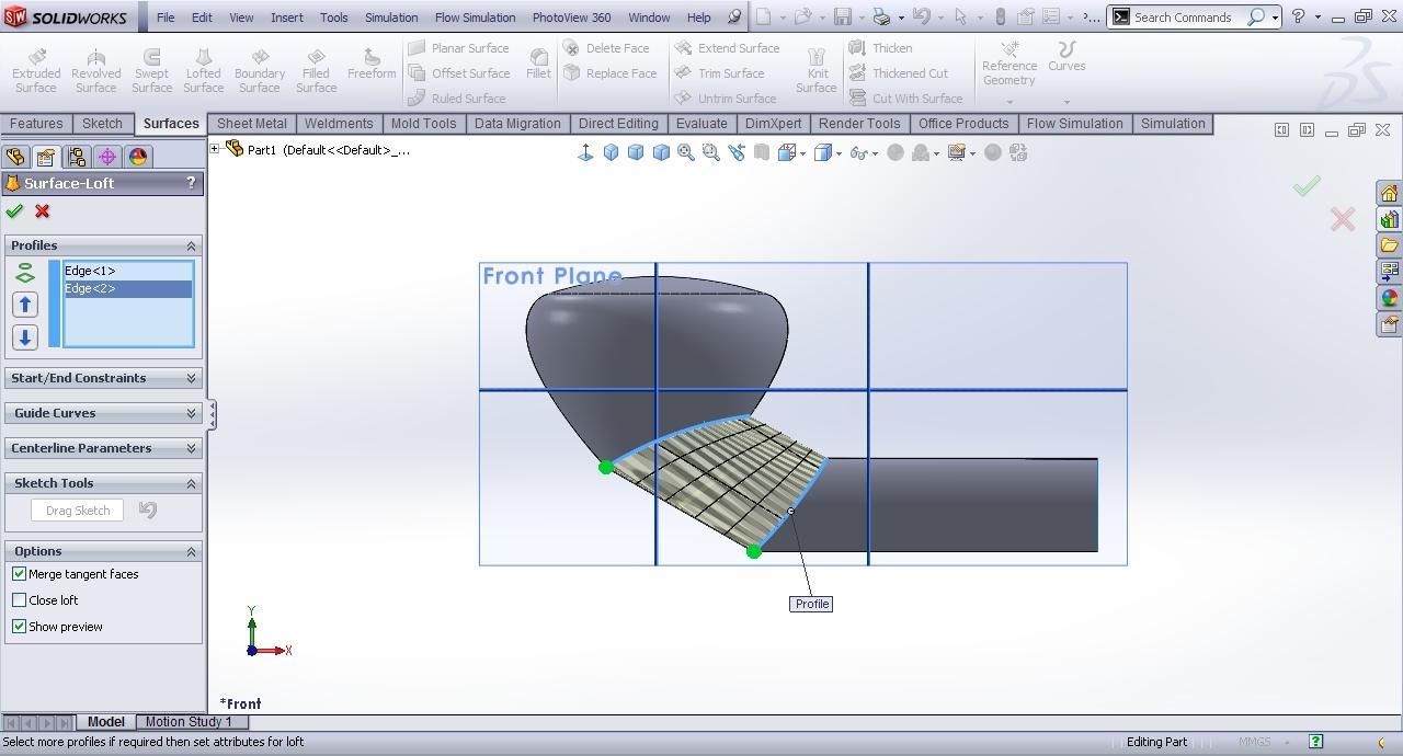

Step 13:
Under surfaces tab select lofted surface.
Step 14:
Select both edges.
Step 15:
Under Start/End constraints change start and end constraint to tangency to face. Click OK.

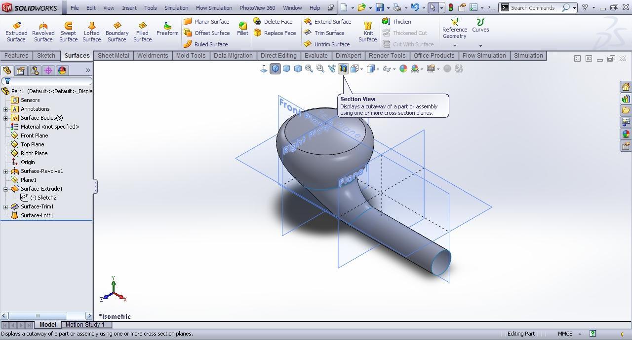

Step 16:
We have basic shape of the earphone. I have decreased the radius of the extruded surface Because it was a little larger.
Step 17:

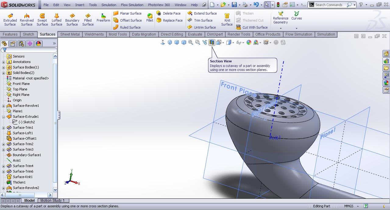

Select section view in standard views.
Step 18:
Select front plane for section and click OK.

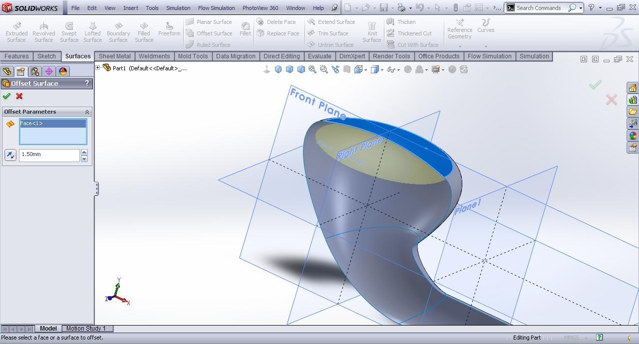

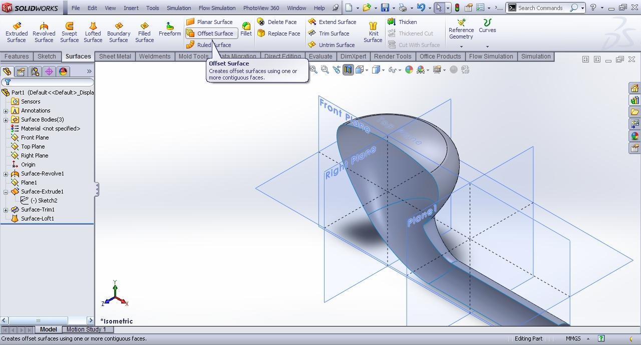

Step 19:
Under surfaces tab select offset surface.
Step 20:
Select the top face and change the distance to minimum i.e. about 1.5mm in my case.

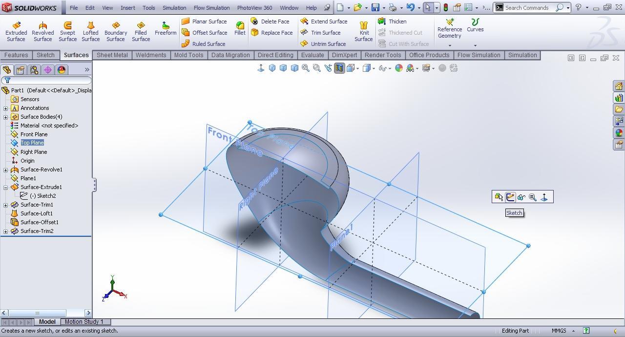

Step 21:

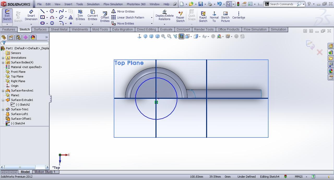

Now select Top plane and then sketch.
Step 22:
Draw a circle.

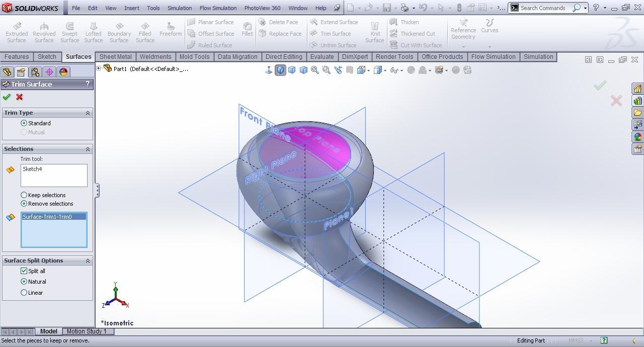

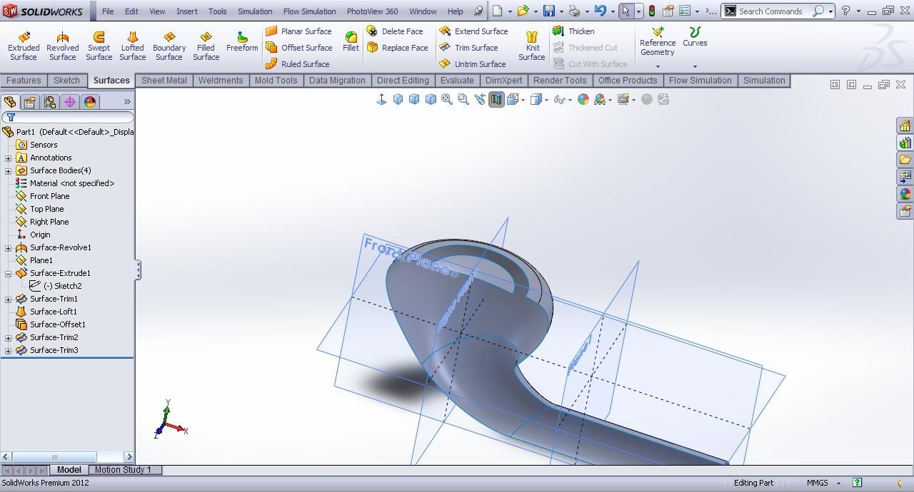

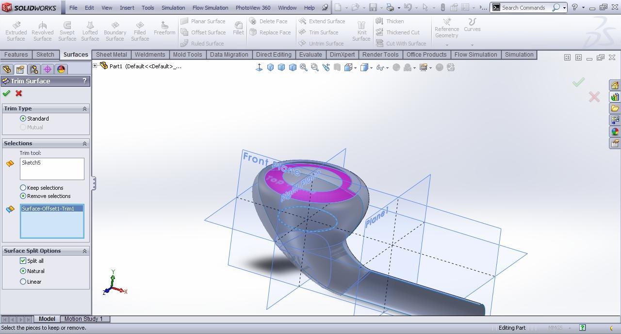

Step 23:
Step 24:
Trim the inner portion of the top-most face.

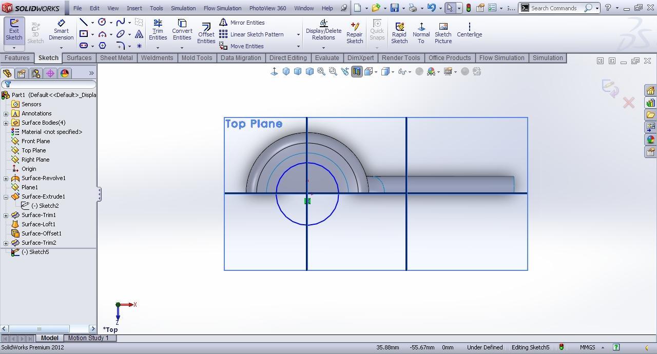

Step 25:
Again top plane and then sketch.
Step 26:
This time draw a circle considerably smaller than last one.
Step 27:
Select trim surface under surfaces tab.
Step 28:
Select the outer portion of the offsetted surface.

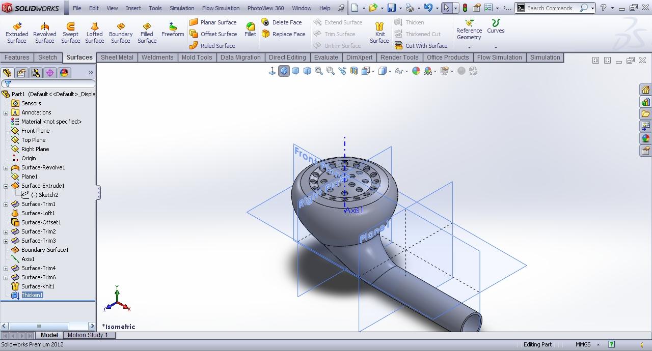

Step 29:
Click OK and the area is trimmed.

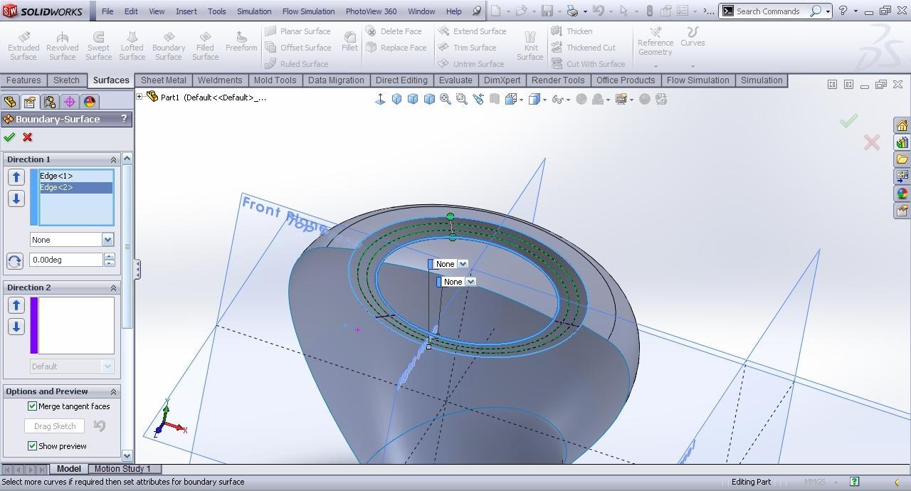

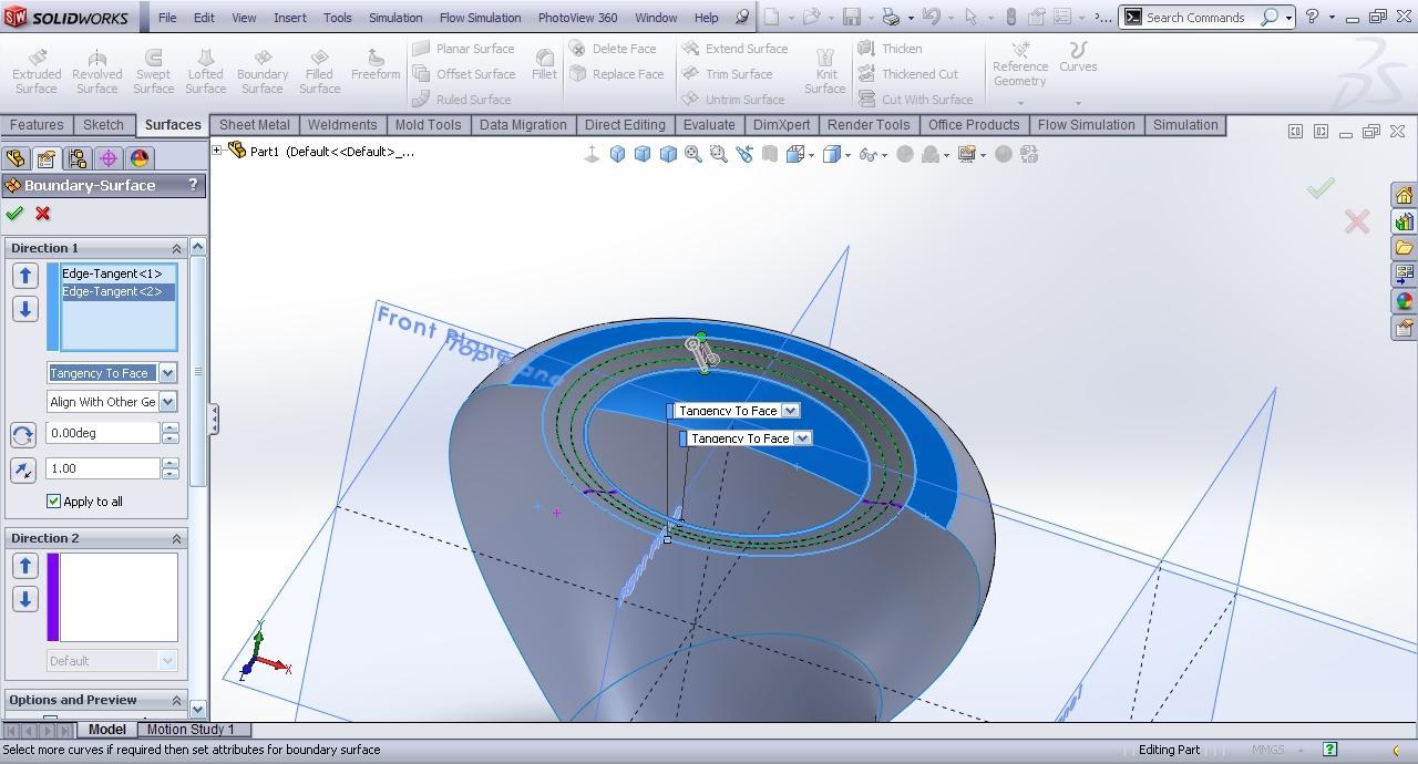

Step 30:
Under surfaces tab select boundary surface.
Step 31:
Select both edges.
Step 32:
Select tangency to face for both edges.
Step 33:
Click OK.

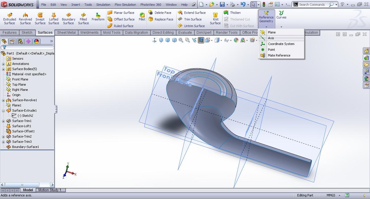

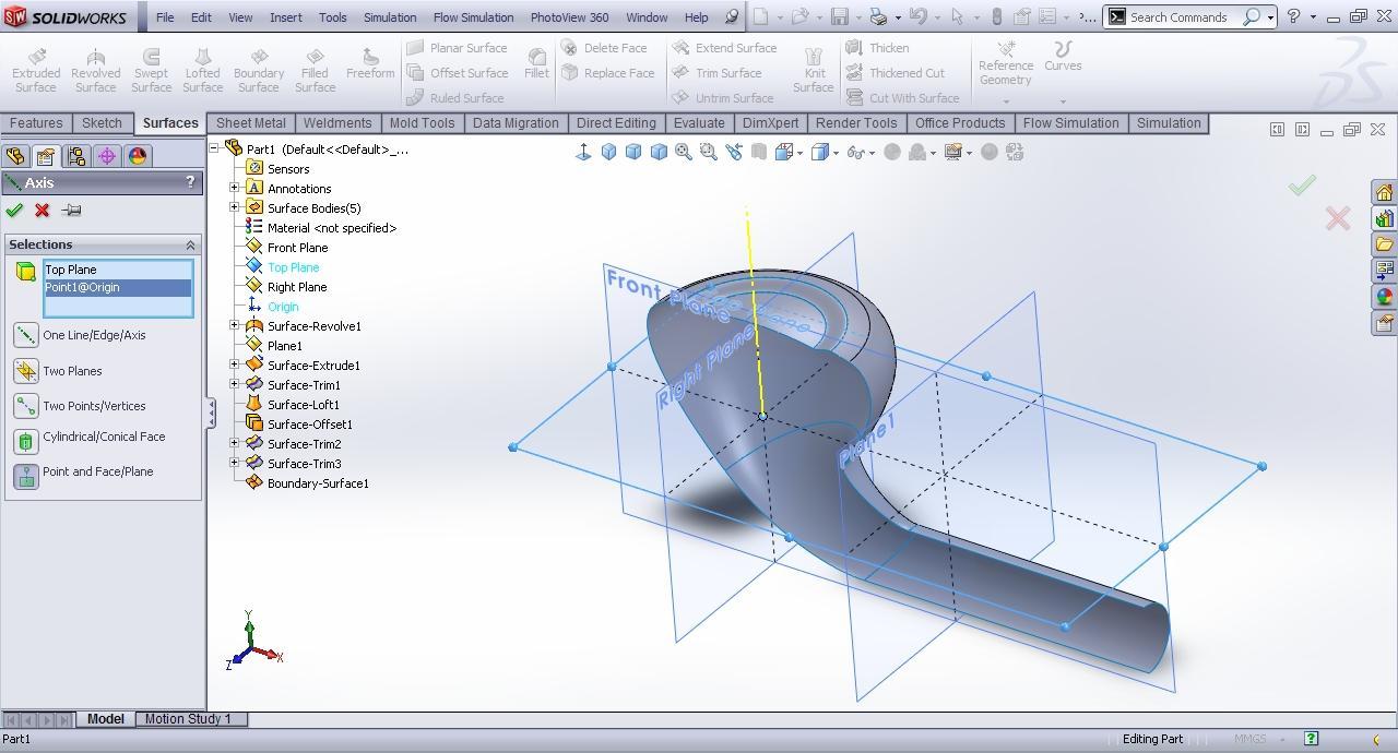

Step 34:
Now under surfaces or feature tab select reference geometry and then axis.
Step 35:
Select top plane and origin. This will create an axis perpendicular to top plane and passing through origin.

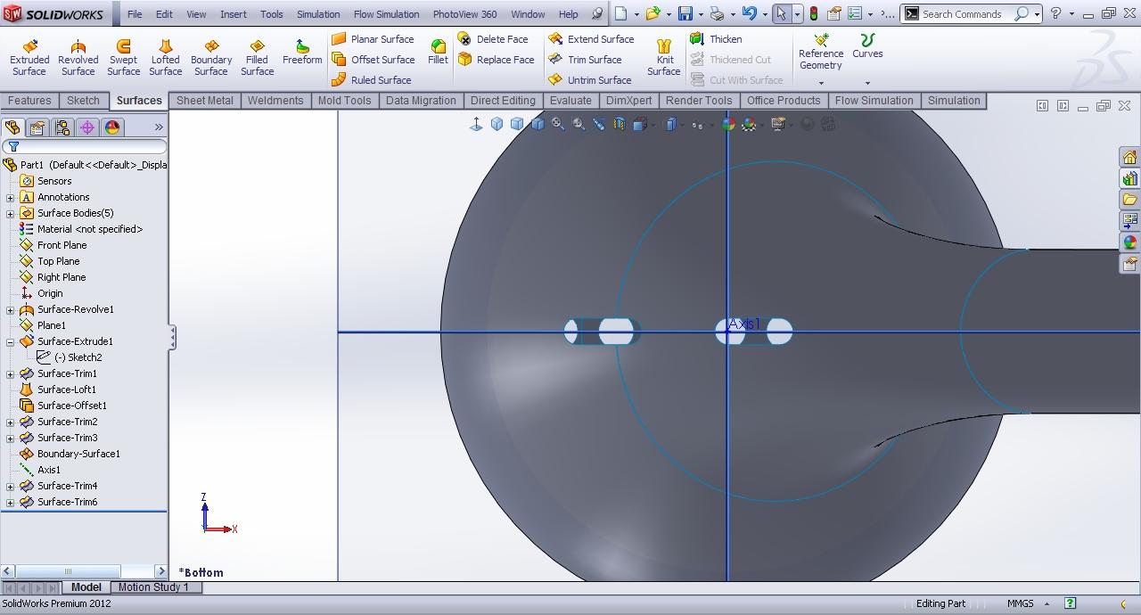

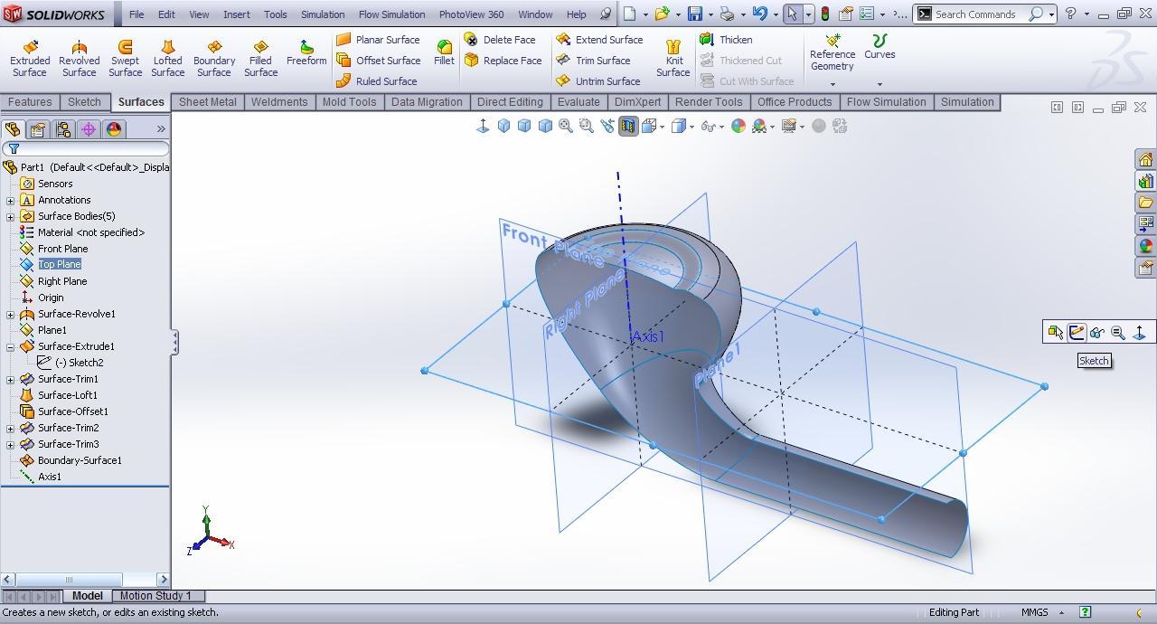

Step 36:
Now select top plane and then sketch.
Step 37:
Make a circle for hole.

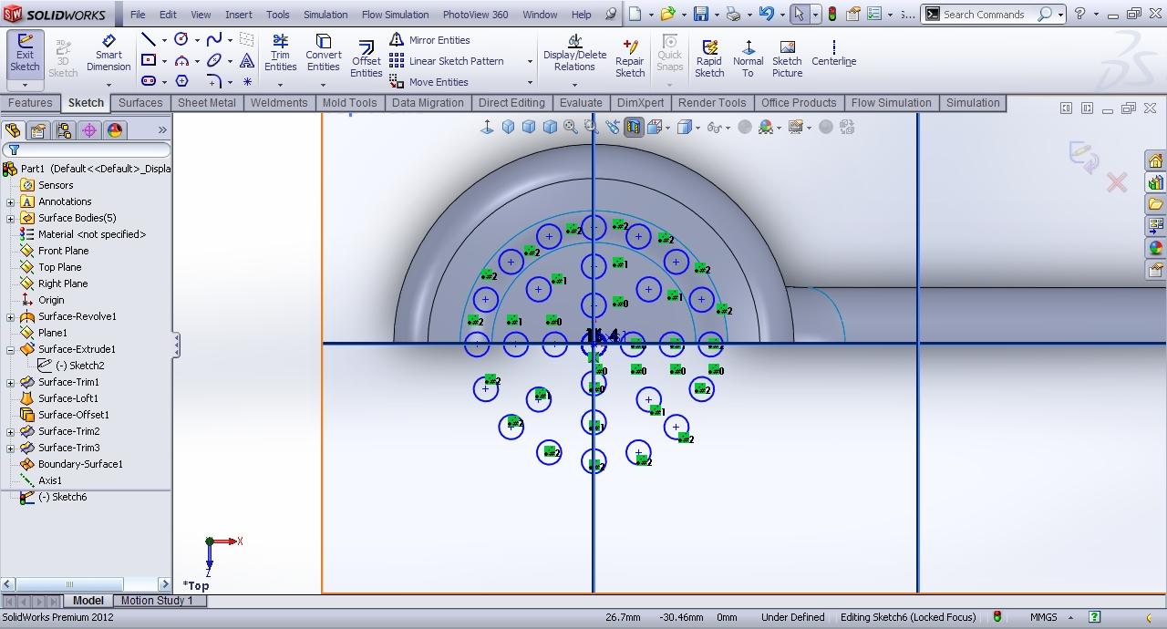

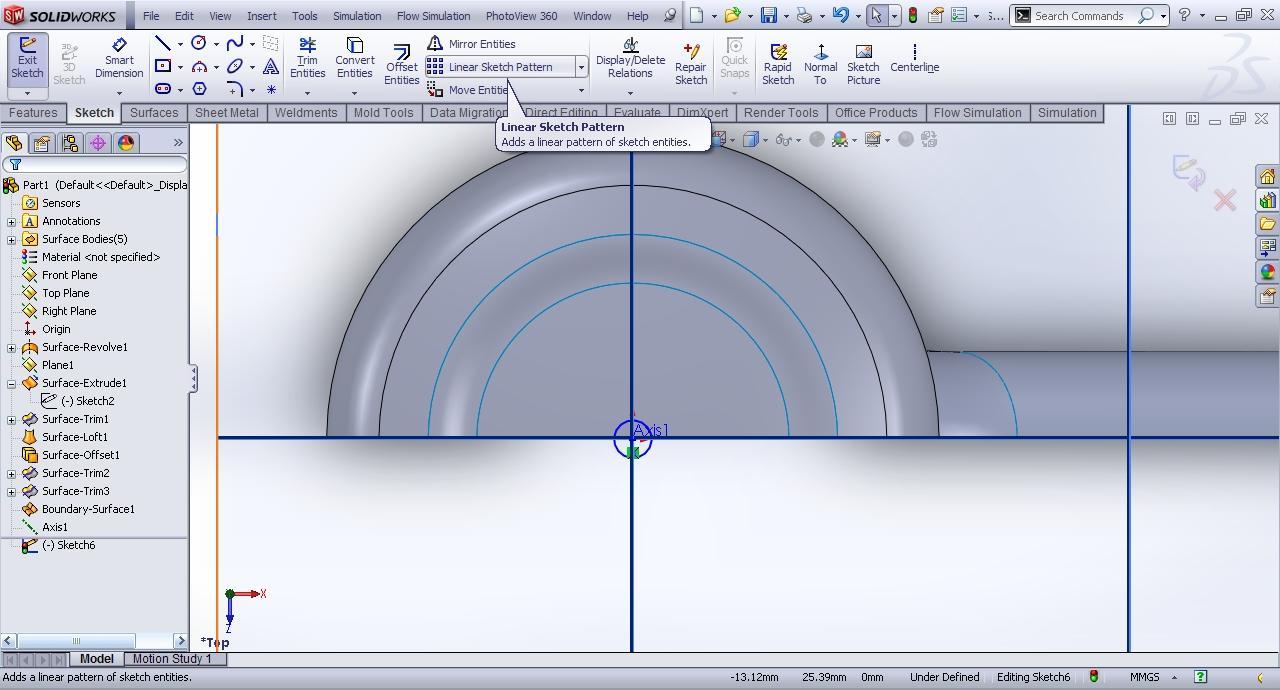

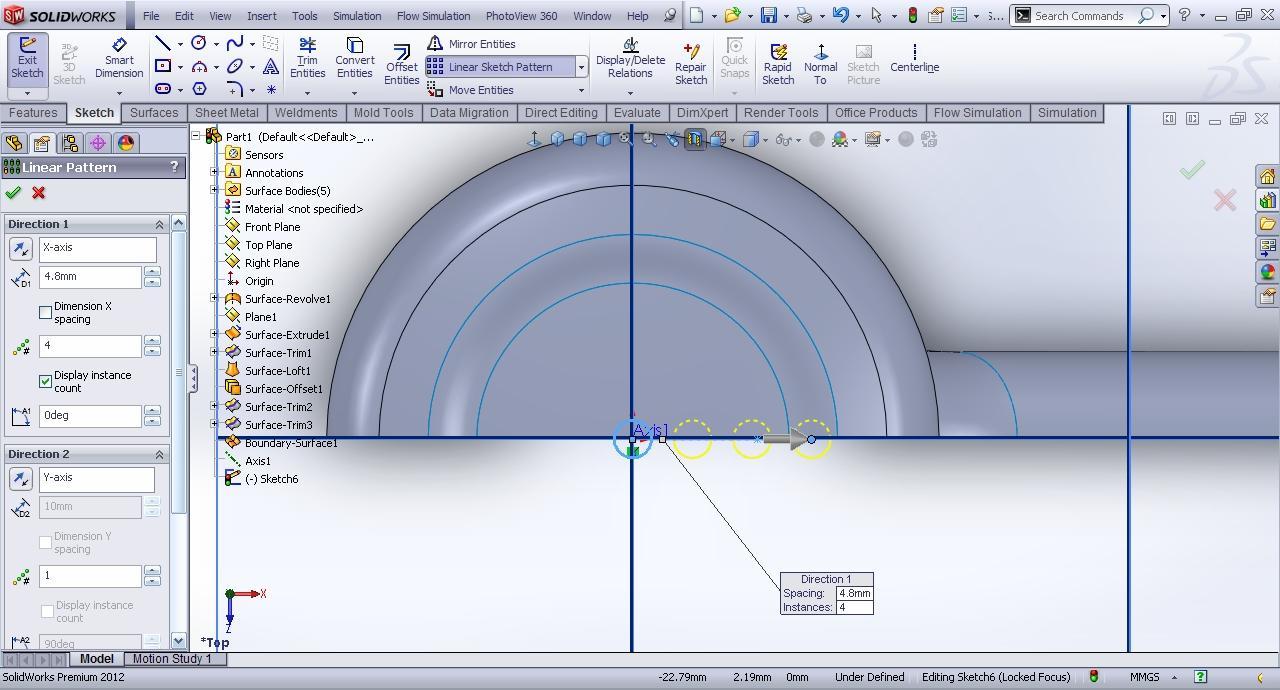

Step 38:

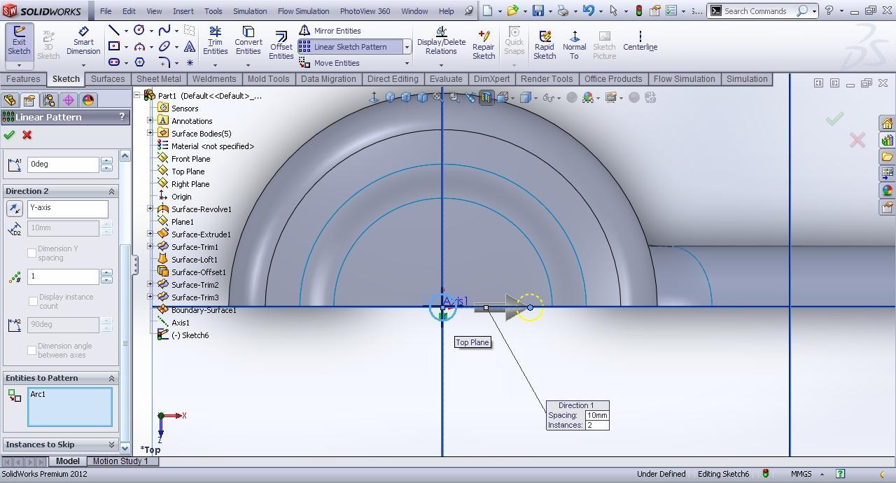

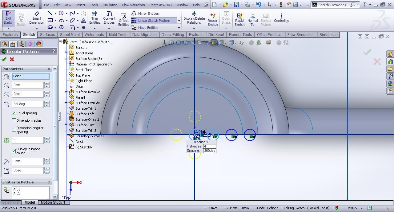

Now click linear sketch pattern in sketch tab.
Step 39:
Select the circle to entity to pattern.
Step 40:
Adjust the distance and increase the number of instances.
Step 41:
Now select circular sketch pattern.
Step 42:
Now select the 2nd circle to pattern.
Step 43:
Repeat the same step for other circles increasing the number of instances each time.

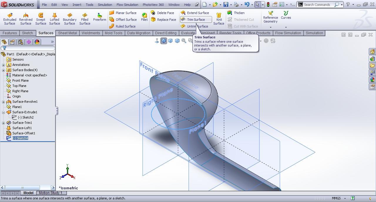

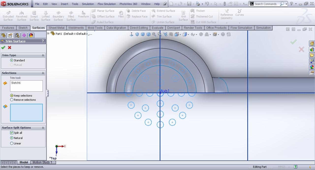

Step 44:
Under surface tab select trim surface.
Step 45:
Now select keep selection.
Step 46:
Select the excluded surface of holes.
Step 47:
Click OK and the surface is trimmed.

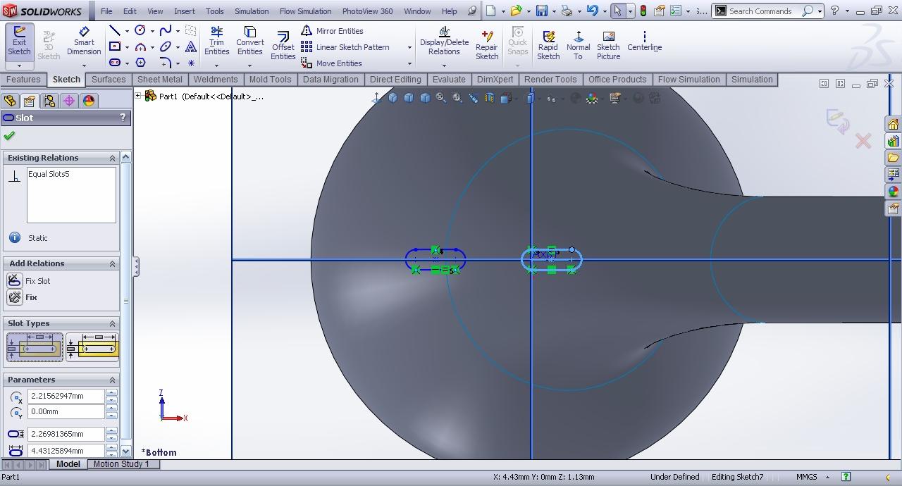

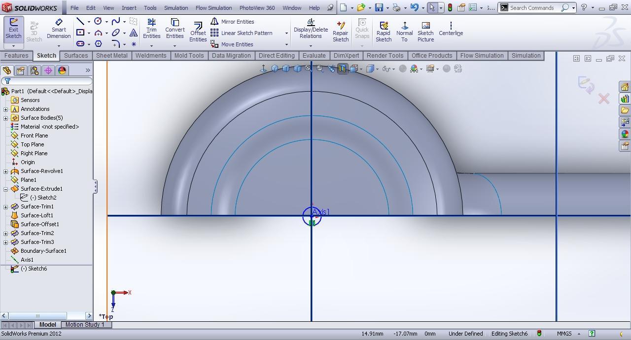

Step 48:

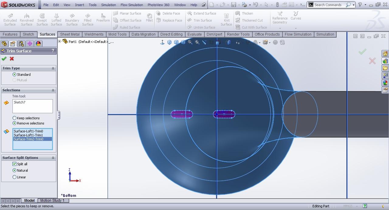

Step 49:
Use slot tool to make 2 slots.
Step 50:
Now select trim surface in surface tab and select remove selection. Select the surface bounded in slots and click OK.

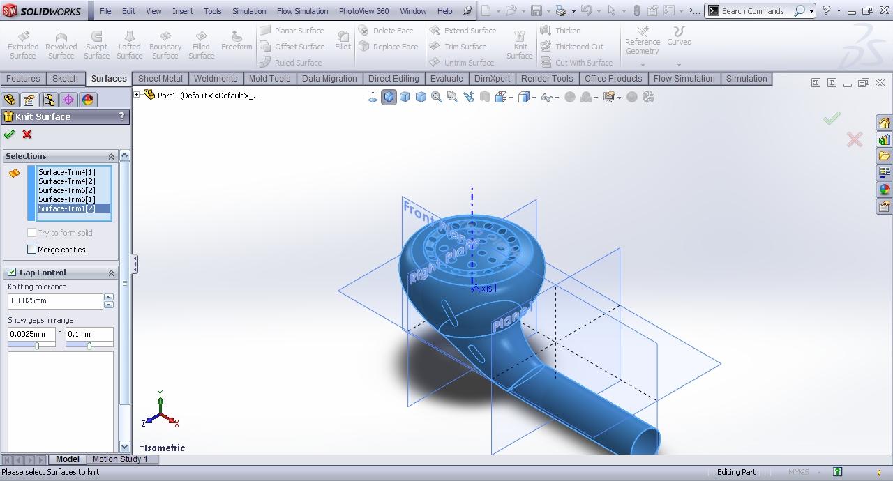

Step 52:

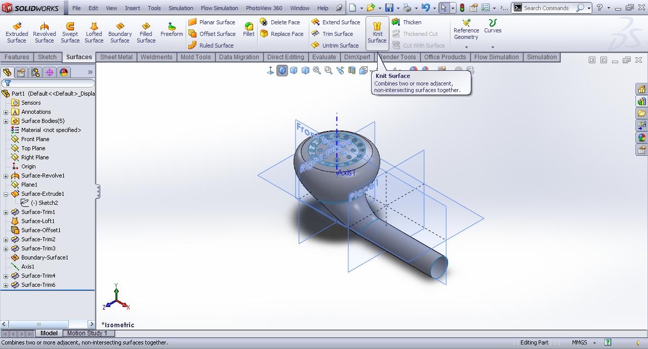

Select knit surface under surface tab.
Step 53:
Select all surfaces one by one and then click OK.

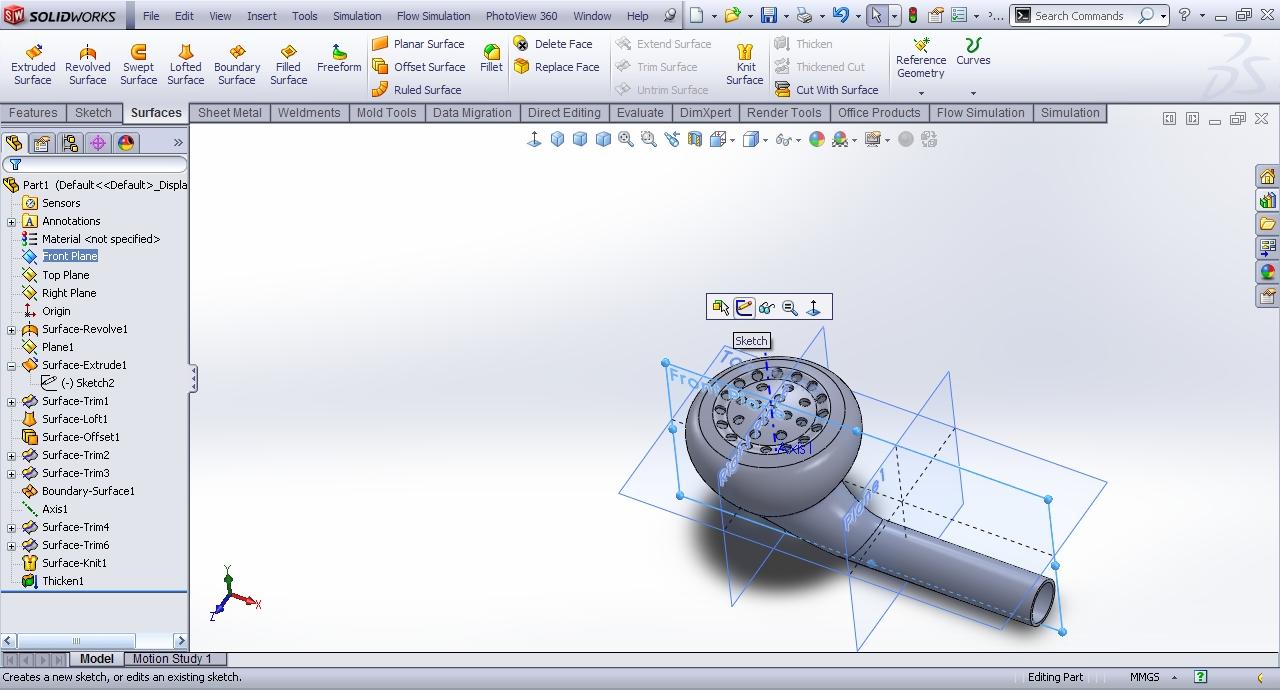

Step 54:
Under surface tab select thicken.
Step 55:
Select the surface. It will select Knit surface feature. Change the thicken distance to 1mm and outside direction. Click OK.
Step 56:
Now we have solid body of the earphone. We will now seperate the bodies.

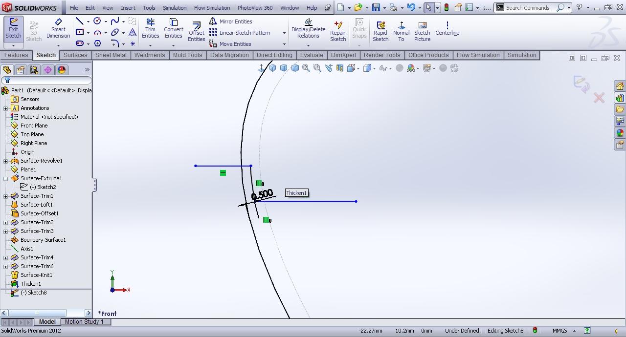

Step 59:
Offset the edge by 0.50mm and then draw two straight line horizontally. Trim other entities.

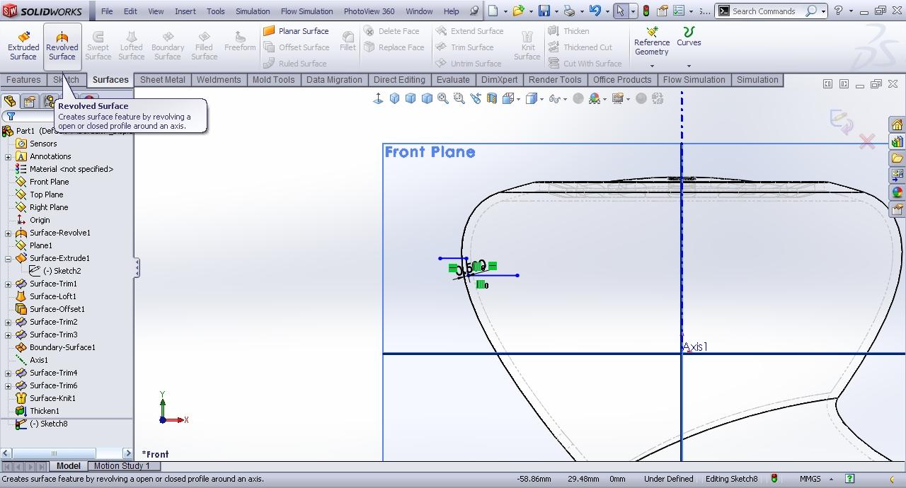

Step 60:

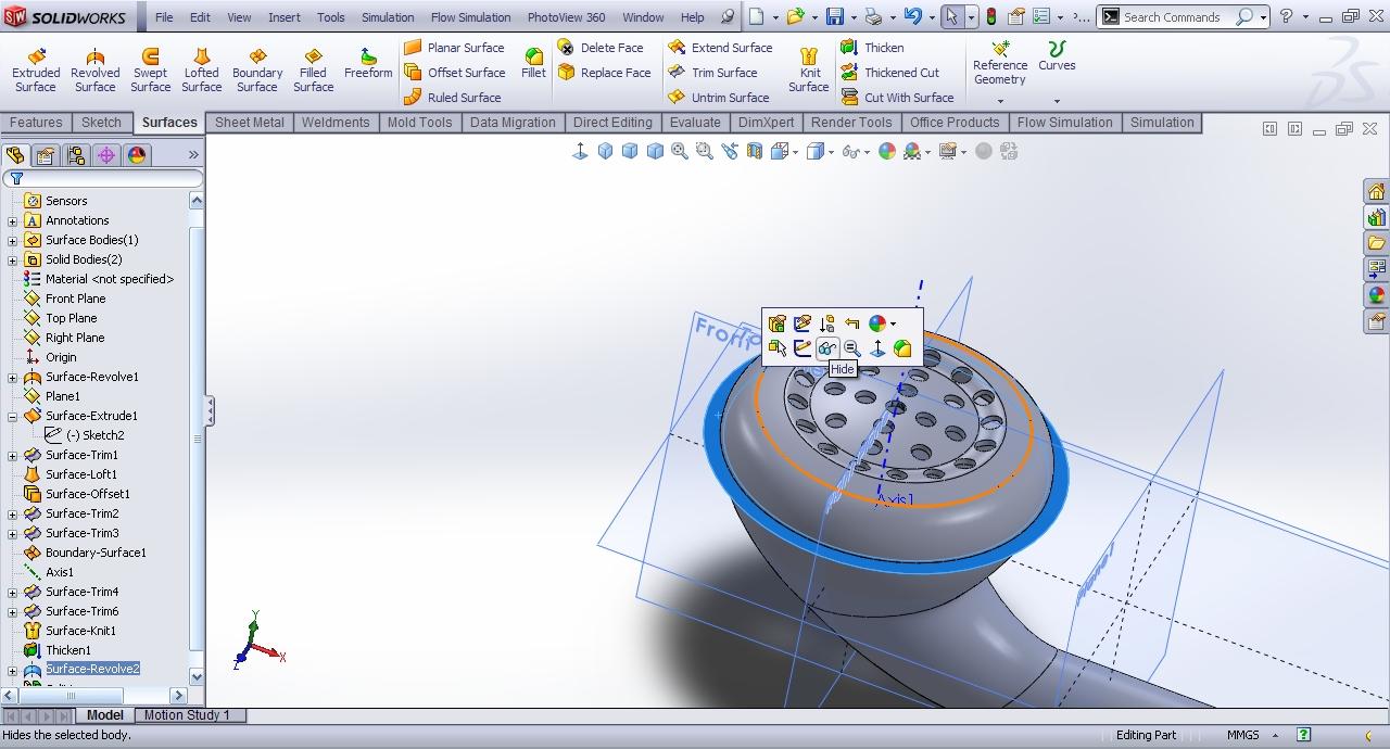

Select revolved surface in surface tab.
Step 61:
Select axis1 and click OK.

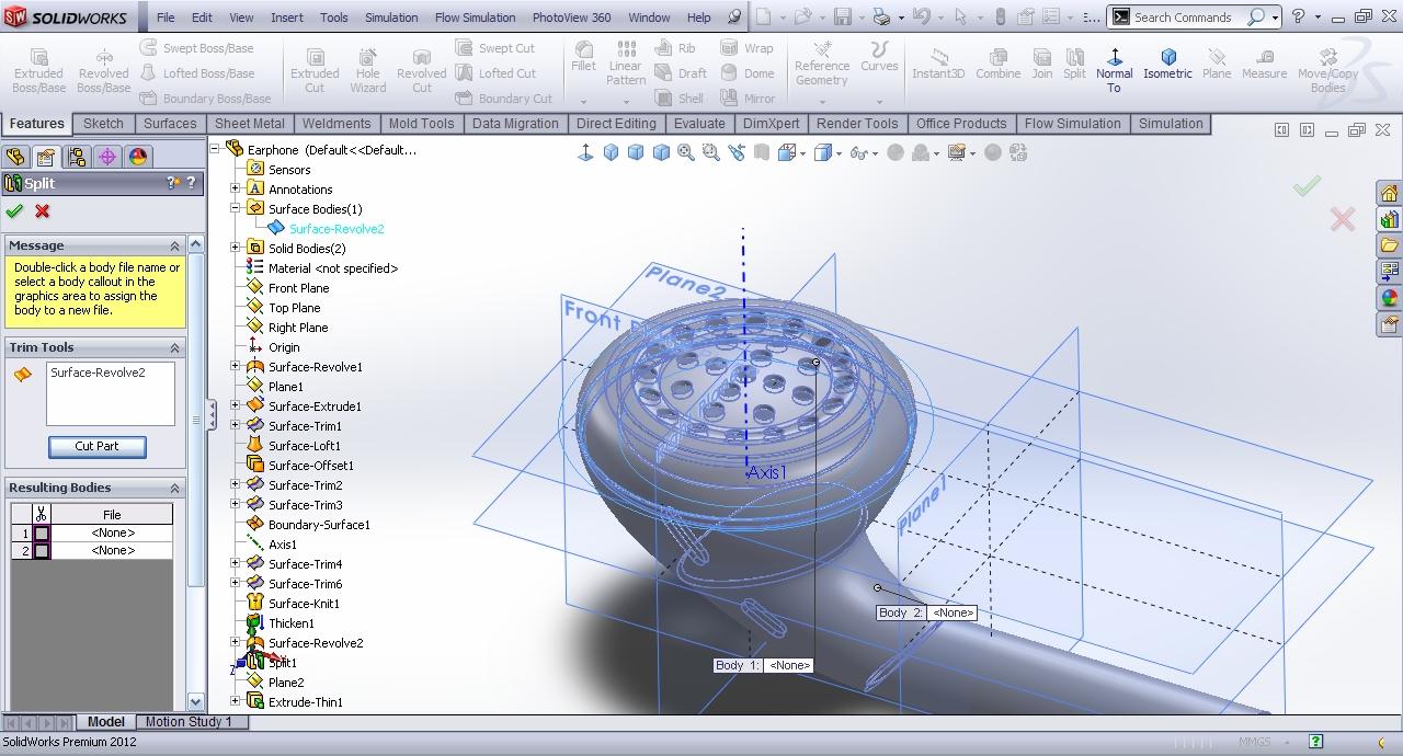

Go to insert menu then feautres >> split.
Step 63:
Select the revolved surface as the trim tool and click cut part.
Step 64:
Now check both the bodies and click OK. This feature will generate two split bodies by the revolved surface.

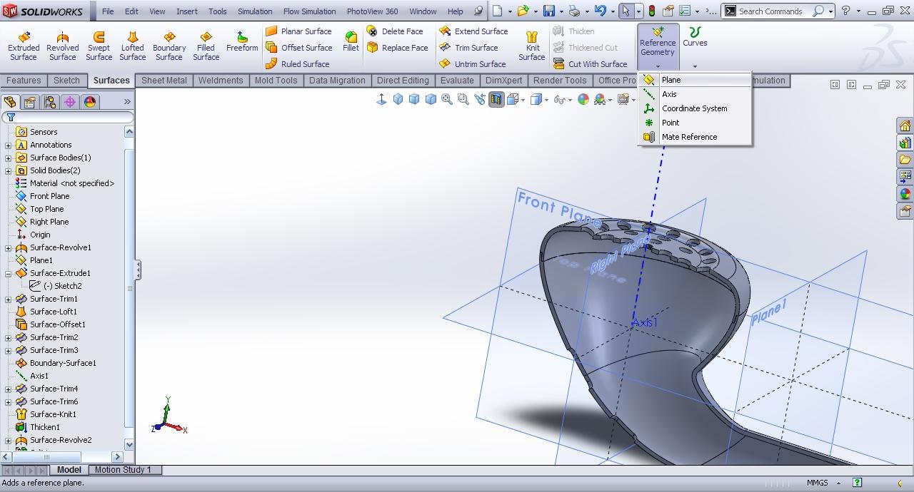

Step 67:
Select reference geometry and then plane under surface or features tab.
Step 68:
Select top plane and then offset it by a distance so that it will lie in the upper body.

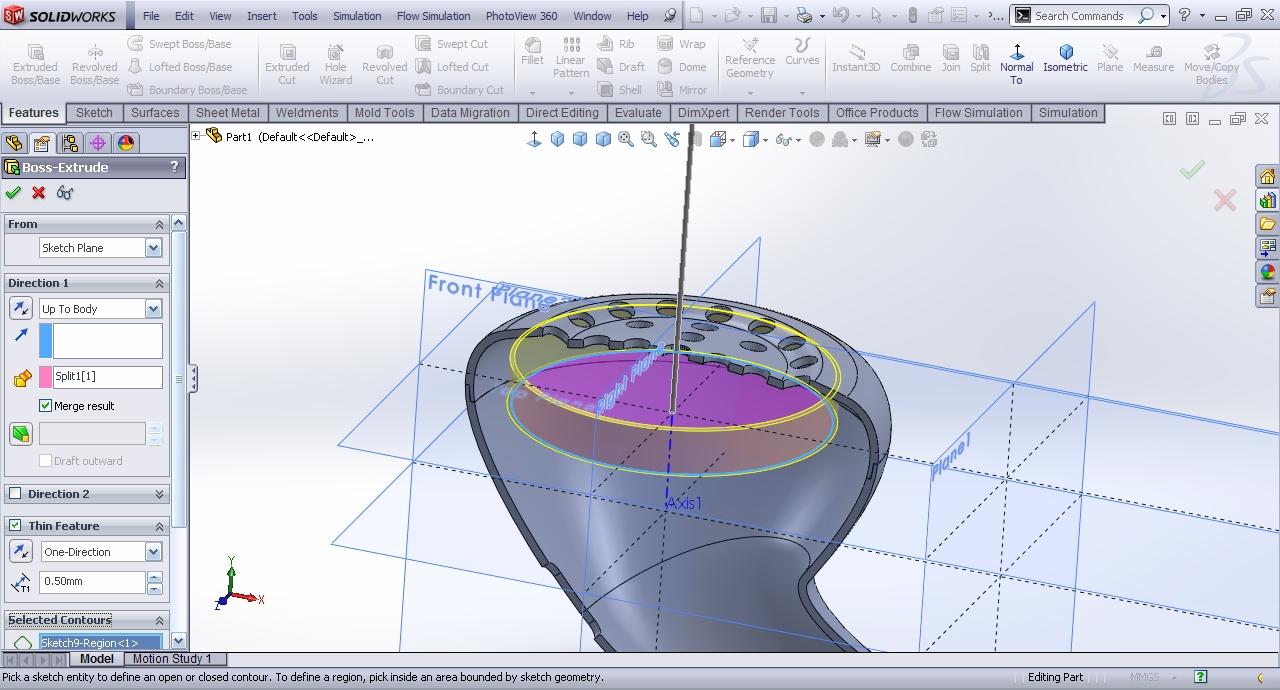

Step 69:
Select the plane2 and then sketch.
Step 70:
Draw a circle larger than the region bounded by the holes.

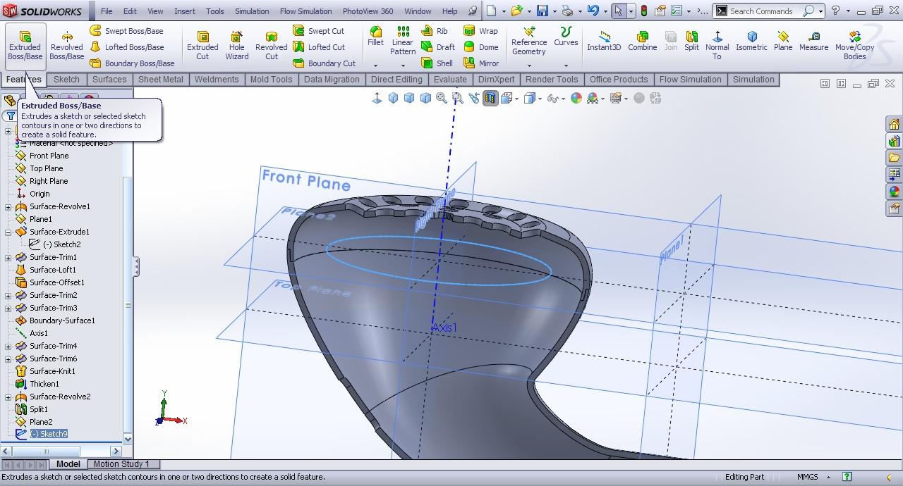

Step 71:
Under features tab click extruded boss/base feature.
Step 72:
Under direction1 select up to body.
Step 73:
Select the upper body and enable thin feature by a distance of 0.50mm. Click OK.
Step 74:
Now we have the body for the speaker of ear phone.

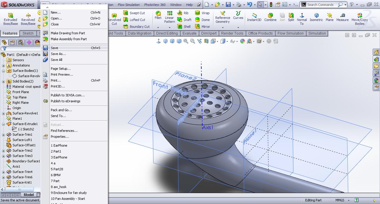

Step 75:

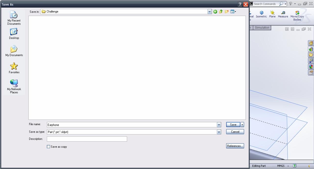

Now click file save.
Step 76:
Enter any file name for the part document. I entered earphone for myself.

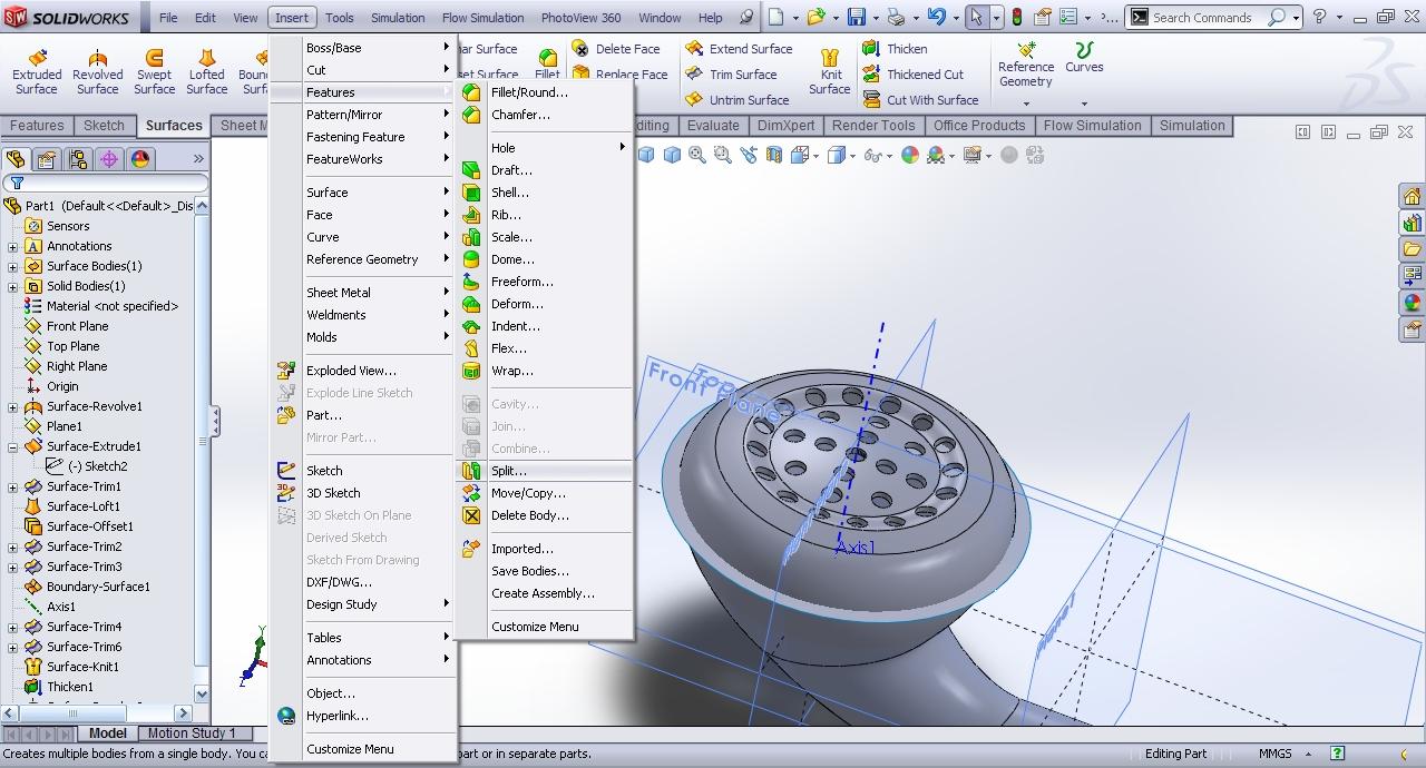

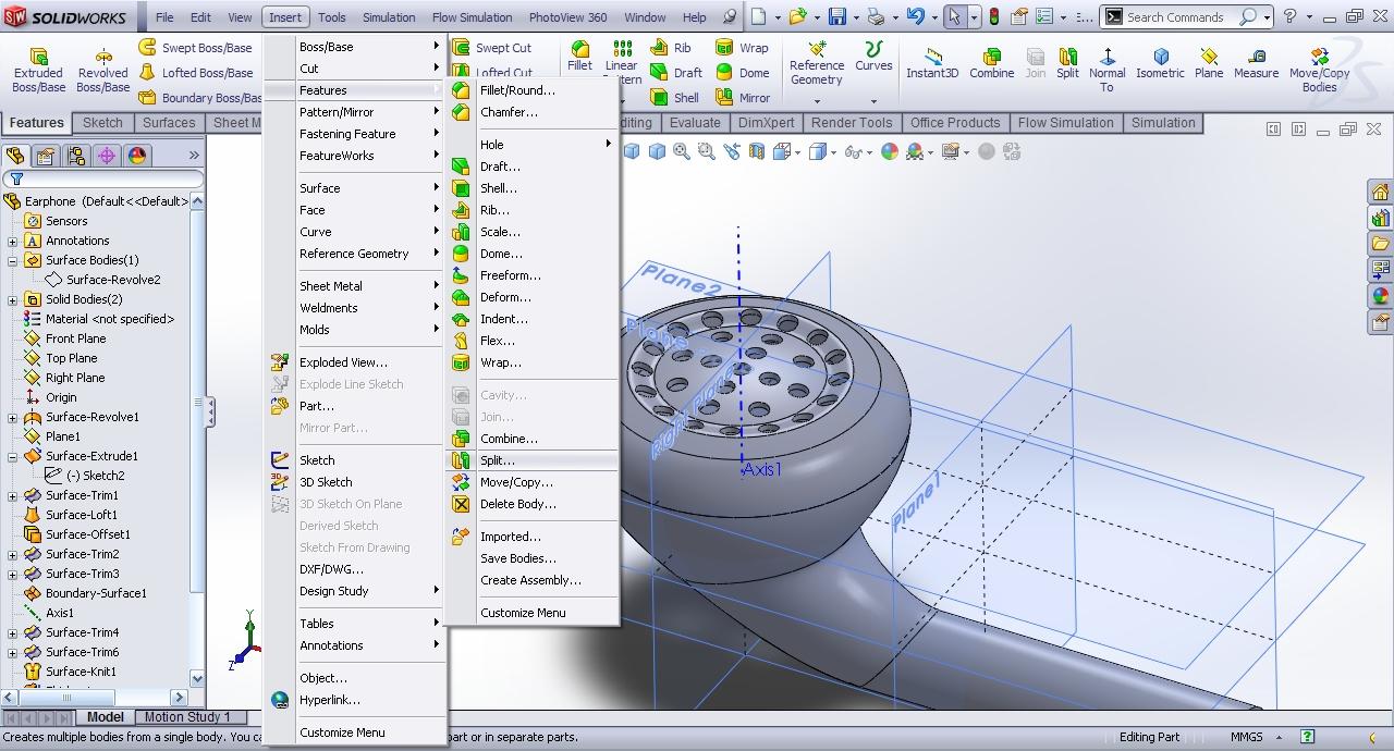

Step 77:

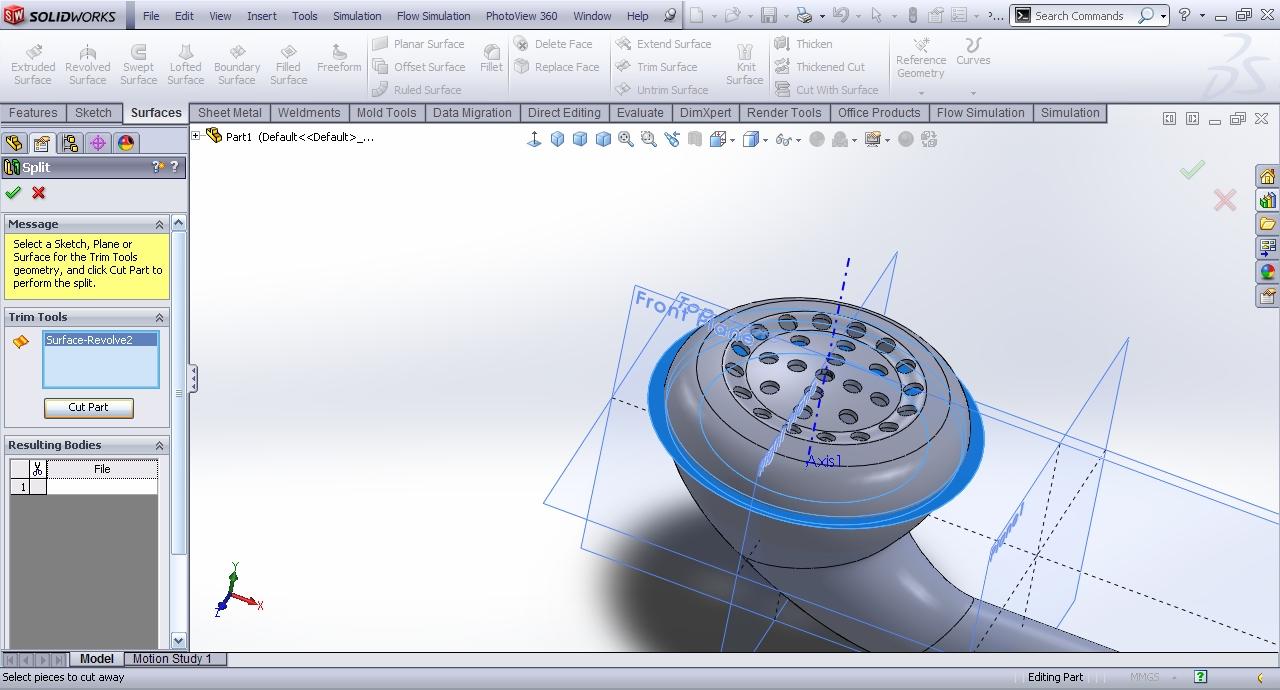

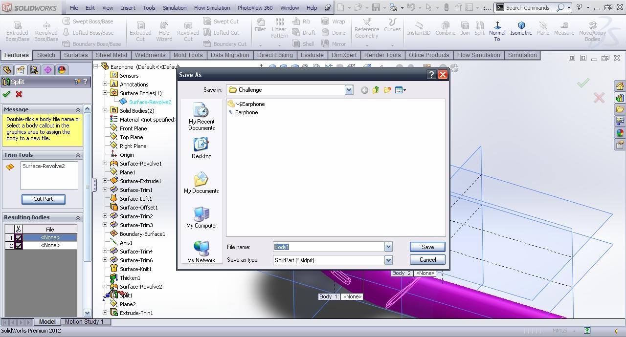

After saving part click insert>>feature and then split.
Step 78:
Again select revolved surface2 from the surface bodies under tree view and click cut part.
Step 79:
Double click the cut body1 and save it.
Step 80:
Repeat the same step for the other body and click OK.

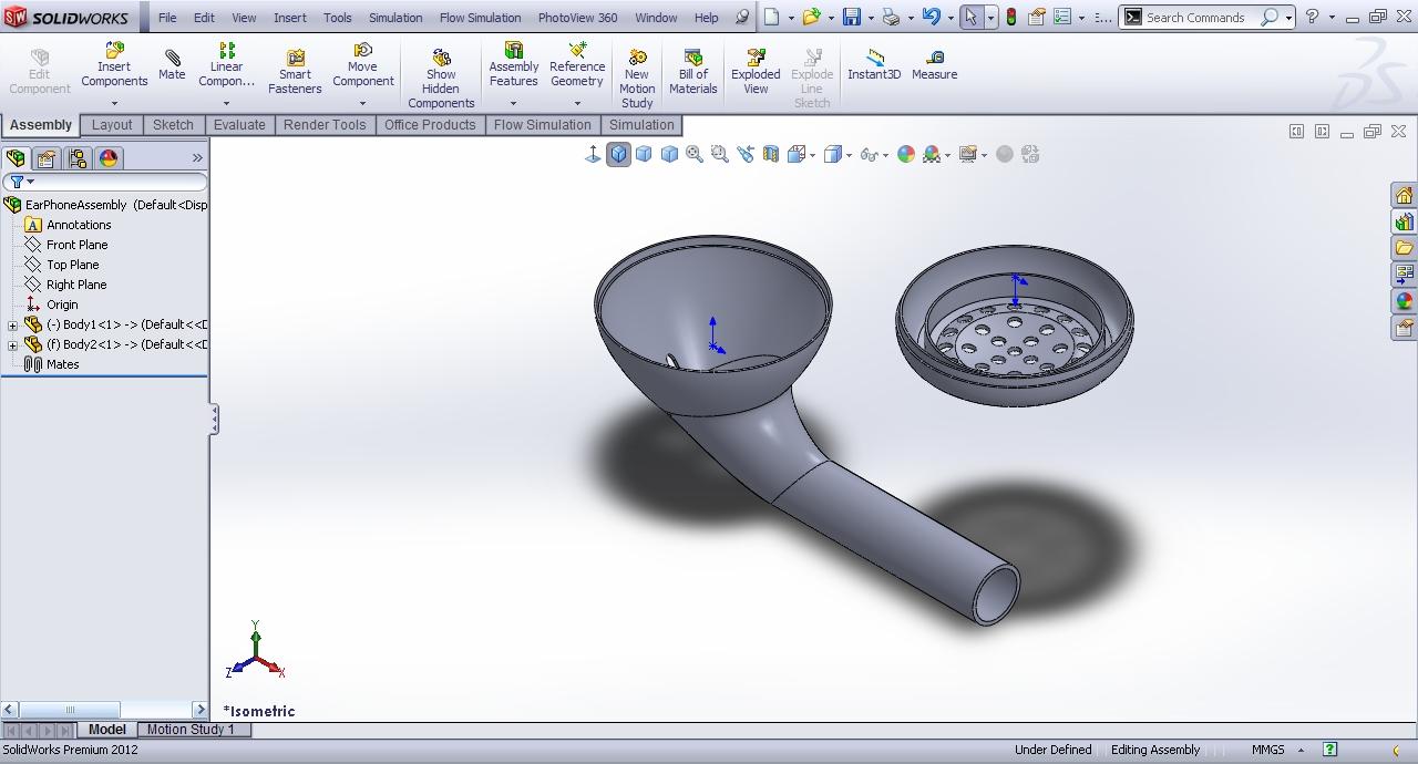

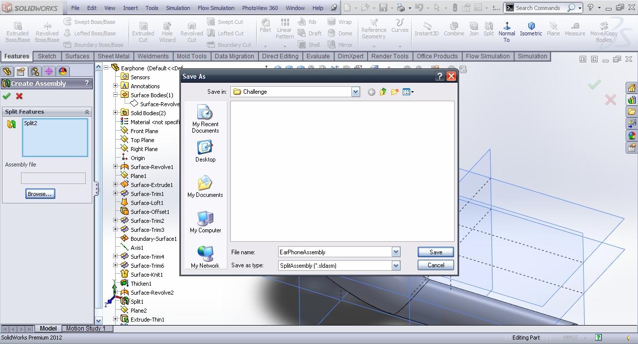

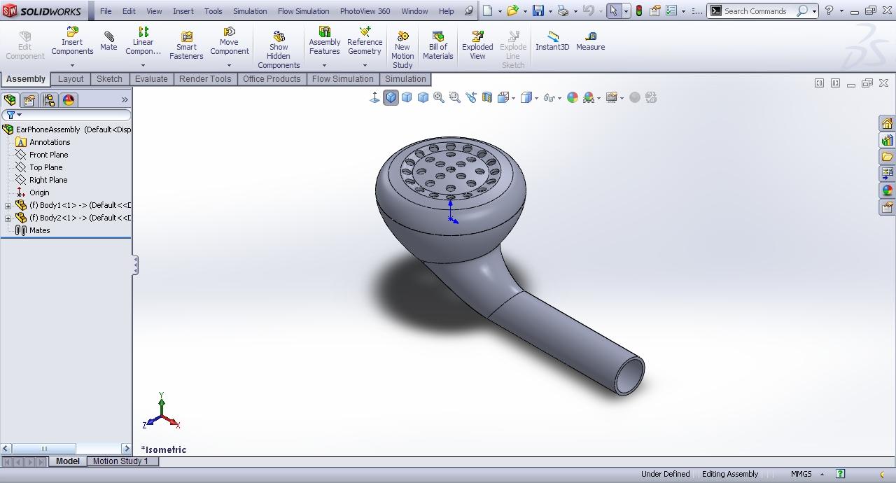

Step 81:
Now right click the split2 feature and then select create assembly.
Step 82:
Click browse.
Step 83:
Now save the assembly file for the splitted part document.
Step 84:
Now the assembly file will open.

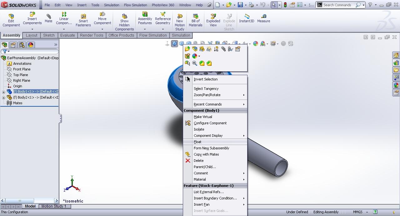

Step 85:
Right click the upper body and select float.
Step 86:
Move it and then rotate it to have a better view.

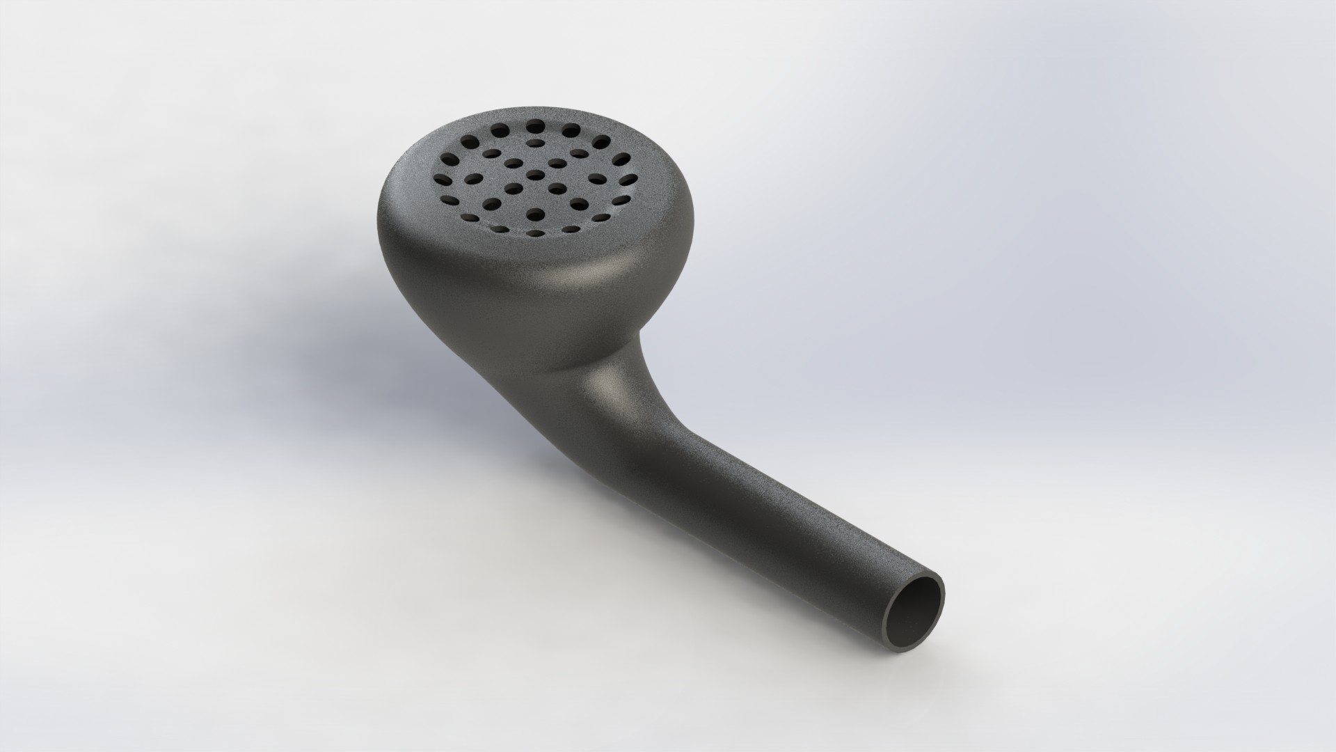

Step 87:
Here is the rendered image of the earphone. This one is not much better than the last one but you can make one better if done with care.
