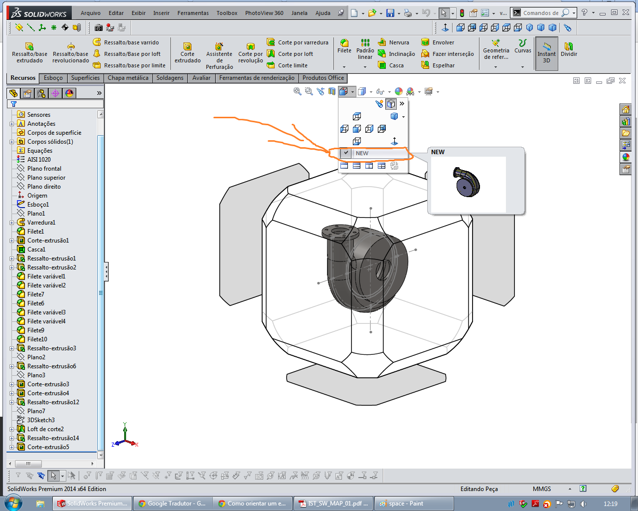

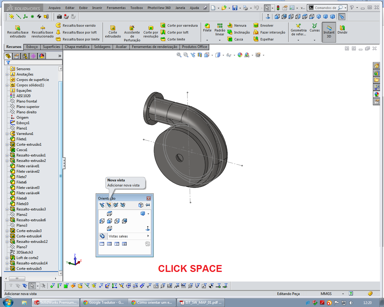

First, position the view the way you want it to appear. That done, press the spacebar and click the New View button, and give a name for the new view. That done, his new view will appear along with the patterns seen SolidWorks.
  1. Step 1:
    Step 1
  2. Step 2:
    Step 2
