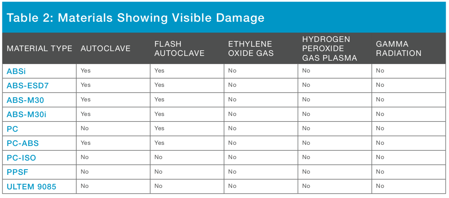

Although a large majority of the test samples showed they could successfully be sterilized by each of the methods, not all of them withstood the sterilization procedures themselves (Table 2).
All 9 materials seemed unchanged after sterilization by ethylene oxide gas, hydrogen peroxide gas plasma, and gamma radiation. However, the high heat and moisture of the autoclave caused damage to some of the materials. For example, after the first autoclave cycle, bending and indentations were seen in ABSi, ABSESD7, ABS-M30, ABS-M30i, and PC-ABS, all of which are ABS derivatives.
The indentations were caused by the metal basket used to hold the samples in the autoclave chamber. Some of the samples were also attached to one another as if melded together by the heat. For this reason, the samples were packaged individually for the flash autoclave cycle. However, the flash autoclave cycle also damaged all of the ABS derivatives. Bending was very apparent as well as indentation. Although some of the indentation was from the holding basket, there was also some that appeared to be a result of the moisture retained by the bags post-sterilization. Color change was also noted. Slight bending of the samples was also seen in PC as a result of the flash autoclave cycle.
