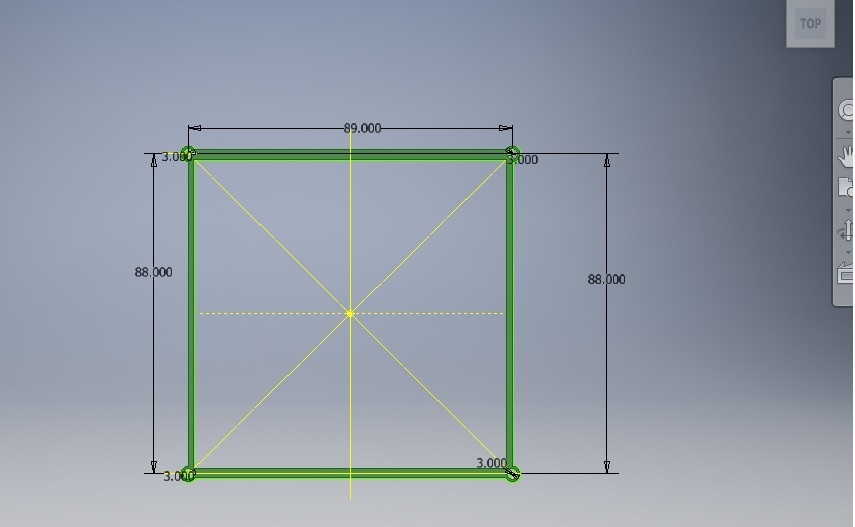

Step 1: Your model (current view)
Notice the view cube and the orientation for FRONT & TOP
Step 2: Your model (current FRONT)
Current FRONT view for your model
