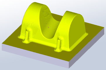

HSMWorks tutorial №2 - High-speed 3D machining
In this tutorial you will learn how to machine the part above on a high speed machine tool through the following steps:

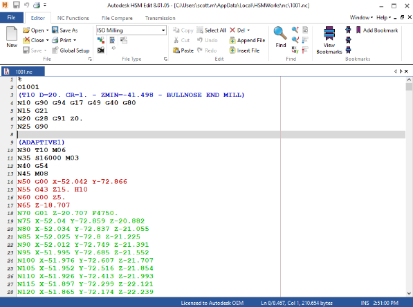

▸Post Processing

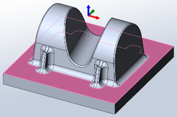

Before proceeding, open the part Tutorial2.SLDPRT into HSMWorks.

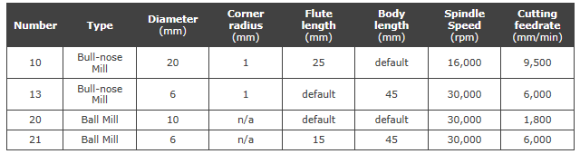

    In this tutorial, we will start of by creating a tool library containing all the tools we will be using first.
    First, open the tool library:
    ➝ Choose Tool Library from the CAM toolbar or the CAM menu.
    The tool library allows you to select from existing tools in a library as well as define new tools. Tool definitions can be saved in a library or just for the part you work on.
    Next, create a new library called Tutorial2:
    ➝ In the tool library dialog, select My Libraries
    ➝ Click New Library
    ➝ Name the new library Tutorial2. Press Enter to accept the new name
    This creates a new library file in My Libraries subfolder of your My Documents folder.
    You can locate the library file by right-clicking on the library and pressing Open in Windows Explorer.
    Now, add each of the following tools by pressing New Mill Tool, and then changing the type and the parameters specified below. All other parameters should be left at their defaults.
    When you are done setting up the tools, press OK to return to HSMWorks. The library will be saved automatically.

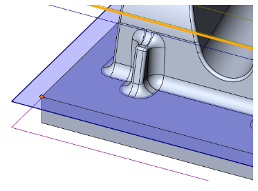

    3. Heights
    The default heights are set to relate to the geometry such that the entire depth of the part is machined.
    In this operation we will only machine down to the flat area of the part, omitting the rectangular base of the part.

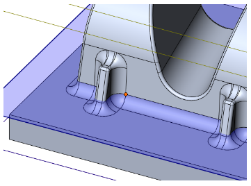

    ➝ For Bottom choose From Selection.
    ➝ For the Bottom Reference select one of the vertices along the bottom face:

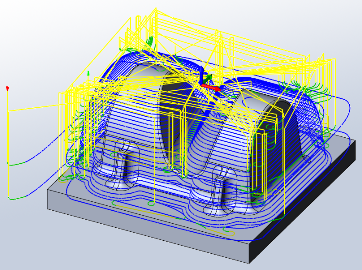

    5. Start calculation
    Click at the top of the property manager. This will start generation of the toolpath.
    Whenever a toolpath is being generated, you can continue to work by pressing the Hide button on the Task Manager dialog.
    When the Task Manager is hidden, toolpath calculation will continue in the background, and you can see progress directly in the operation manager.
    Note also that for most of the strategies, it is possible to see a preview of the toolpath as it's being generated. This can be valuable to help you see early on if something is wrong so you can abort the task and go back and change the parameters.
    You can bring the dialog back by selecting Task Manager from the CAM toolbar or menu.
    You can either abort a task by pressing the Abort button in the task manager, or by choosing Abort Generation when right-clicking on the operation in the operation manager.

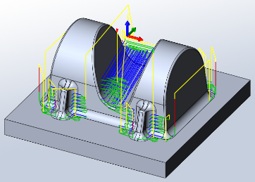

    When the toolpath generation is complete, the resulting toolpath should look like this:

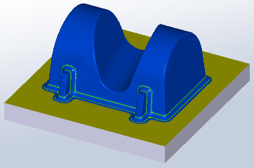

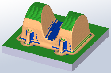

    6. Verification

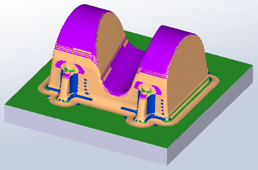

    To verify the toolpath use the stock simulation, right click on the Job node in the Operation Manager and select Stock Simulation (All). Press the Start button and watch the stock simulation up to the final stock shape.
    Click to exit the Stock Simulation.

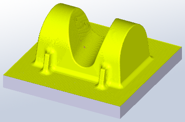

    6. Verification

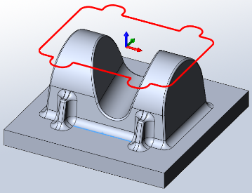

    2. Geometry
    Machining Boundary
    ➝ Select Tool Center on Boundary from the Tool Containment drop down.
    We want to confine the machining to steep areas with this operation. This can be achieved by limiting the Slope range.
    Slope
    ➝ Enable Slope
    ➝ Change From Slope Angle: 60deg
    ➝ Change To Slope Angle: 90deg
    All other settings remain default.

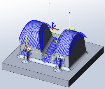

    Click at the top of the property manager. The resulting toolpath should look like this:

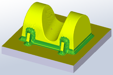

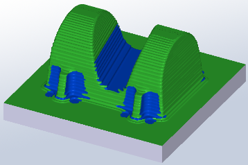

    6. Verification

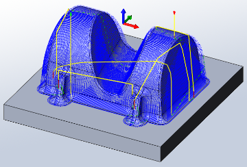

    4. Start calculation
    Click ✔ at the top of the property manager. The resulting toolpath will look like this:

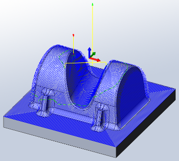

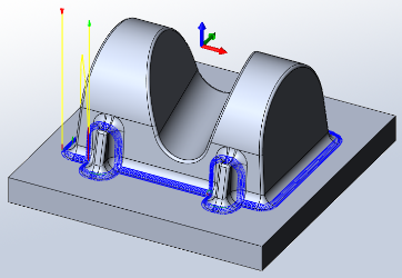

  8. Step 8: Pencil Milling
    We are using a 6 mm ball mill for finishing toolpaths. The fillets between base and boss are 4mm radius. We will use parallel pencil passes to machine the fillets.
    ➝ Click the strategy Pencil on the CAM toolbar. This opens the Property Manager and you will see the following groups.
    1. Tool
    Select tool #21 - Ø6mm ball from the document tool table.
    2. Passes
    Pencil
    Use these settings:
    ➝ Set Overthickness: 1.2mm
    ➝ Set Number Of Stepovers: 5
    ➝ Set Stepover: 0.3mm
    Overthickness is used by HSMWorks to generate pencil passes where they would not exist for the specified tool. Here the tool radius of 3mm is smaller than the fillet radius of 4mm. With Overthickness set to 1.2mm, HSMWorks will generate the pencil passes for a larger tool radius, and uses them to guide the smaller tool into the fillets.
    Stock to Leave
    Use these settings:
    ➝ Enable Stock To Leave
    ➝ Set Radial (Wall) Stock To Leave: 0.05mm
    ➝ Set Axial (Floor) Stock To Leave: 0.05mm (updated automatically)

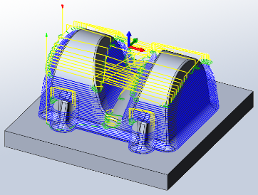

    3. Start calculation
    4. Verification
    Click ✔ to exit the Stock Simulation
  9. Step 9: Collapsed Pencil
    For the last finishing operation, we will use a collapsed pencil finishing toolpath over the entire part except the base surface. We can copy the previous operation, and then edit the parameters.
    ➝ Right-click on the last operation, Pencil1.
    ➝ Select Copy from the context menu.
    ➝ Right-click again.
    ➝ Select Paste from the context menu. A copied operation Copy of Pencil1 is added to the bottom of the toolpath list.
    ➝ Rename the copied toolpath: select and press F2. Type the new name Parallel pencil.
    ➝ To open the Property manager right-click Parallel pencil and select Edit from the context menu. You will see the following groups:
    1. Tool
    The selected tool should still be #21 - Ø6mm ball.
    2. Geometry
    Confinement
    We will confine the toolpath to the area of the boss.
    ➝ In the pull down menu Machining Boundary switch from Silhouette to Selection.
    ➝ Disable Tangent Propagation
    ➝ Select an edge on the inner boundary as shown here:
    ➝ Set Additional Offset: 1.0mm
    3. Passes
    Pencil
    ➝ Disable Limit Number Of Stepovers
    ➝ Set Stepover: 0.7mm
    Stock to Leave
    ➝ Disable Stock To Leave
    5. Verification

  10. Step 10: Post Processing
    We are ready to post process all toolpaths in order to make the NC-code which can be used by the machine tool.
    ➝ Right-click on Job in the operation manager.
    ➝ Select Post Process (All).
    ➝ Choose the desired post processor configuration, program file name and location.
    ➝ When you have finished editing your settings click on Post to generate the CNC program file. By default HSMWorks Edit will open and you can view and simulate the program code, and transfer it to the machine control.
    Congratulations! You have completed this tutorial.
