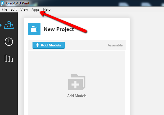

Open GCP > Apps > Insight
This will open the latest version of Insight. FYI - This version of Insight is updated more frequently than stand-alone versions of Insight. -

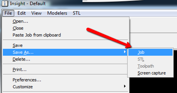

Using Insight: load, process and save (File > Save as > Job) your file.

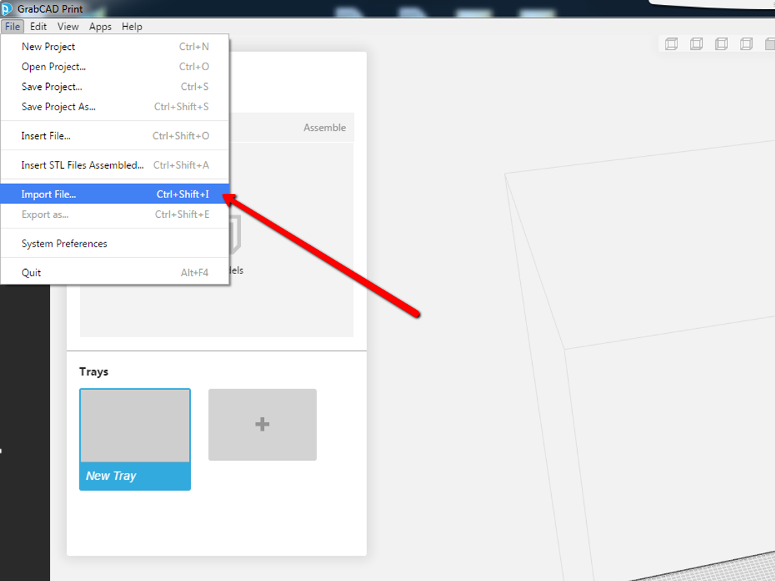

From GCP select your desired printer, and import (File > Import) the saved Insight file (.cmb).
