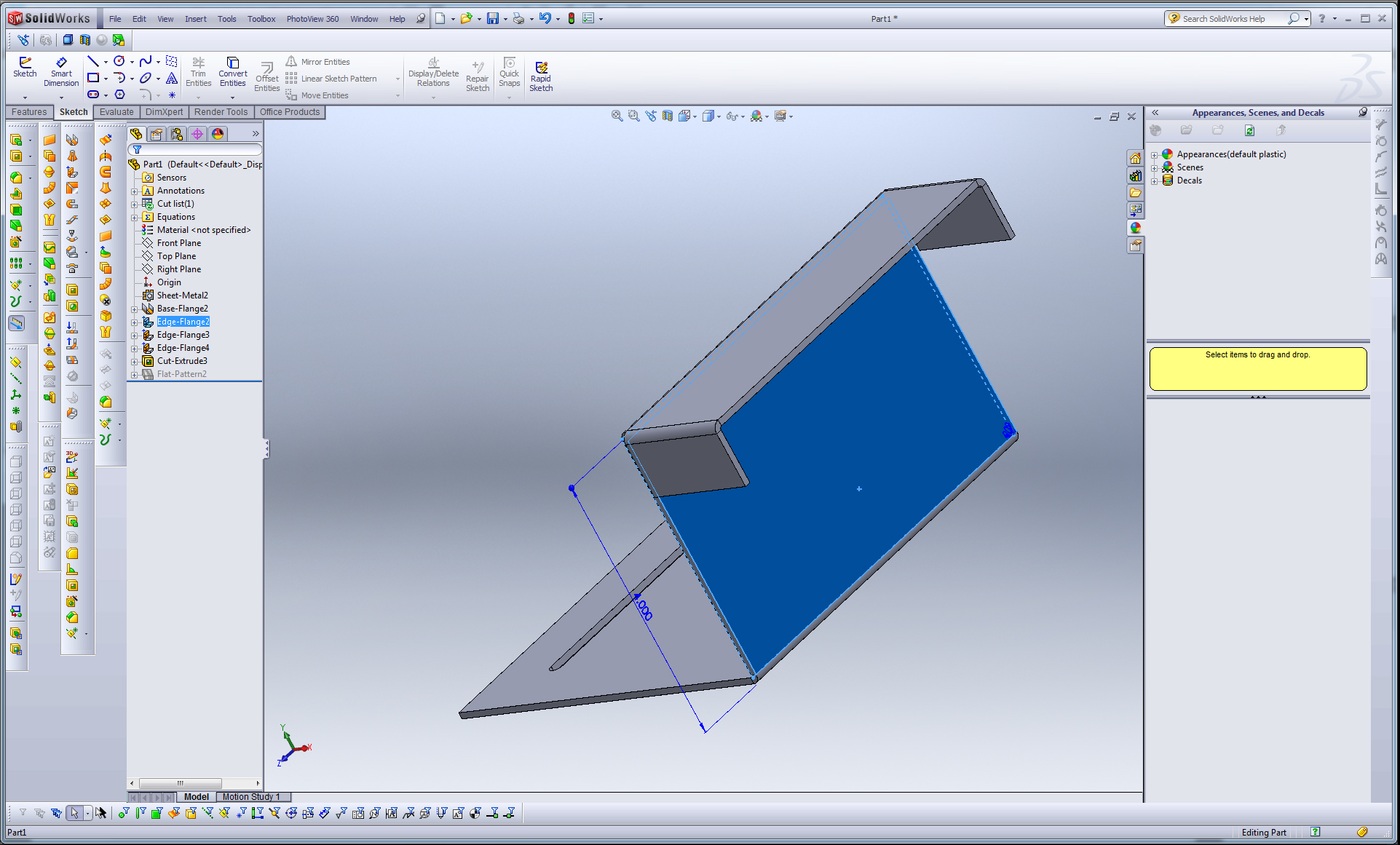

Select the face for the slot and make a Cut-Extrude. Draw your slot and dimension accordingly. Exit sketch and select Through All. Click OK.
Step 8:
Select the face shown and select Cut-Extrude.
Step 9:
