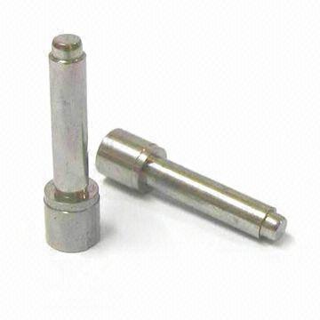

Step 2:
stepped ejector pin

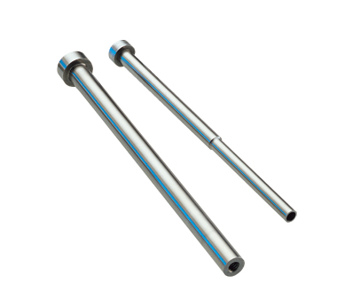

Step 3:
ejector sleeve

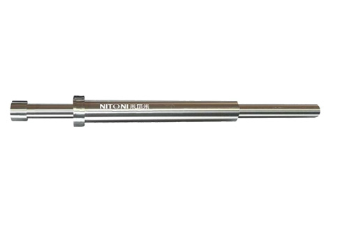

Step 4:
ejector pin in sleeve

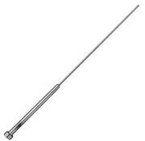

Step 5:
blade ejector pin

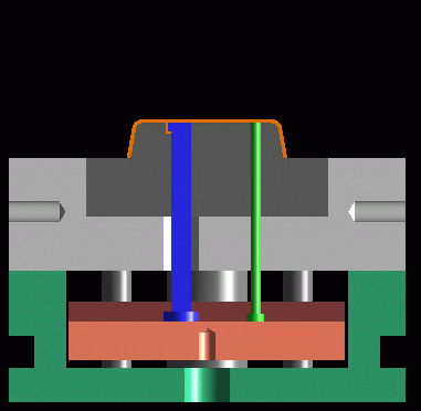

Step 7:
ejection process showing why witness marks appear
Step 8:
ejecting part
