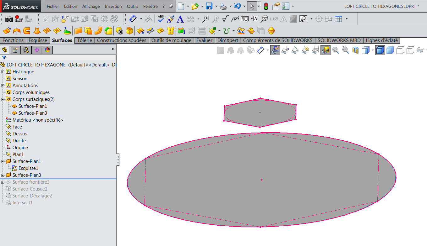

  1. Step 1:
    Before sweeping, creating a flat surface with the hexagon along the circle. This will give the opportunity to sweep tangeance with the circle.
  2. Step 2:

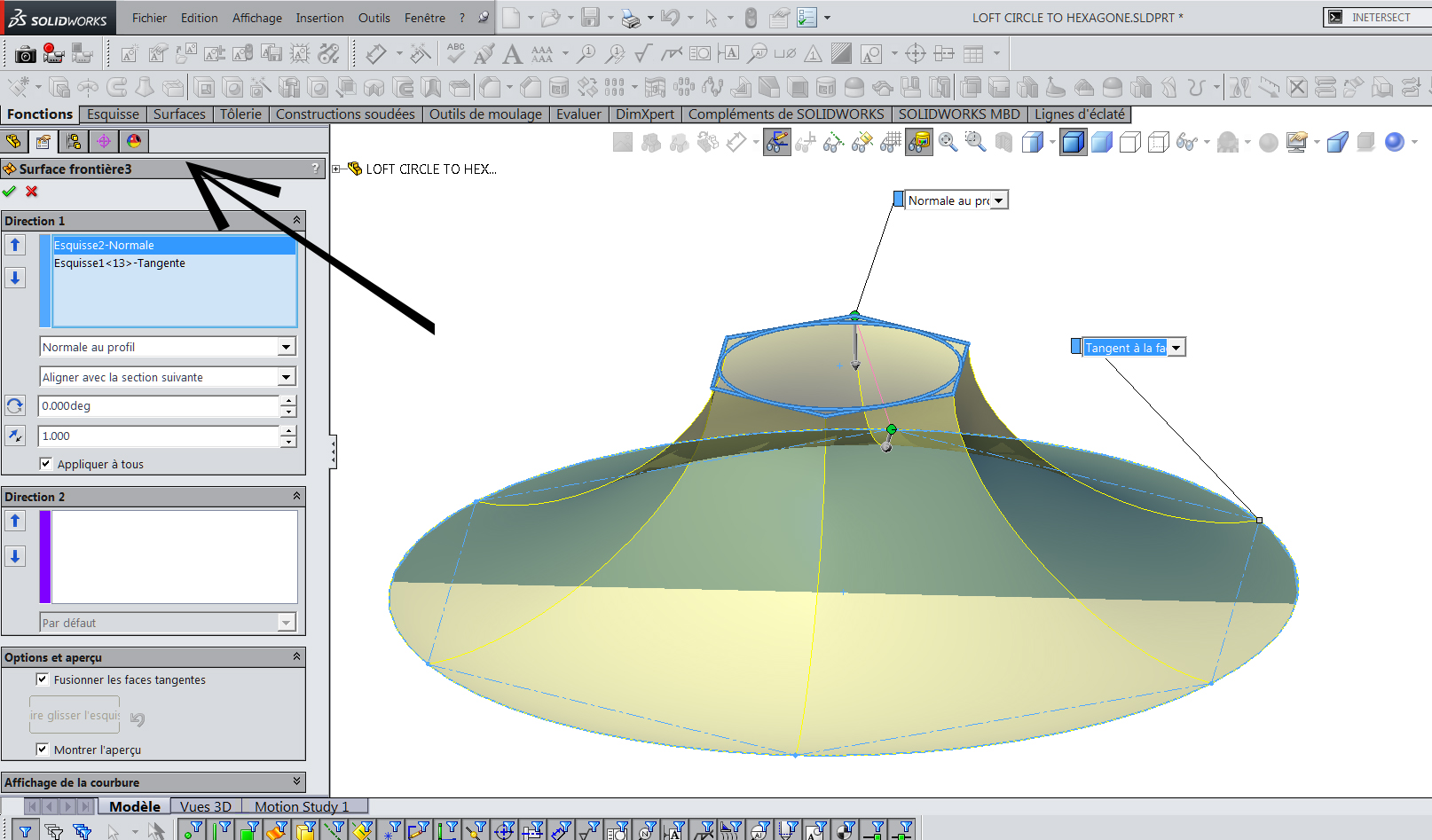

    Use boundary surface hexagonal before circle and put it normal to the surface
  3. Step 3:
    You can choose the circle profile and put it tangeant to the surface
  4. Step 4:
    Now you need to knit all surfaces and "try to make a volume" with them. See my SW 2015 file.
