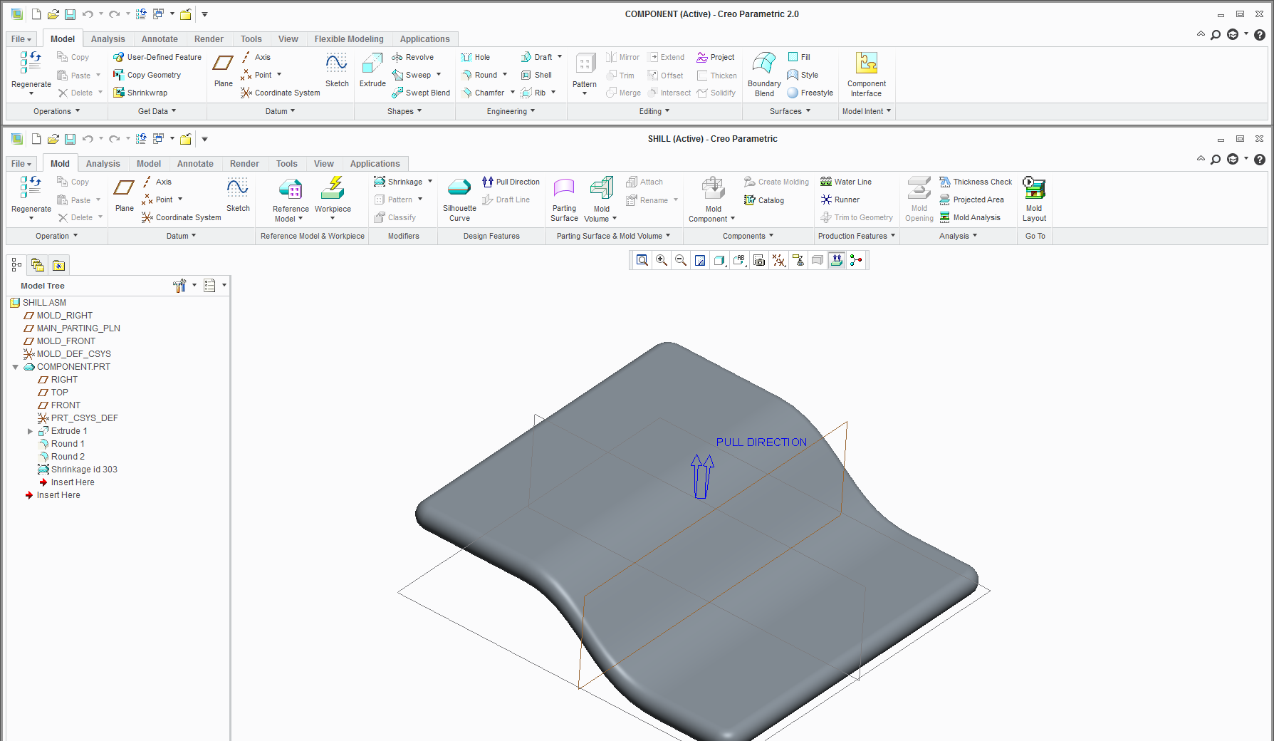

Generally shelhoutte curve type of parting surface are used for splitting 3D shapped pipes, and components with full round edges. I took a simple plastic component with full round edge as shown in the image
Step 2:
Refer previous tutorial to assemle the component . else follow these steps
1-file-new-manufacturing then click mold cavity
2- Assemble the component as shown in the image -

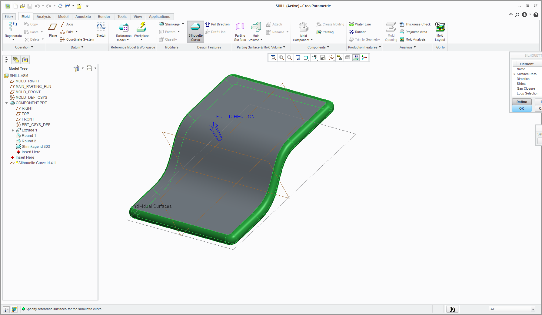

Step 3:

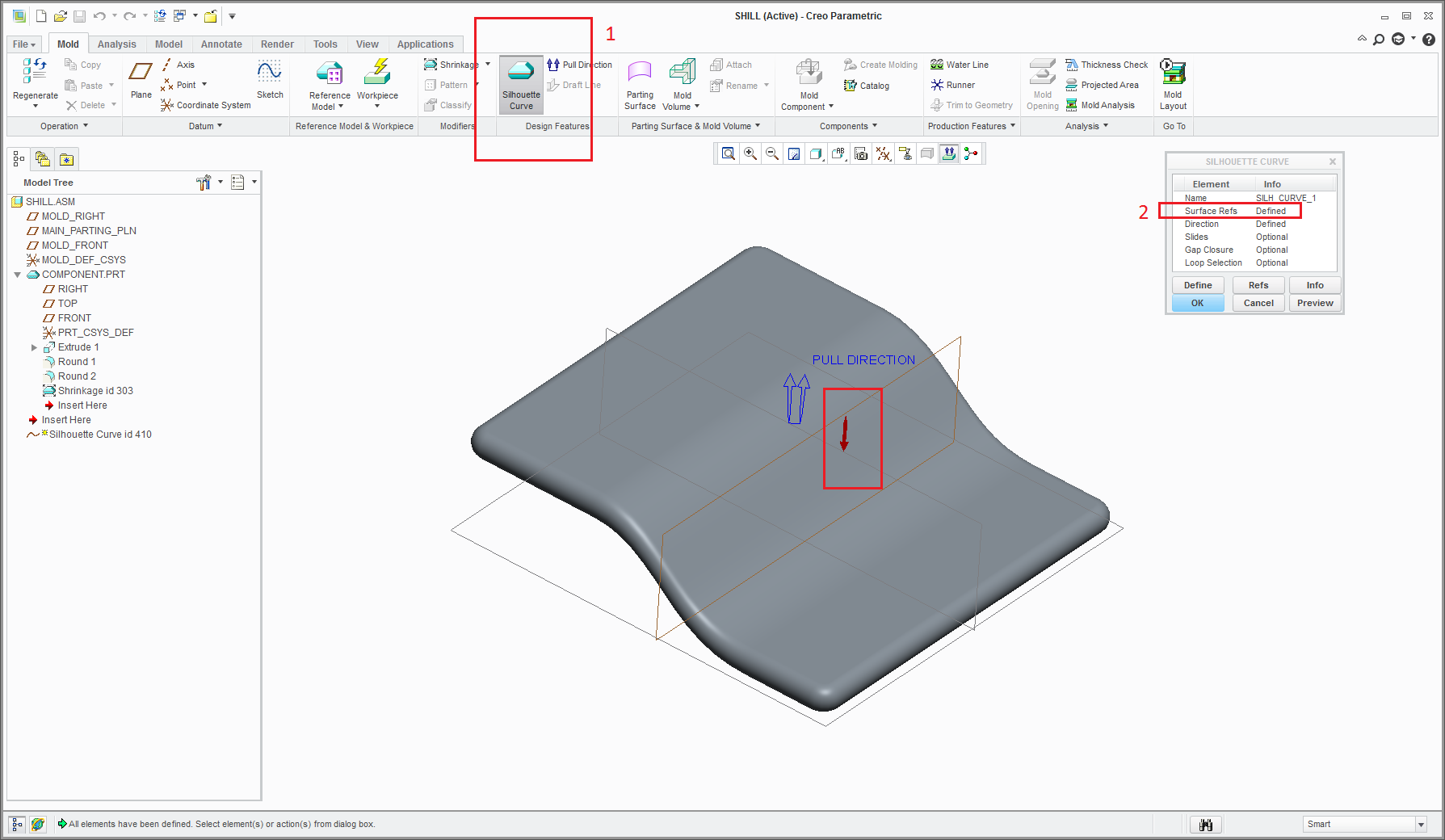

Once you assebled the component properly , you can click "silhoutte curve" and select the surface. You should select all the full round surfaces as shown in the image
Step 4:
Image shows the selected surfaces, for complicated components you need to define the direction plane also

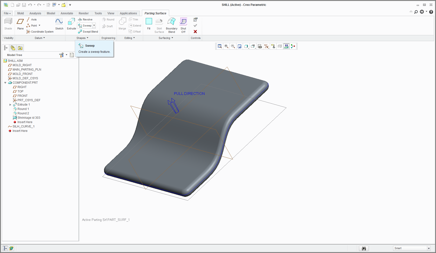

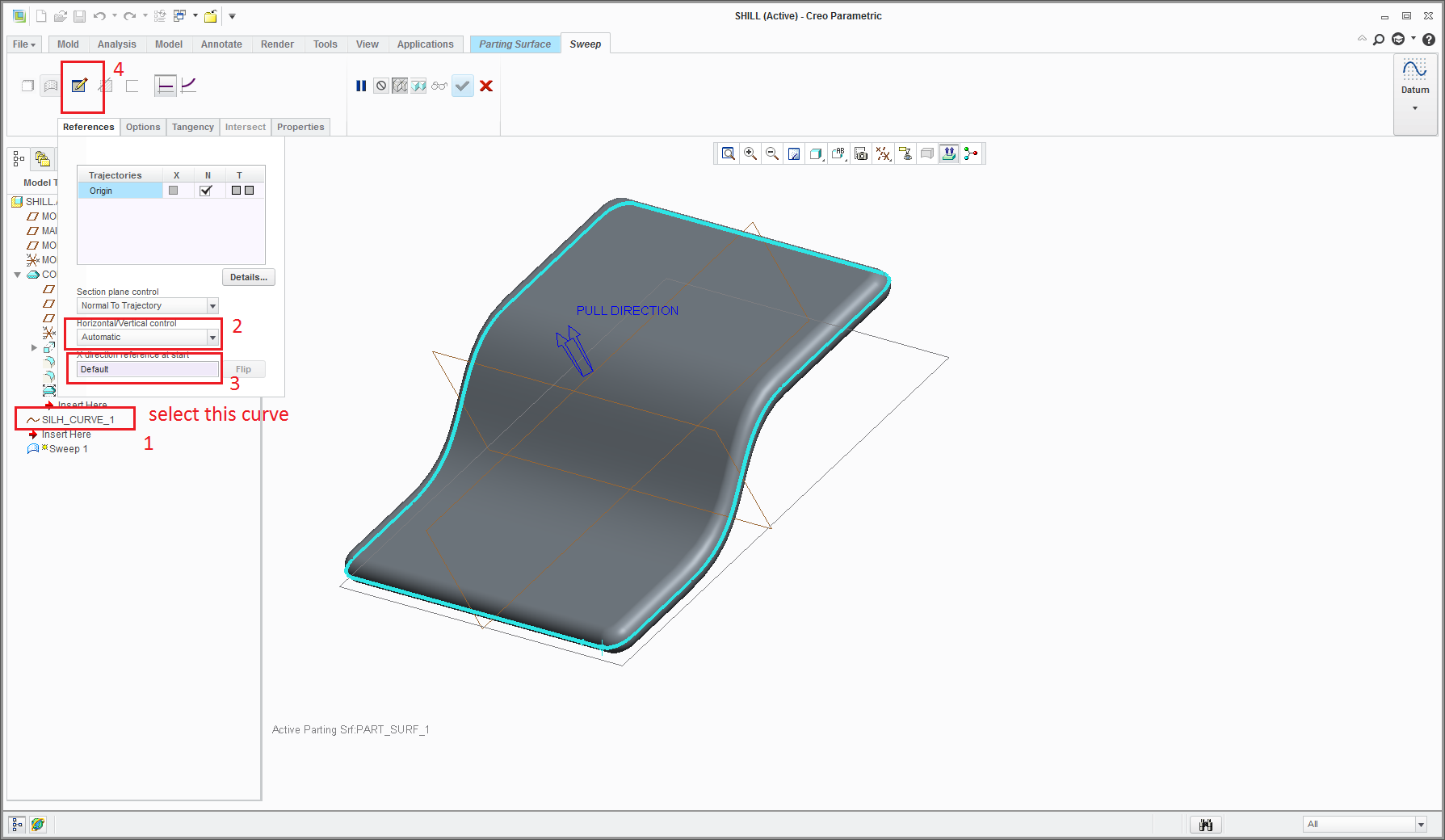

Now you need to create a parting surface from the created silhoutte curve using sweep feature as shown in the image
Step 6:
You need to select that silhoutte curve and follow the steps as shown in the image and next you need to create a sketch (sweeping profile)

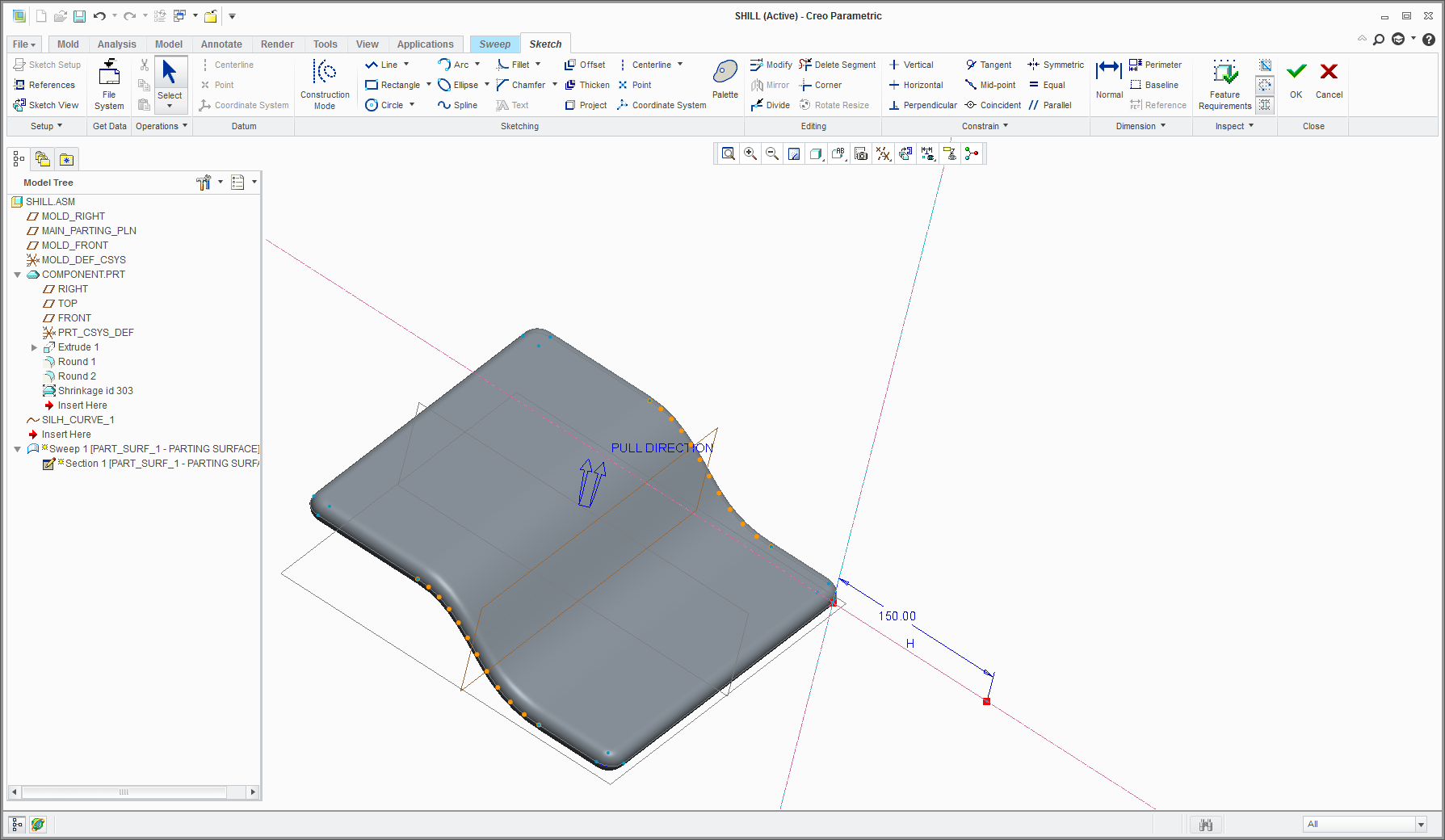

Step 7:
Just create a straight line of required length as shown in the image. We should keep in mind that this surface should cut the work piece which we will create in coming steps
