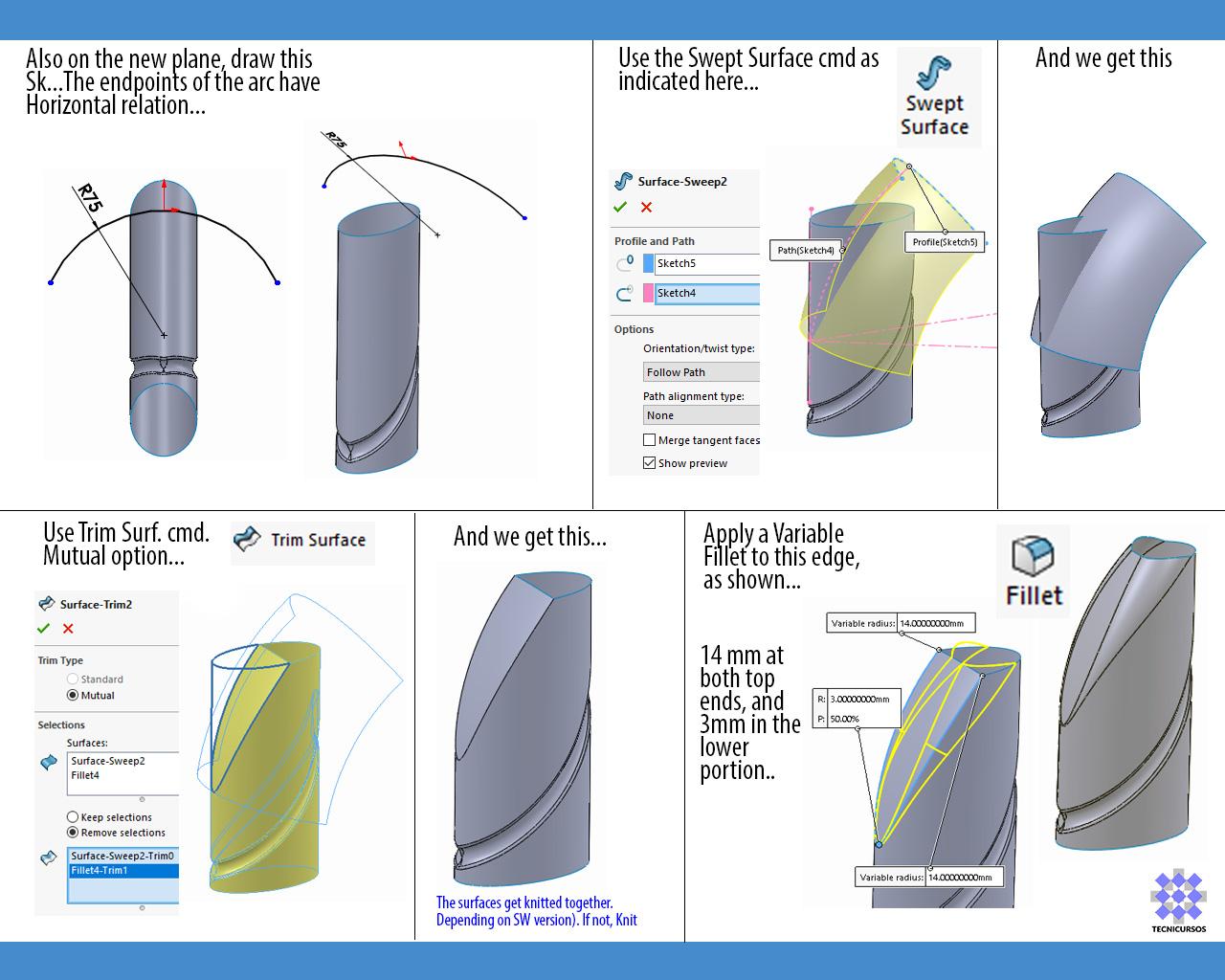

Step 1: First Extruded Surface & Wrap cmd...
Wrap is almost unknown, but you can achieve extraordinary results with it...
Step 2: Swept surface & Knitting...
Step 3: Removing unwanted Half...
And mirroring. Also new plane for new cutting surface...
Step 4: Swept Surf. & Cutting Shoulder...
Step 5: More Cutting action...
And improving one of the fillets...
