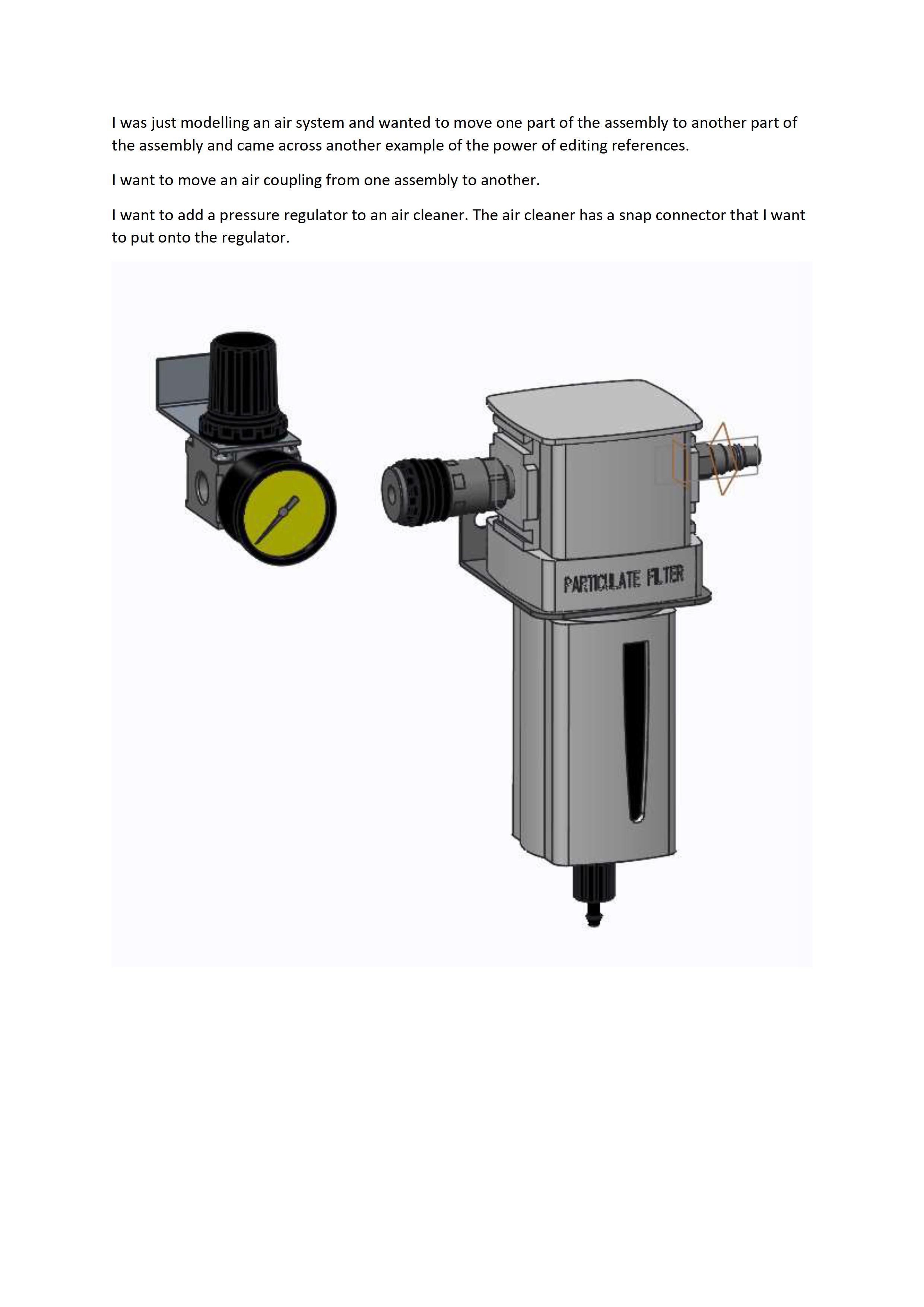

A function in Creo that can save a lot of time.
I use it a lot and thought it could be helpful.

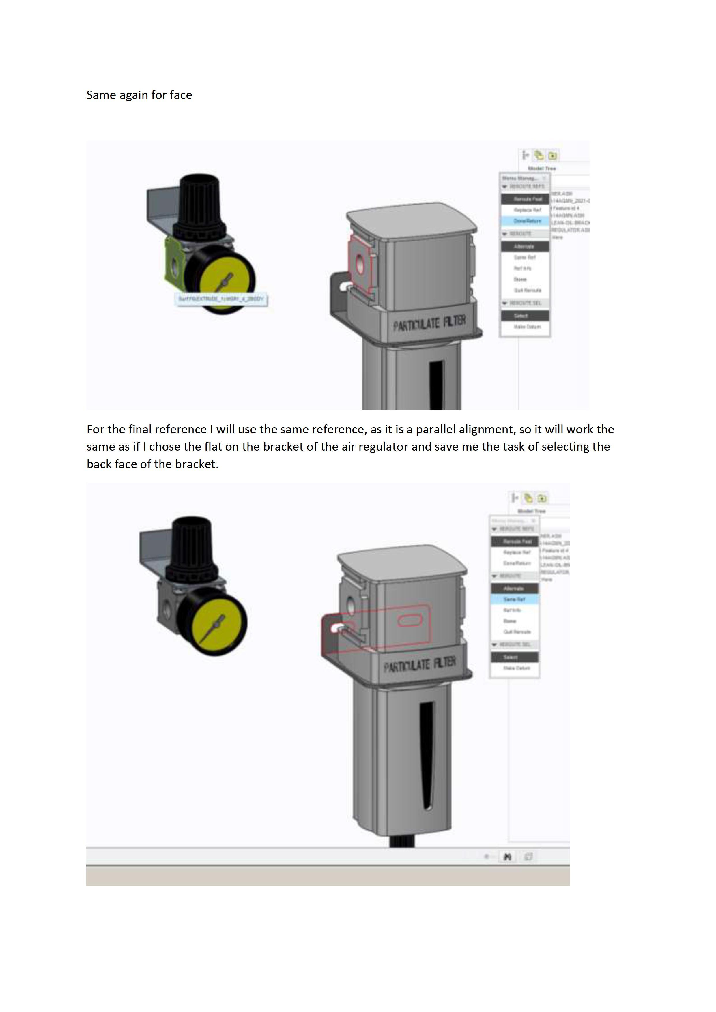

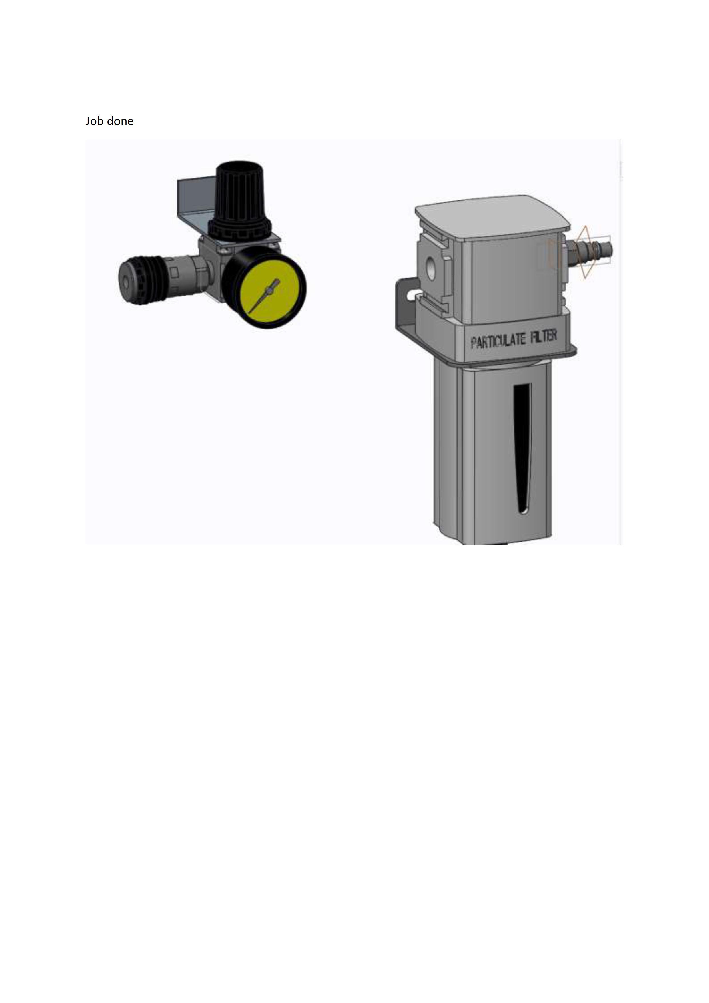

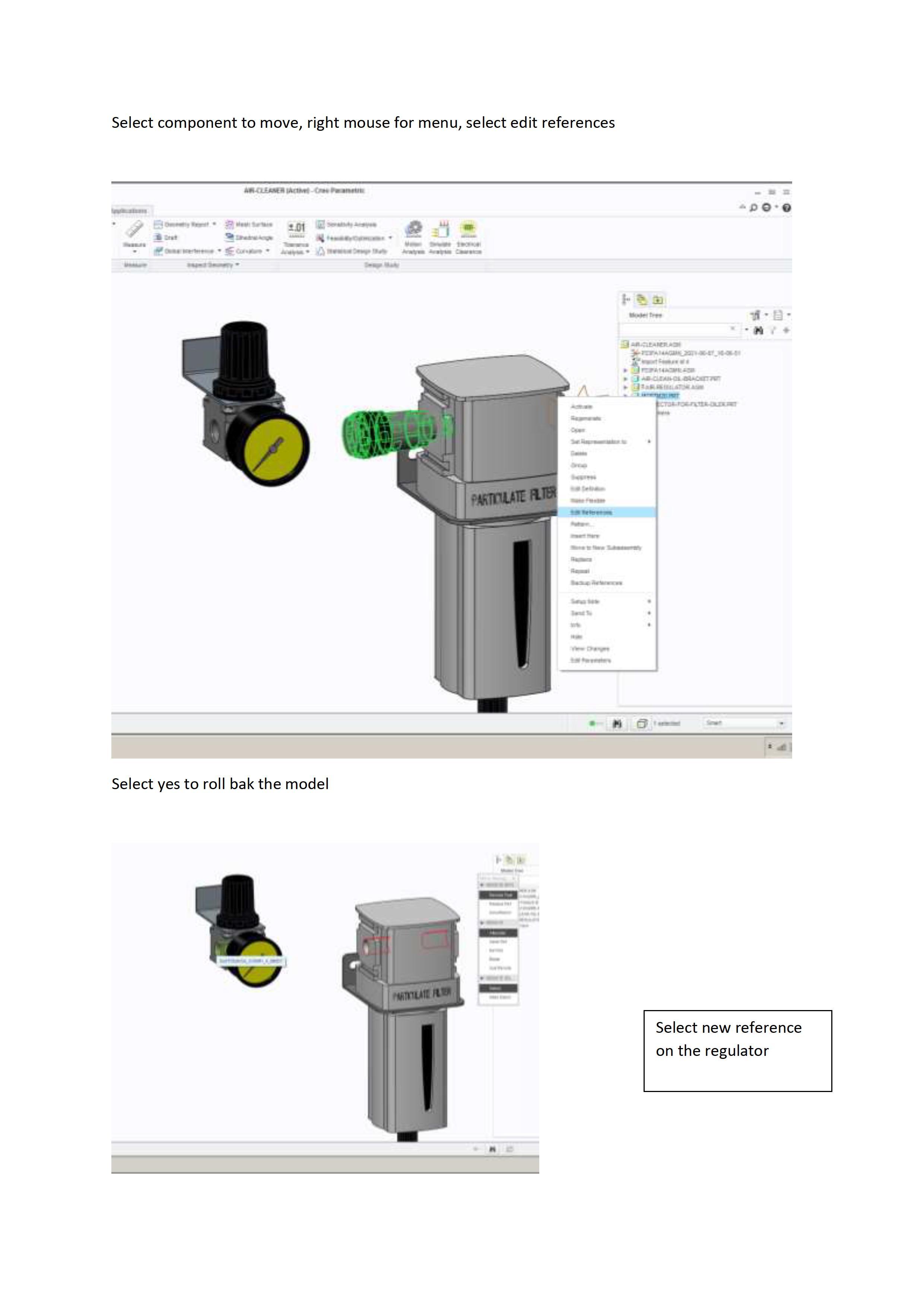

Step 1:
Modifying assembly reference
Step 2:
