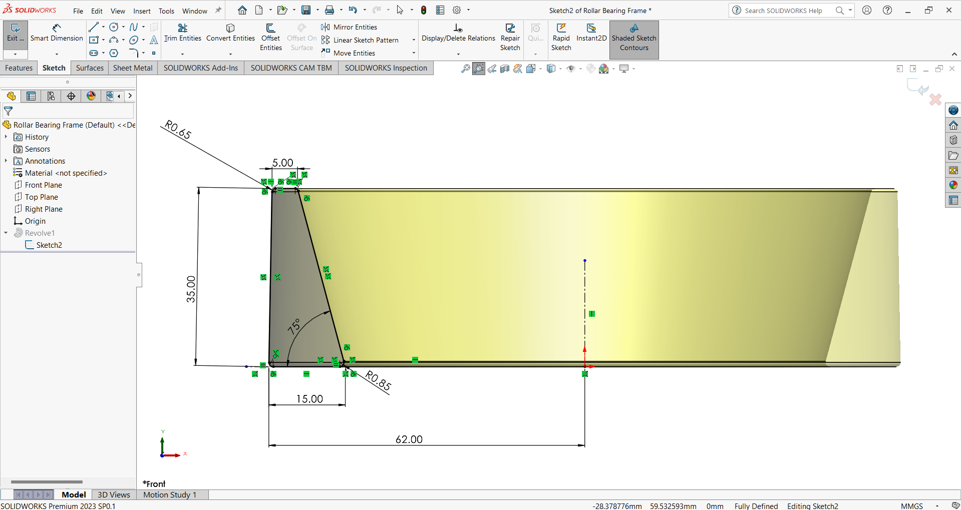

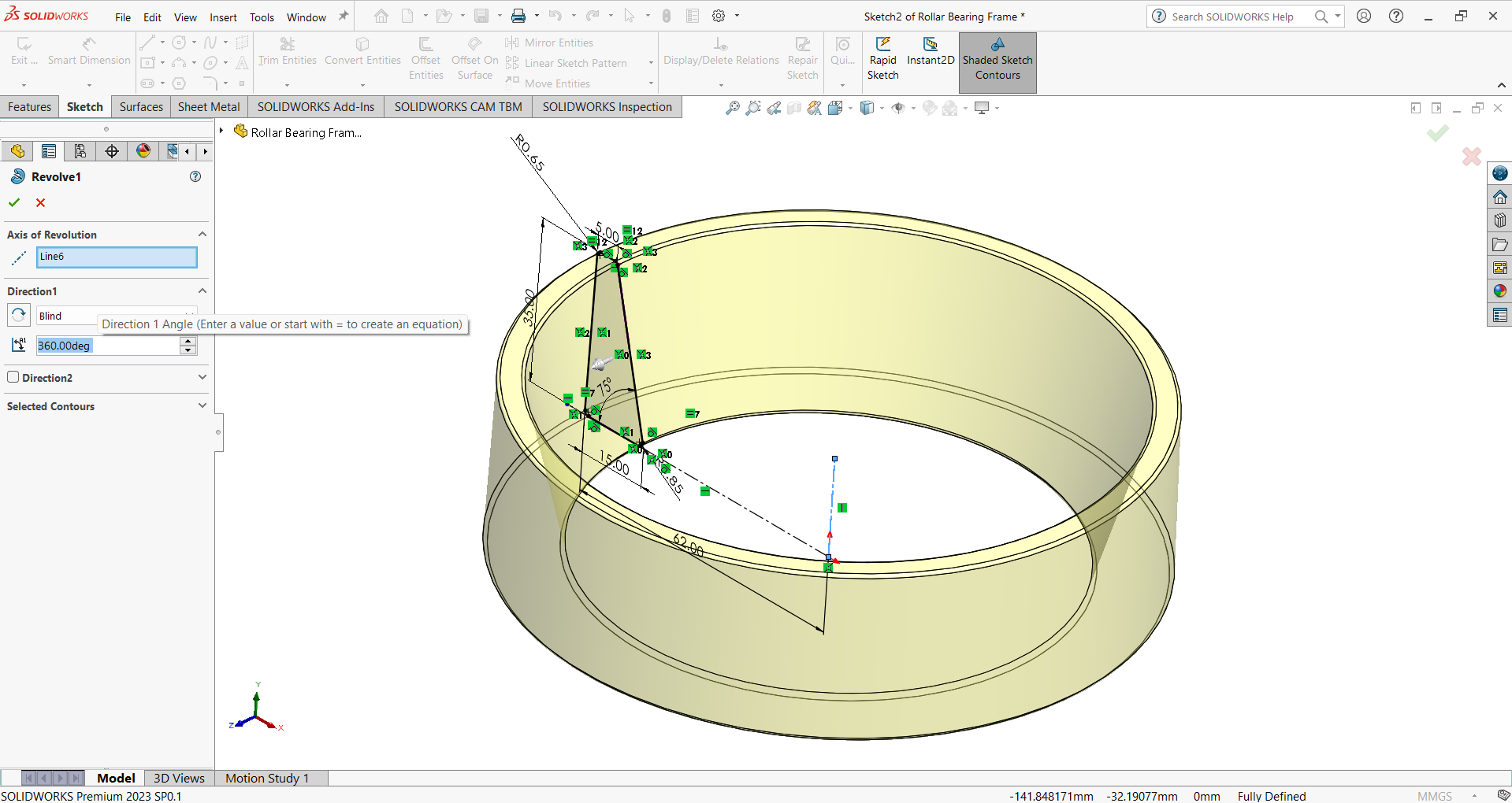

  1. Step 1: Making Outer ring
    Step 1:
    Make sketch of the ring.
    In the picture you will find all measurements.
    Step 2:
    create solid body from sketch.
    Lets see the sectional view of the solid body.

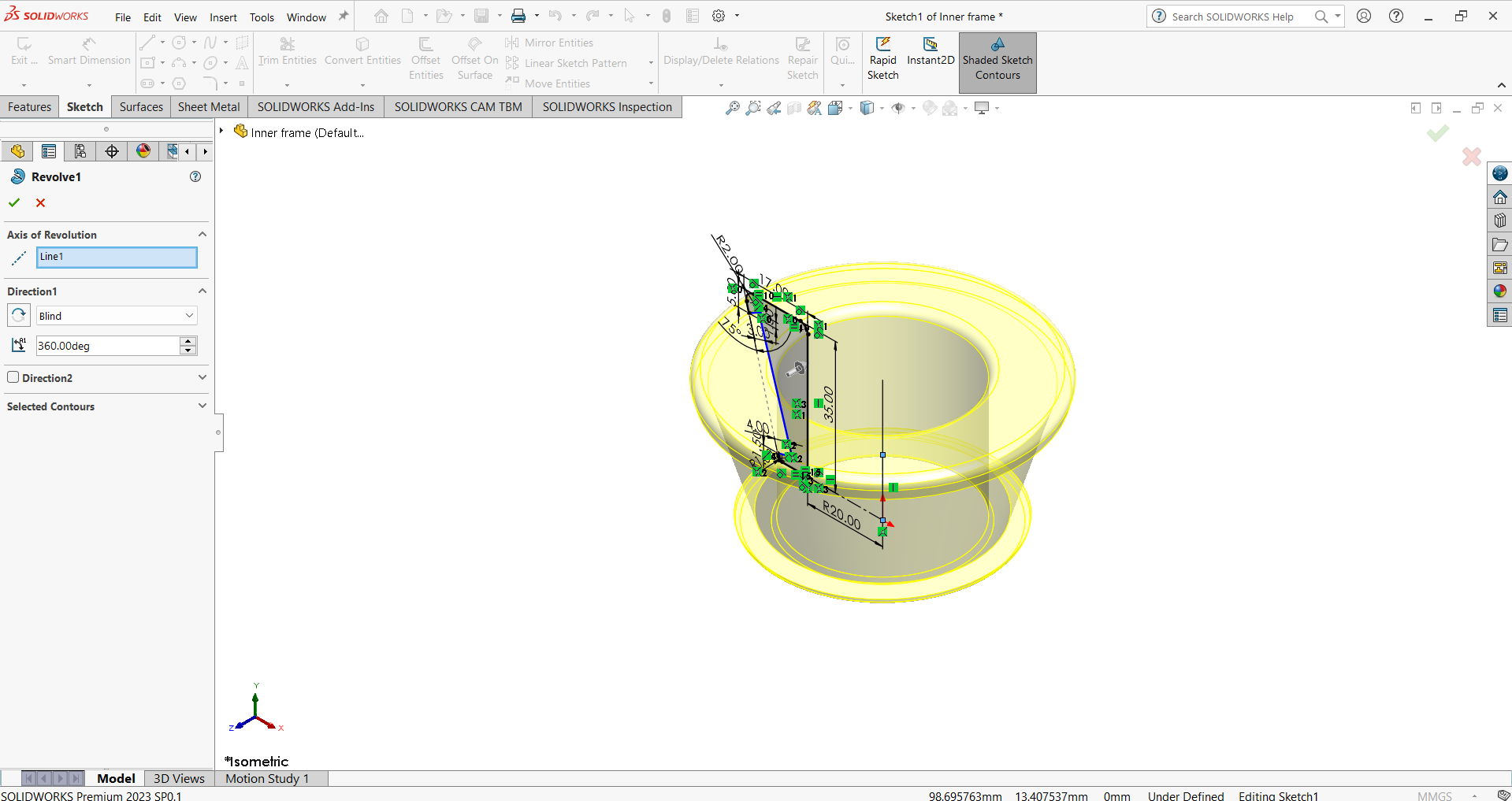

  2. Step 2: Making Inner ring
    Step 1:
    Step 2:
    Revolve the sketch.

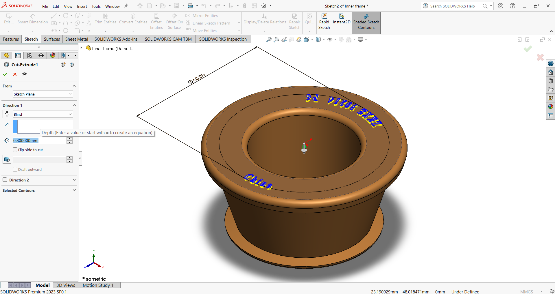

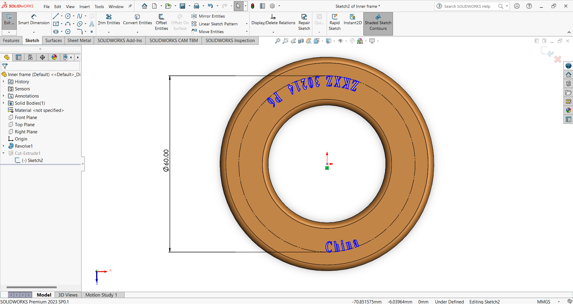

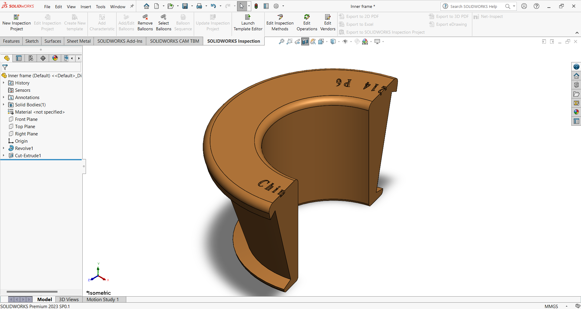

    Sketch model number, origin of manufacturer of bearing.
    Step 4:
    Extrude cut the sketch.
