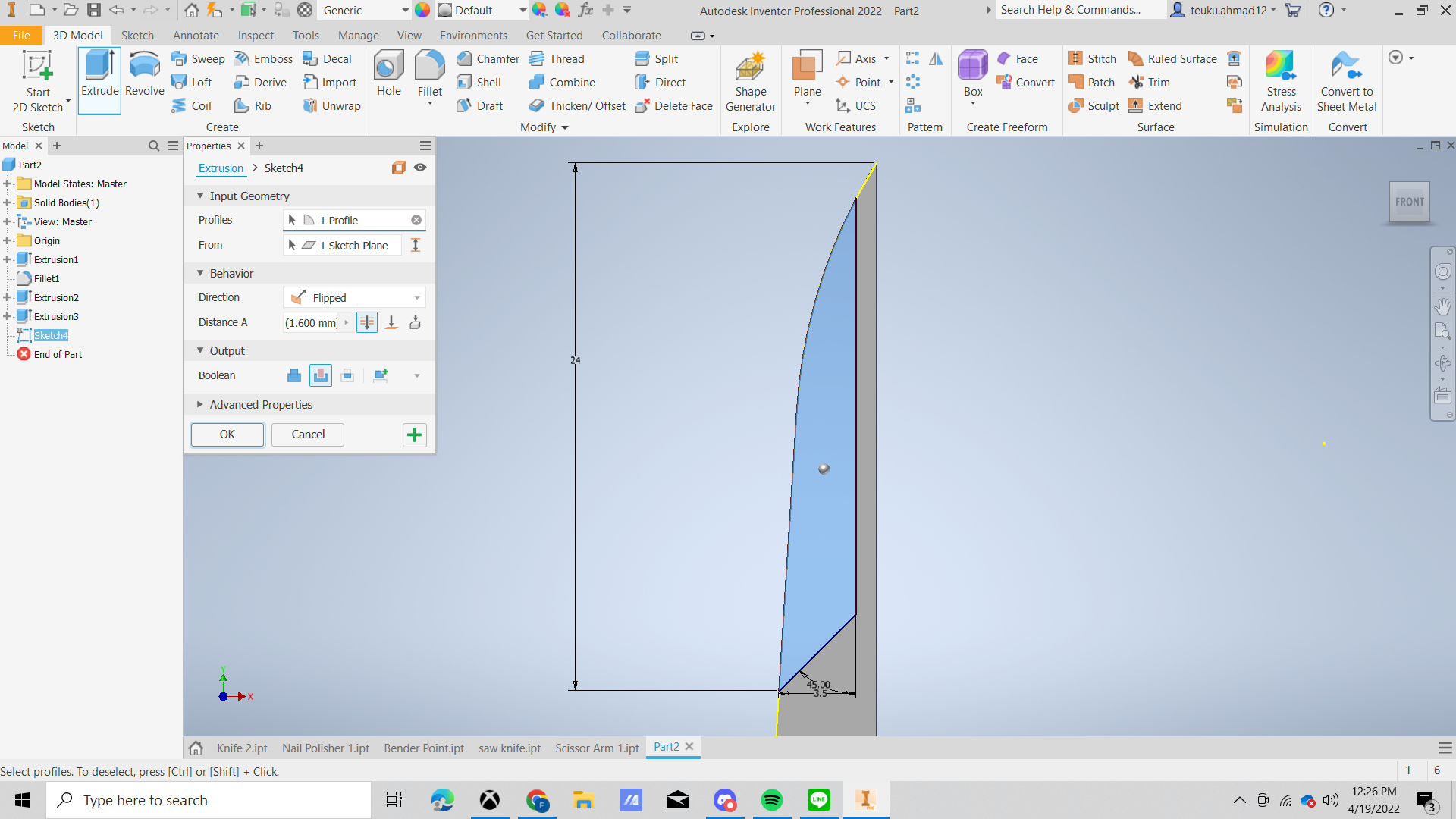

  1. Step 1:
    Make a rectangle with height is 78 mm and the width is 11.5 mm. after that draw straight line from the bottom with length 6 mm and than draw a straight line with a half circle in the middle with radius 5.1 mm and at the end of the line make a curve with radius 24 mm. and than make straight line to the bottom with length 30,75 mm and than make a corner with angle 25 mm and make straight line again with length 15.15 mm and than make a curve like a puple line in the picture and after that make a straight line to the bottom.
  2. Step 2:
    Extrude the Scissor arm with distance 1,6 mm

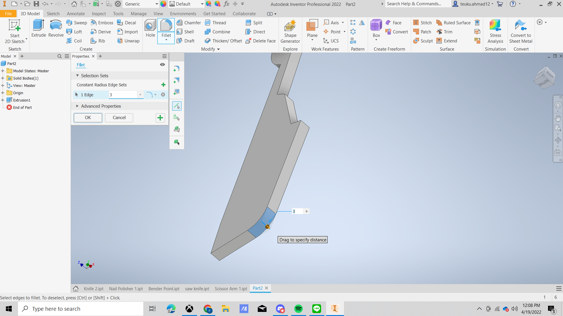

  3. Step 3:
    Fillet the edge like in the picture with radius edge is 3 mm

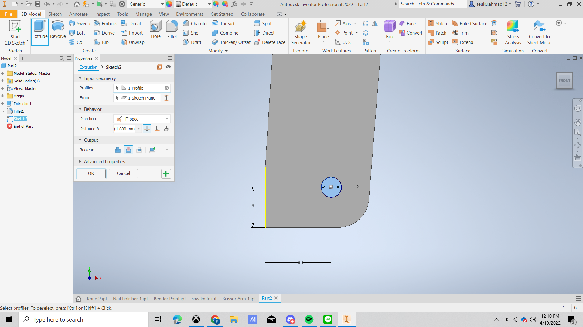

  4. Step 4:
    After that make a circle with radius 2 mm and the distance from the left line is 6,5 mm and the distance from the bottom line is 4 mm

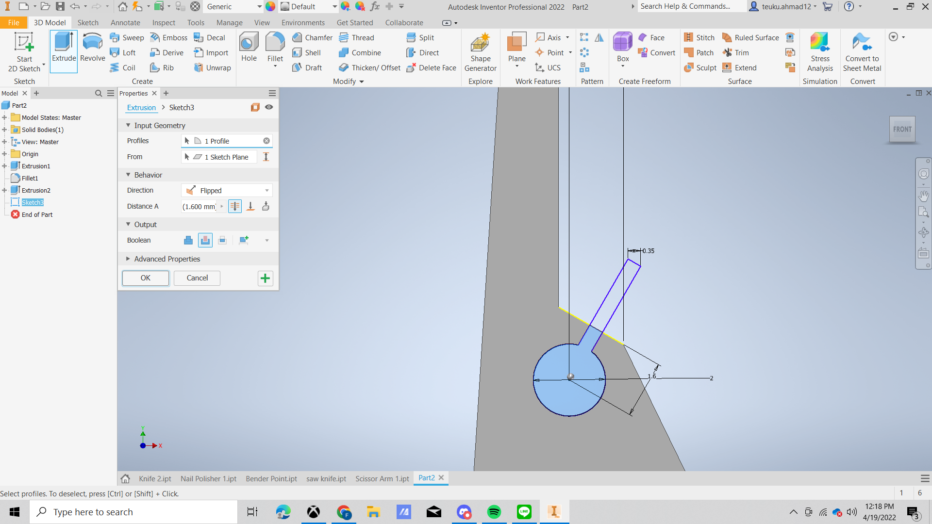

  5. Step 5:
    Make circle in the middle of the scissor with radius 2 mm. and also make a small rectangle like in the picture
  6. Step 6:
    And than trim the half rectangle until it looks like in the picture
  7. Step 7:
    Extrude the circle with direction is flipped and the distance is 1.6 mm
  8. Step 8:
    And than draw a line like in the pictire and make corner with angle 45 degree like in the picture
  9. Step 9:
    Extrude the section with the direction is flipped and the distance is 1.6 mm

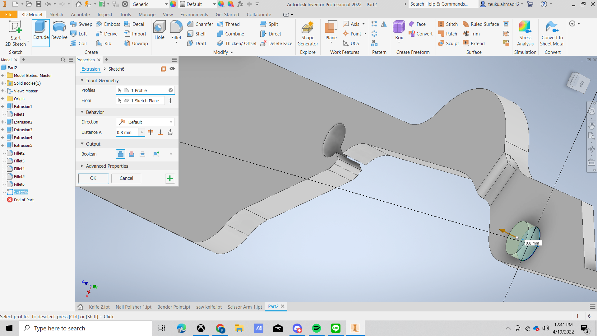

  10. Step 10:
    After that make a rectangle like in the picture and extrude with distance 0.8 mm
  11. Step 11:
    Fillet the edge like in the picture. in the picture 1 the radius edge is 3 mm and the picture 2 the radius edge is also 3 mm

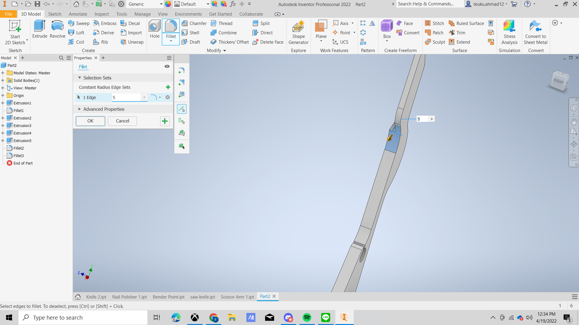

  12. Step 12:
    Fillet the edge like in the picture. in the picture 1 the radius edge is 5 mm and the picture 2 the radius edge is 0,4 mm

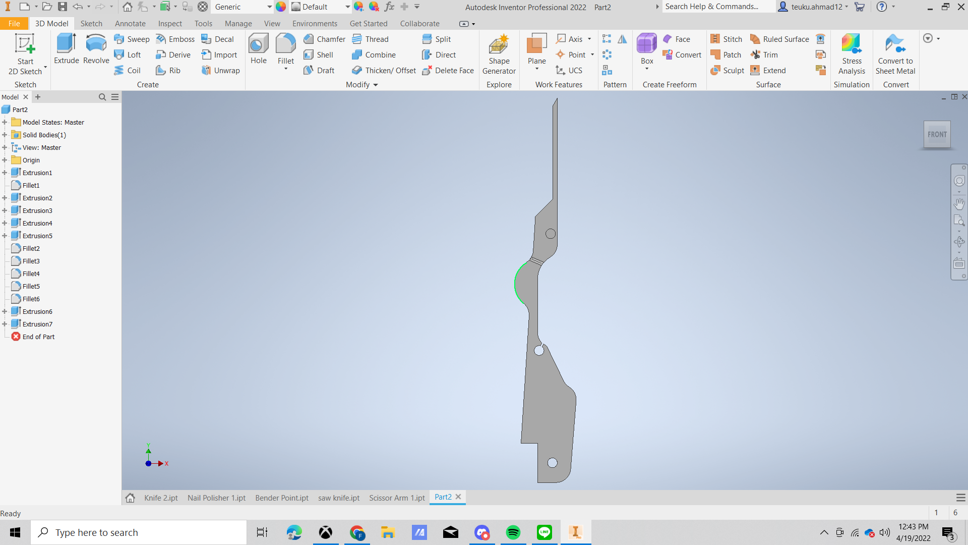

  13. Step 13:
    make circle like in the picture with radius 2 mm and then extrude with distance 0,8 mm
  14. Step 14:
    Make a small rectangle with height 8 mm and the width is 3,5 mm and then extrude with distance 1,6 mm
  15. Step 15:
    And the Scissor Arm 2 is done
