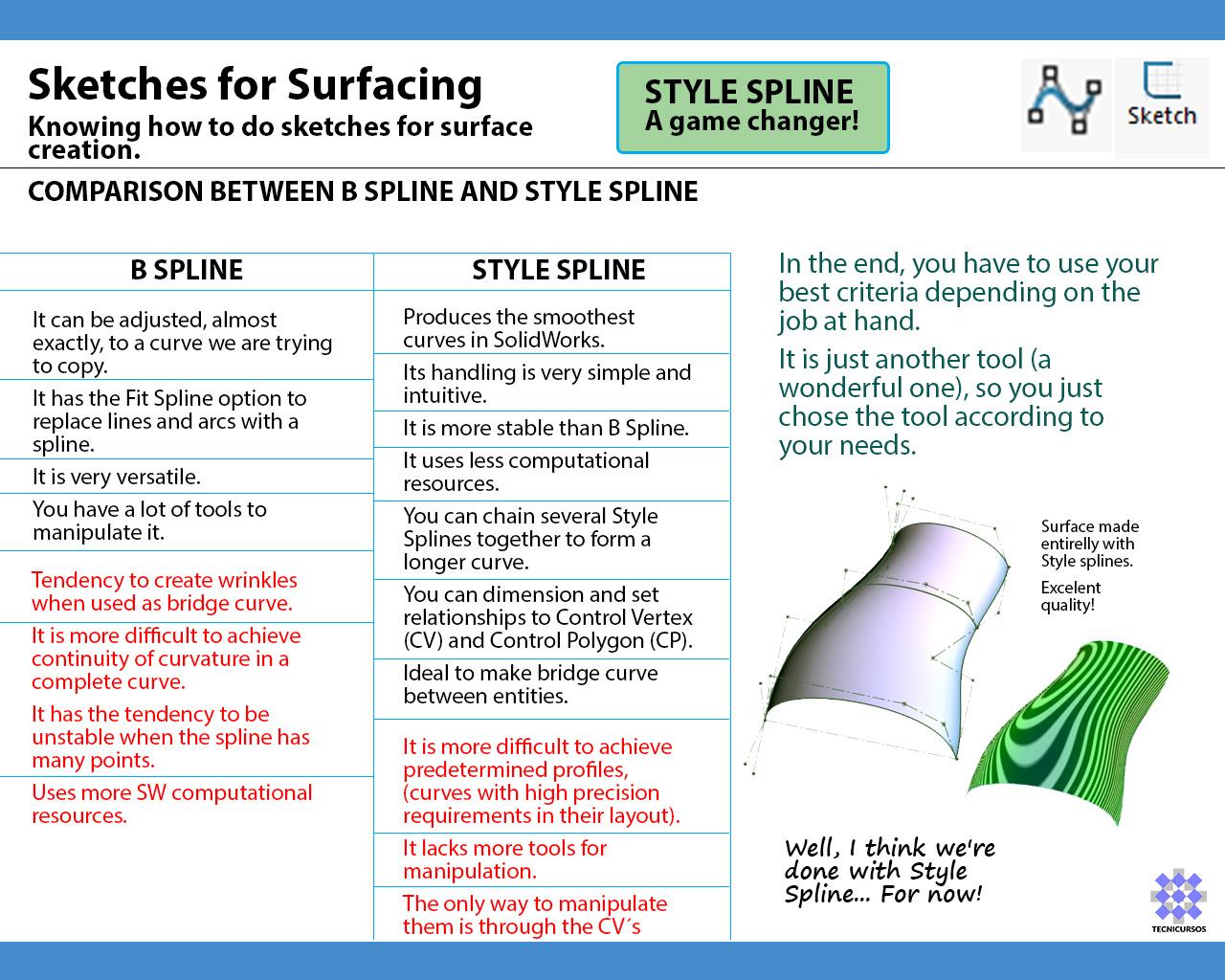

Here we study the powerful Style Spline tool, incorporated in SW in 2014, which allows us to get smoother and more stable curves and surfaces.

  1. Step 1: Style Spline.. A Game Changer...

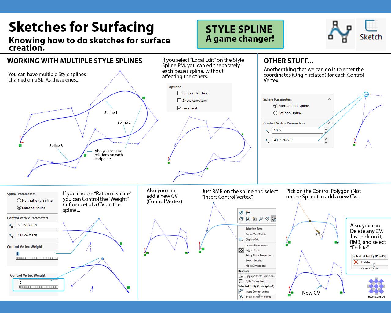

  2. Step 2: Things you can do...

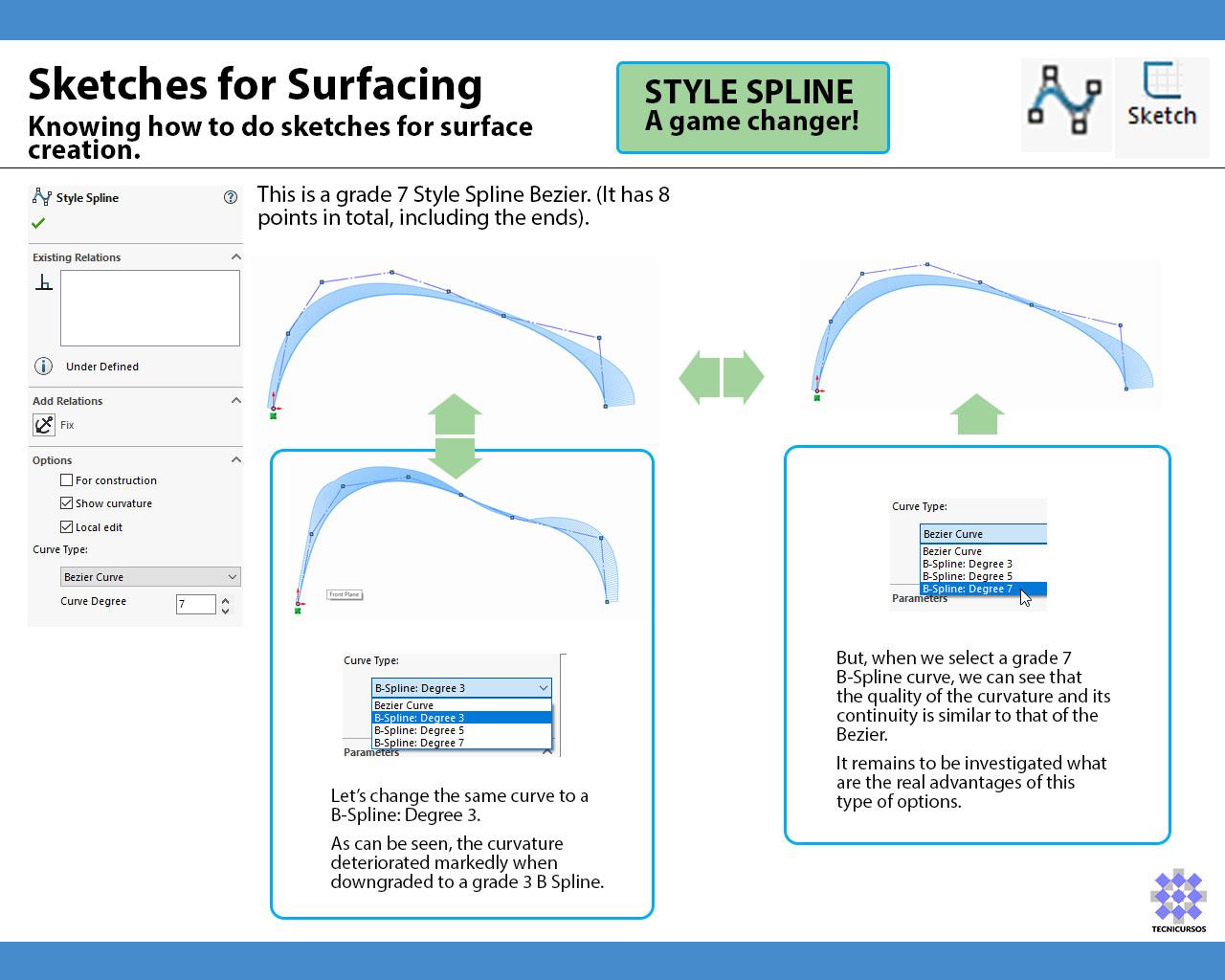

  3. Step 3: Understanding Curve Degree...
  4. Step 4: Bezier & B Splines...
  5. Step 5: Multiple Splines & More...

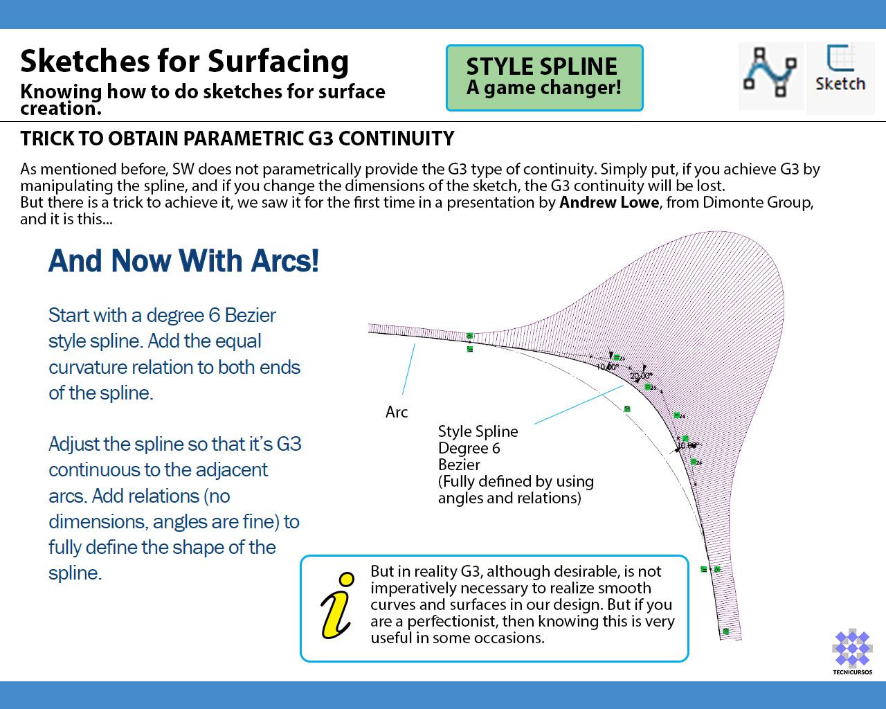

  6. Step 6: G1, G2 & G3 Continuity...(!?)
  7. Step 7: Parametrical G3...
    In fact, SolidWorks 2020 now includes G3 continuity.
    But for those who don't have that version of the program, there is good news. We can get G3 with this trick...
  8. Step 8: B Spline Vs Style Splines...
