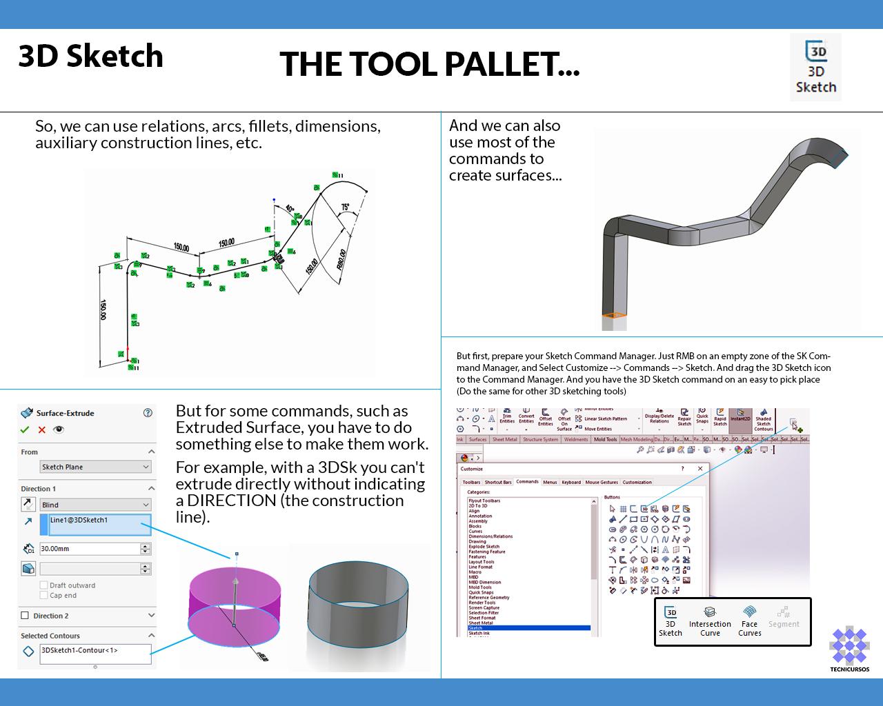

Surfacing with SolidWorks 15
This time we begin the study of 3D Sketch's capabilities to help you create surfaces.
We will look at some limitations of 3DS, and some advantages it has.
Don't miss the next lessons.
Step 1: The Tool Pallet for 3D Sketch...
Step 2: Some details & Preparation...
Step 3: Surfacing With 3DSketch...
Step 4: Using Frames for Surfaces...
