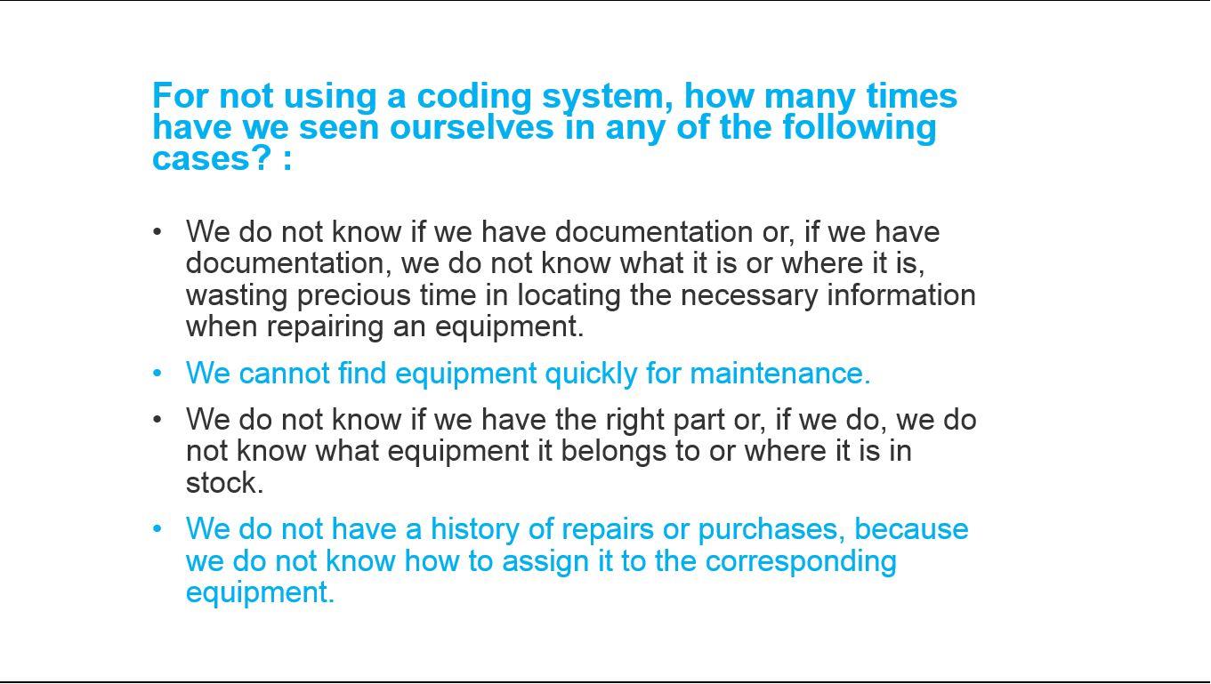

Step 1: 1St. Step for Control & Maintenance

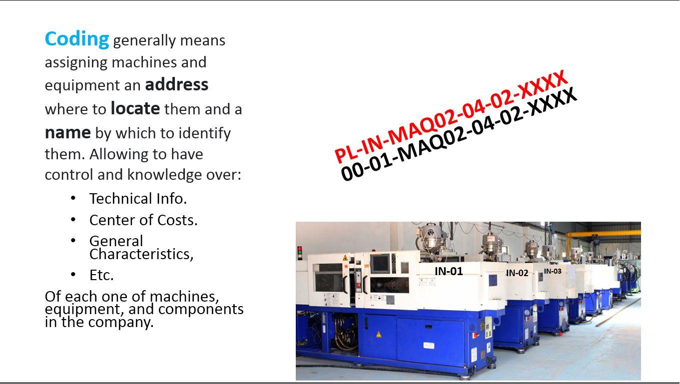

Step 2: Coding Meaning...
Step 3: Non-Coding Consequences...

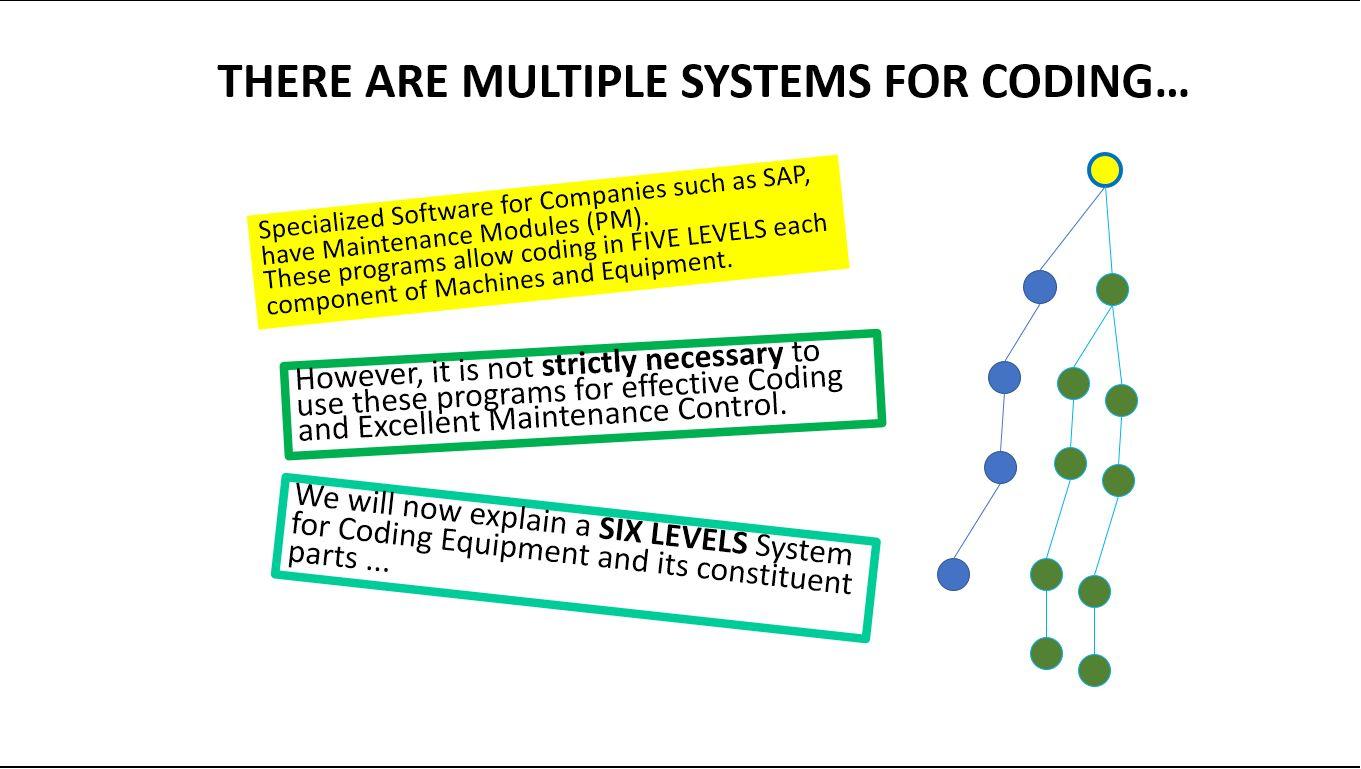

Step 5: Coding Systems...

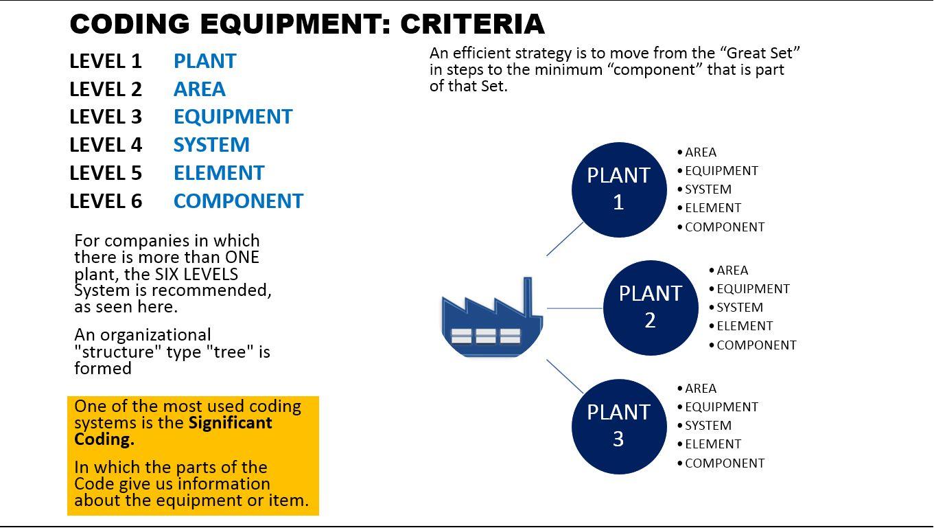

Step 6: Coding Structure (Tree)...
Step 7: Coding Industrial Plants...

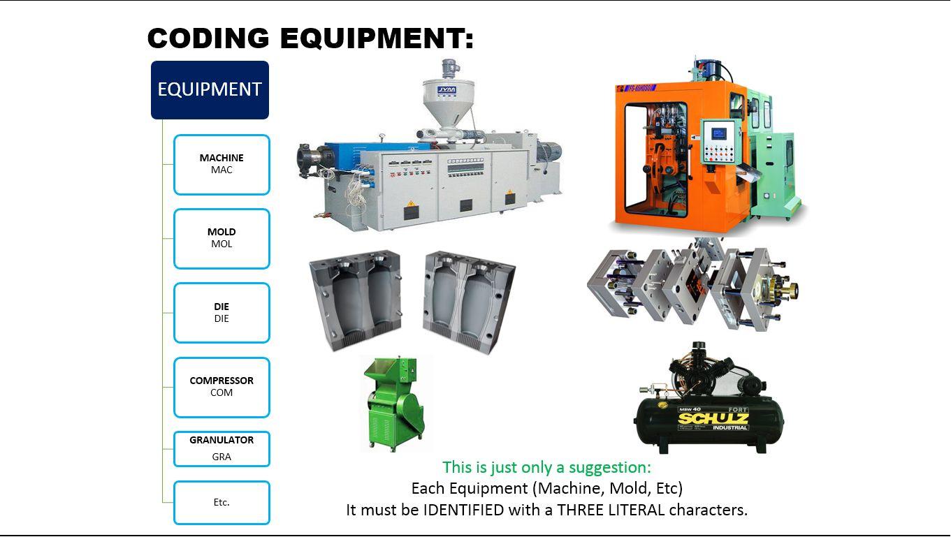

Step 8: Coding Equipment...

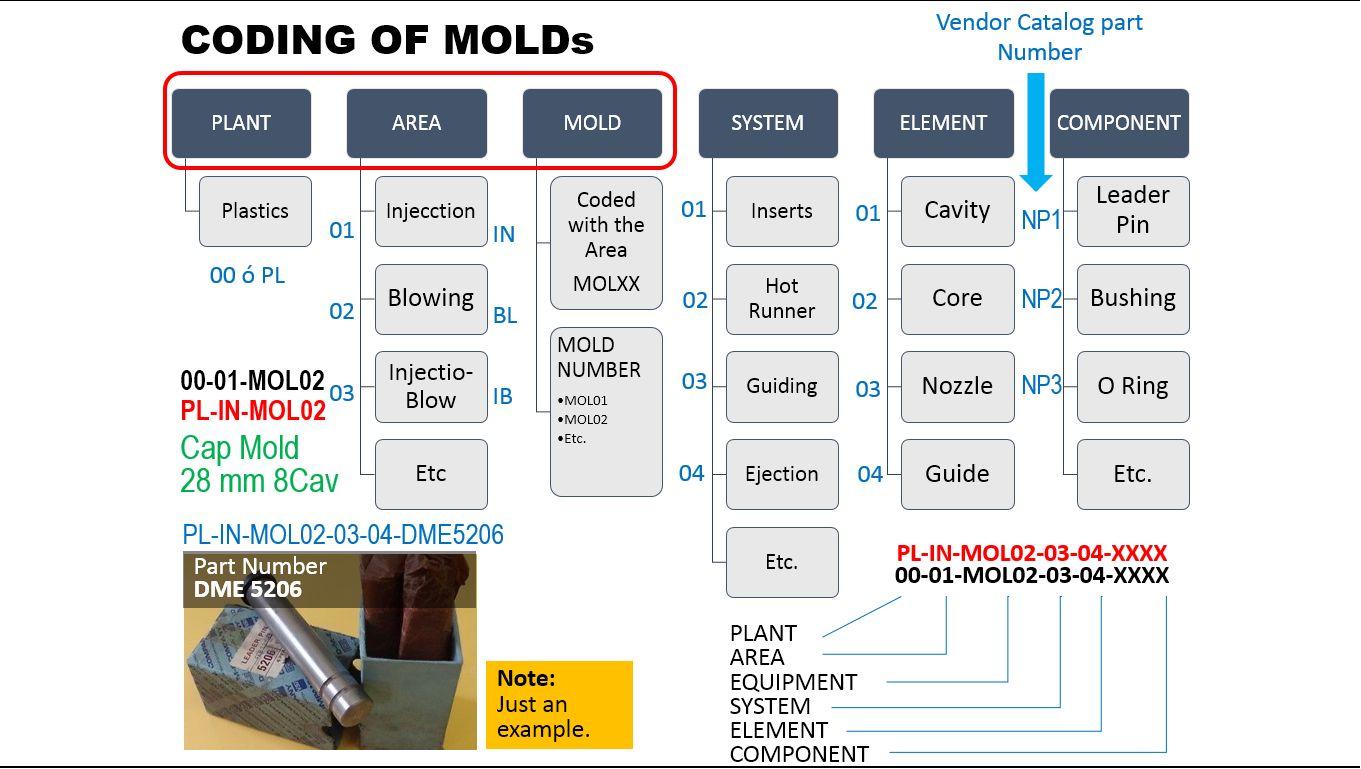

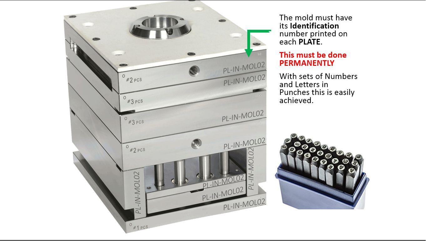

Step 9: Coding Molds...
Step 10: Coding Molds...
