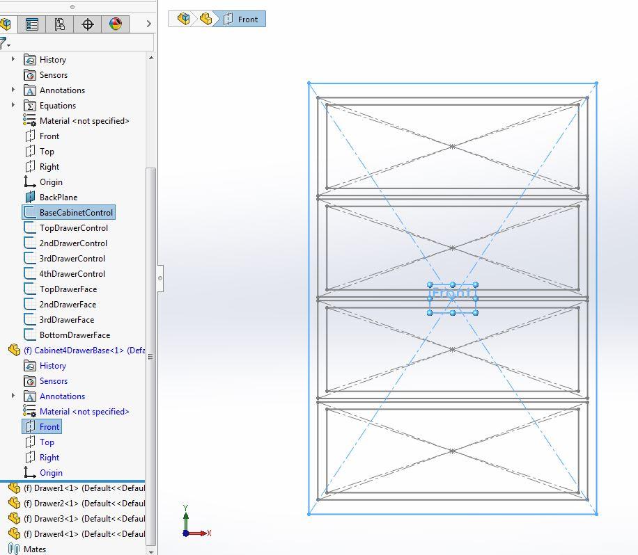

  1. Step 1: Create the Control Part
    Create sketches with dimensions defining the cabinet, the drawers, and the cut-outs for the drawers in the cabinet case. Link your dimensions to variables in the Equations list & save this as your control part. Also define a Plane offset from the front plane that controls the depth of the cabinet.
  2. Step 2: Create the Assembly
    Create an assembly and insert your control part as the first part in the assembly.  Create 5 empty parts with names for the cabinet case, and one part for each of the 4 drawers and insert those into the assembly by just checking okay when prompting for position (i.e., all parts are constrained so their Front, Right, and Top planes are constrained to the Top, Front, & Right Planes of the Assembly.) These parts are empty parts with no sketches or any geometry at this point.
  3. Step 3: Insert Derived Sketches
    1. Edit in place the cabinet case in the assembly. Select the cabinet case sketch in the Control Part and then Ctrl select the front plane in the Cabinet Case part that is being edited. With those two items selected, now Insert a Derived Sketch (In the Insert Pull-down menu), locate the derived sketch and constrain its orientation by constraining the center at the origin, and one of the corners to the original Control Part sketch.
