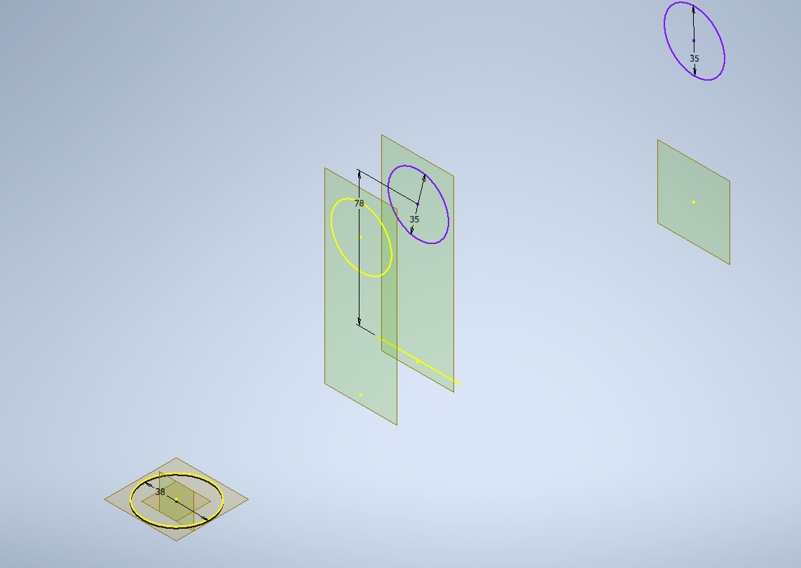

  2. Step 2: Offset Plane for Future Lofting
    Create a new plane offset from the origin's XZ plane some small height away.
    Create the same sized circle on this new offset plane. This will be used for making the curved leg solid later on.

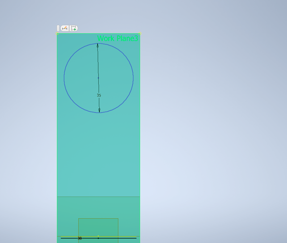

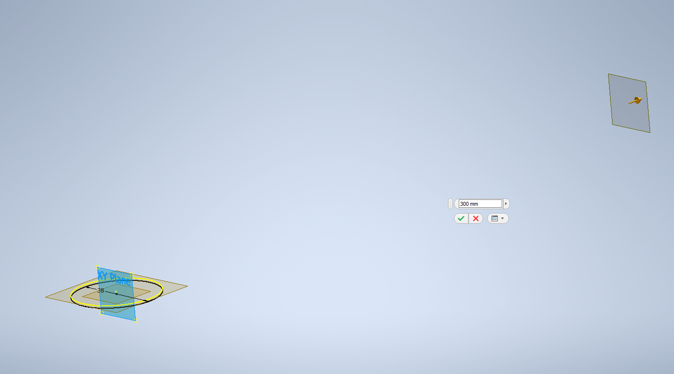

  3. Step 3: Sketching End Point of Leg
    We want to create the point at which the leg will extend to from the bottom, in other words the point where multiple legs will meet at the center.
    Create a plane offset from the origin's XY plane some distance away based on the intended leg length. In this scenario we use 300mm.
    Sketch a circle on this plane, located some height above the original center of the plane to create elevation between the base of the legs with the meeting point at the center. The diameter should still remain the same.
    Resizing the plane by dragging its corners to make the sketching more comfortable is possible.
  4. Step 4: Sketches for Lofting Steps

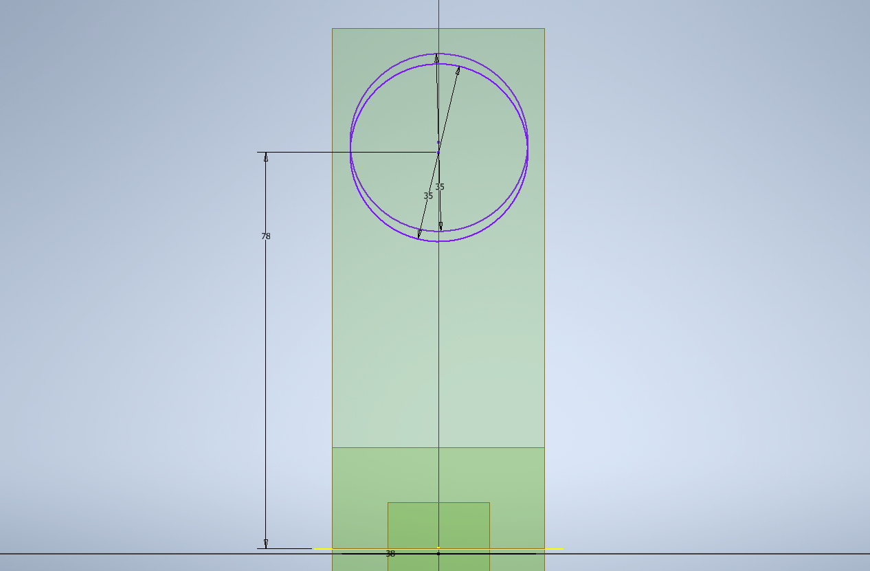

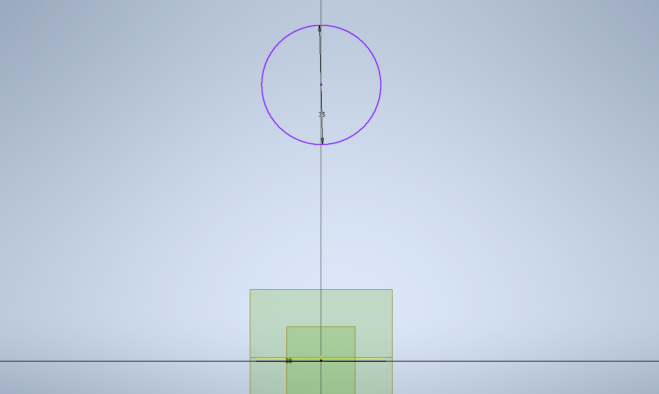

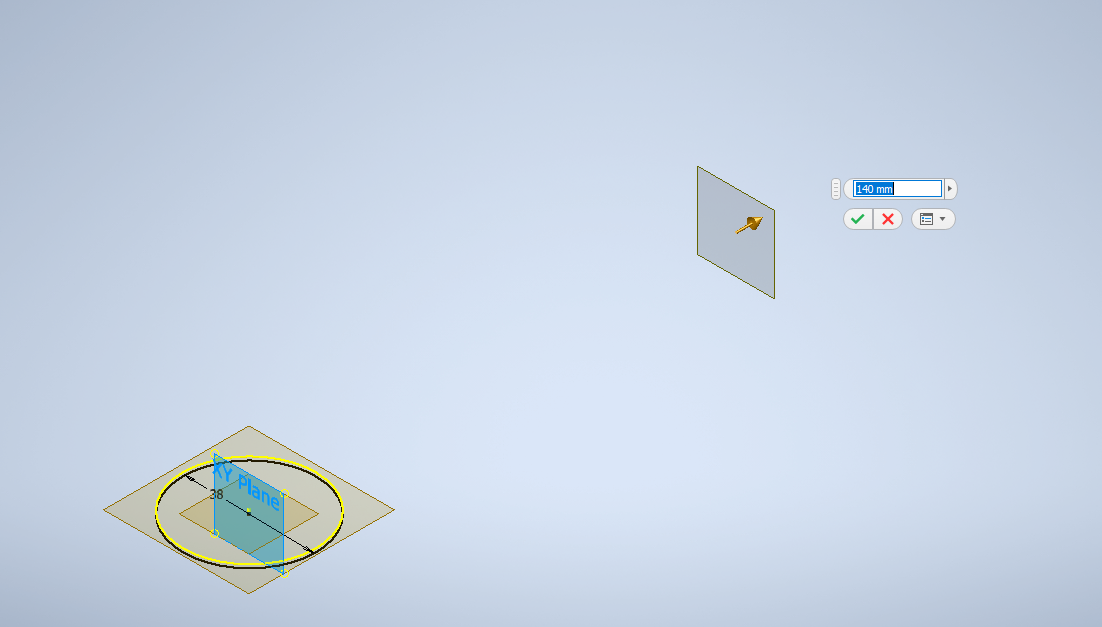

    Since we plan to use the 'Loft' feature to create the curved leg solid, we need to create more circular sketches along the path we want to have the leg be curved on.
    Use the same procedure to create a plane offset from the XY-origin, this time a shorter distance than the previous. Here we use 140mm in comparison to the previous 300mm.
    Resize the plane to reach about the height of the previous circle to make it more convenient.
    Sketch a circle with a height lower than the one on the previous elevated plane. The height change is arbitrary depending on how much curve is desired.
    Repeat the same process for as many times as necessary based on the intended curving shape. More elaborate curves may require more planes with more height change between the circles.

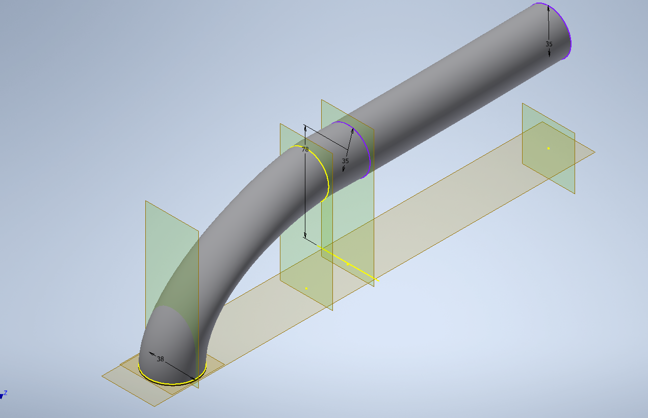

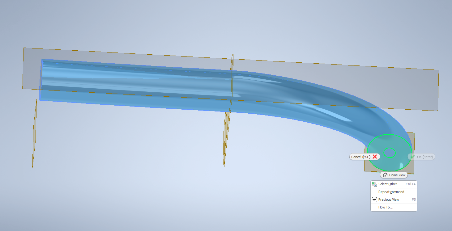

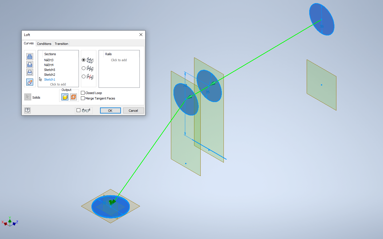

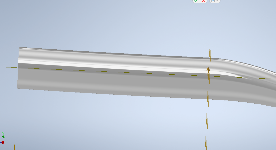

  5. Step 5: Lofting
    Using the Loft feature, select the 'New Solid' function (lowest from the four selections). Select the sketches that have been created (make sure to make them visible first) in order from the top to the bottom. If it is not in order, the loft may fail to be created.
    The result should look similar to this.

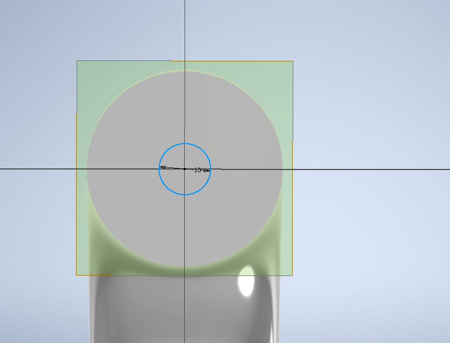

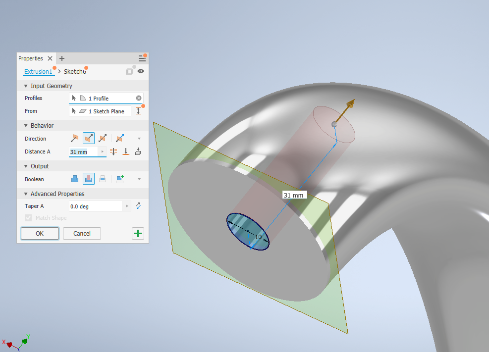

  6. Step 6: Hole for Wheel Mount
    Sketch a small circle with the bottom of the leg as the plane.
    Extrude this circle some height away to create room for the future wheel-mount part.

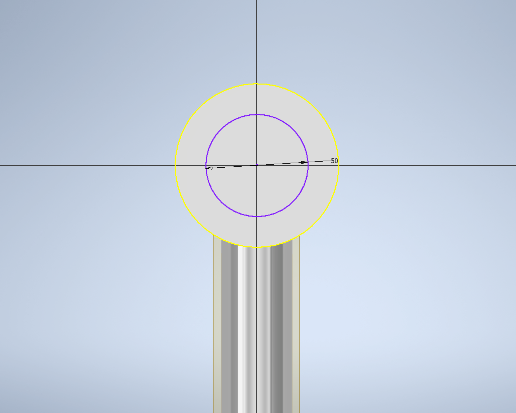

  8. Step 8: Hole in Center Piece for Vertical Stand
    This step is necessary for allowing the legs to be assembled with the vertical stand connecting the seat above.
    On the center piece that has been created, sketch an ideally large circle with the top as the surface.
    Next, start a new sketch on the opposite (bottom) side of the center piece, sketch a circle smaller than the upper part. This part is optional based on the intended shape of the vertical stand bottom. Since our part has a narrowing section on the vertical stand, we need to create a narrowing hole.
    Loft using the 'Join' function between the two circles to create a suitable hole.

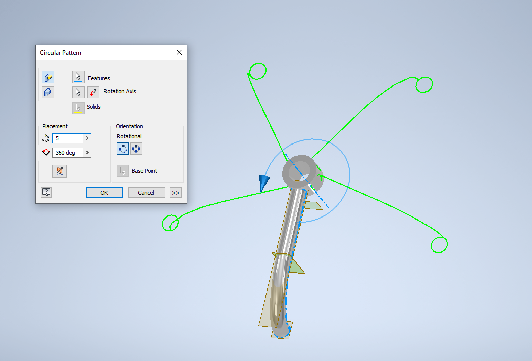

  9. Step 9: Circular Pattern
    Using the Circular Pattern function, select the Loft (leg) as the feature and select the center piece as the rotation axis.
    In the Placement section, enter the intended amount of repetitions along the desired angle of rotation. In this case since we want to create five total revolving legs around the center piece, we use 5 pieces and 360 degrees of rotation.
