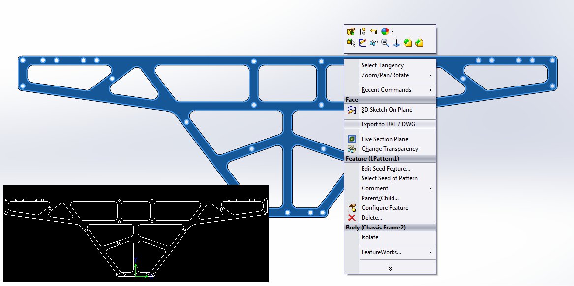

Step 10:
Need a DXF file for cnc laser or plasma cutting? use DXF / DWG export
