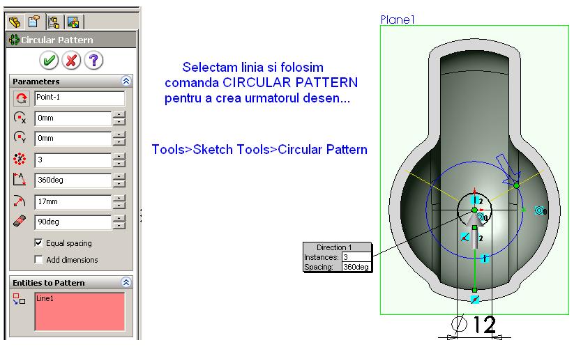

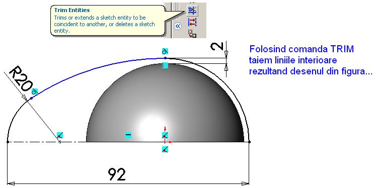

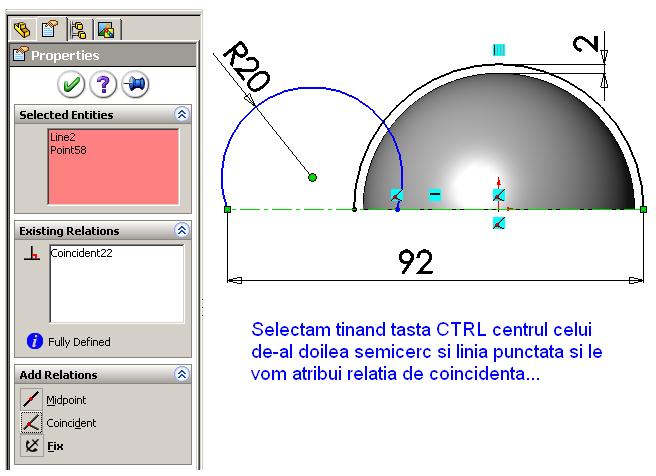

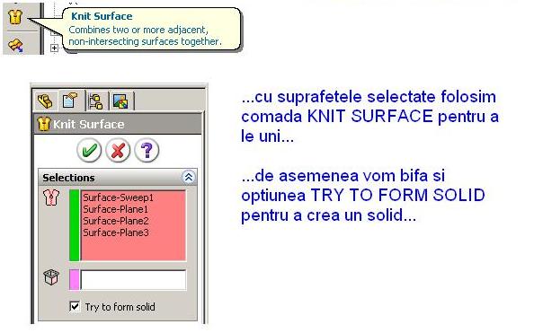

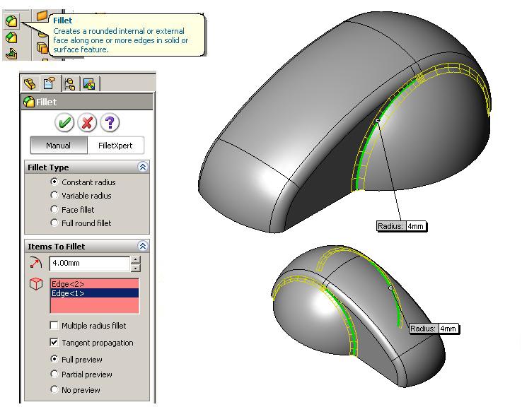

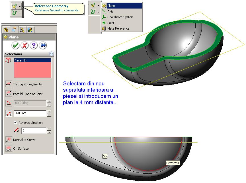

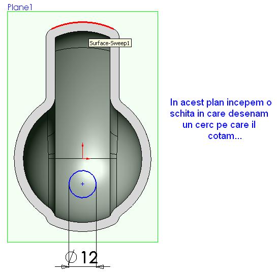

Step 1:
The knob.

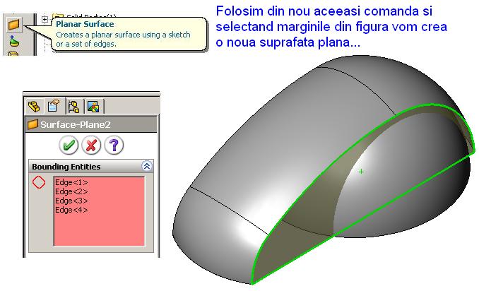

Step 2:
Step 1
Step 3:
Step 2

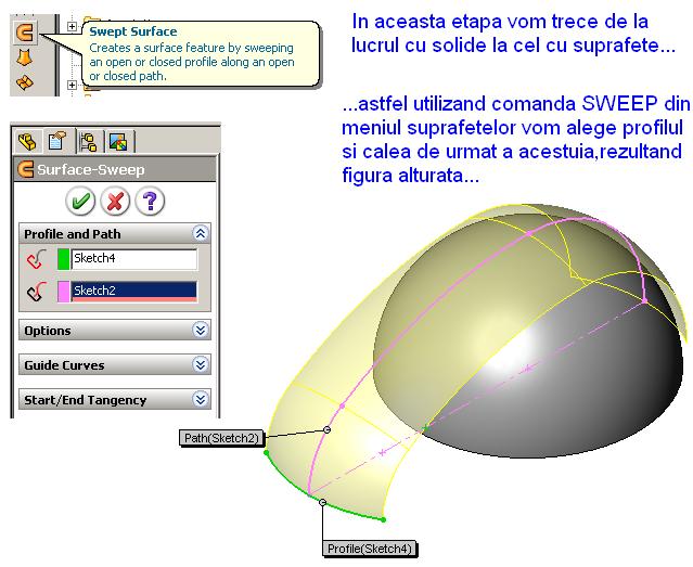

Step 4:
Step 3
Step 5:
Step 4

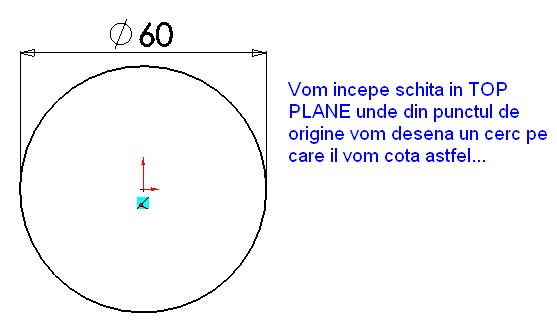

Step 6:
Step 5
Step 7:
Step 6

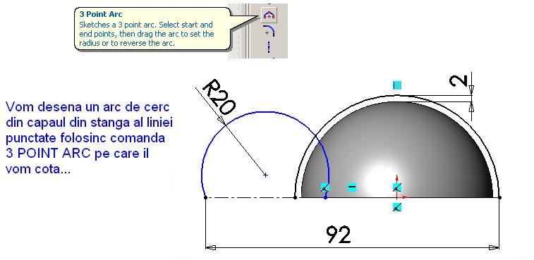

Step 8:
Step 7
Step 9:
Step 8
Step 10:
Step 9
Step 11:
Step 10
Step 12:
Step 11
Step 13:
Step 12
Step 14:
Step 13
Step 15:
Step 14
Step 16:
Step 15
Step 17:
Step 16
Step 18:
Step 17
Step 19:
Step 18
Step 20:
Step 19
Step 21:
Step 20
Step 22:
Step 21
Step 23:
Step 22
Step 24:
Step 23
Step 25:
Step 24
Step 26:
Step 25
Step 27:
Step 26
Step 28:
Step 27
Step 29:
Step 28
Step 30:
Step 29
Step 31:
Step 30
Step 32:
Step 31
Step 33:
Step 32
Step 34:
Step 33
Step 35:

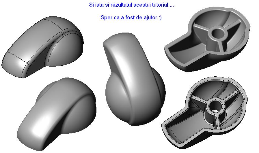

The result.
Step 36:
The result in colours .
