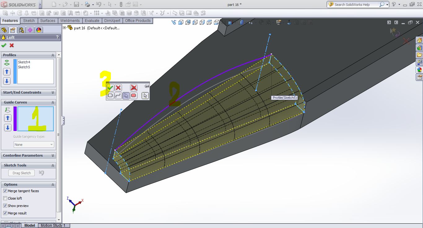

Step 1:

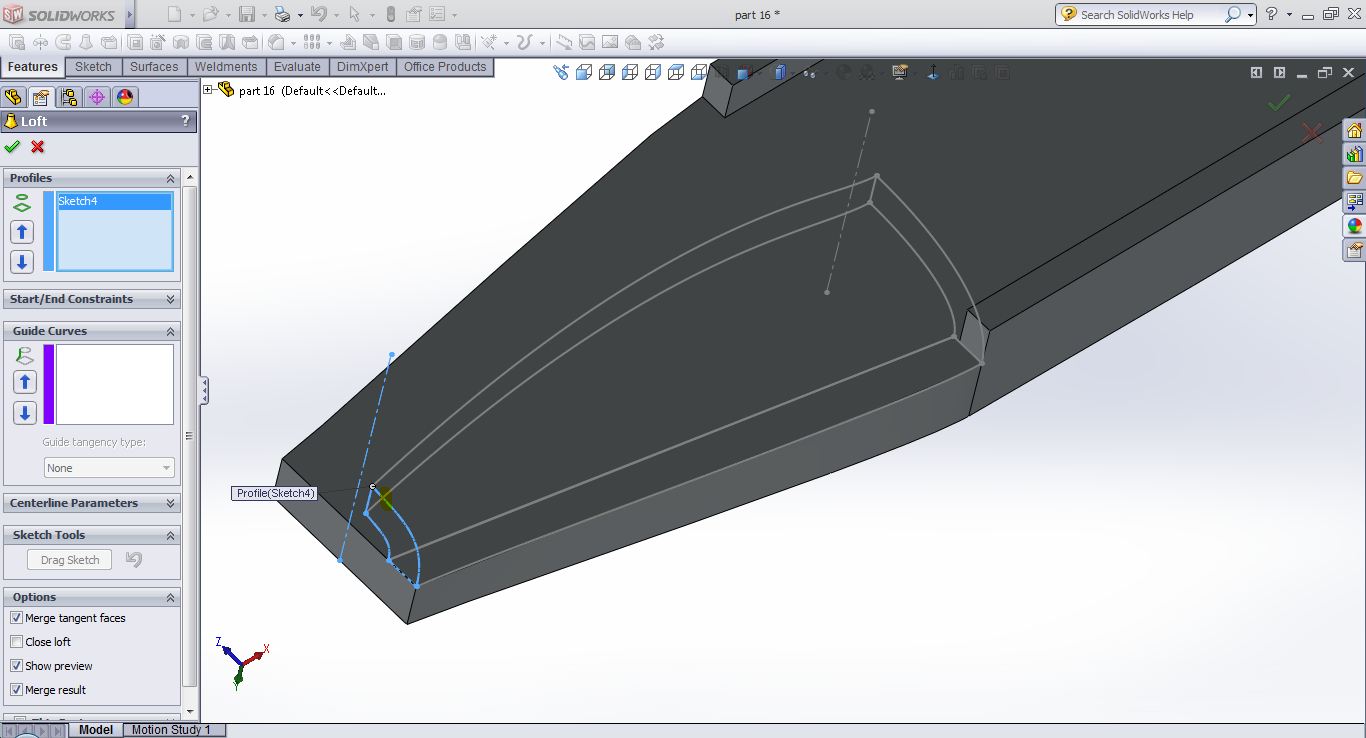

use loft command, select the sketch4 firstly (please click on shown place while selecting)
Step 2:
secondly select the sketch 5 ( please attention that to click on shown place. it saves you from errors)
Step 3:

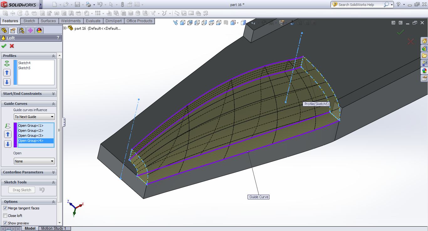

1. click on guide curves box 2. click on shown spline 3. confirm that
Step 4:
now select this spline and confirm that

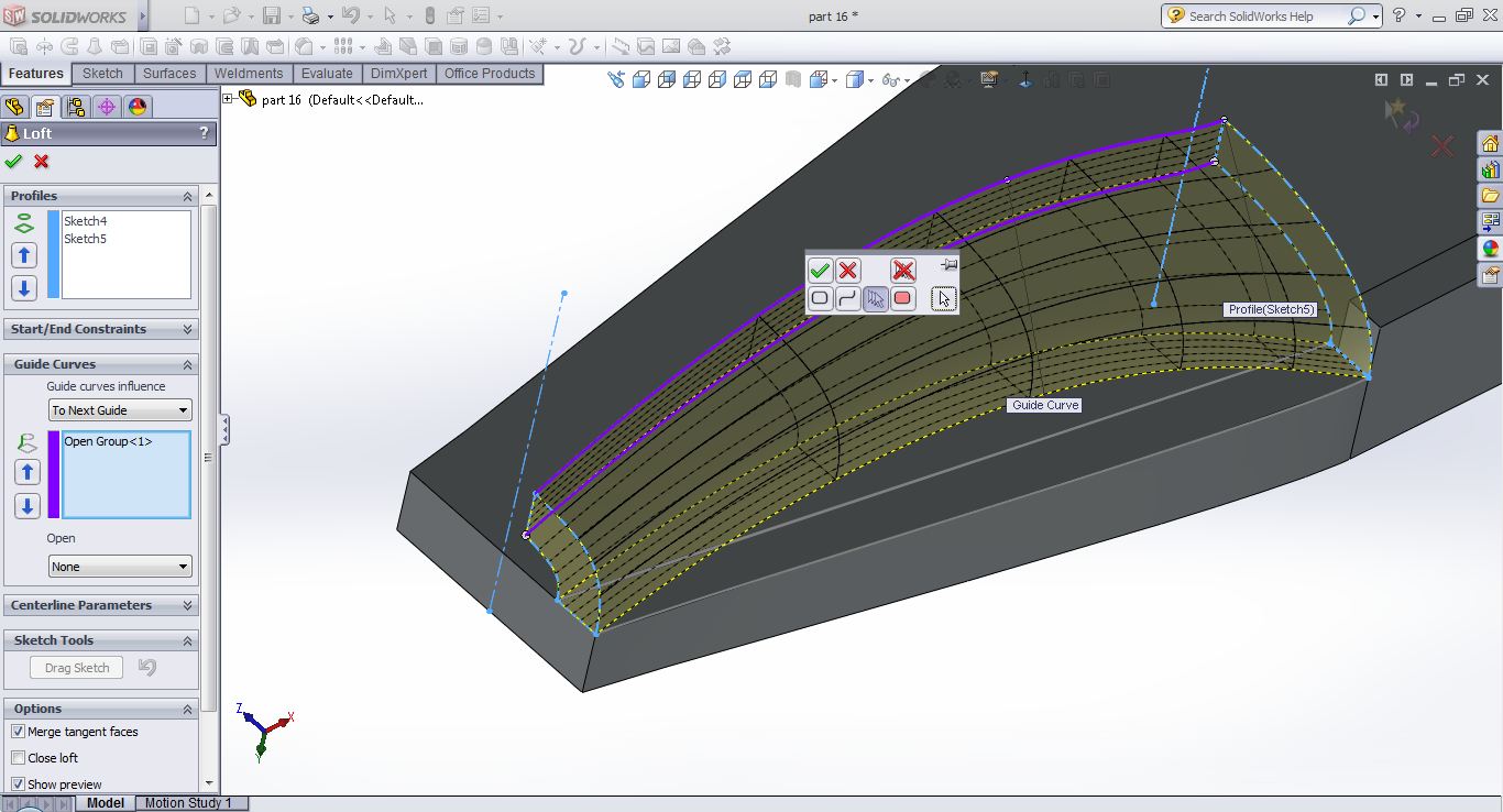

Step 5:
make same things for the other two lines

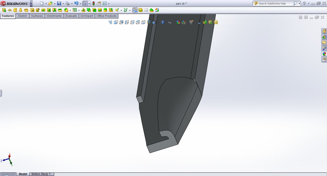

Step 6:
lofted body is ready

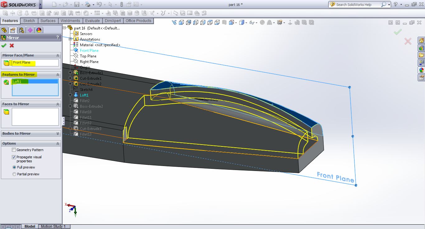

Step 7:
use mirror command

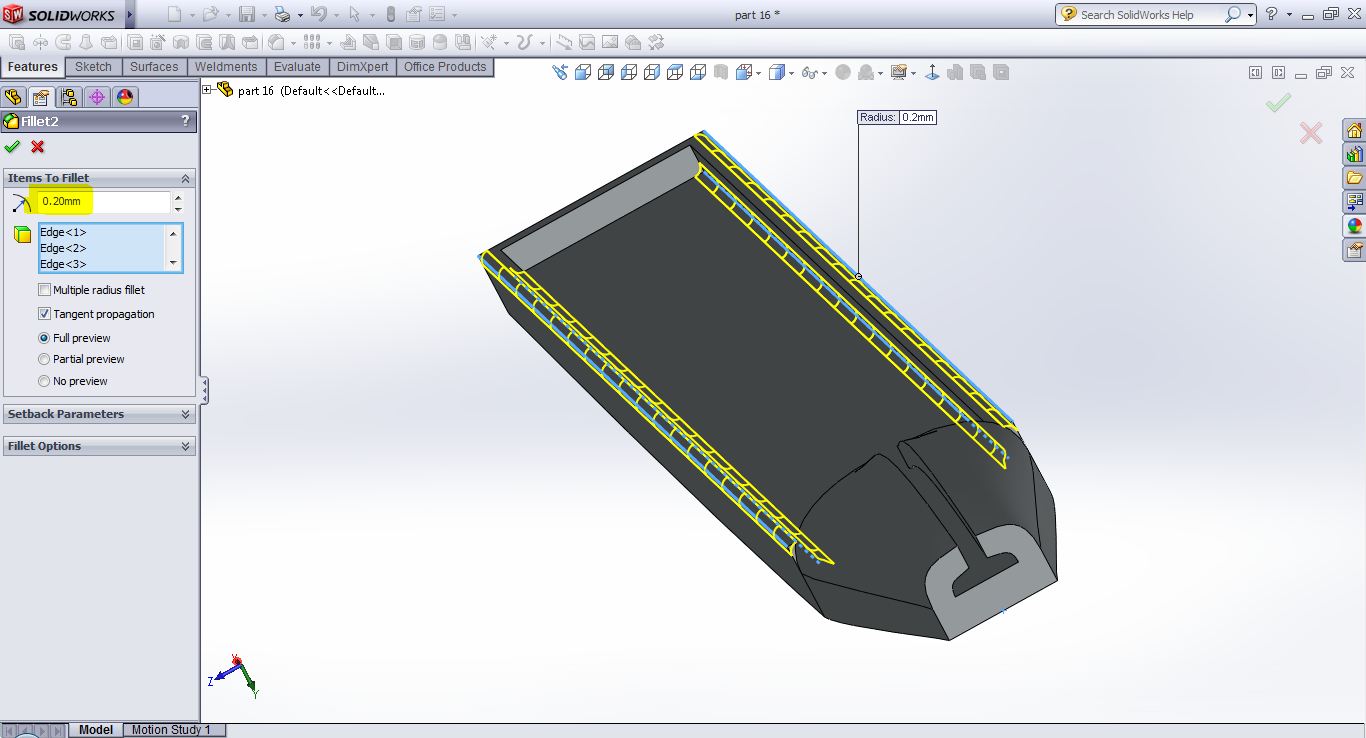

use fillet command

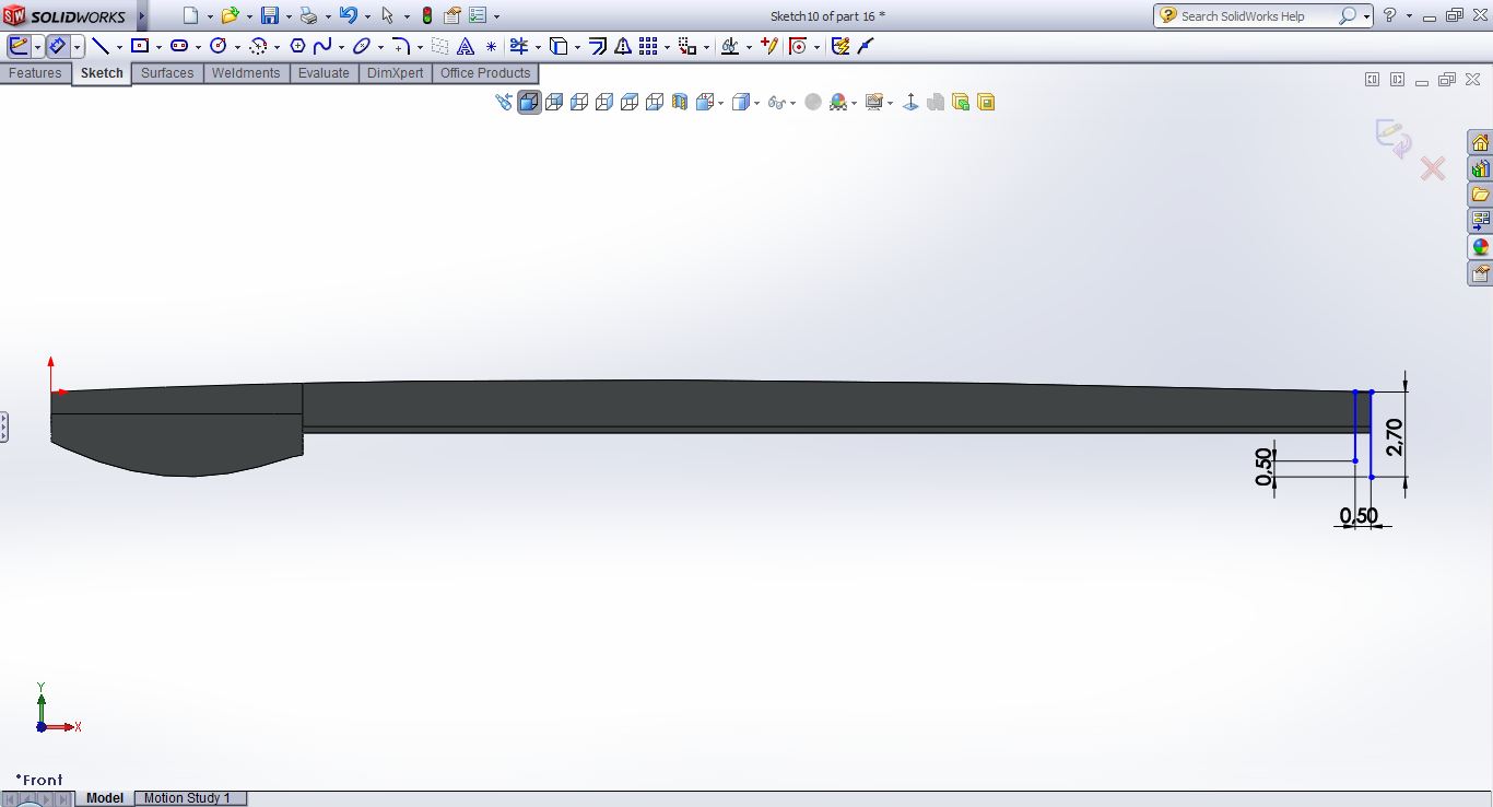

open a sketch on the front plane
Step 10:

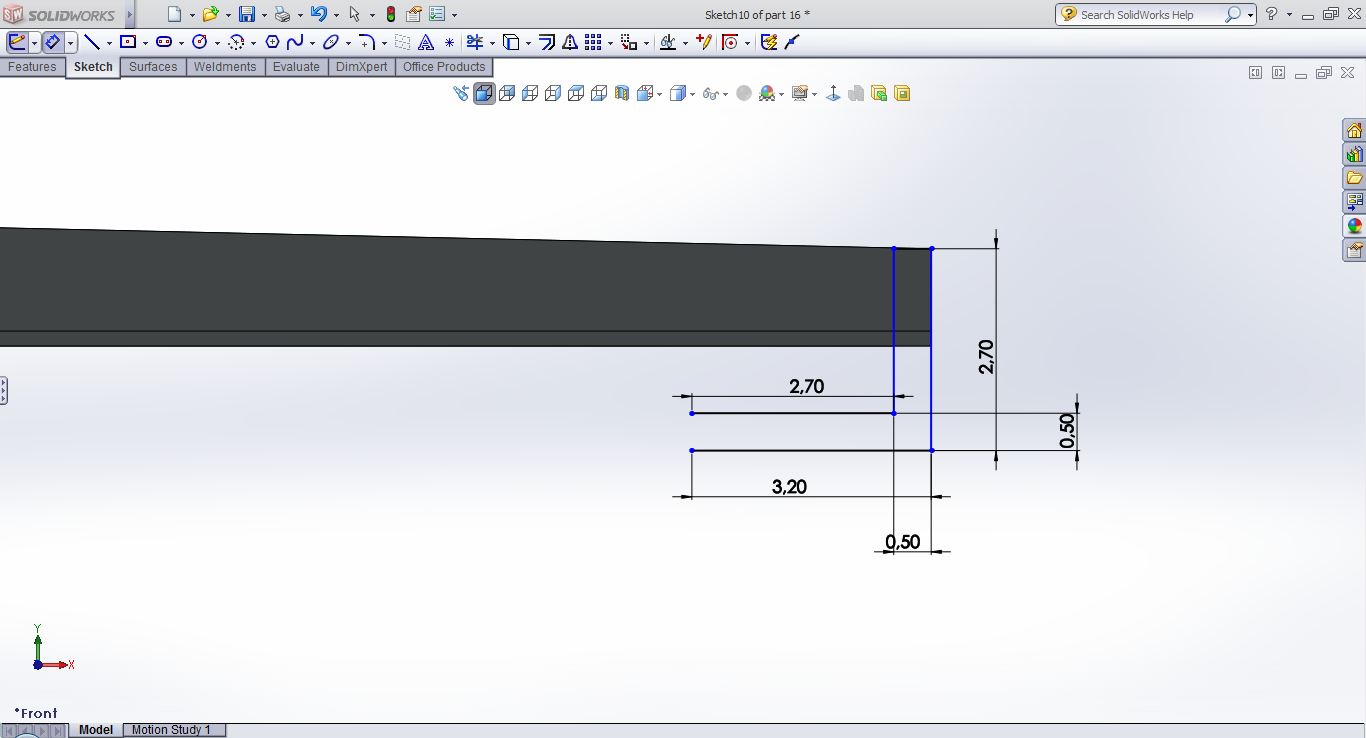

draw shown lines..
Step 11:
try to make your sketch like in the picture. please note only the shown lengths.
