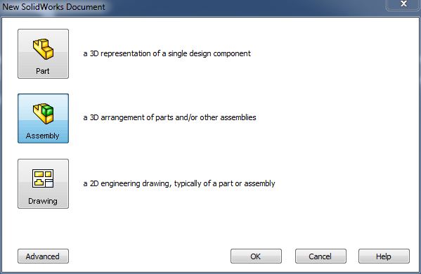

Step 1:

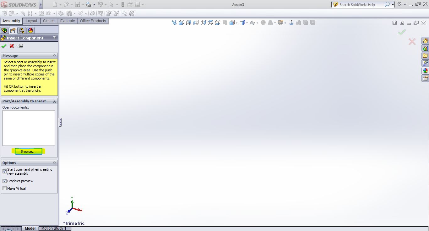

open a new assembly file
Step 2:

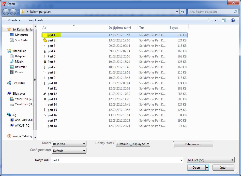

click on insert new parts--browse
Step 3:

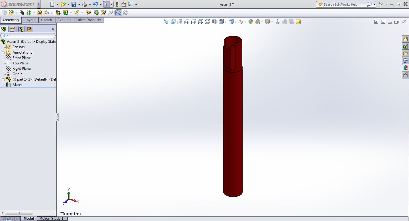

select part 1
Step 4:
part 1 ( I hope you named the files as I said. if not, found the parts that you see below and insert them:)

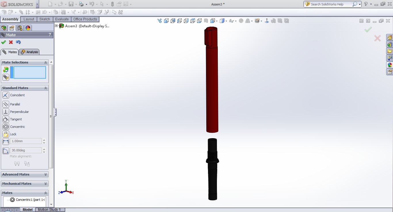

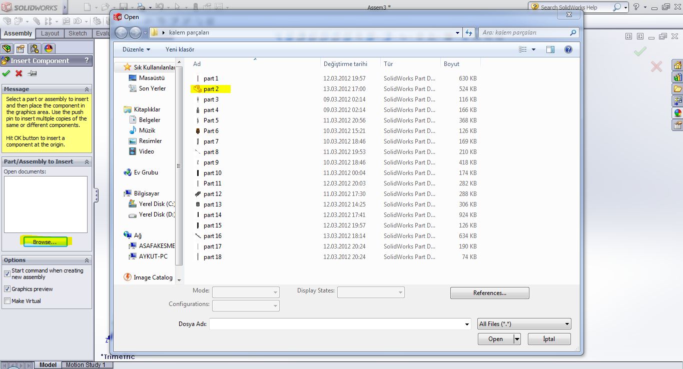

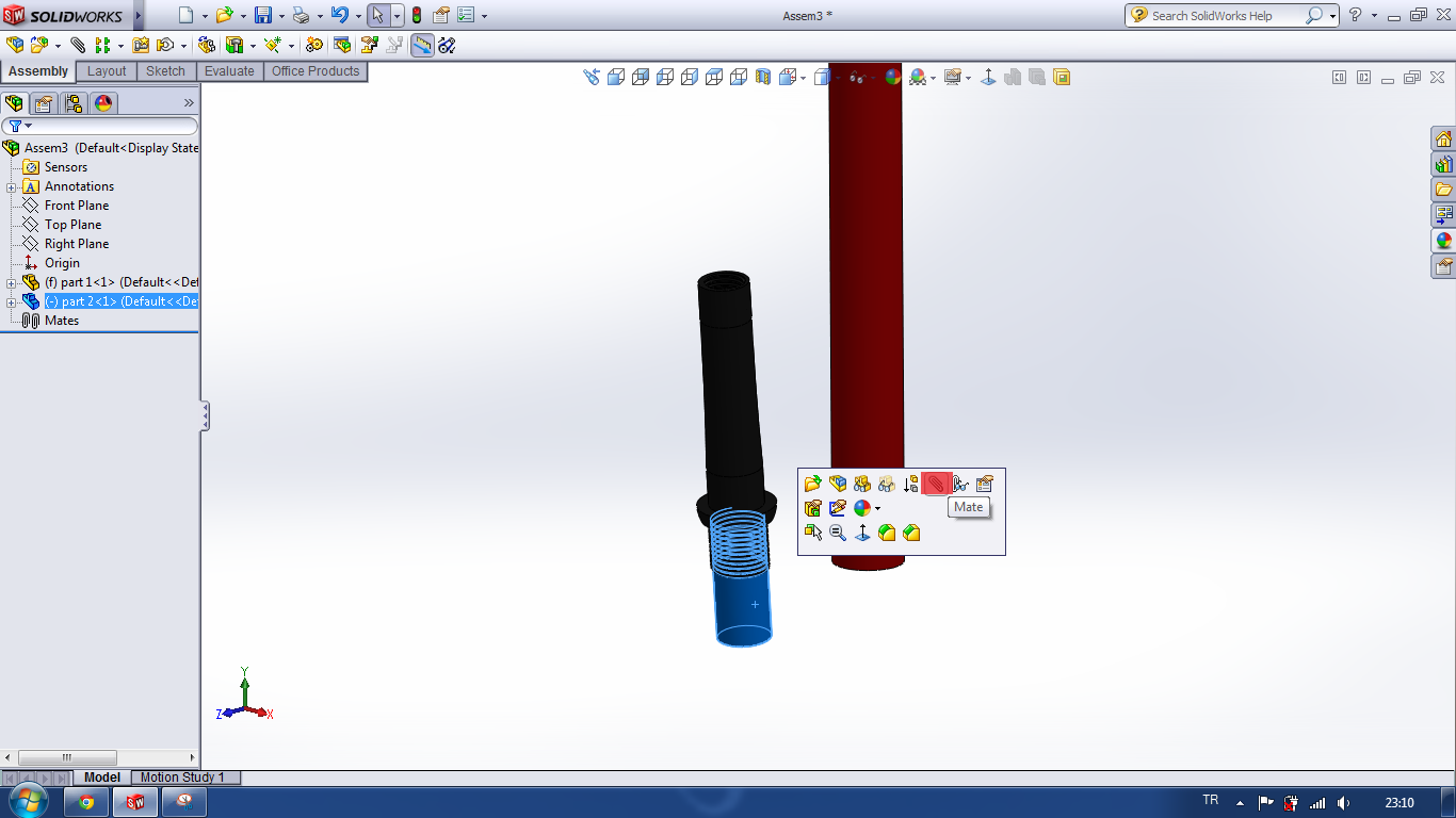

insert part 2

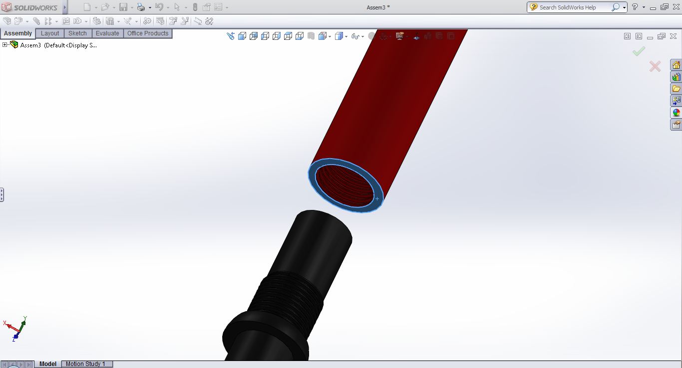

Step 6:

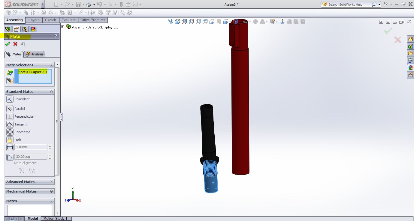

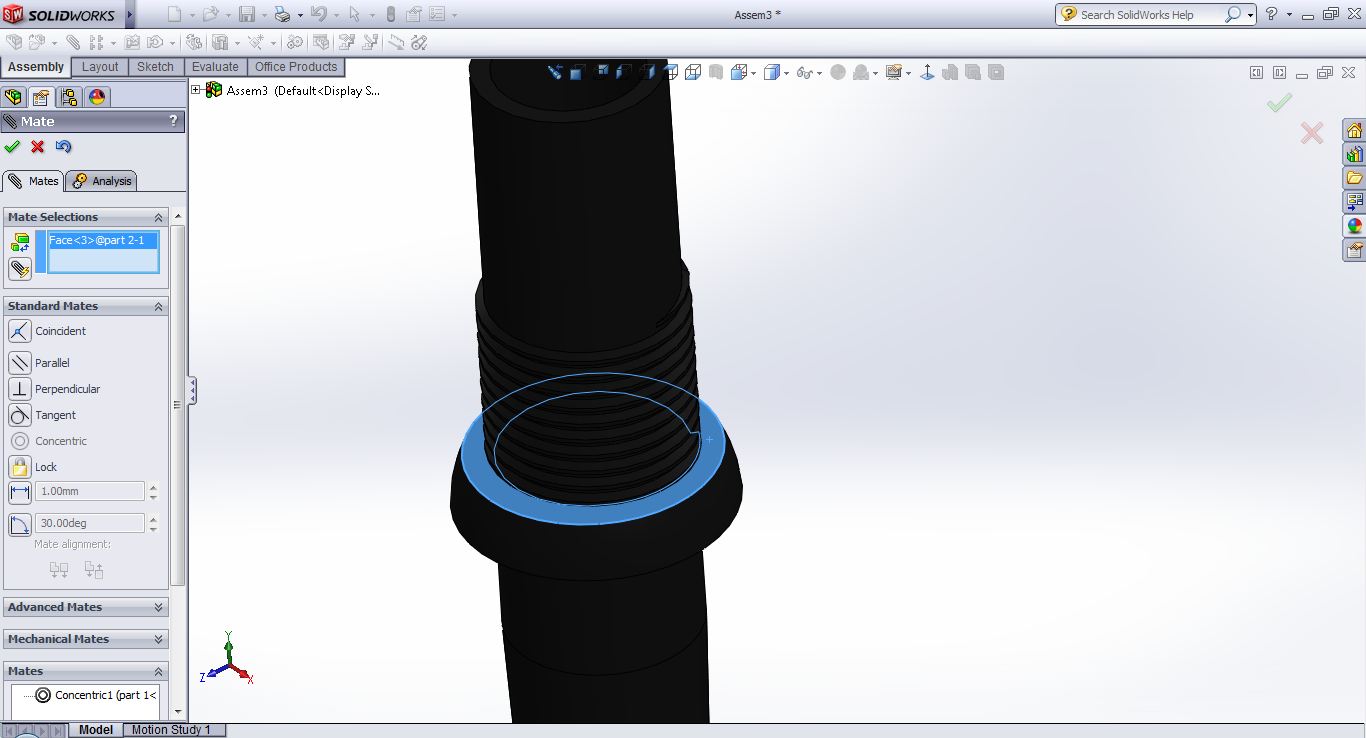

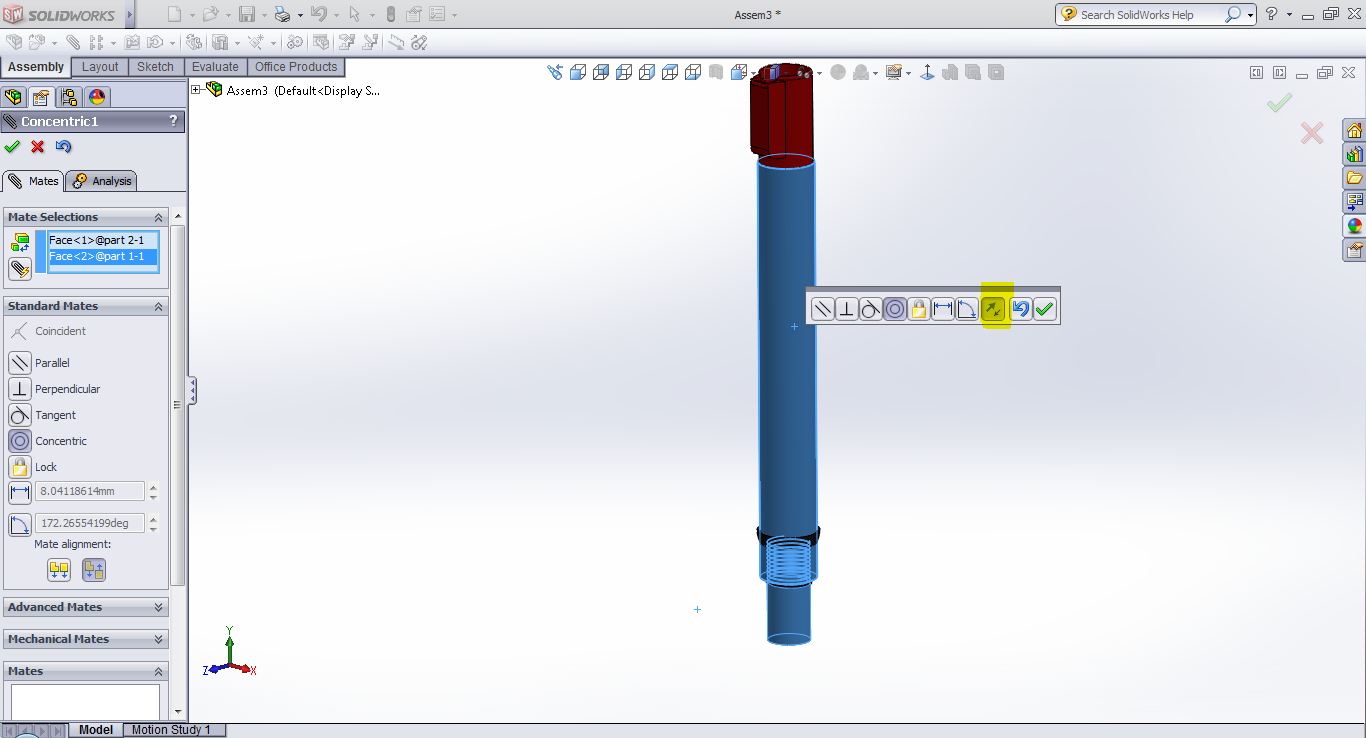

click on shown blue surface then click on matte button
Step 7:

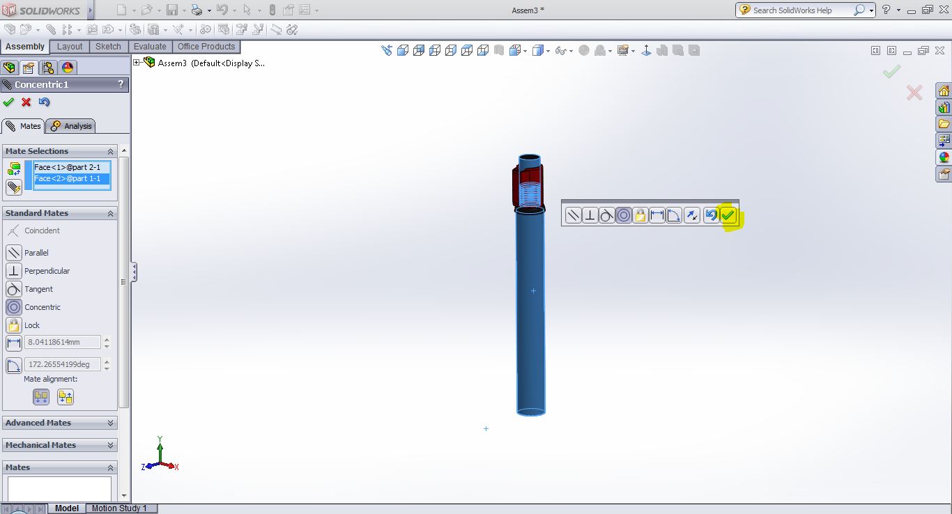

matte command is activated now as you see
Step 8:
click on shown surface of part 1. they will be concentric automaticly
Step 9:

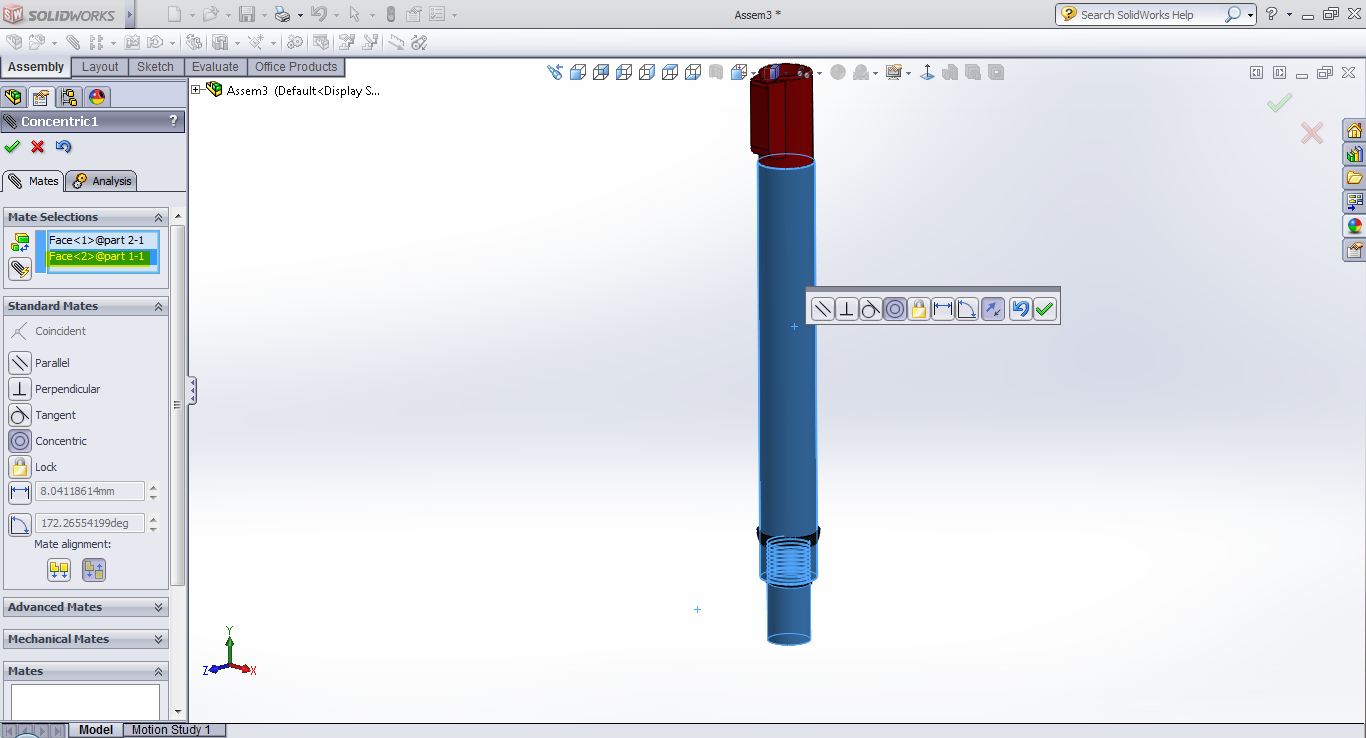

now click on shown button. because part 2 is reverse
Step 10:
confirm that
Step 11:
now move the part by dragging
Step 12:

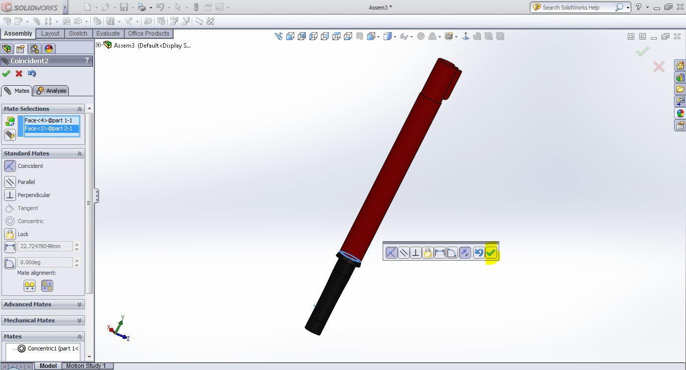

select the surface
Step 13:
then select this surface
Step 14:
confirm that..

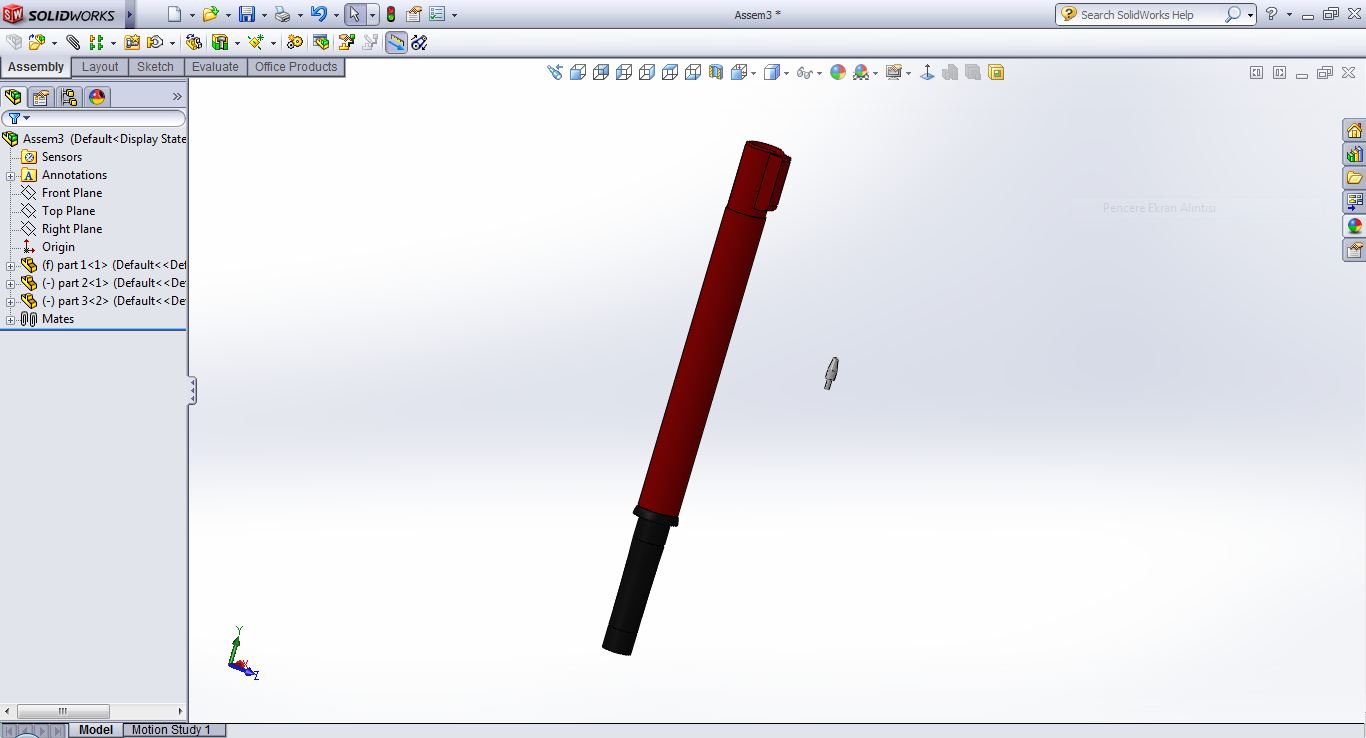

insert part 3
Step 16:
just drop it
Step 17:

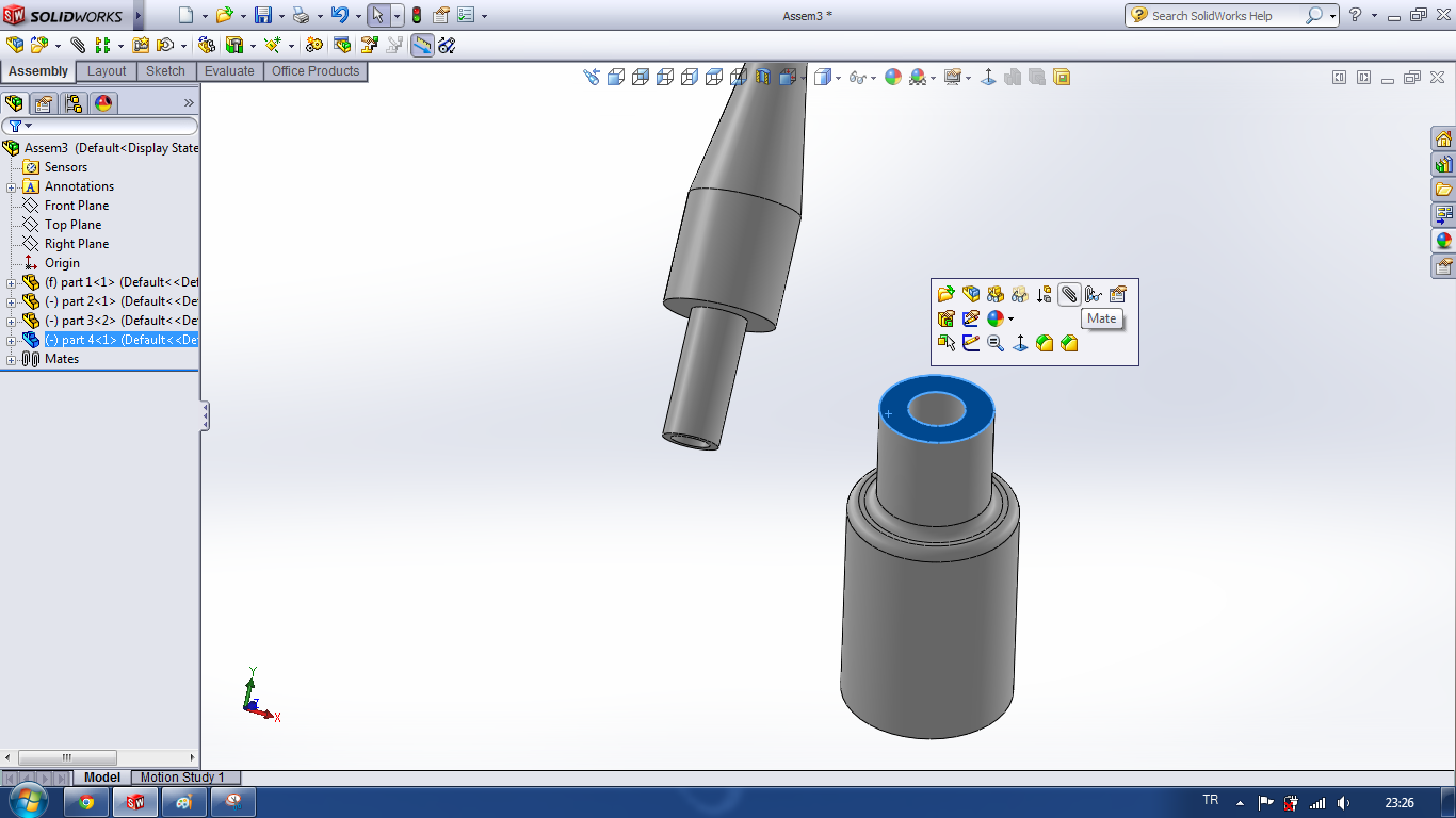

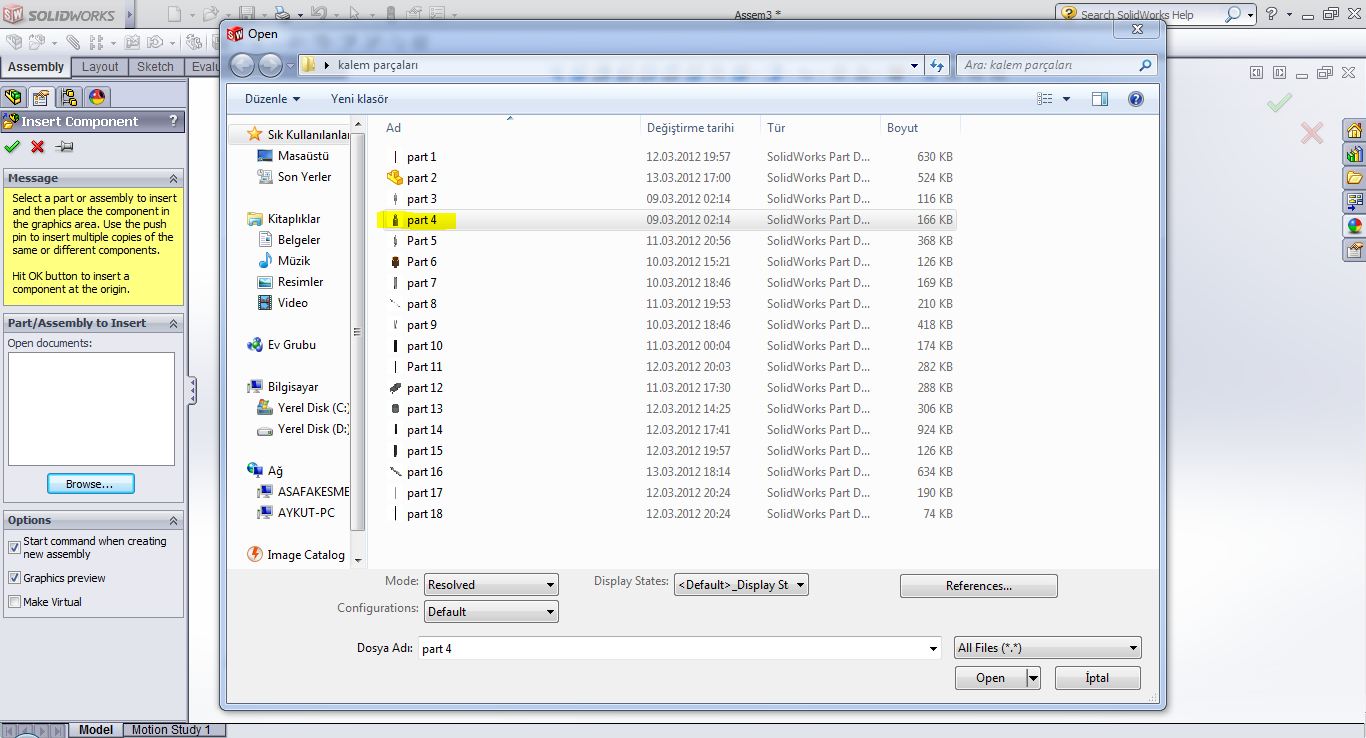

insert part 4
Step 18:

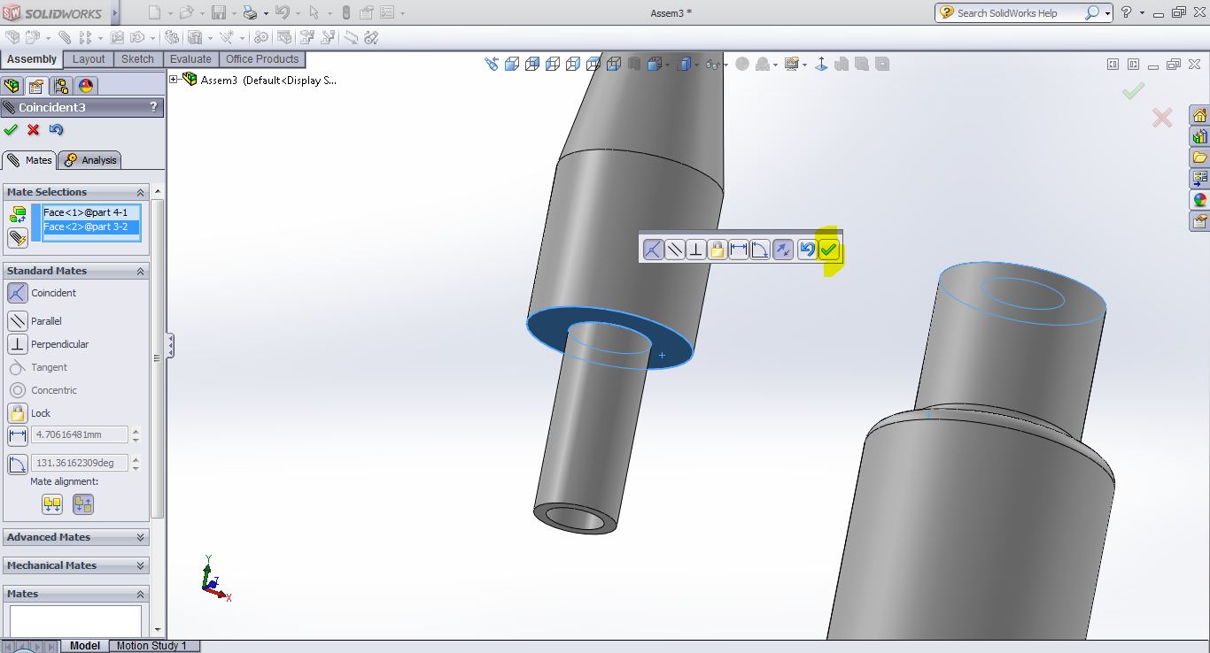

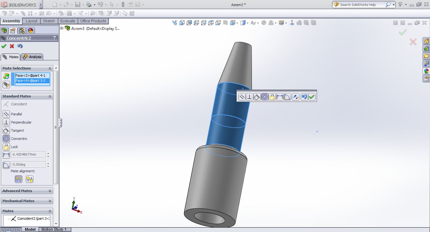

click on the shown surface and use matte command
Step 19:
then click on that surface and confirm it

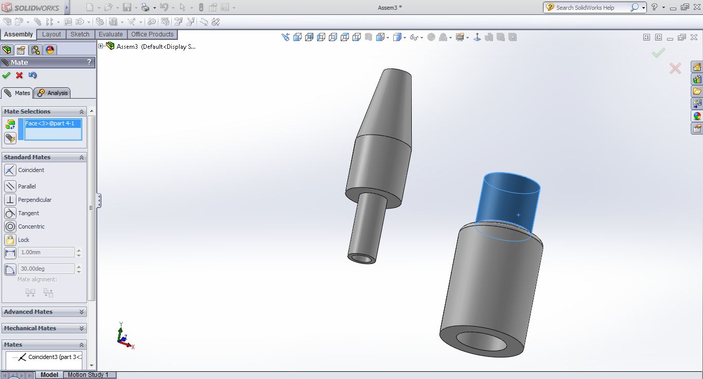

Step 20:
select the surface. ( don't close mate command )
Step 21:
select other shown surface and ok
