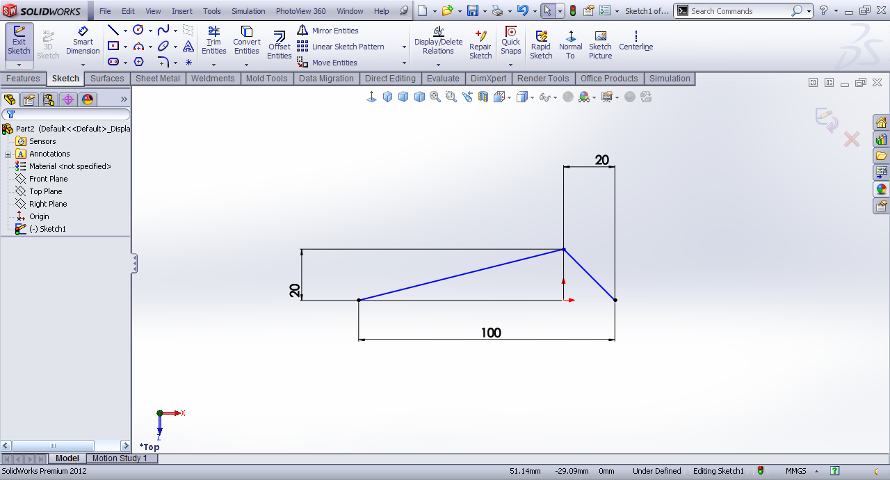

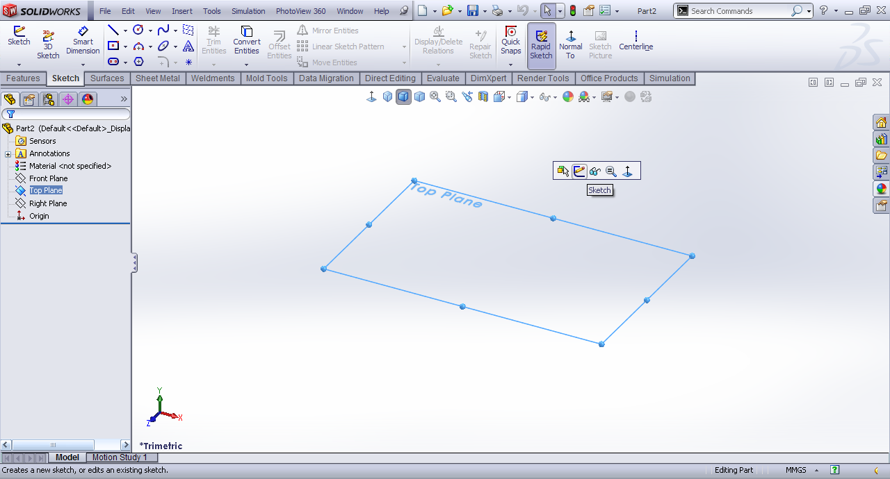

  1. Step 1:
    Top plane >> Sketch.
  2. Step 2:
    Draw this profile.

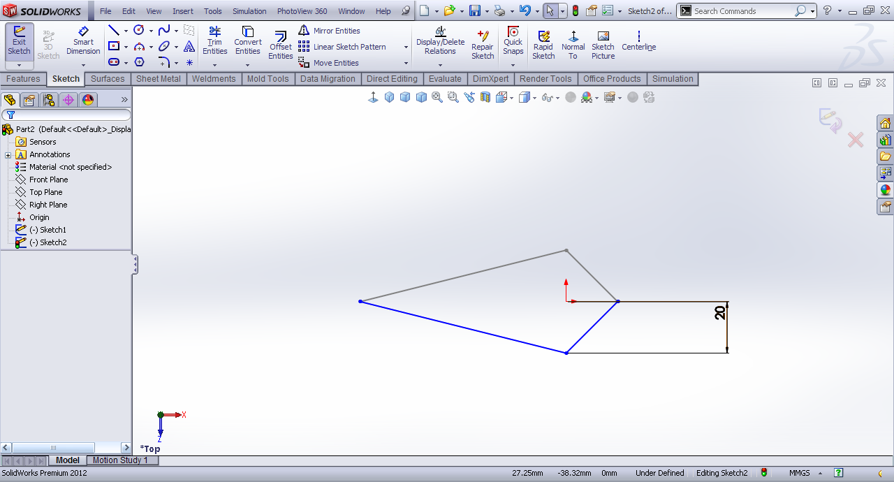

  3. Step 3:
    Exit the sketch and then again Top plane >> Sketch. Draw same profile.

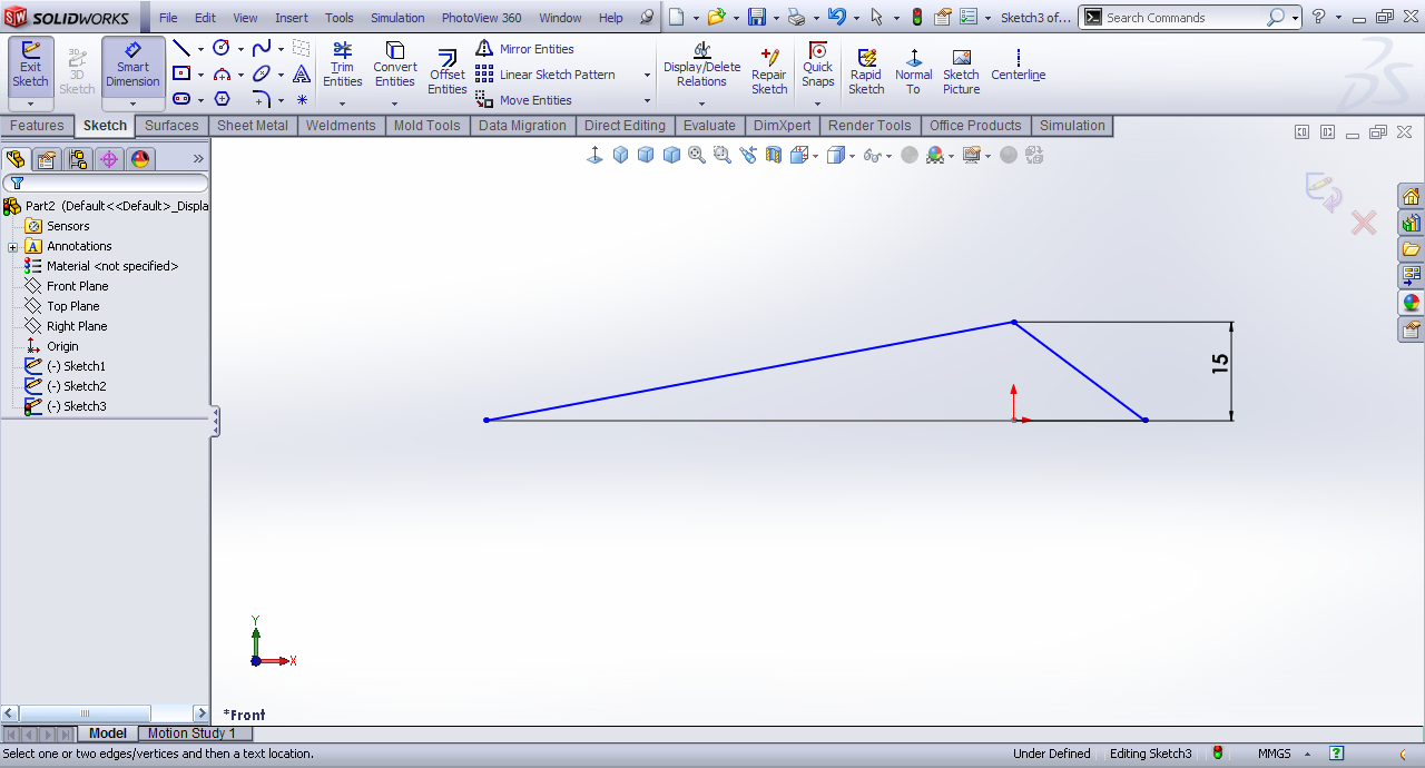

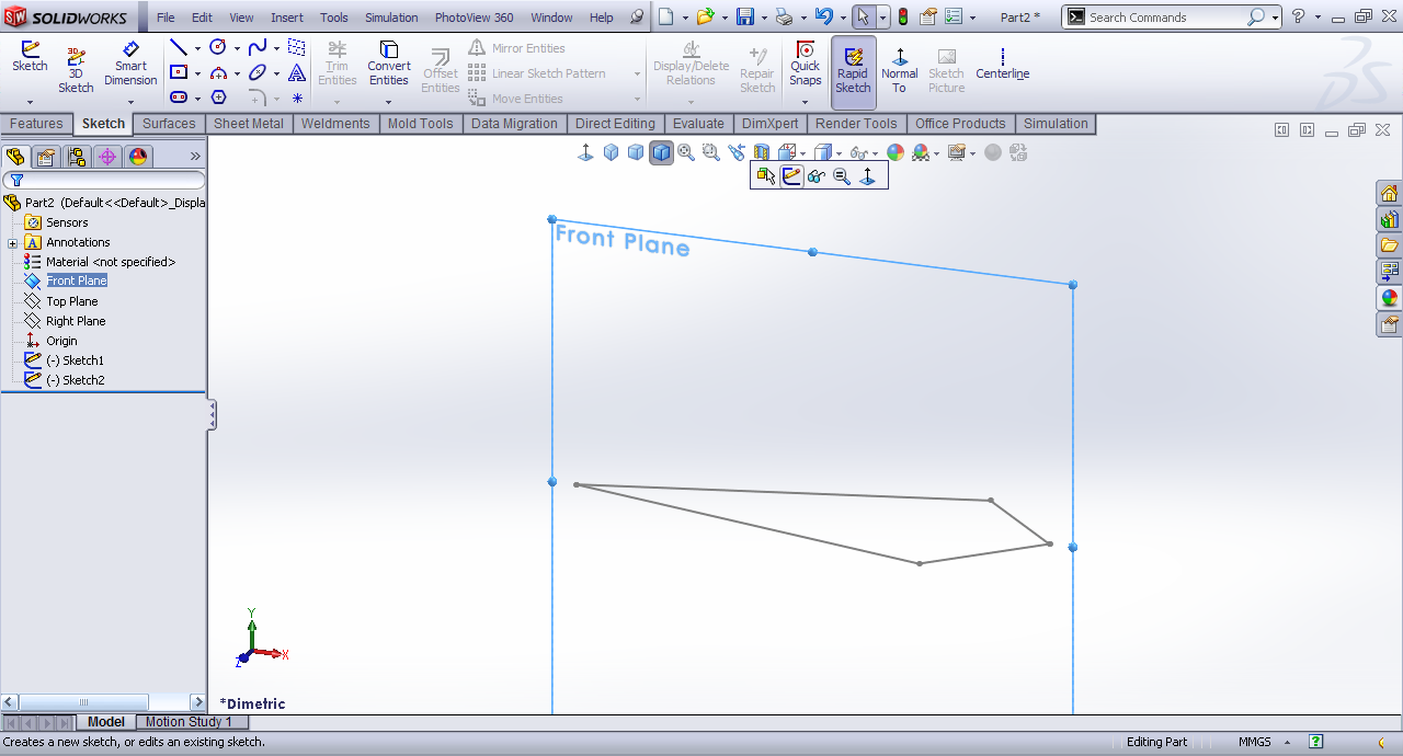

  4. Step 4:

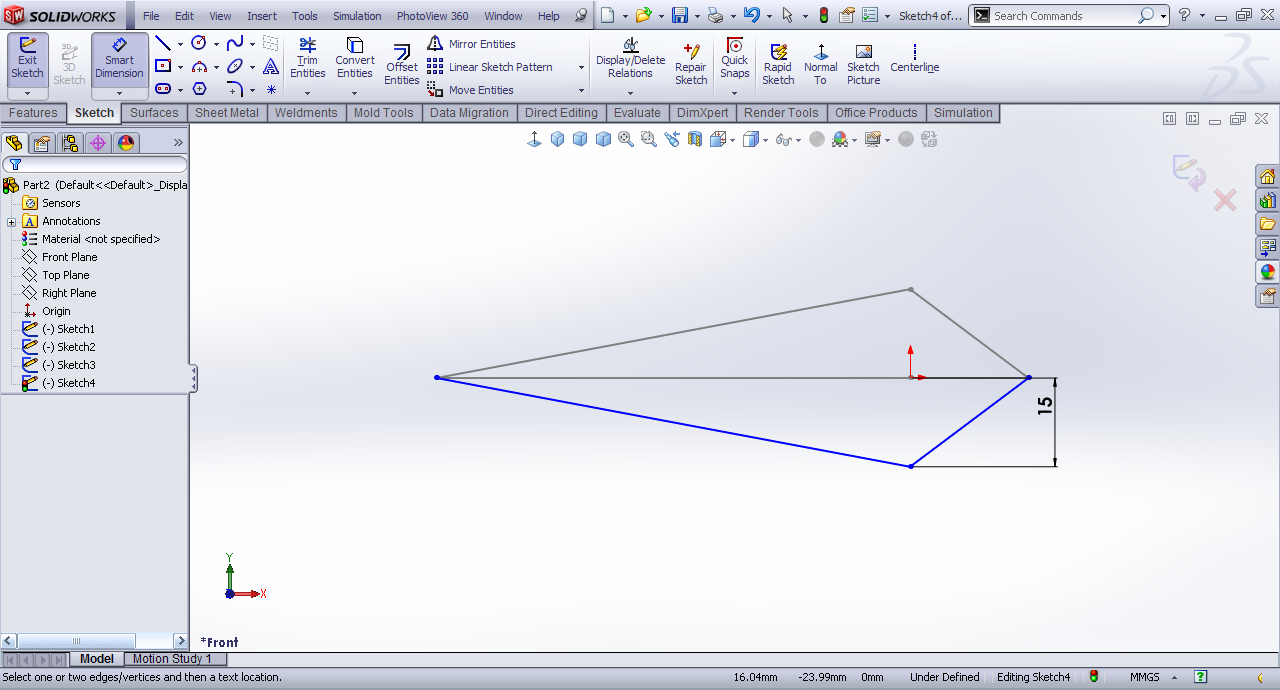

    Front plane >> Sketch.
  5. Step 5:
    Draw this profile. Exit the sketch.
  6. Step 6:
    Again Front plane >> Sketch and this profile. Exit the sketch.

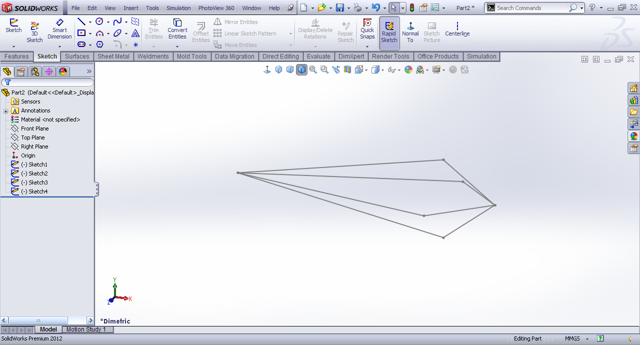

  7. Step 7:
    Now we have four different sketches.

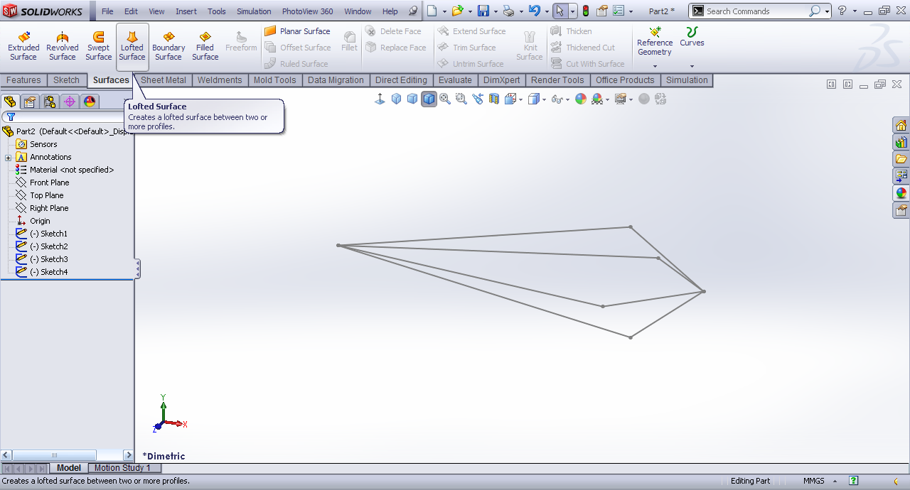

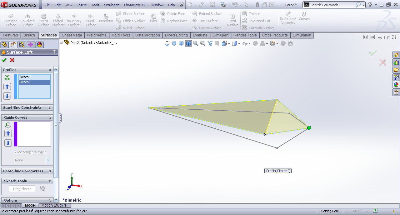

  8. Step 8:

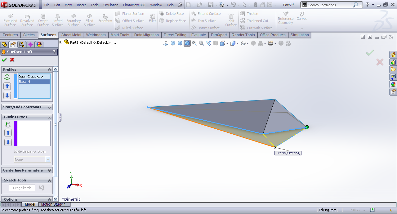

    Click Lofted surface under surfaces tab.
  9. Step 9:
    Select the two sketches. Click OK and the first surface is generated.

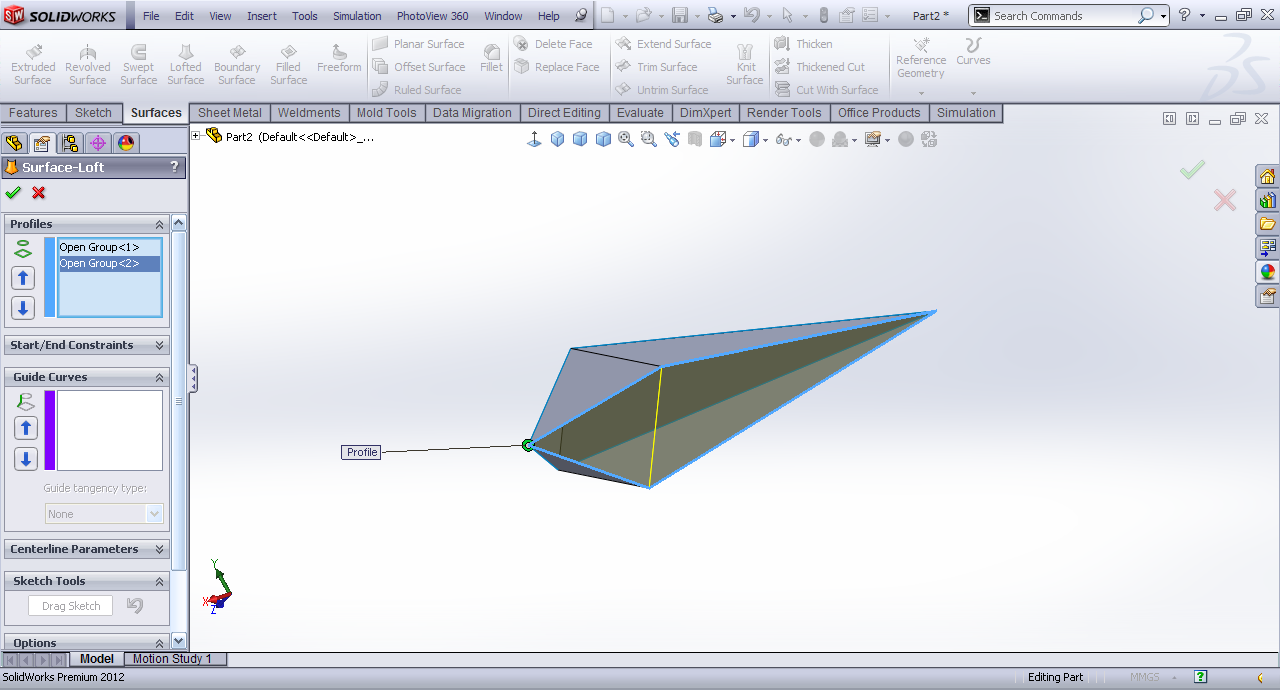

  10. Step 10:
    Now generate a lofted surface b/w the edge of the surface and sketch. Use selection manager to form group.
  11. Step 11:
    Again create the 3rd surface with same step.
  12. Step 12:
    Final surface with the edges of surfaces.

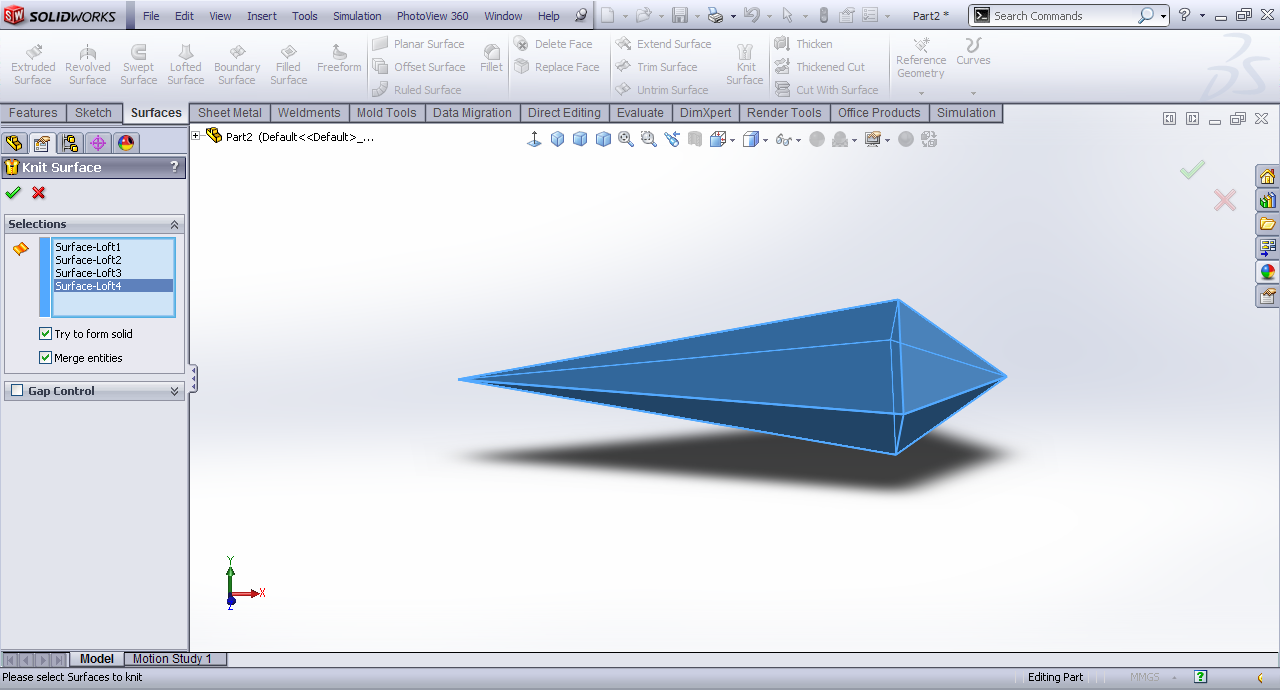

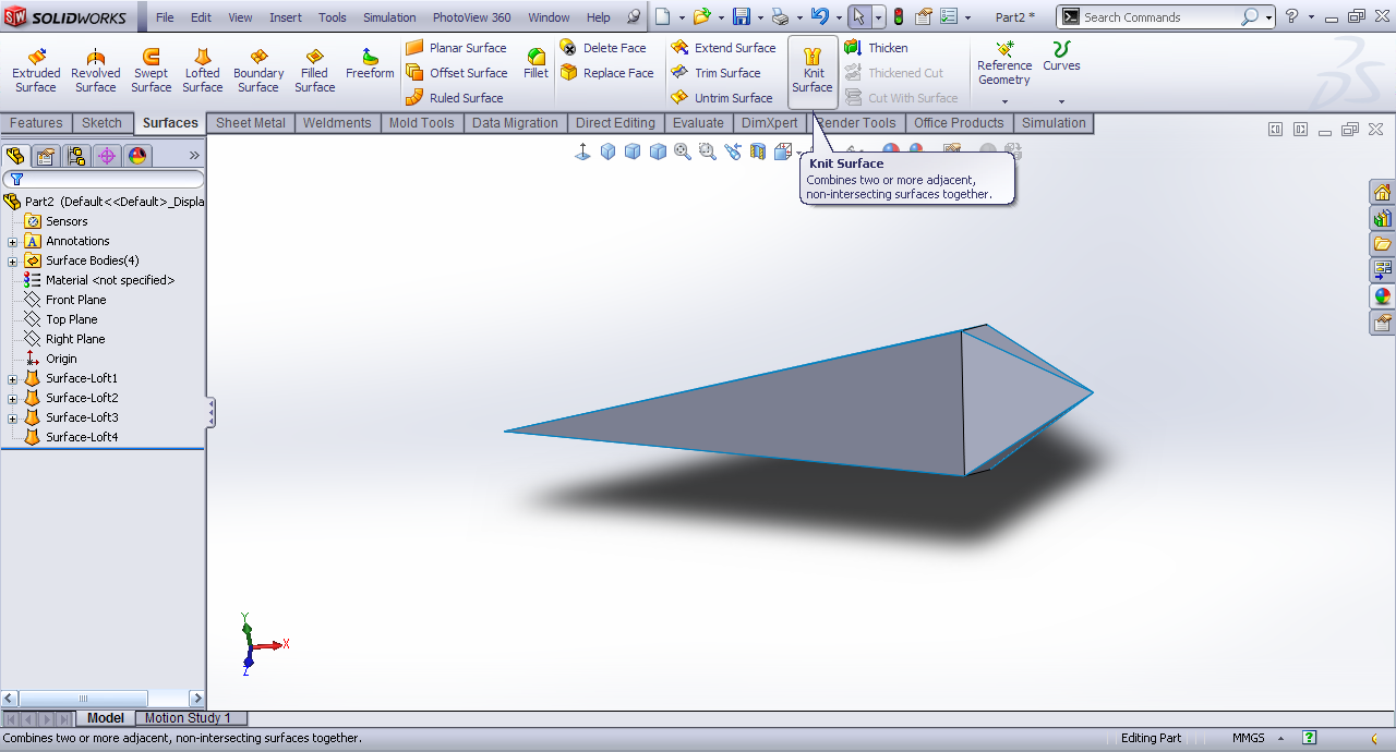

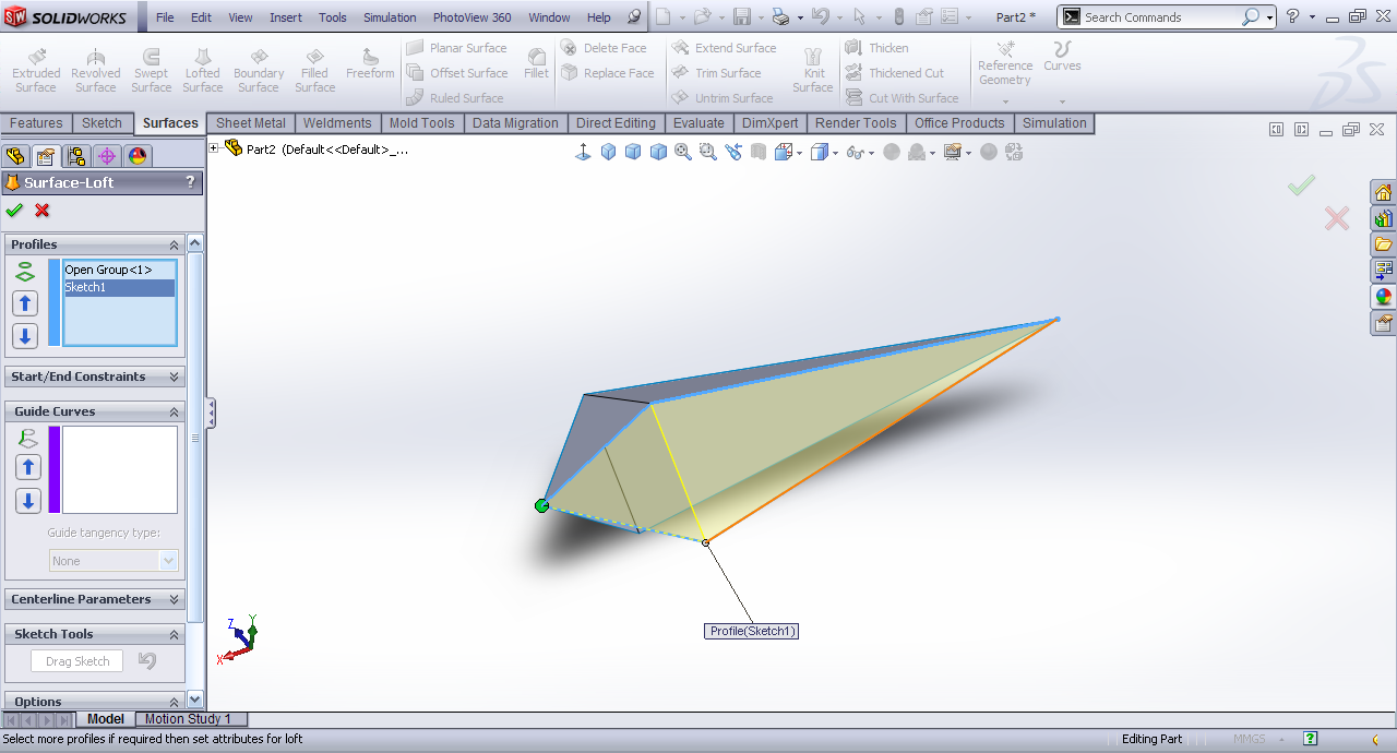

  13. Step 13:

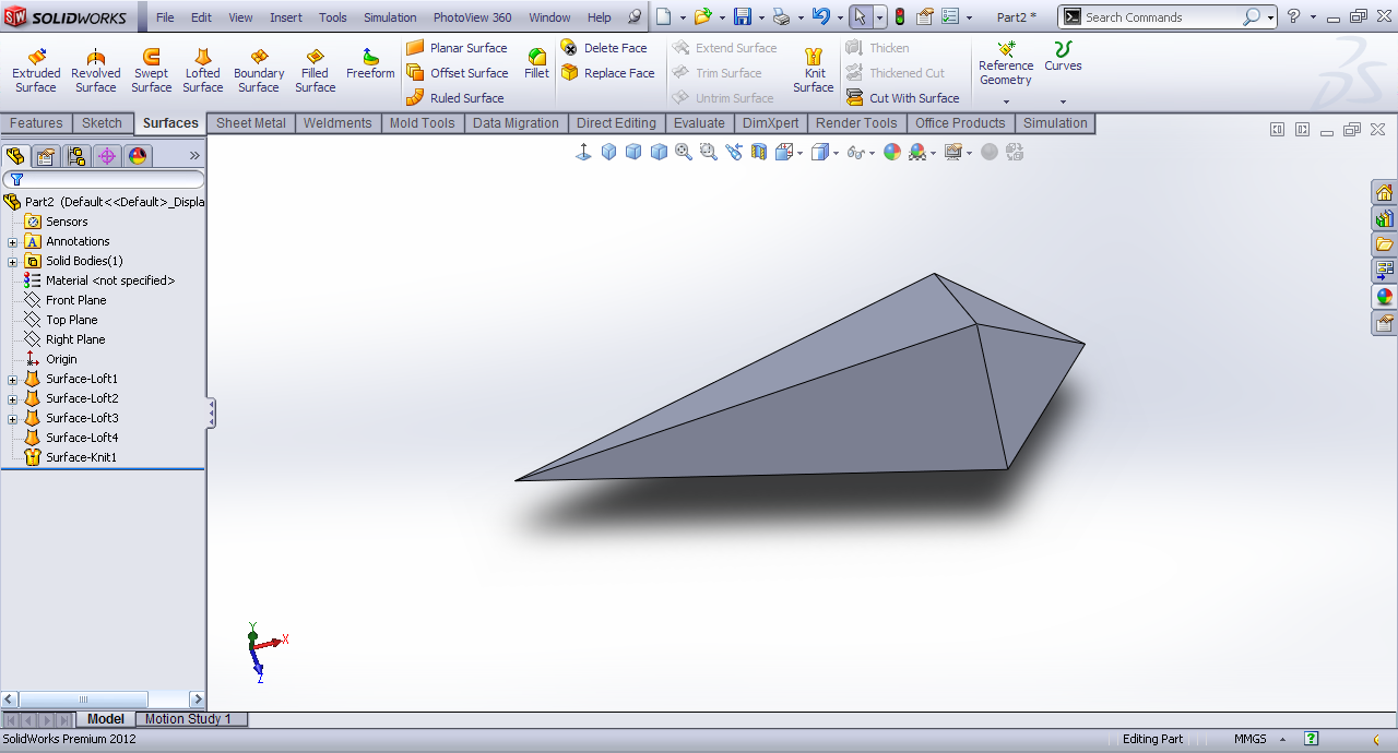

    Click Knit surface under surfaces tab.
  14. Step 14:
    Select all surfaces and check Try to form solid and click OK.

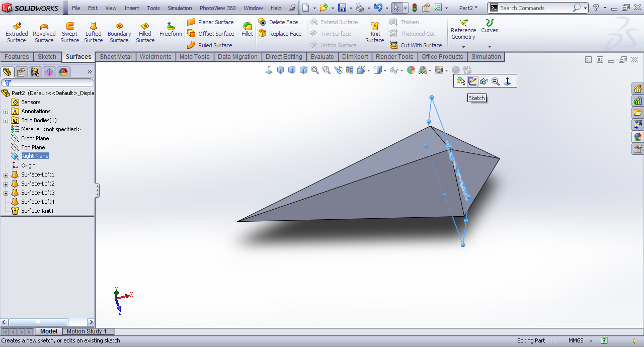

  15. Step 15:
    Now we can see that a surface is generated.

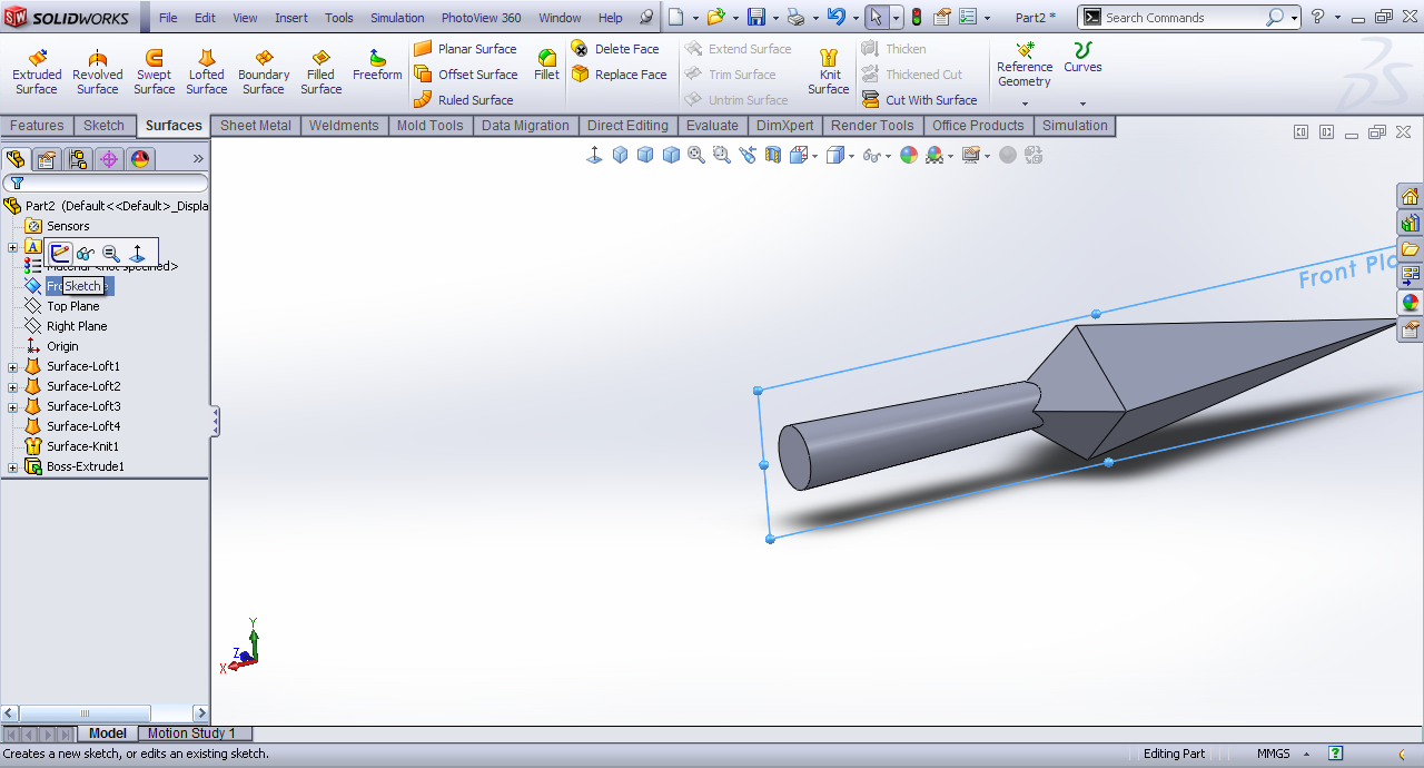

  16. Step 16:

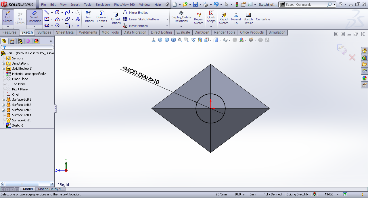

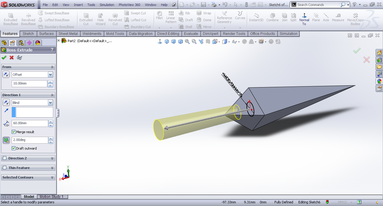

    Right plane >> Sketch.
  17. Step 17:
    Draw a circle of 10mm dia.
  18. Step 18:
    Extrude it with outward draft and from the offset plane.
  19. Step 19:

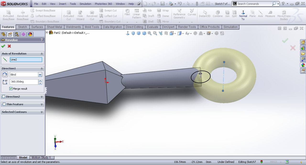

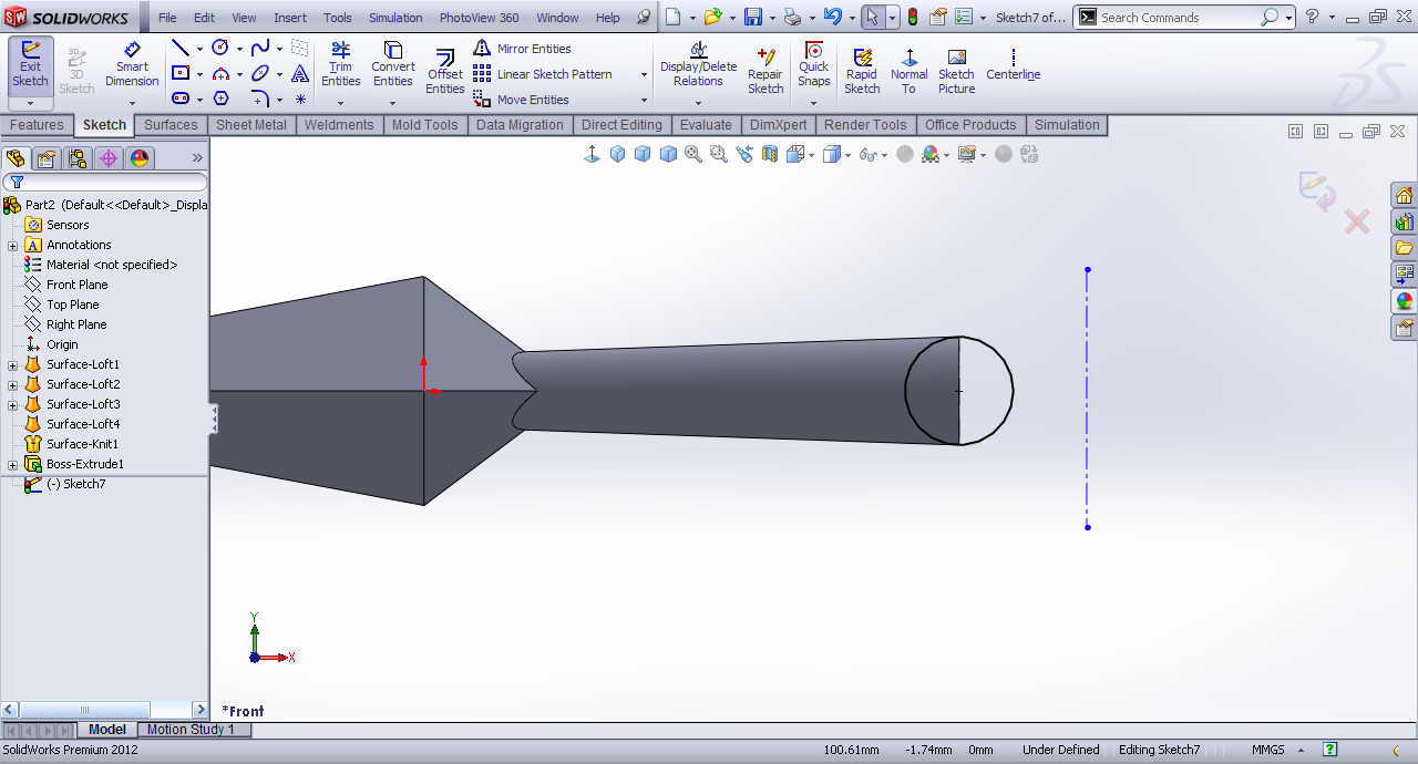

  20. Step 20:
    Draw a circle on the edge.
  21. Step 21:
    Revolve it about the center line.

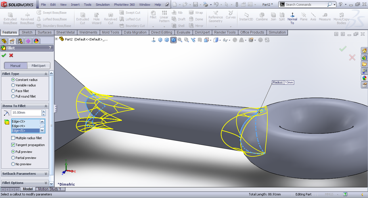

  22. Step 22:
    Fillet the edges.

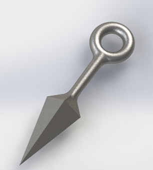

  23. Step 23:
    We have the kunai created.
