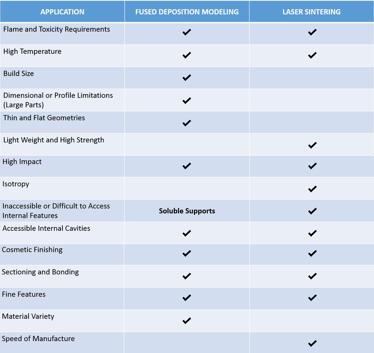

Step 3: Comparing FDM & LS
Step 4: Familiar & Fast
The ultimate benefit of using LS or FDM to fabricate parts is the familiarity of the materials with the added advantages of 3D printing. LS and FDM offer the ability to build low-volume parts with complicated geometries much faster and usually at lower cost than injection molding.
