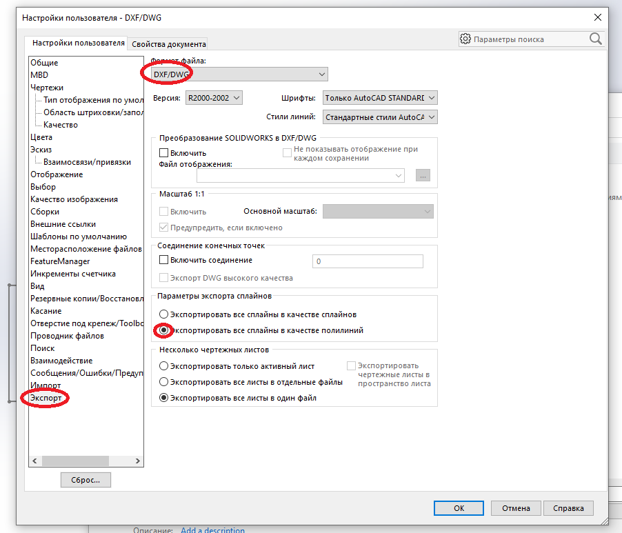

Does anybody know a way to have text in a sheet metal part and it not turn in to splines when flat pattern is saved as .dxf?
The main reason for this question is anytime I make something with text in it, I have to go back in the .dxf I saved and clean up the splines so I can program the part to be laser cut. It looks like crap when I cut a part with a bunch of splines. Any advice will be much appreciated.
Try this settings in SW
