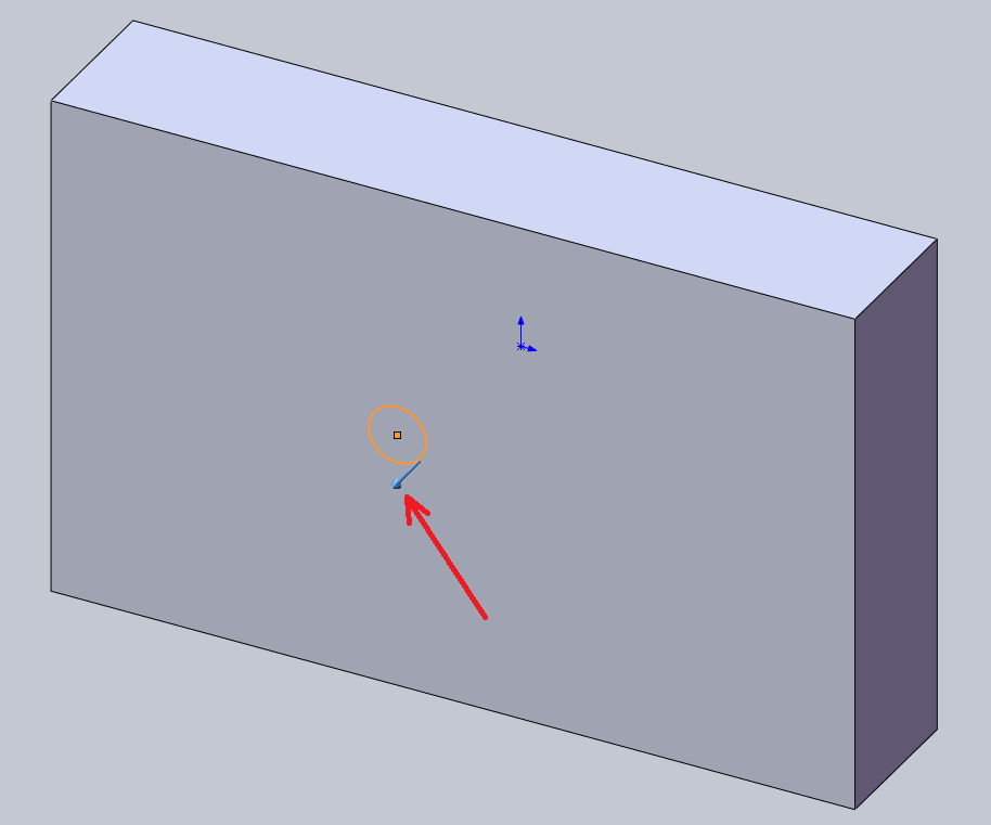

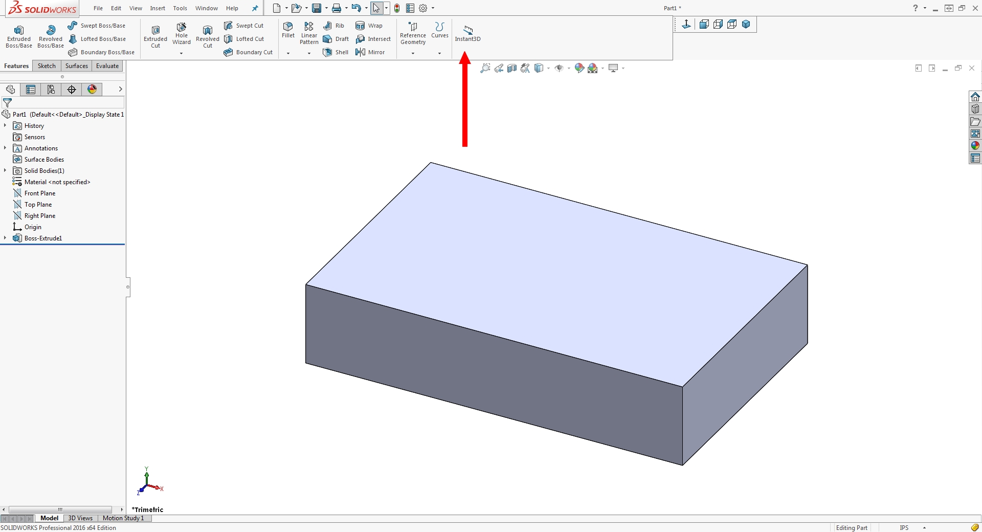

How add this shortcut option in Solid Works (Refer attached drawing)! Ranjith Chandradharan 27 Nov, 2015 11:52 AM Hi, Please find attached image and could anybody tell me how to add the indicated option in Solid Works? SolidWorks-.png 1 Answer FredSWUG Answered on 27 Nov, 2015 10:52 PM That looks like Instant3D mode. Look for the button to turn it on/off, I don't think there is a menu command to do it from. Instant3d.jpg
