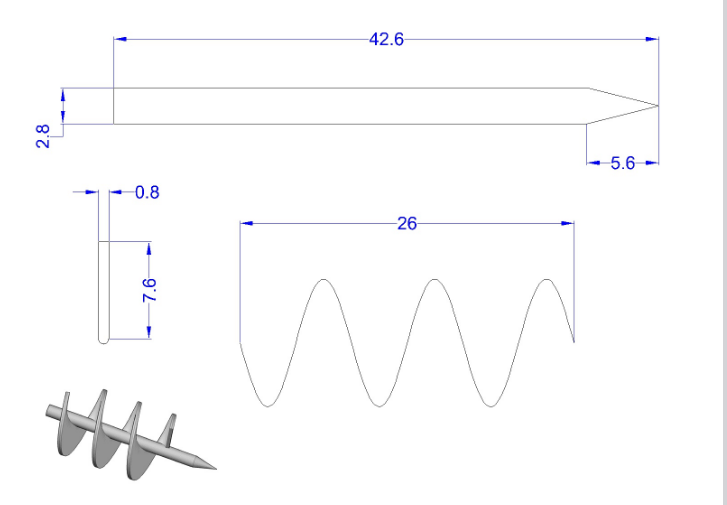

How I draw this part using catia v5 software Mohammed Diab 28 Jul, 2025 06:54 AM please help me to draw this part Capture.PNG 2 Answers Jack K Answered on 29 Jul, 2025 01:42 AM What have you drawn so far? Please attach a screen shot Muhammad Asim Nouman Answered on 20 Aug, 2025 10:40 AM You have to use GSD for Helix Curve and other thins using Part Design Work Bench Only. Let me know if you could draw with this hint.
