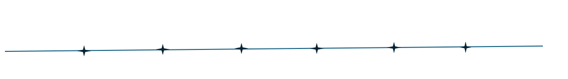

hi, what I mean is something like this. you can create a line and then you can create equal segments on the line like the image here. Solidworks has this feature.

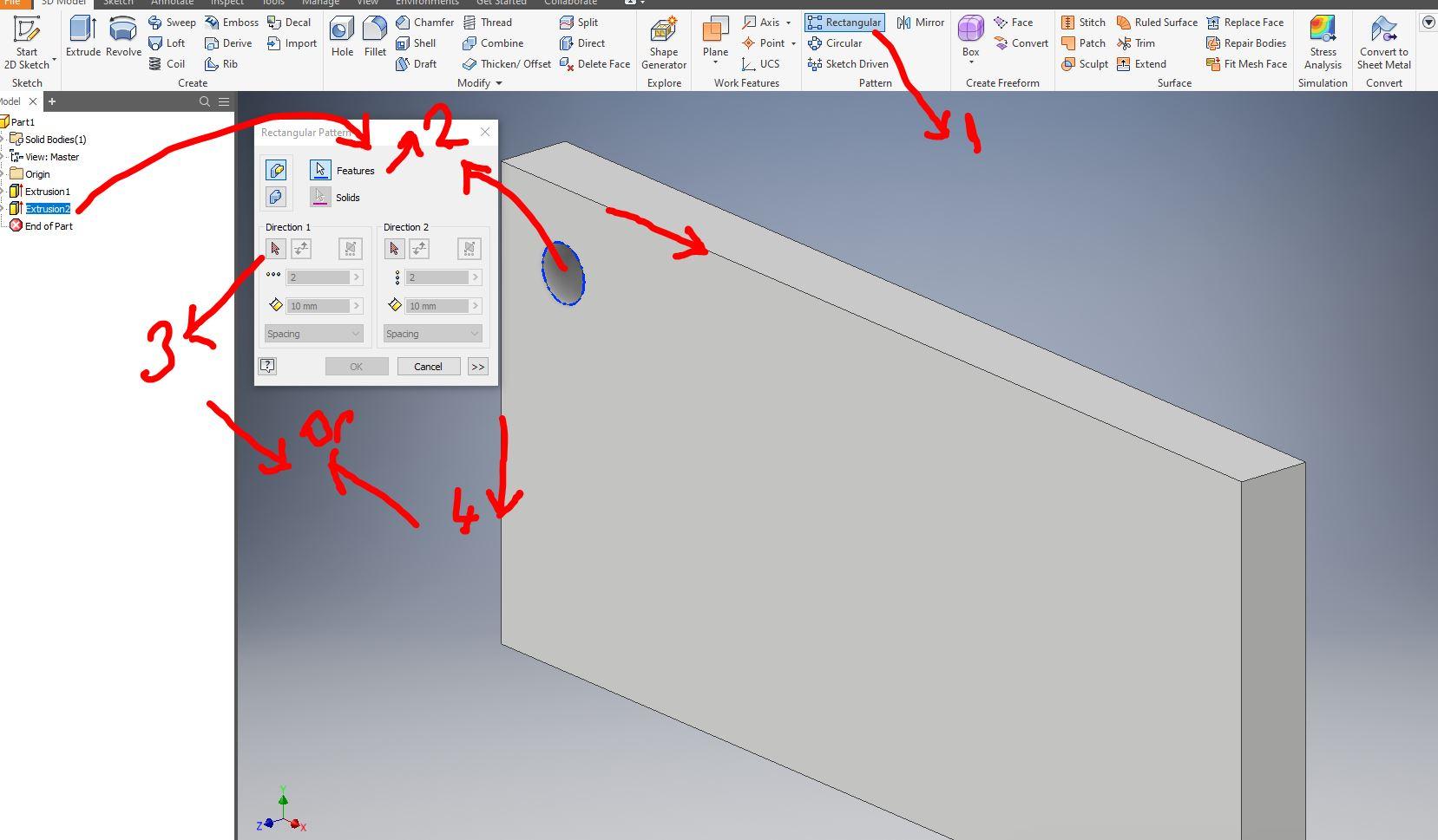

Görseldeki gibi delikleri çoğaltabilirsin
