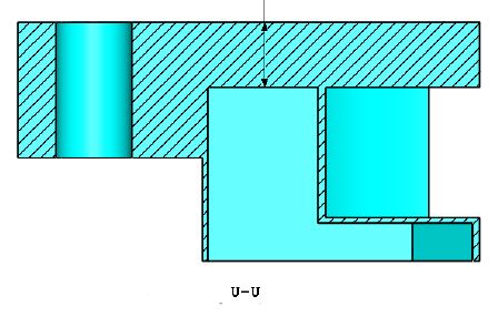

how to perform shell (thickness as "1mm")operation as shown in below figure
perform shell and mass of the body will be 452grams

in 3d model..i already attached that model .while performing the shell operation the whole solid body taking the feature(shell)..

i attached a picture and model ..according to the picture i want to use the shell command..if there any posibility make a tutorial for this operation
I'm not sure that I understand you in the correct way.
But if is necessary for You to work with the shell Command, i have a quick and dirty solution.
Should be the Front open?
To get to the weight of 452g, the Insidethickness must be 2.1 mm and the "Thickness.2 must be -12.89mm.
